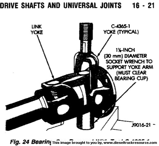

This is what the manual suggests. I've never had any trouble getting the plastic to shear doing it this way. Since you are only pressing against one ear of the joint's yoke at a time, and that ear is directly supported, you don't squeeze or spread the spacing between the ears.
I don't have the "C-4365-1" tool in the picture, so I use blocks under the joint to support the arms of the cross, and put the socket on top. I've watched guys use the heat method, and using the press is a lot easier. Not to mention the Spicer service manual "WARNING: Never heat components, never use sledge hammers, and never use floor jacks to disassemble driveshafts.This can result in damaged,weakened, or bent components."
