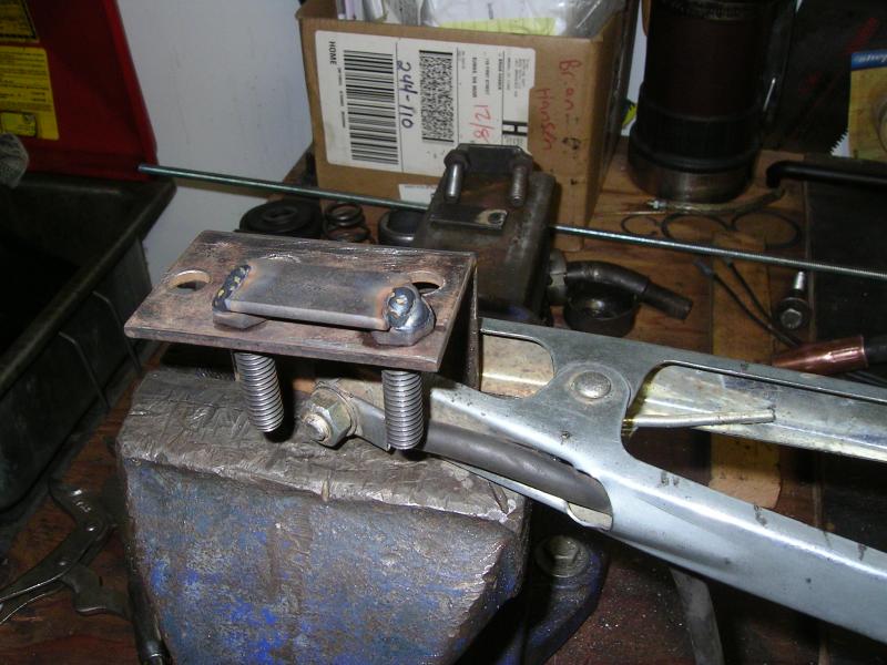

I did do one little modification when installing the fuel tank straps. Since the 84 chassis uses a little different tank strap then the later ones. The 84 straps are bolted to the bottom of the frame rail with two bolts and nuts, behind the fuel tank. The problem with this set-up is that you can not remove those nuts since the bolts will spin once loosened.
So my solution was to weld a small piece of flat bar between the bolts. Thus making a simple U-bolt that can be unbolted anytime.

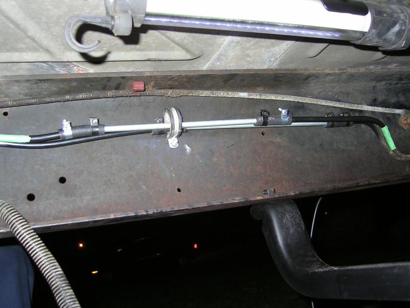

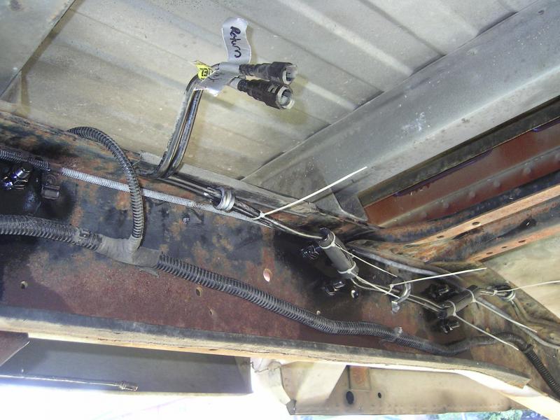

The nylon fuel lines were pre-bent for the clubcab chassis....but I made them work. Used a number of old heater hose zip tied to them to make sure they would not rub on anything.
Had to lengthen them 11". Staggered my cuts and used 5/16" brake line make the splice.

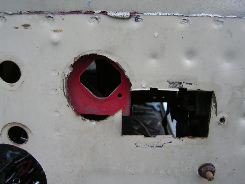

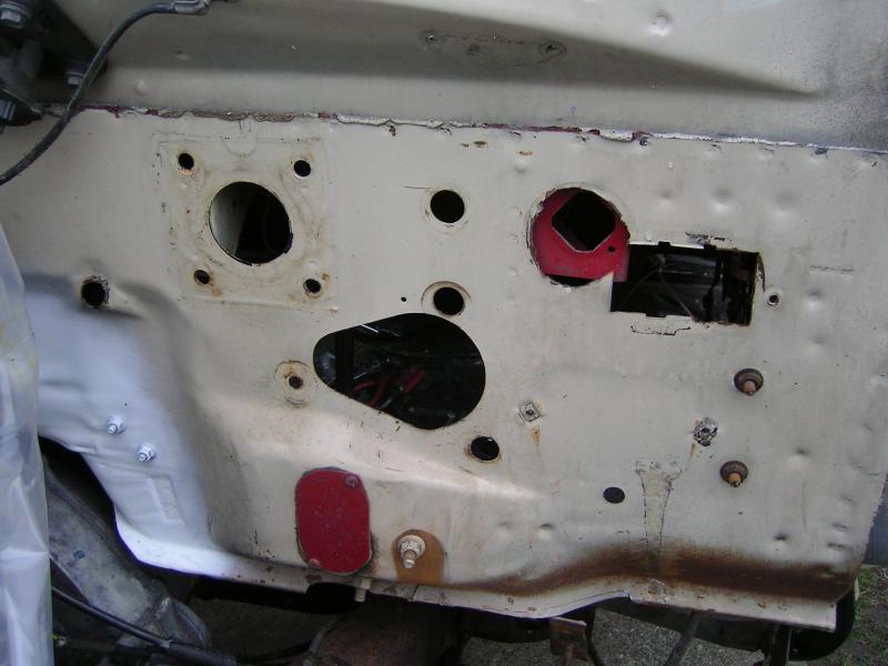

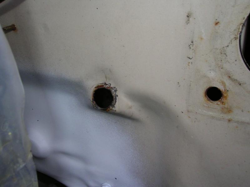

Removed all the dash cluster and wiring. Also managed to wrestle out the 7 5/16" bolts from under the window seal. Got the firewall all stripped out on the drivers side.
Man I hate people who do hack work!! Just makes more work for me to re-do it properly.

Going to finish stripping the dash out, then I can weld in new material and re-shape the holes, and add the ones necessary for the 93 wiring and such.

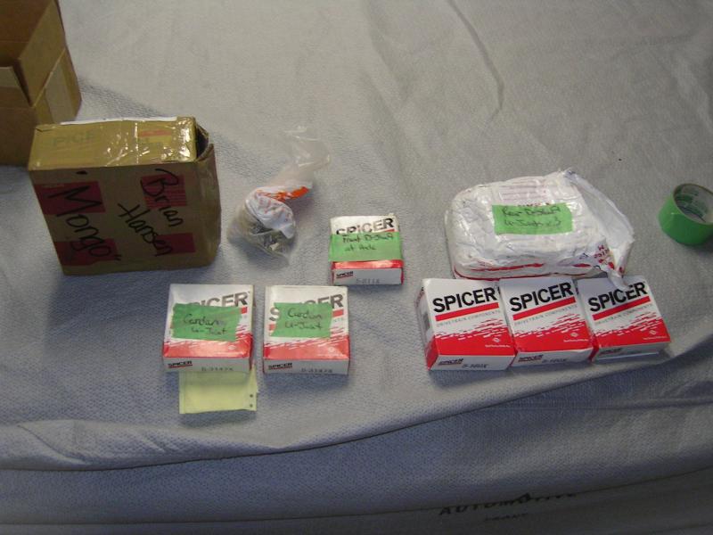

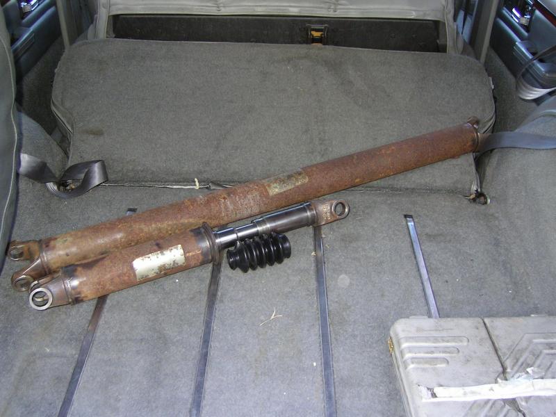

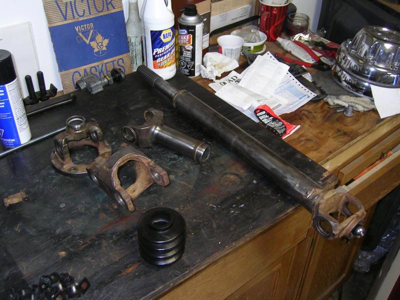

Also got my driveshafts all done. I ordered all new Spicer U-joints, Cardan joint rebuild kit, and carrier bearing.
Dismantled everything and cleaned it all up the best I could.

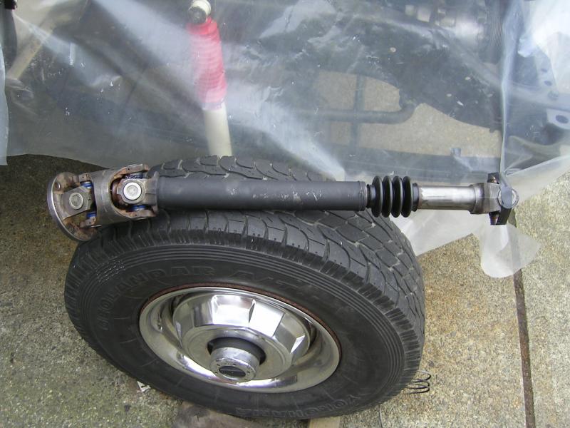

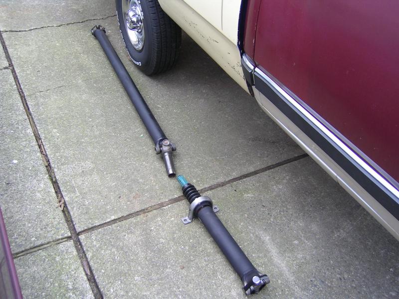

I called my local driveline shop and asked them how they wanted me to measure things. Turned out I needed 29.75" length for the front drive shaft.

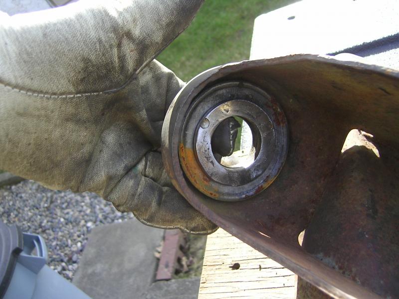

Then the 2 piece rear I needed 19" for the shaft from transfer case to center line of the carrier bearing. Then 75" from carrier bearing center line to rear axle. They ended up having to replace both ends on the long driveshaft. The bores for the cups were worn out.
They did a very nice job on everything. Not cheap getting 3 drive shafts done. Shorten front one...then lengthen both rears, with 2 new ends. But they did install all the U-joints and and hardware for free. But at least everything is New and ready for another 260K Km's....

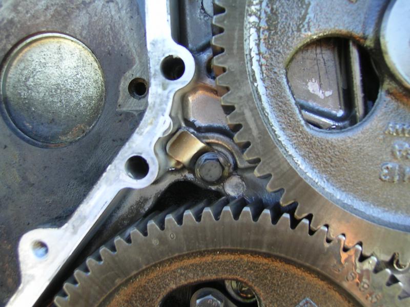

Pulled apart the front of the motor to check the KDP and case bolts. Case bolts were still nice and tight. I tabbed the KDP with an old U-joint axle strap...someone mentioned doing this so I thought I'd try it.
Little work with the rat file to open up the hole. Then cut and grind until it fit perfect.

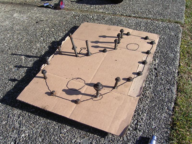

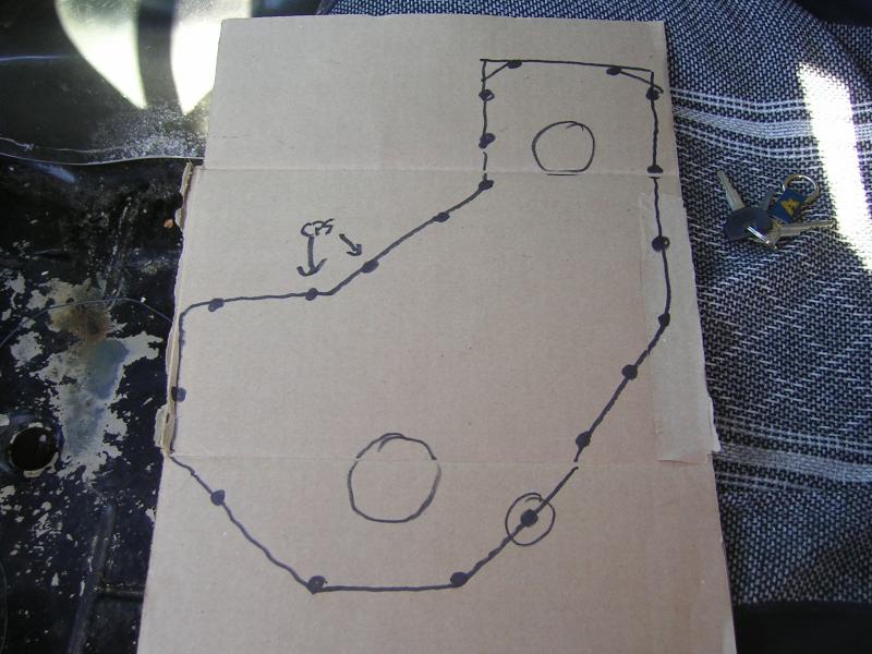

And a little trick I use to make sure I get the front timing case cover bolts back in the right location. Since there are short, and long bolts.

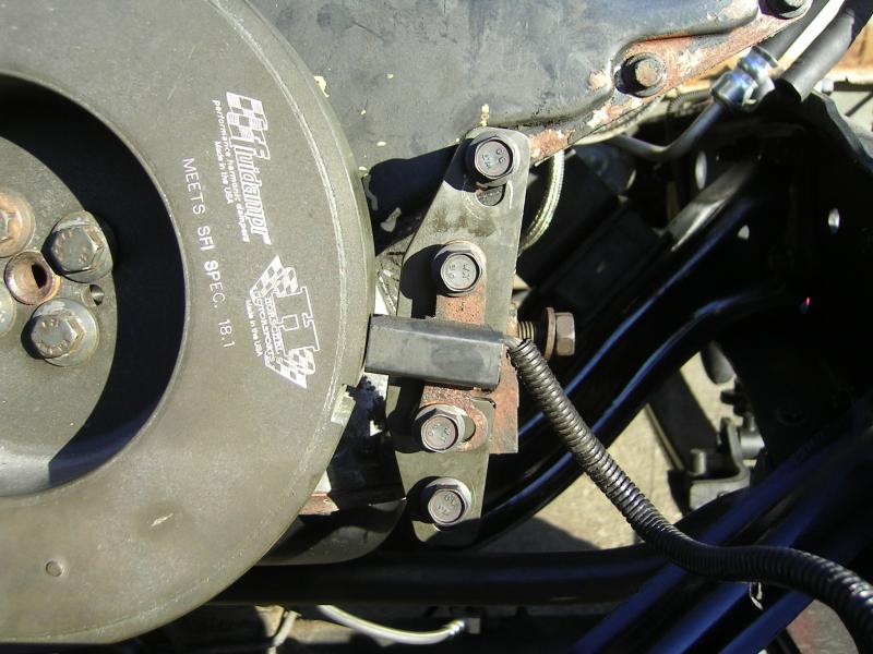

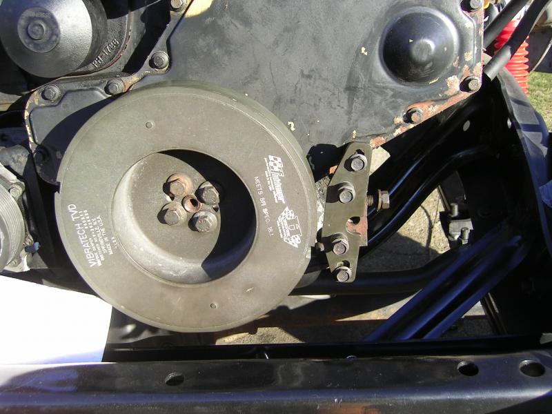

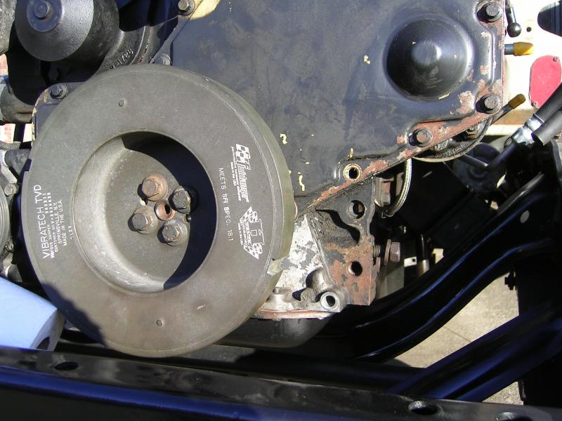

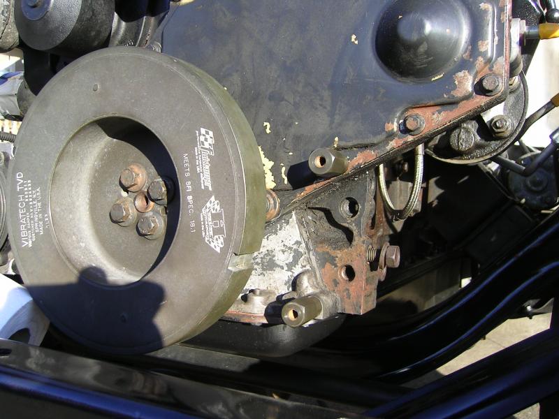

Then it was on to the installation of the fluidampr. Since this is a 93 motor I had to use the CPS relocation bracket. I looked on-line and could not find any pics of how this all went together...and the instructions that came with the kit were vague at best!
So I'll post up on what to do.
Once the timing case cover crank seal has been replaced, and the cover is back in place, you can install the fluidampr with the 4 - 15mm crank bolts. Then remove the two bolts on the lower LH side of the motor. The instructions that came with the CPS relocation kit were not very clear here. These are the ones you need to remove.
Then install the new spacer/bolts. These are 19mm.
And now the main bracket.
Old Feb 7, 2014 | 01:35 AM
  #507

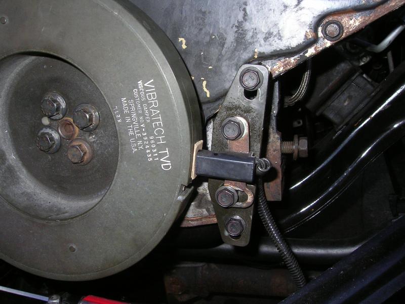

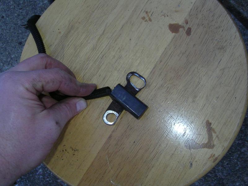

Now it should have been easy and just re-install the Crank Postion Sensor (CPS) and adjust the gap... 0.049 to 0.051, and your done. Nope not for me!
Turned out the CPS I have on my motor is a little different. I tried every way possible to get things to line up. I was just not able to get any clearance between the CPS and the fluidampr.
Turned out that after searching pics on-line I think the mounting bracket changed at some point.
Here's my CPS and bracket....after my modification with the rat file.
And I was finally able to get my .050" air gap.

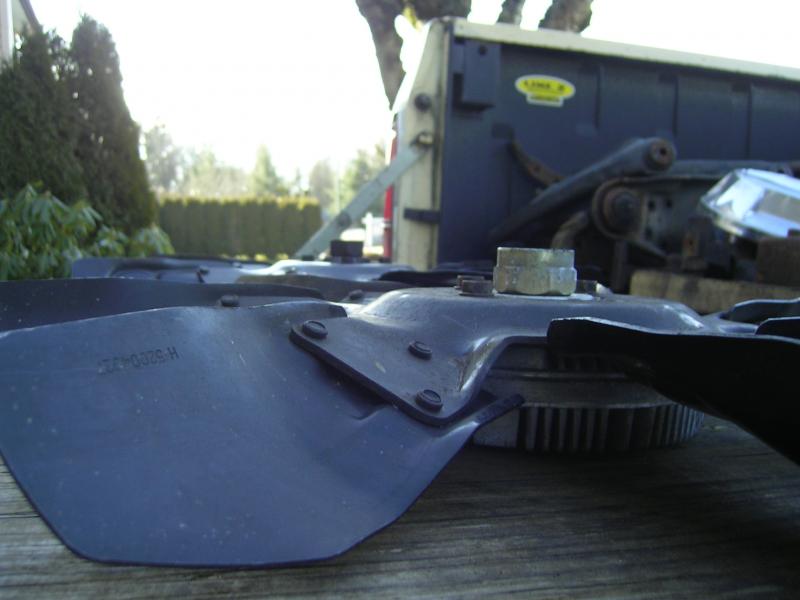

If your installing a fluidampr on a non-IC motor (89, 90, early 91) then you should be OK with fan blade clearance, but double check first. On the 91.5 to 93 motors you are more then likely going to have clearance issues between the fan and fluidampr.
I had a new fan from a 2nd Gen on my 89 motor, with a new clutch assembly. I decided to compare it to the original assembly I pulled off the 93 motor. Turned out the fans are the same, but the clutches are a bit different.
but the distance between the end of the clutch bolt, and the body of the fan was different. The OEM 93 unit was a tad longer then the 2nd Gen fan and new clutch. The difference was about 0.20" longer for the 93 clutch.
So I swapped the fans around and used the OEM 93 clutch.

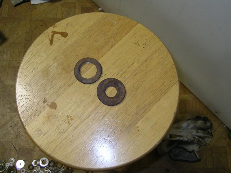

So I first modified a washer that was about 0.125" thick. Wish I had a milling machine...I had to resort to rat files, and drum sand discs, and round flapper discs.

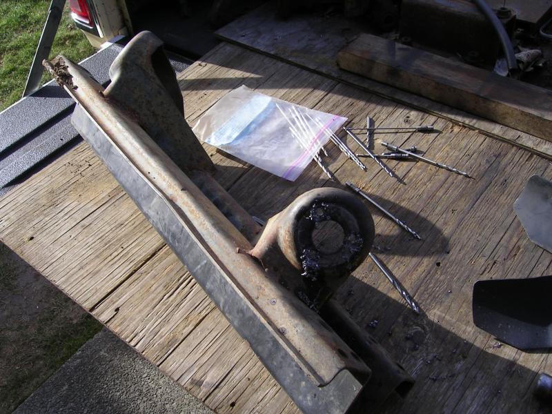

Once installed the fan was just kissing the fluidampr. So I needed a thicker washer. I found one spot welded to the old 2wd front cross member from the crewcab. Had to drill out 3 spot welds.
Then used a 60 grit flapper disc on my 4.5" grinder to slowly turn down the outside diameter....You can see it was a fair amount!!
This washer was about 0.20"...and was perfect!!
