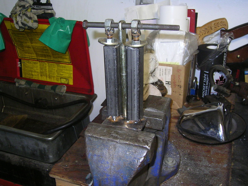

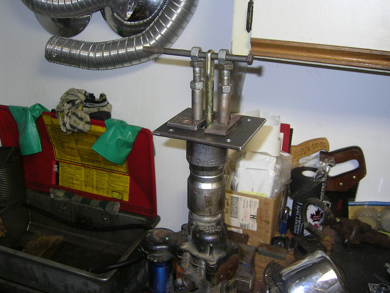

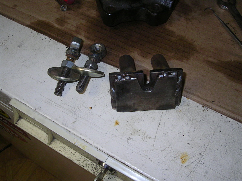

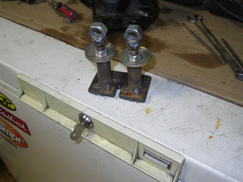

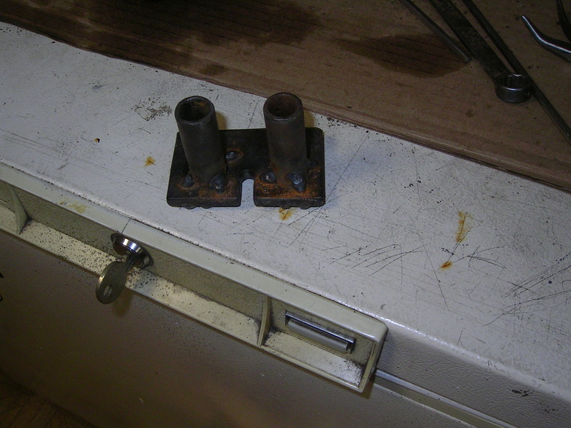

And I decided to make the proper push rod puller. Spent a couple hours putting this together. Thanks Mark (MKnittle) for the pics on building this baby!
And thought I'd pull the 2nd Gen pushrod properly from the broken piece, as a trial run on the new puller. Due to the super long push rod I had to toss on a couple pieces of 1" box tube as extensions.....puller worked like a charm!

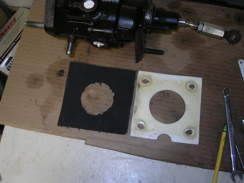

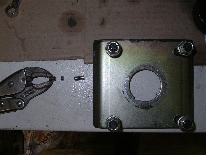

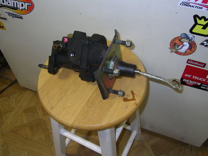

First off I wanted to use as much of the 2000 Cummins system I could, lines included. But did not want the big firewall bracket. The Astro Van unit provided the perfect swap since it's firewall bracket is a direct swap onto the 1st Gen firewall....no mods required (if you use all GM stuff)....almost.

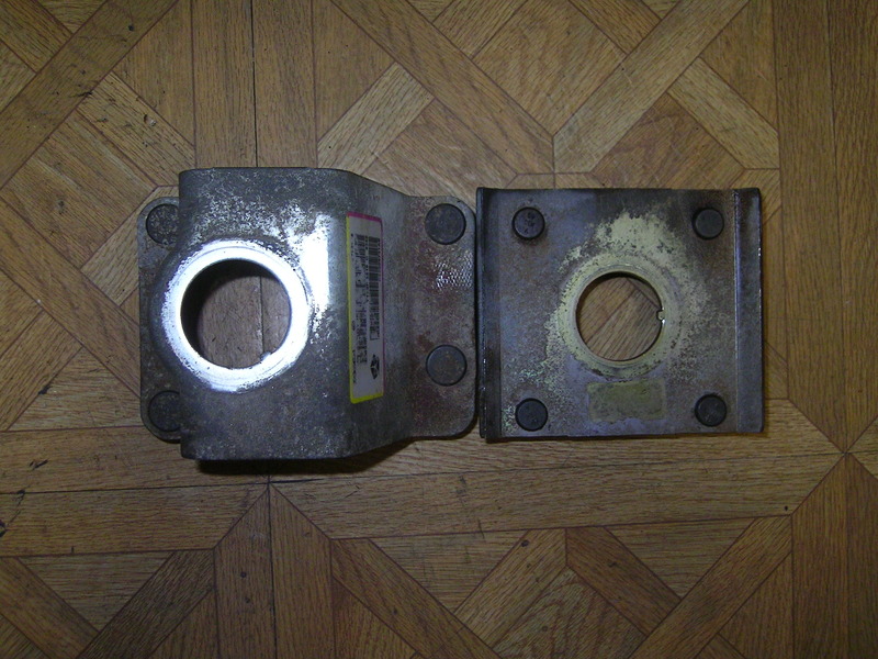

Since I wanted to use the Dodge assembly I had to alter the alignment if the HB unit, since Dodge uses a master cylinder adapter bracket the turns the HB about 45* clockwise.
Dodge vs Astro Van.....you can see the alignment tab location differs.
And my solution to the alignment.
I measured everything out and located where the new tab would be located on the Astro van bracket. I was going to weld up the area then hand file it to fit, but once I started removing some material for the weld to bite into I noticed that perhaps there was another way.
I put the bracket on the tailshaft and noticed that perhaps I could use something as a keyway? Started wandering around the shop and came across some roller bearings from either my NV4500 or NP205 rebuild. Tried one and it fit perfect, just had to cut it to length!

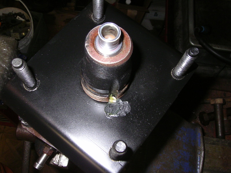

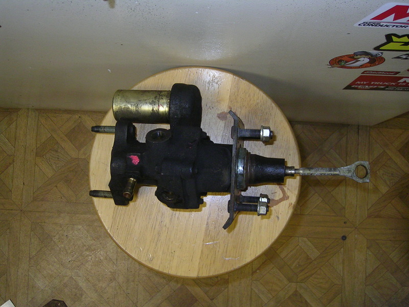

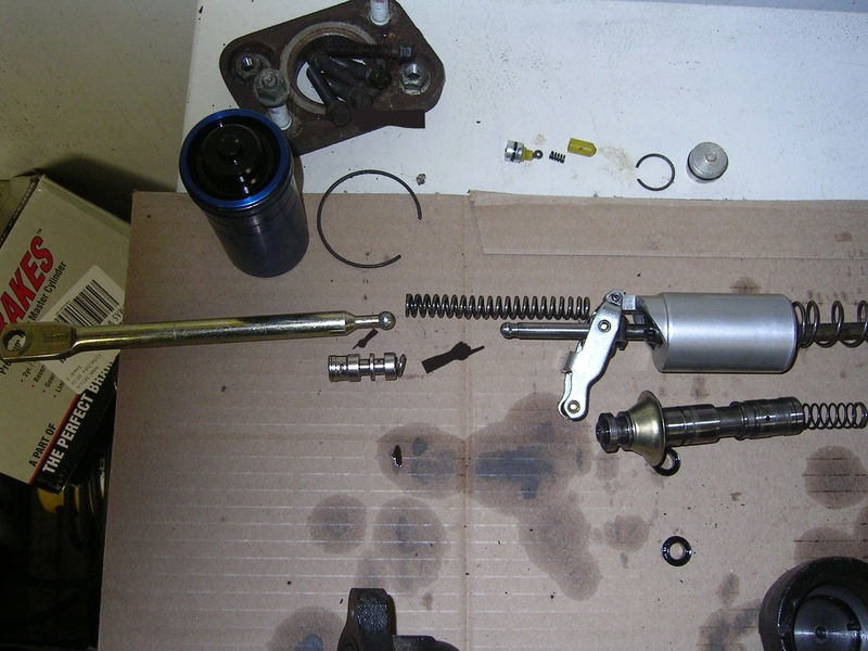

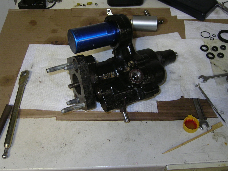

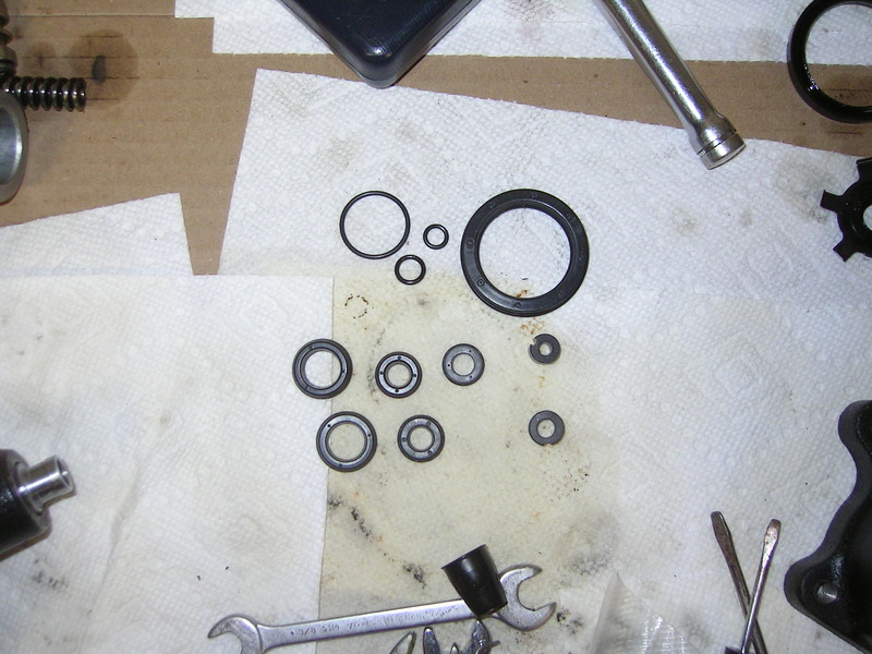

Then it was rebuild and reseal time. I won't go into what I did to redo my HB unit...since I followed this thread to the letter.
Hydroboost reseal tutorial (long)
Follow this one and you can't go wrong.
All done...
I purchased a re-seal kit from E-bay seller "Pirate jack" part # 2771004X or 2771004. You'll have a few O-rings left over from the rebuild.

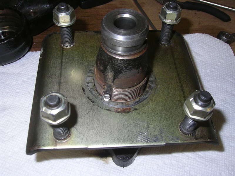

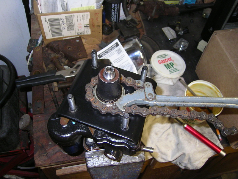

And installing the firewall bracket.
And how do you tighten up that 4 sided nut....I used brass punches and a hammer to get it loose, but this wouldn't work to tighten. Finally came across my grandfathers old chain wrench...worked like a champ!
Highly recommend this for removal, and installation of that nut.

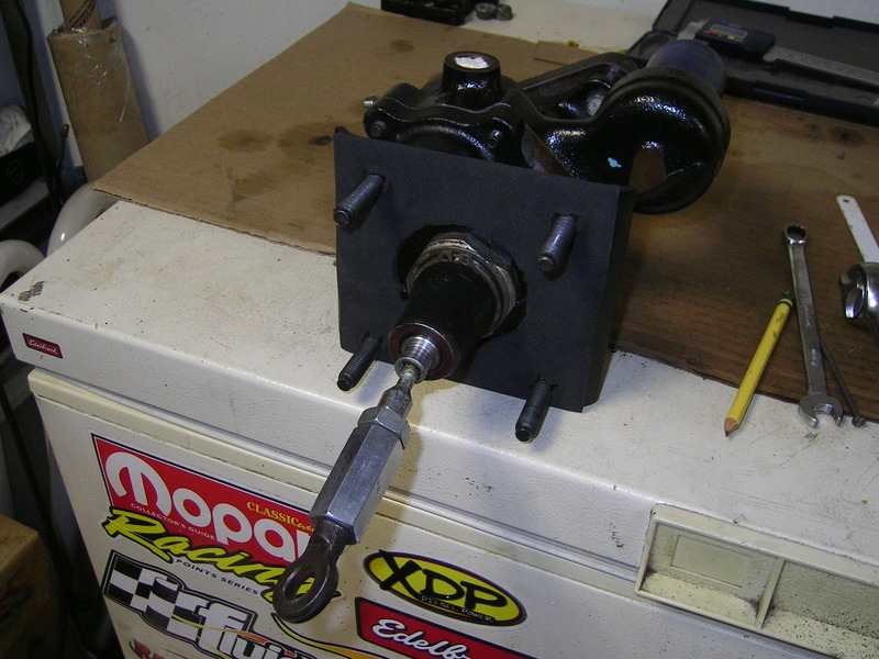

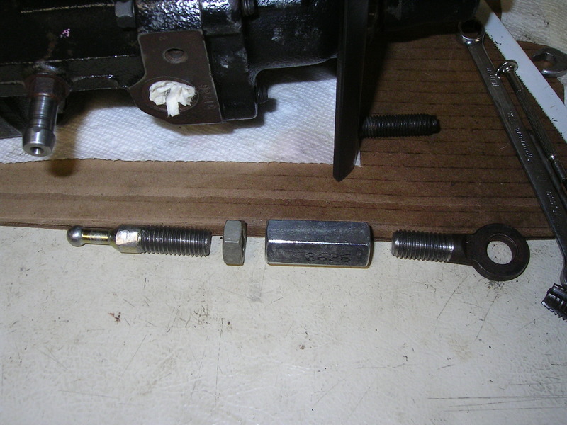

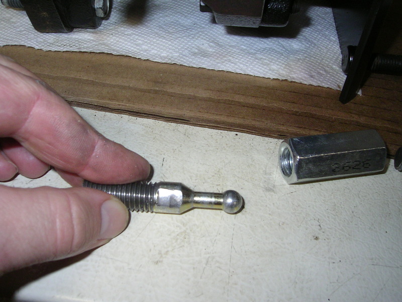

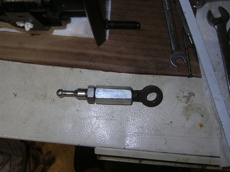

Then all that was left was to make up an adjustable pedal to HB pushrod. I took the ball end off the dodge HB, and cut off the push rod from an old vacuum booster. Then cut each to about 2.35 inches in length, and then threaded each 1/2 x 13 NC. Got a coupler and a jam but and was done.
I also filed two flat sides on the dodge ball end so I could use a crescent wrench to hold it while working on things.

Then used a big rubber hammer to band the pushrod back in. Used a flat chisel and a block of wood to re-stake the push rod.
