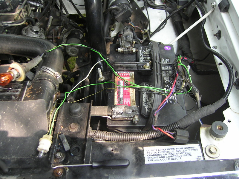

My left turn signal bulb in the dash popped on, and stayed on, while I was out getting groceries. It does this if a running light is out. Checked the truck and my lower front fender side amber light was out.
Got home and popped in a new bulb...nothing. Hmmm try another bulb...nothing. Go get test light...have power to plug so should come on. Checking out the tangs in the plug and they looked a little compressed. So grab a pick and bend them out, insert 3rd bulb and still nothing.
OK now I'm getting cheesed. So go grab a couple alligator clip jump wires. Test all three bulbs...only one was working. OK put working bulb in again, still nothing. Decided to test connectors while bulb is in socket. Had test light on the ground, and had power on one side. Then switched test light to positive, no ground coming into bulb.
OK so I probe the wire on the outside of the connector....still no ground. Now I figure it must be a bad splice or broken wire. So I start pulling the wrap off the wiring. Noticed that the front turn signal/marker bulb also used the same wires, so figured they must join somewhere and that would be where my problem was. I Got it all off all the way back to the inner fender and the big bundle of wrapped wires there...Still no splice.
I then went and got my FSM and started looking at the wiring diagrams. Appeared that there was no splice in the engine compartment. I went back out and was looking at things and then noticed that the front amber bulb was burnt out as well. I thought what would be the odds that if the front signal bulb was out, that the side bulb would not work either...well after a new front bulb the side one started working....
So there ya go folks I learned something new today, it only took me an hour or so to figure it out. Lesson learned is....if you have front side marker light out, and a new bulb doesn't fix the problem...check to make sure your front marker/signal light bulb is in good shape and working properly.

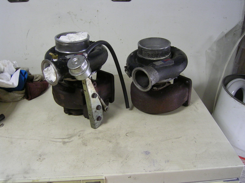

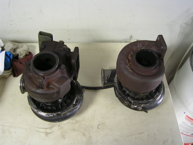

Well last night I decided to install my "new to me" turbo. It's a H1C with a 14cm exhaust housing. A generous local 1st gen owner gave it to me...Thanks Daniel!
Took about 20 minutes to pull the old turbo...then about 90 min to get the new one in and running.
Old vs new

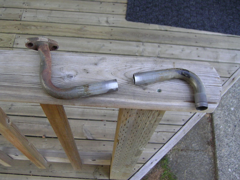

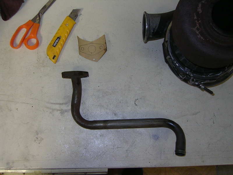

Once the turbo was in and mounted I ran into my first problem. The 1993 turbo drain would not clear the waste gate actuator. Thankfully I had a 24V unit to use. It cleared the turbo fine, but would not quite make it to the drain tube connection off the block.
24V drain tube...

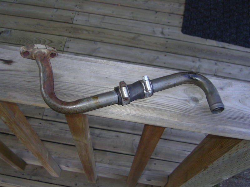

Solution for it being just a bit short, and helped with proper alignment as well.

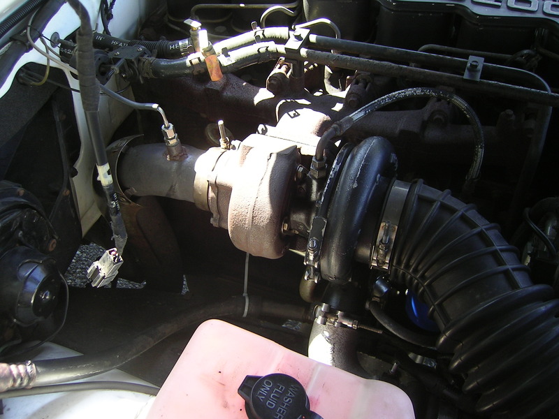

Then I had to remove my exhaust system to get everything lined up and mounted properly. That took a while. Got it running last night and went for a drive. Not as much boost as I thought it might make, but I have not touched the IP except for rotating the stock fuel pin....more fuel might help there. But it definitely spools up quicker on my shifts. Truck doesn't bog and struggle as much either.
Here is a pic of it this morning all installed....
Over all I'm pretty happy with it so far.

Wow I completely forgot that I didn't use the stock oil drain tube.. sorry for not letting you know!
Glad you're liking it so far
Edit: You might want to mess with the adjustable boost elbow, or pinch it off to test it if you're not making much boost. I made around 35 psi with stock injectors and maxed pump.
