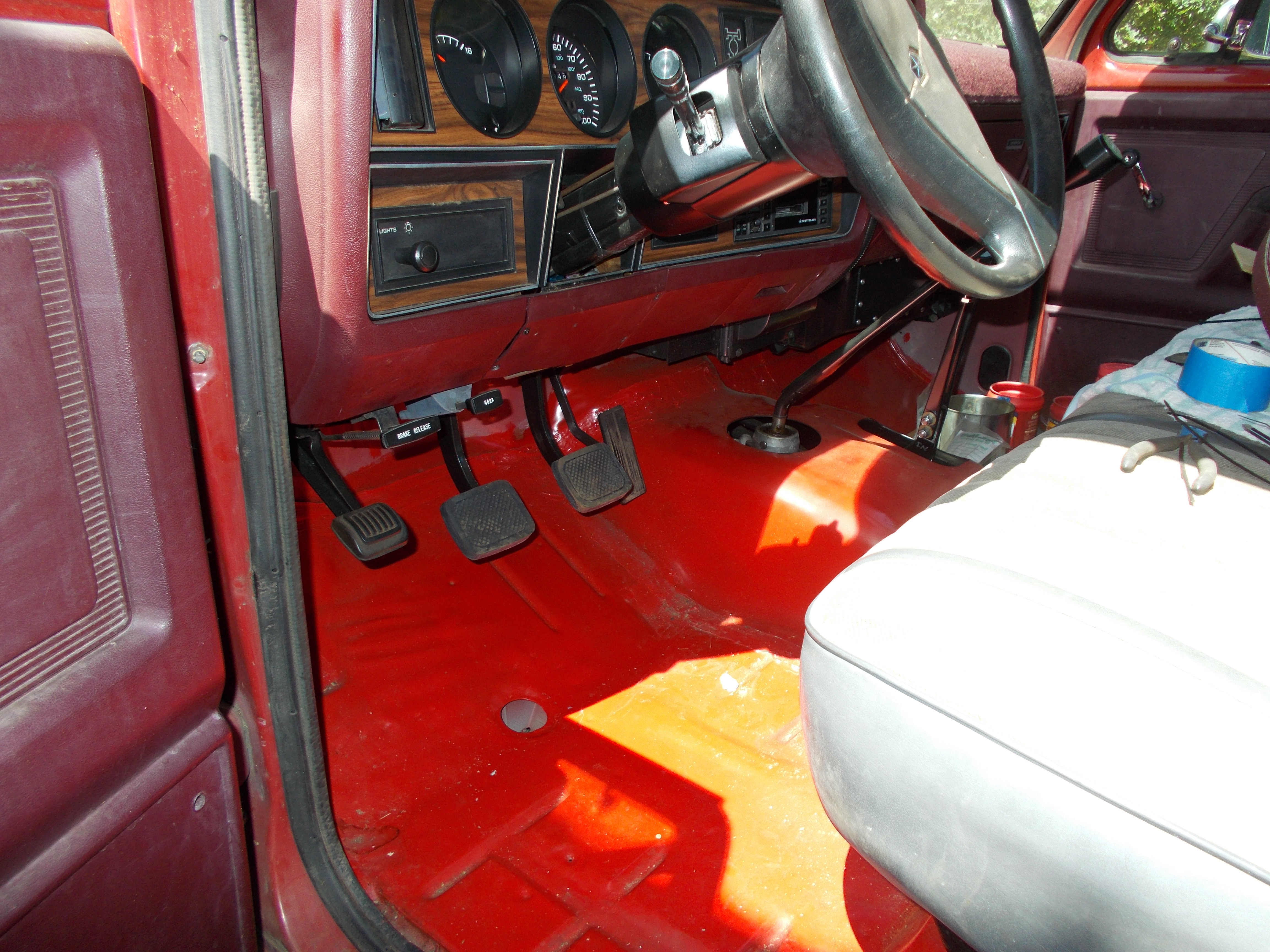

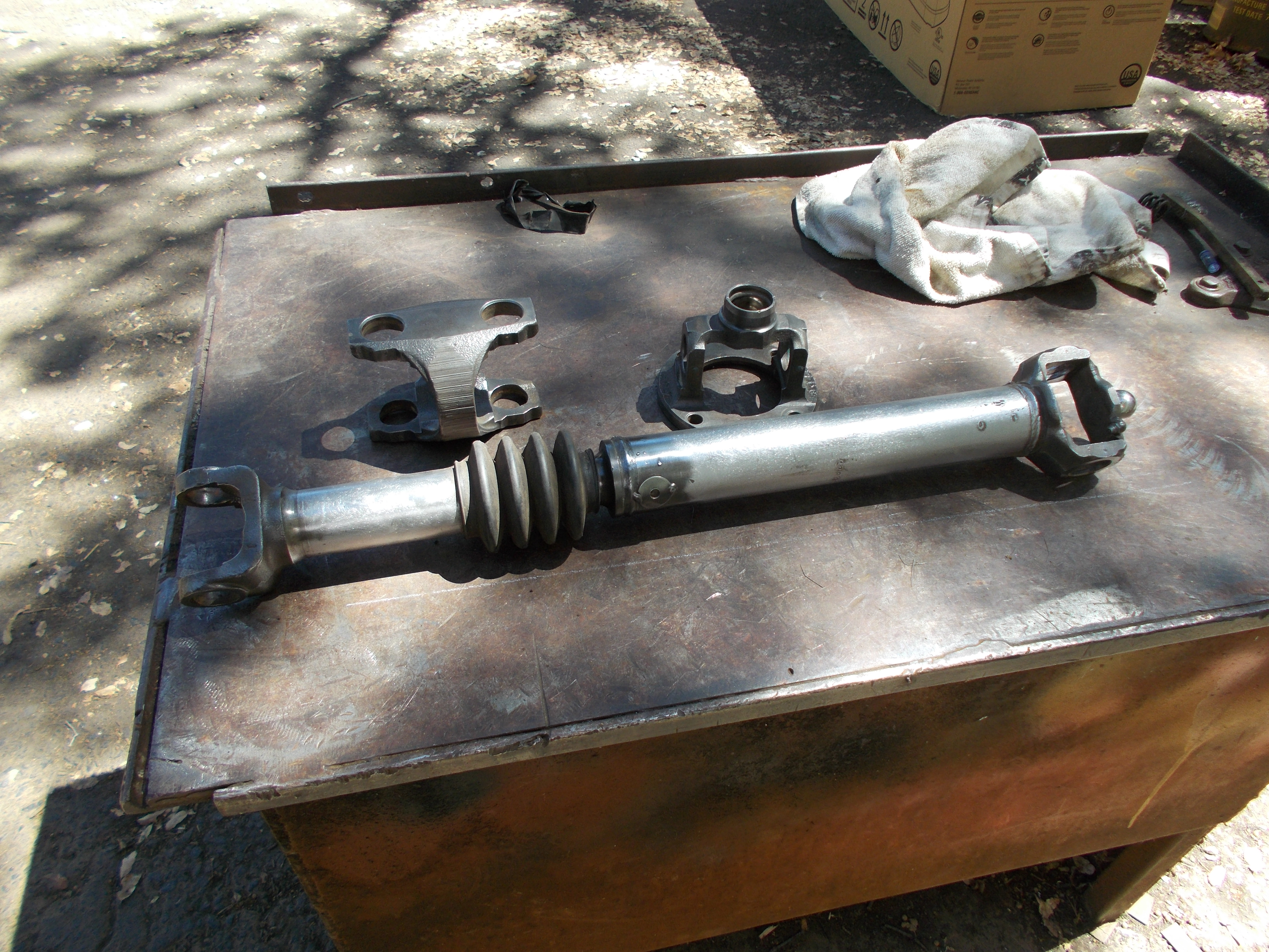

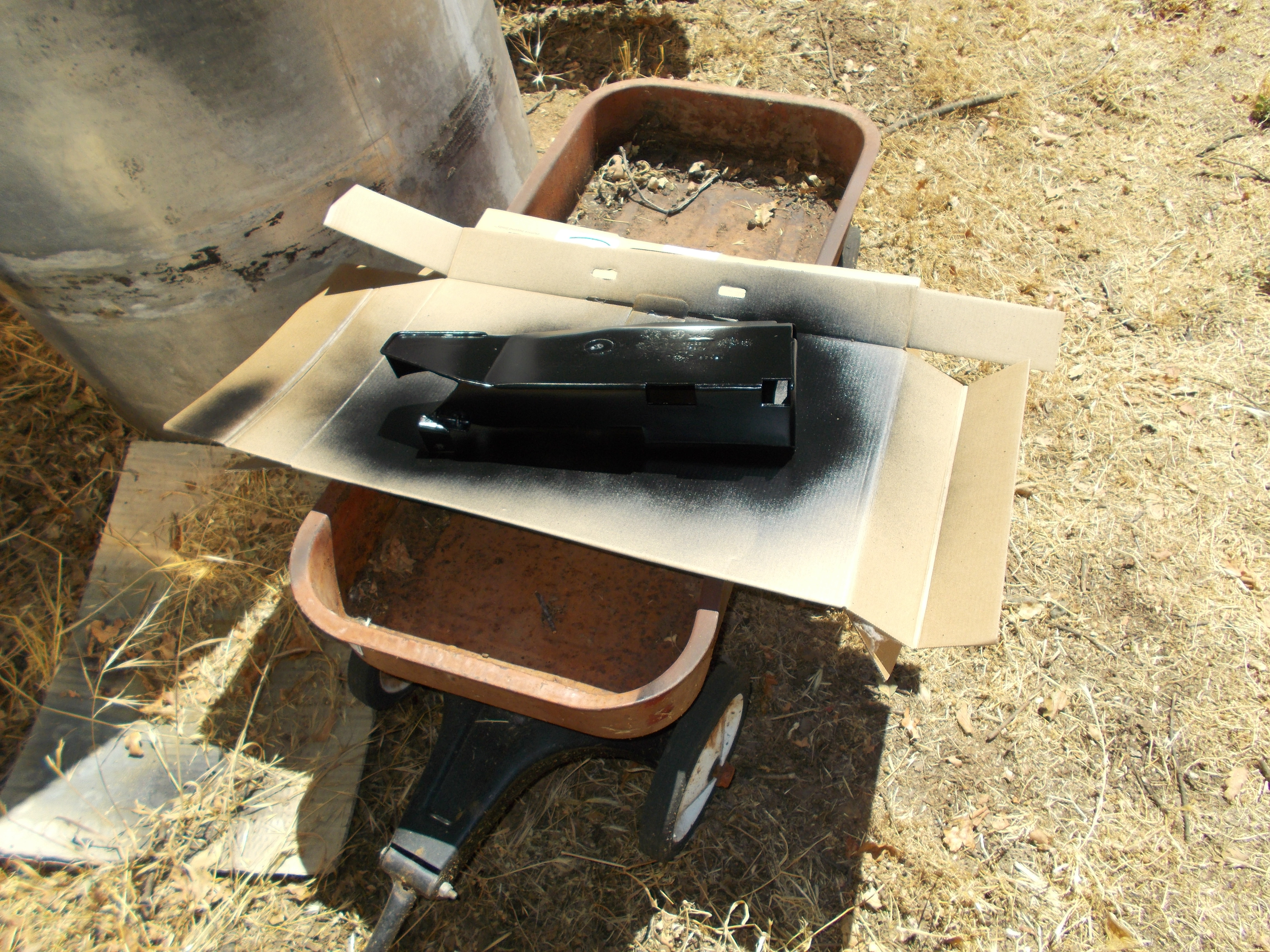

Today was a pretty good day. I got my repainted rear Ac pump bracket back on I had to take it off to get the heater hose fitting out. then I put the old fuse box cover back on (temporarily) and tied the wires up and away from the pedals. then I painted the lower air deflector for the heater/AC. After that I finished cleaning up the double cardon parts for my front driveline. that being done I decided to spend 15 minutes with the old DA and the wire wheel on the bench grinder the clean up the driveline. 15minutes because I already had the yokes cleaned up.

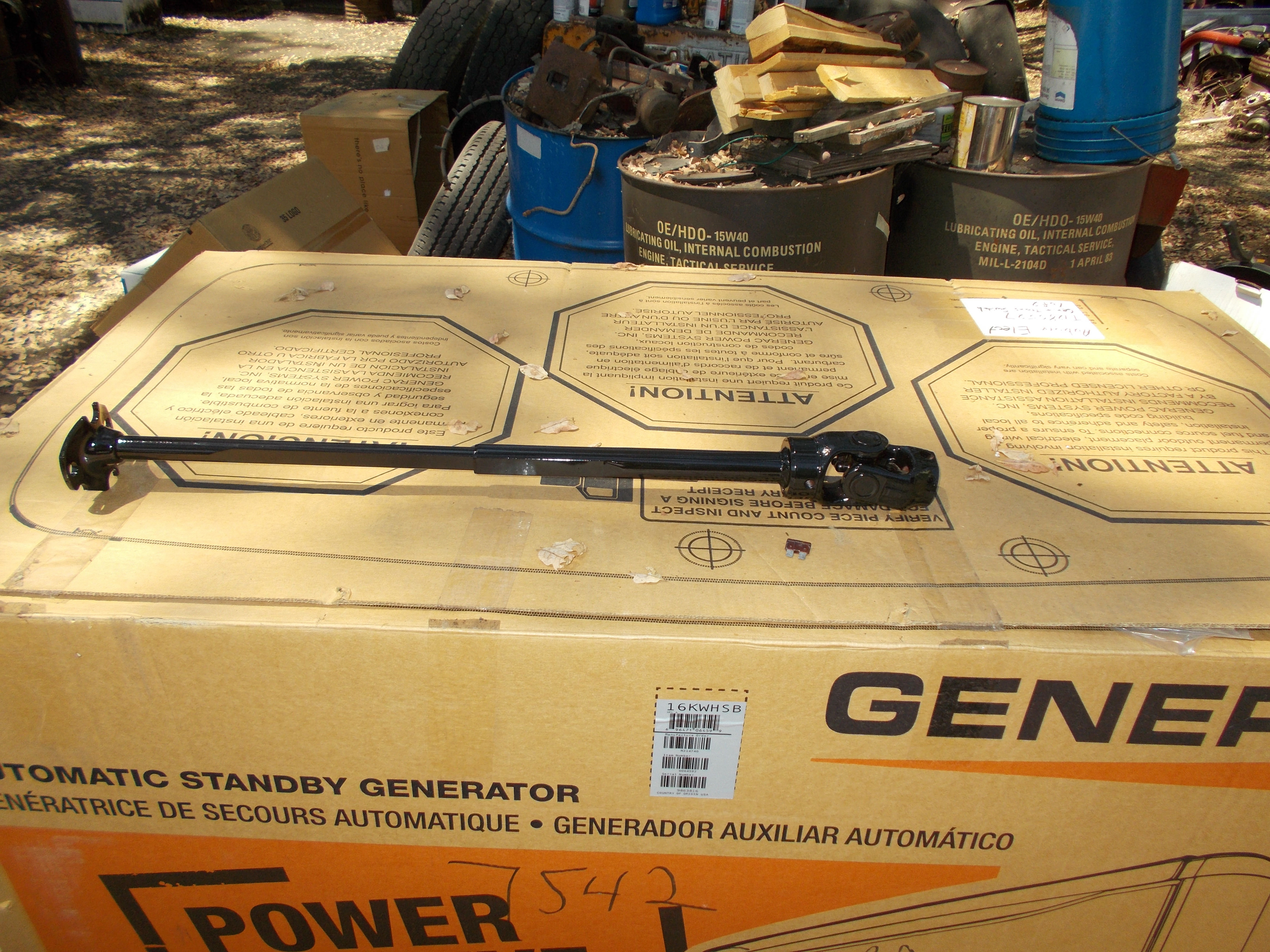

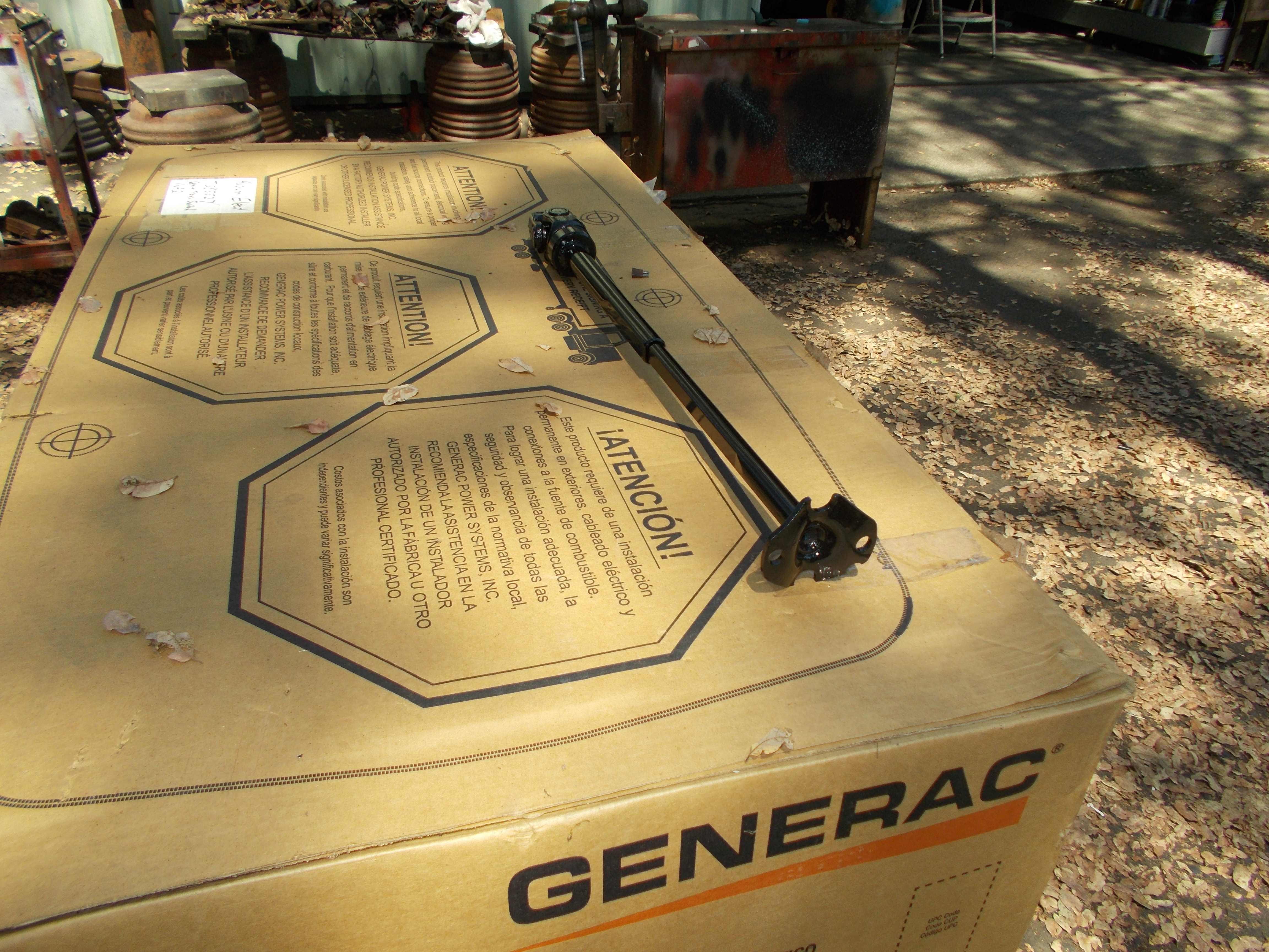

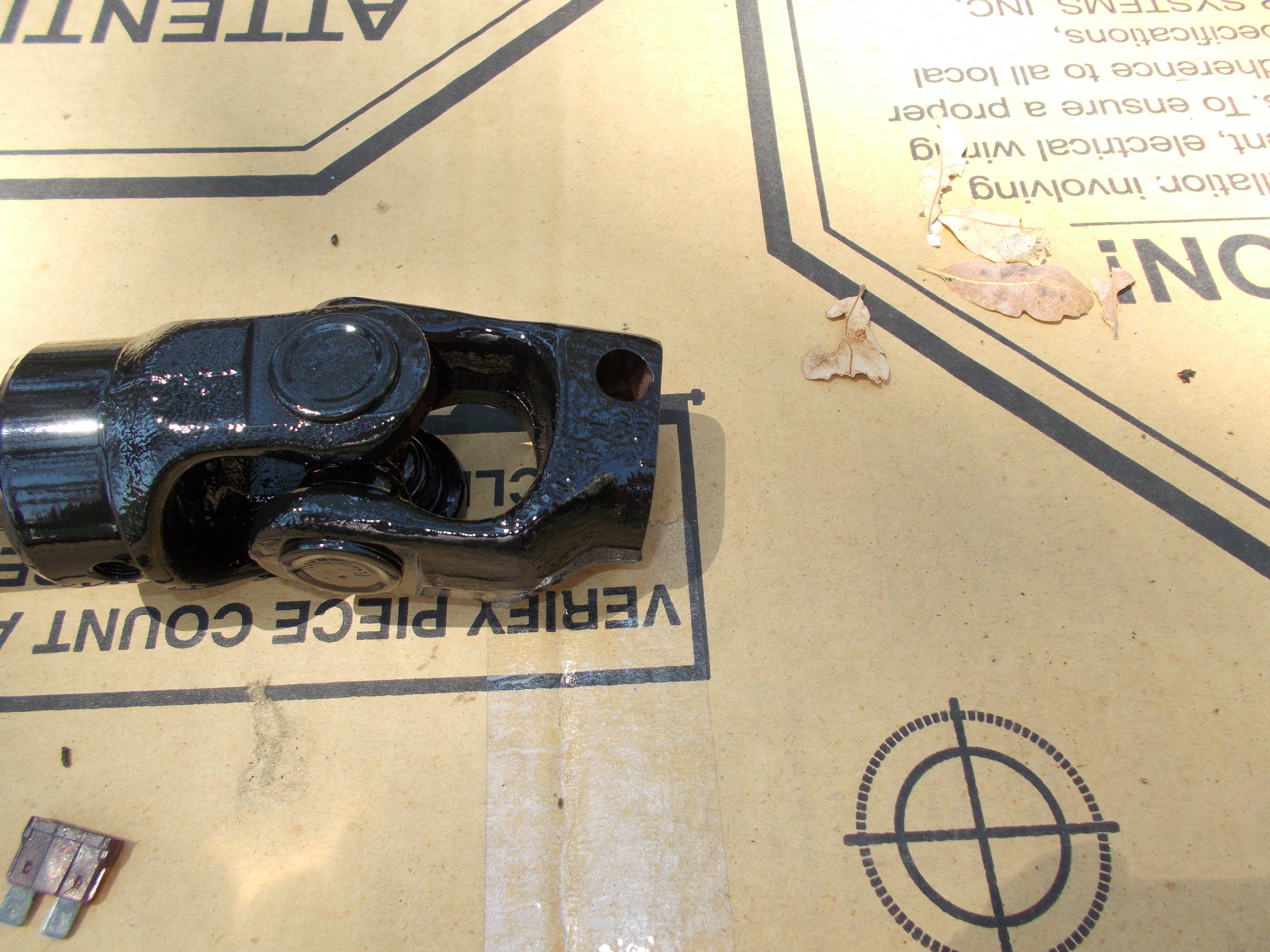

Finally got around to the last piece of my steering. I found the 13/16 splined Spicer series 1000 yoke in the pto parts box. I had to grind .150 off the front(steering gear) end to make it fit with enough clearance. The rest is upside down parts pilfered form an old GMC bread van. that way I could use parts I had. The only new part is the u-joint.

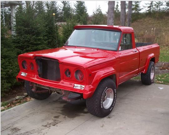

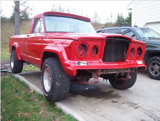

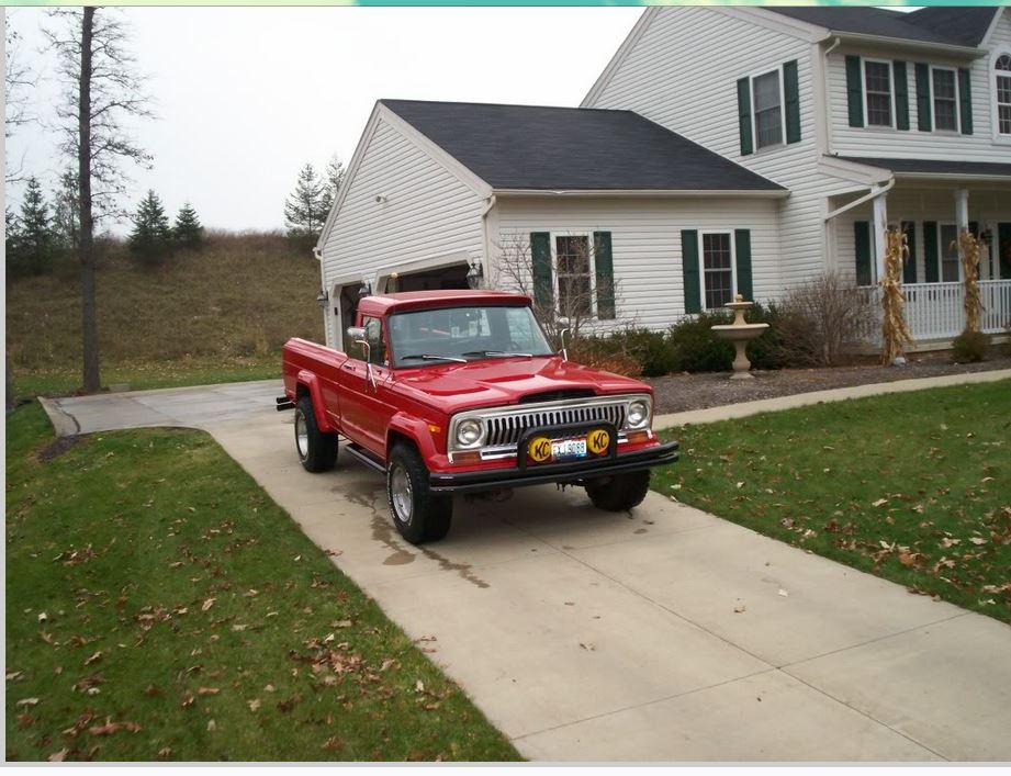

This is the color I settled on to paint my truck. Summit racing flame red.With the hood and cowl matt black.
My first thought was "Now how did he beat that Dodge sheetmetal to look like a J10?"
LOL, knowing you, you could find a way.............. Seriously, it will look good.
