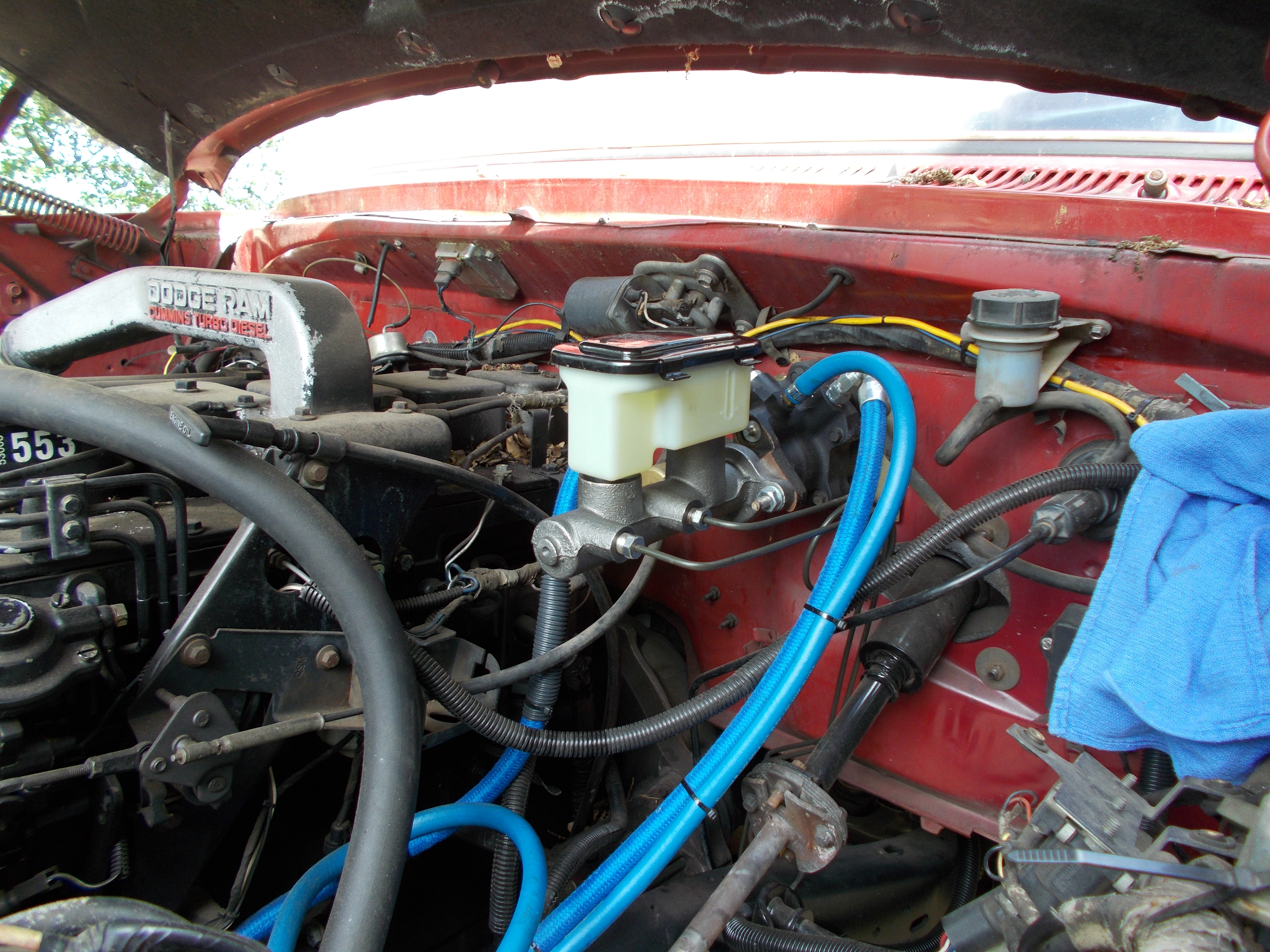

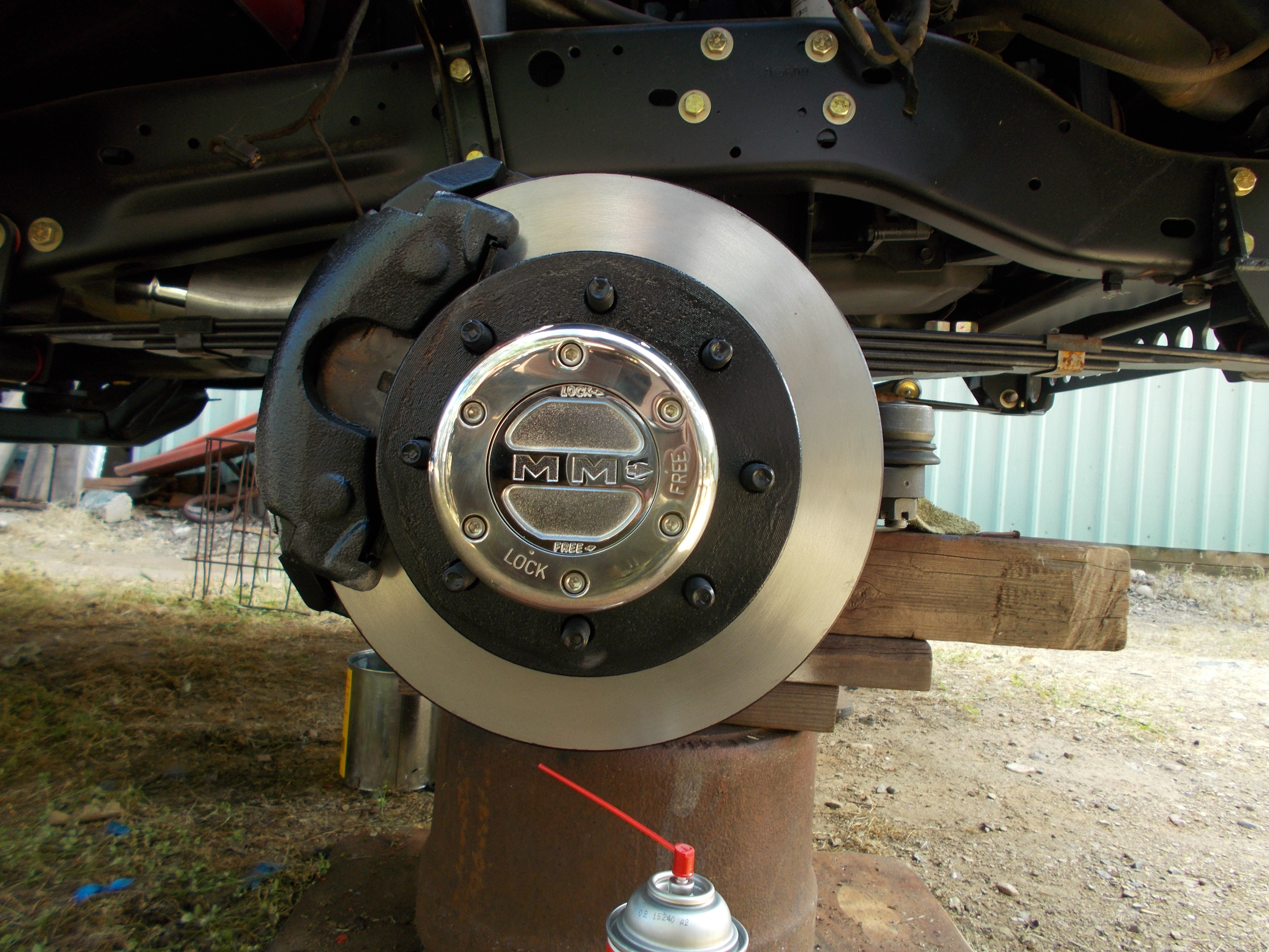

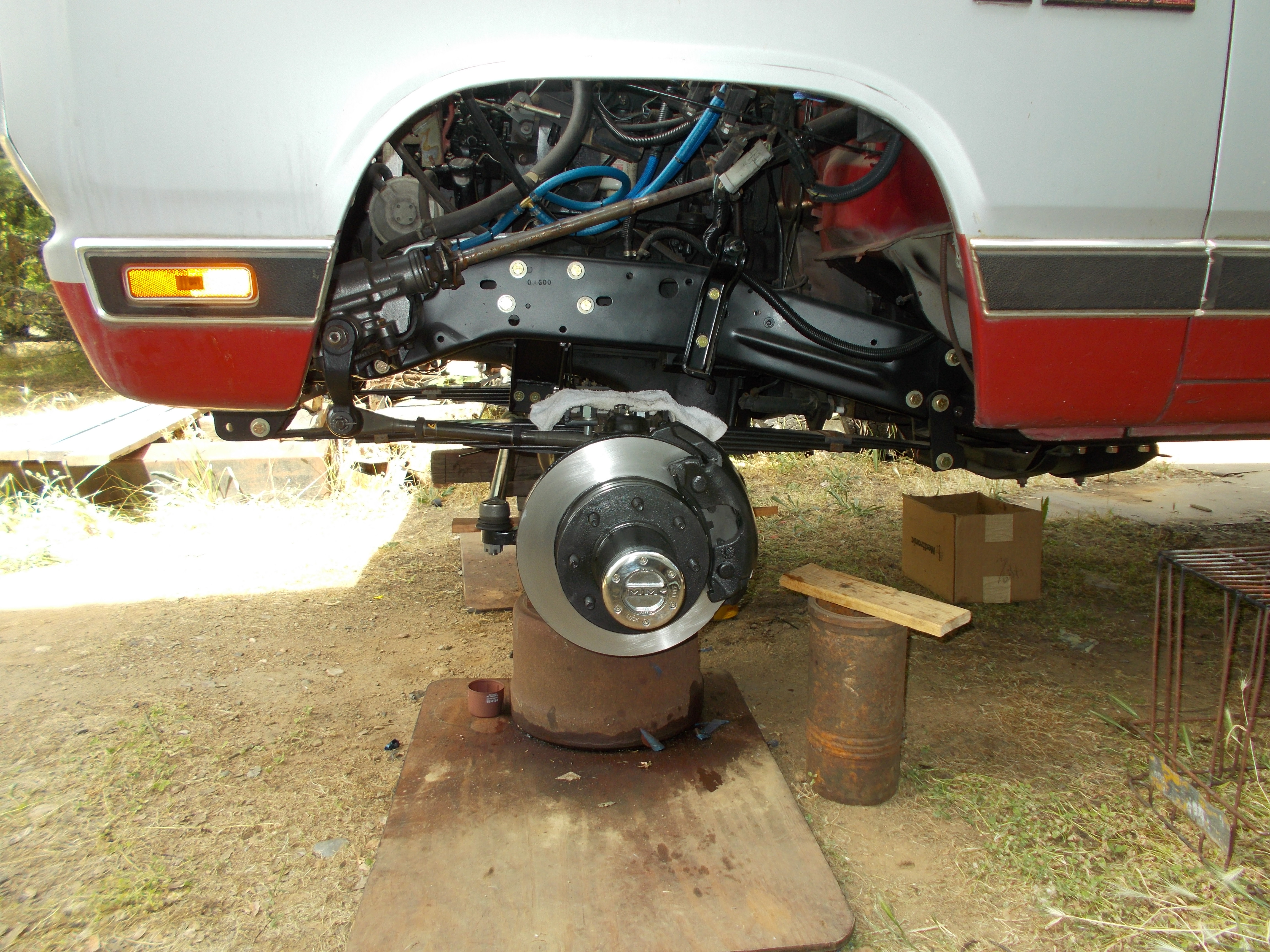

Here is where I am at now. all back together. I got the Chevy master cylinder and front brake lines plumbed and bled.

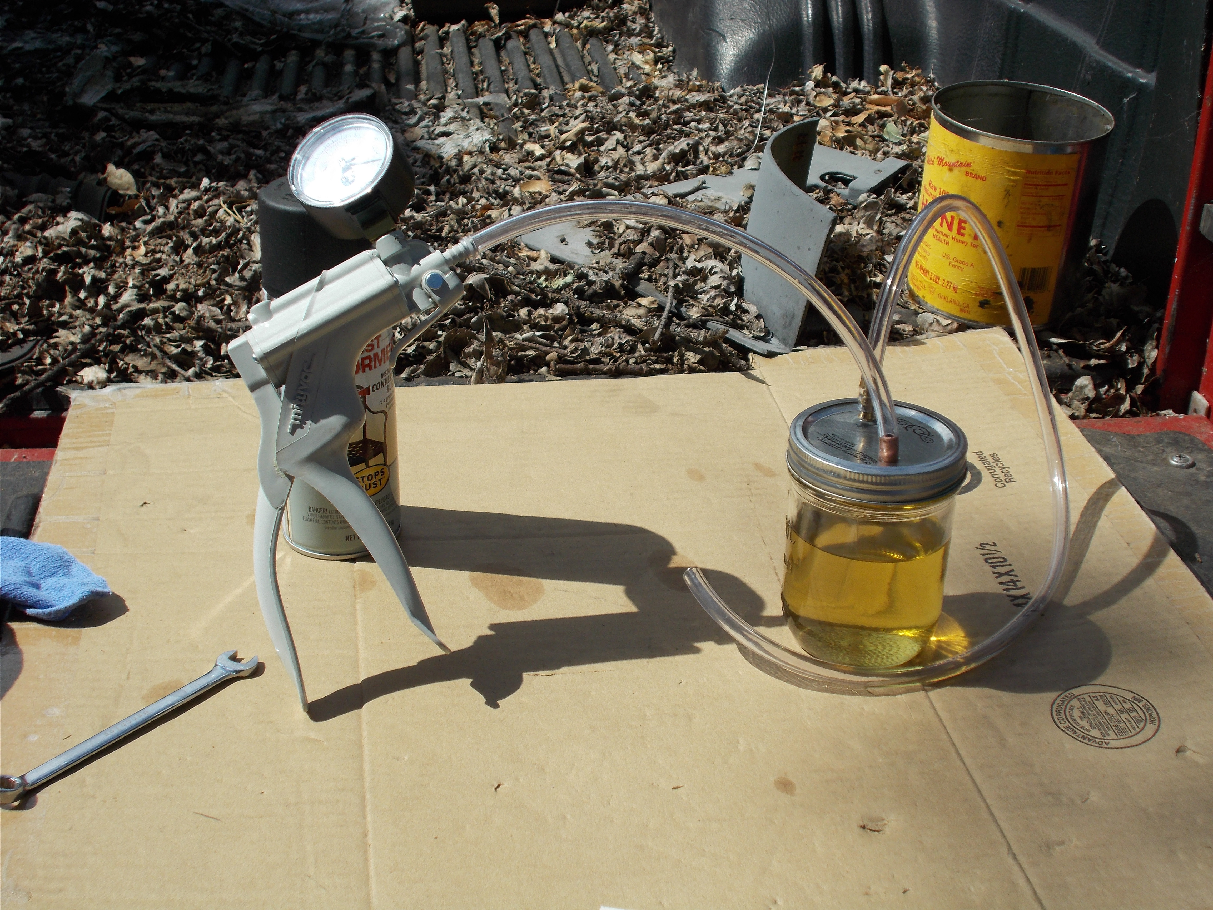

I also made a better brake bleeder for my Mity-vac. the one that comes in the kit isn't all that great. mine is a little heaver so it stays put better and is clear so it is easier to see what is happening. I think there is some air in the system so I will go back and bleed it again after it all settles down.

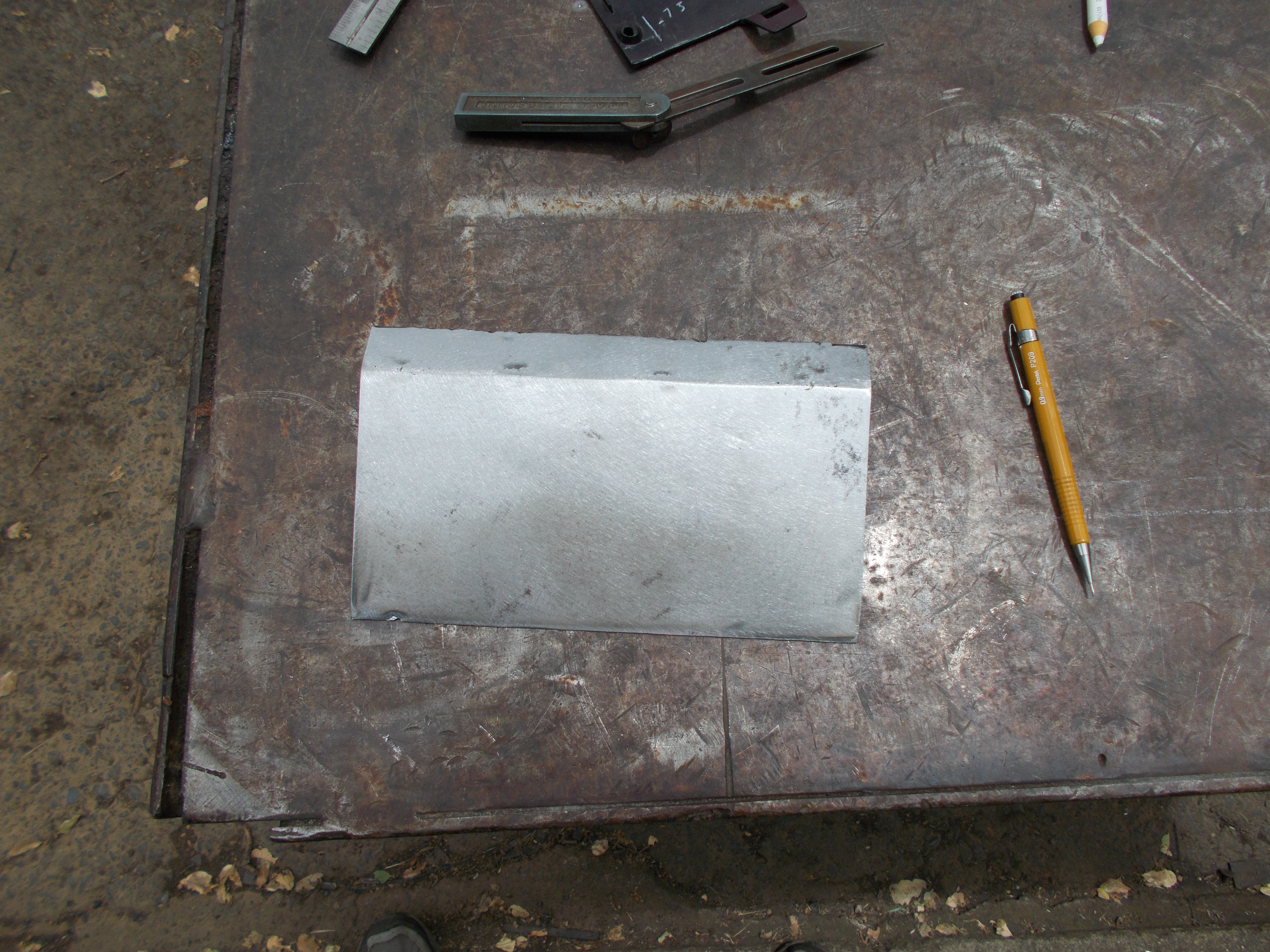

A little more for today. I have been working in this cover for a while.
It is beginning to look like it will work. It still needs some tuning and some filling.
Bear in mind that the stock one is waaaay out of wack.
I haven't figured out how to do the clip on the bottom yet. Maybe a small hinge ,remove the pin and use a small hitch pin to get the fuse box out.

I haven't figured out how to do the clip on the bottom yet. Maybe a small hinge .
Why not bend the bottom to the angle of the bottom of the dash (or add another piece to it, drill two holes, and screw upwards into the dash ends ? or some new fastening point.
That extra "bend" at the bottom would create significant rigidity in that piece of steel..
