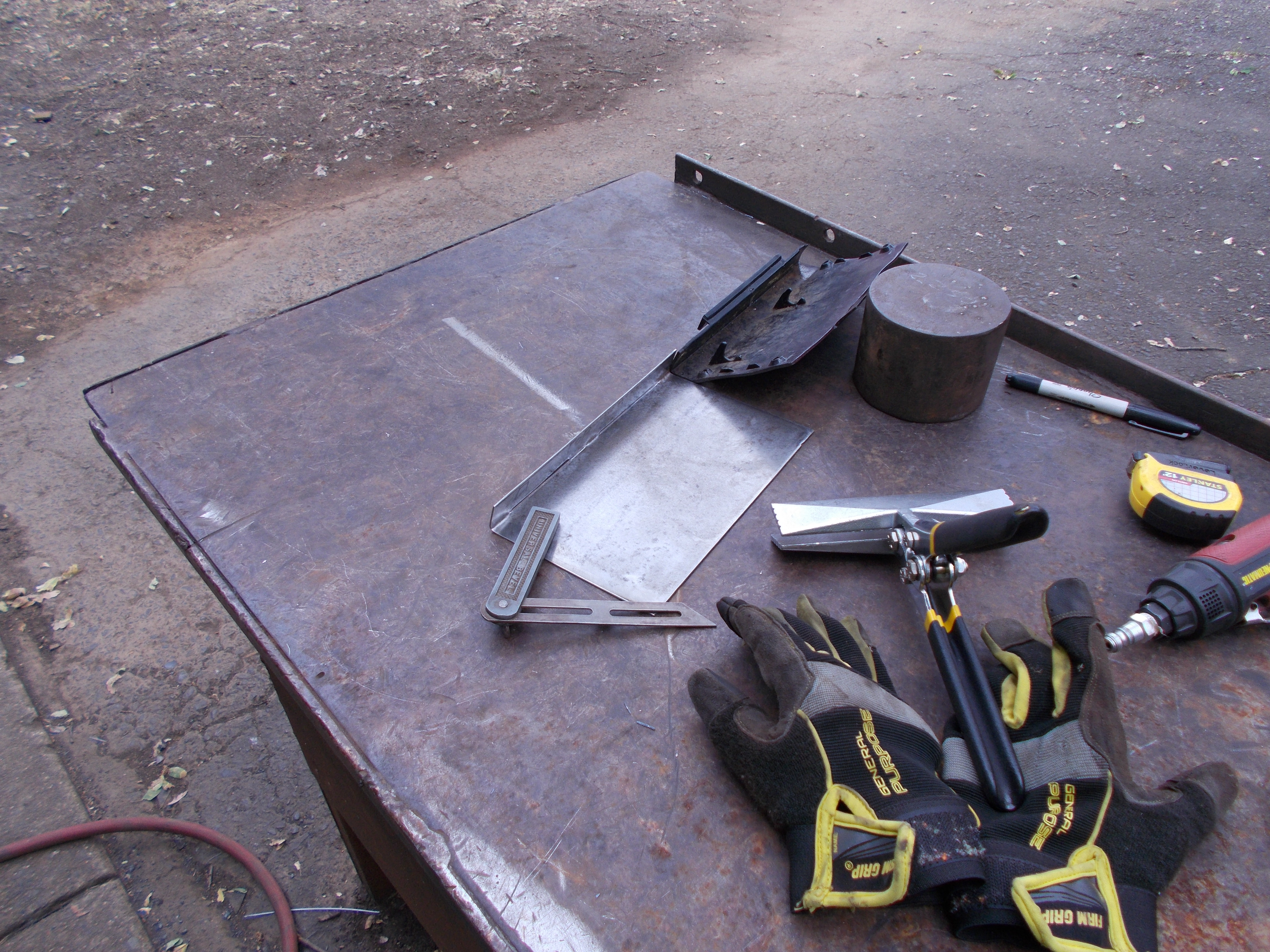

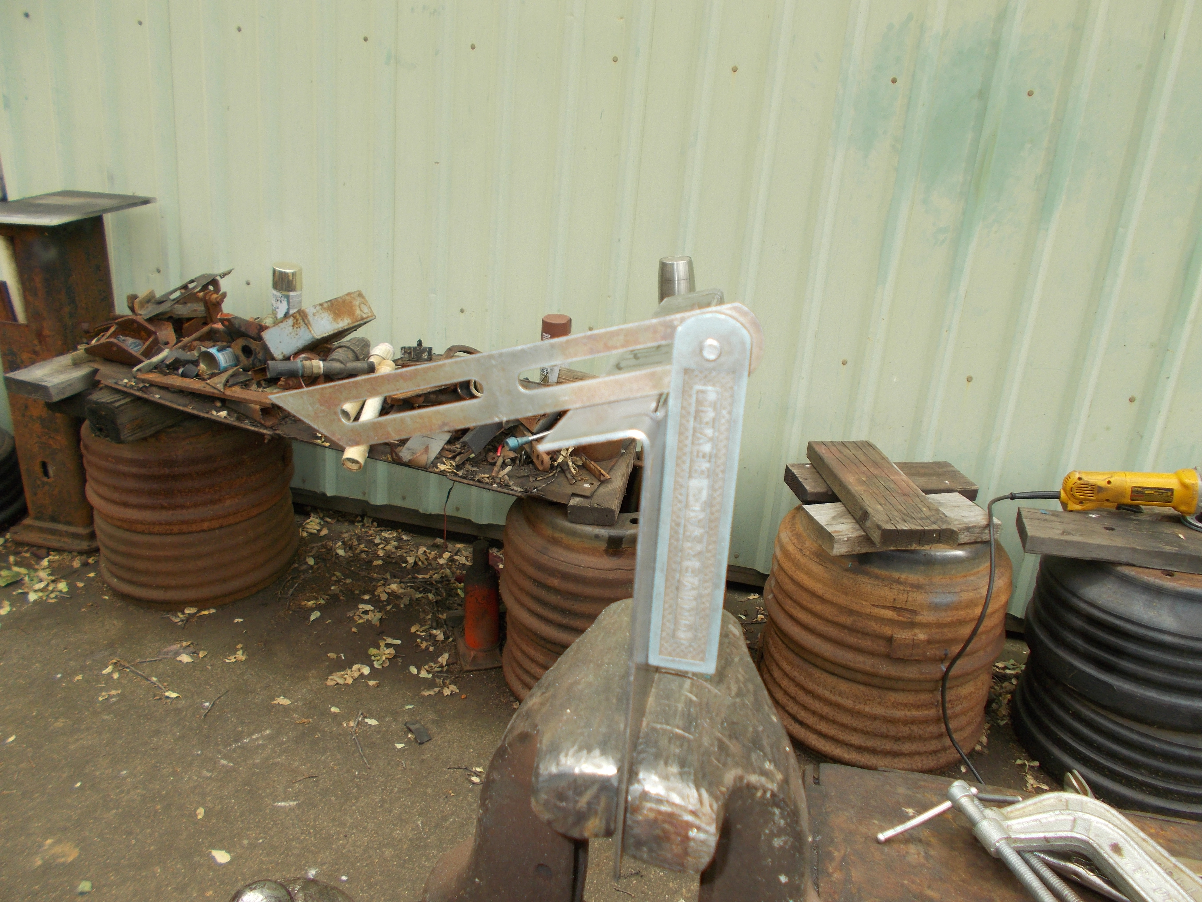

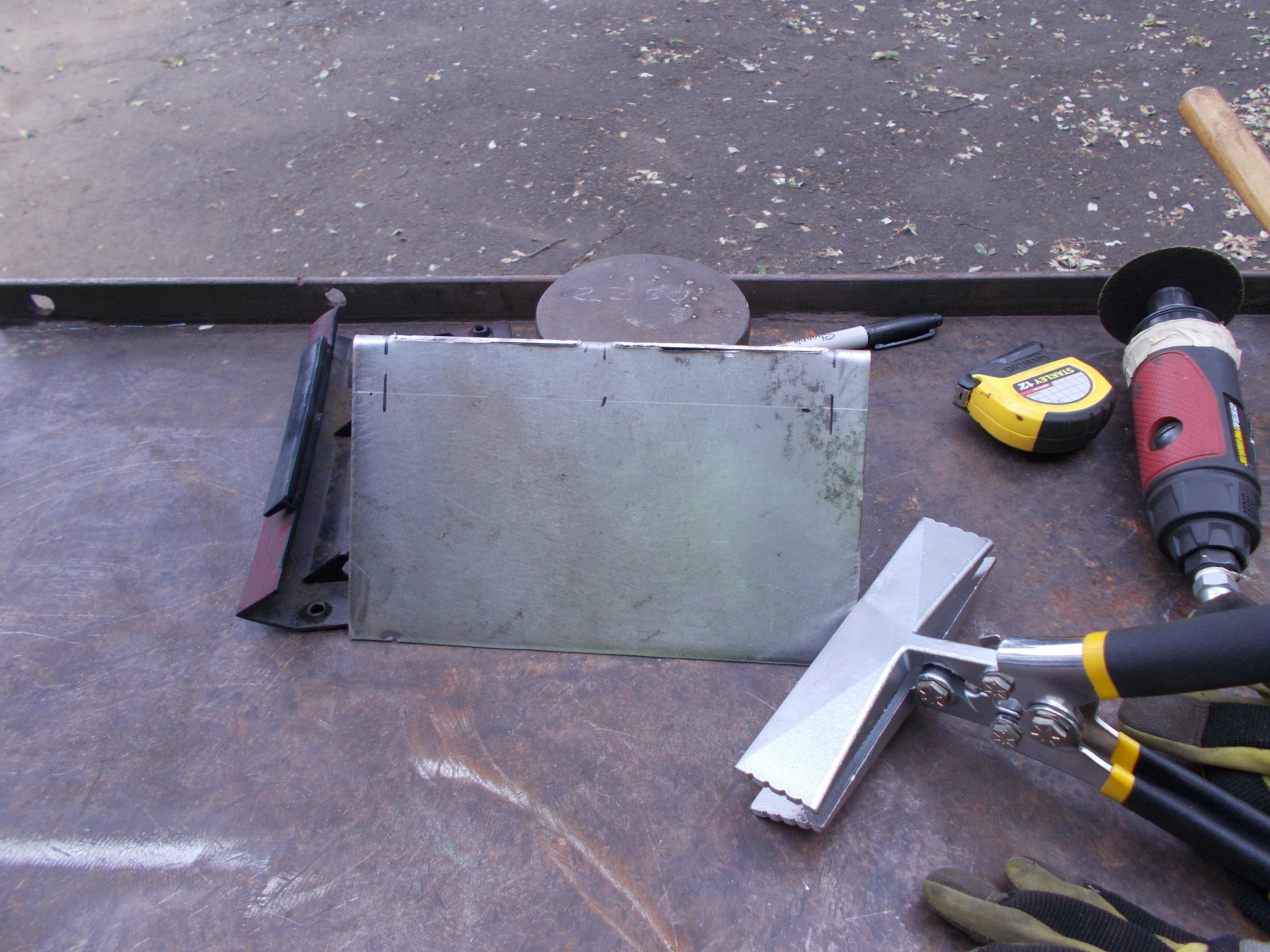

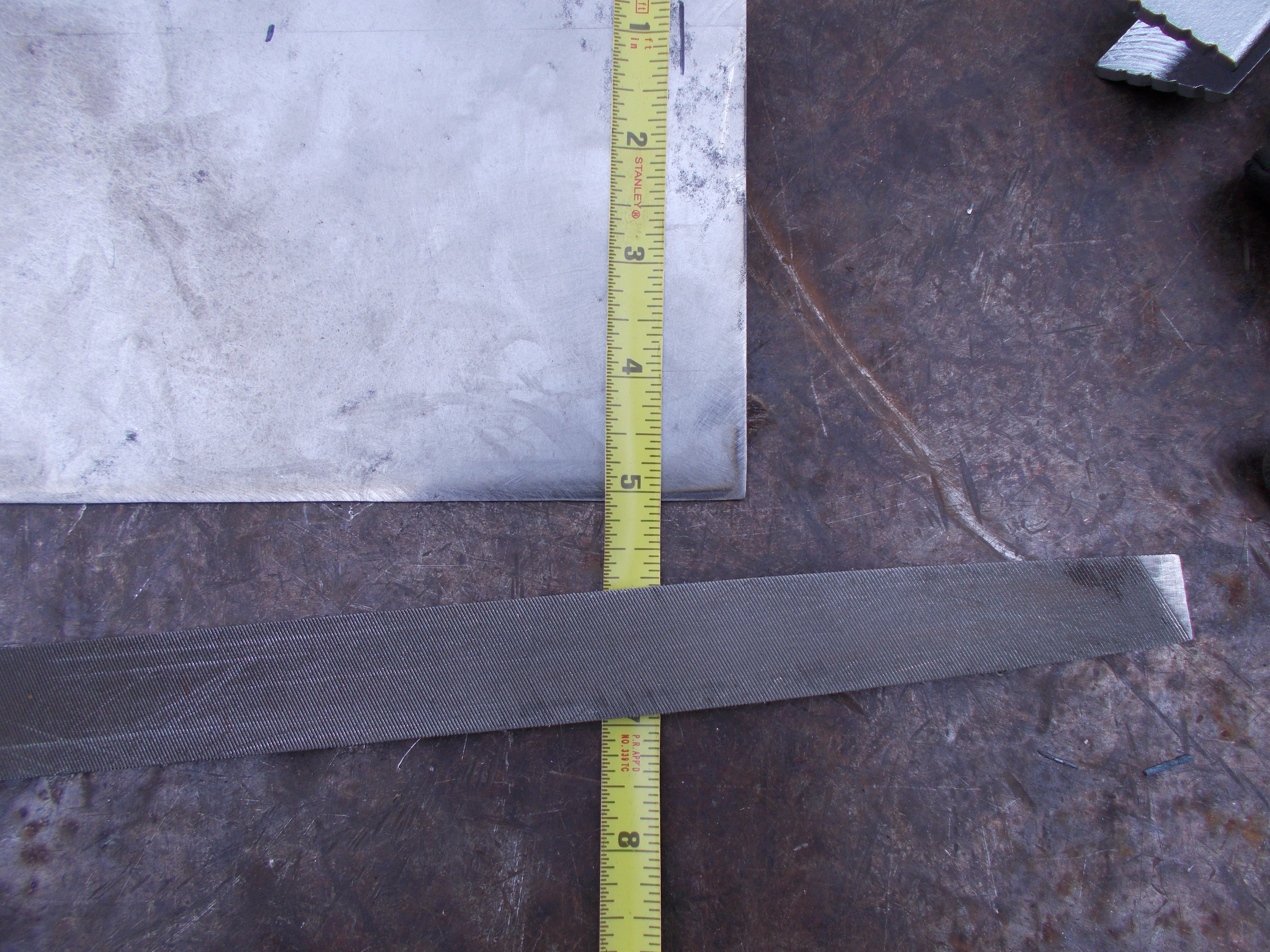

Well I started a project that I have been thinking about for a while. Shouldn't be hard to see where its going.
After a bit of measuring.
I cut a piece of 8.25 X5.875 18Ga out and squared it up.
It took me a while to figure out how I was going to make my bends straight. I settled on marking the bend line and using a straight edge to guide a 3'X 1/16" cutoff wheel. I cut along the line leaving 1/2" on each end and in the middle.
I then stuck a short piece of 3" channel in the vice. Now to clamp my 18Ga between a suitable piece of 3/8 X 3" to back up the channel.
It bent pretty easy only needing a little bumping with a body hammer.
it wouldn't bend quite as sharp as I needed but that can be fixed after I weld up the slots. After welding the slots I can cut the offending places(The three "braces" I left) and weld and sand to a better shape.
I decided it do only one bend at a time not knowing how much material the first bend would take up.
So here it is so far
