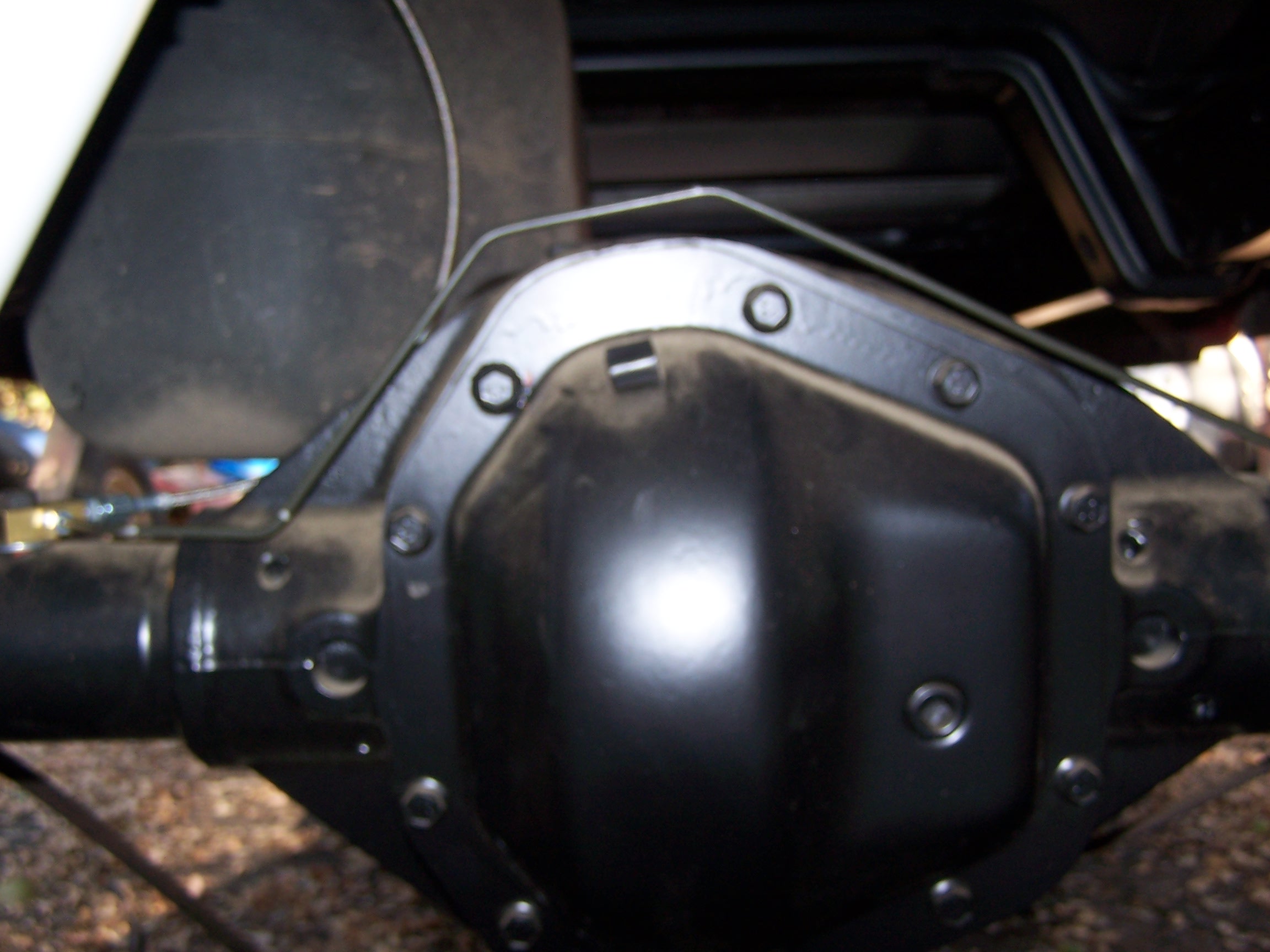

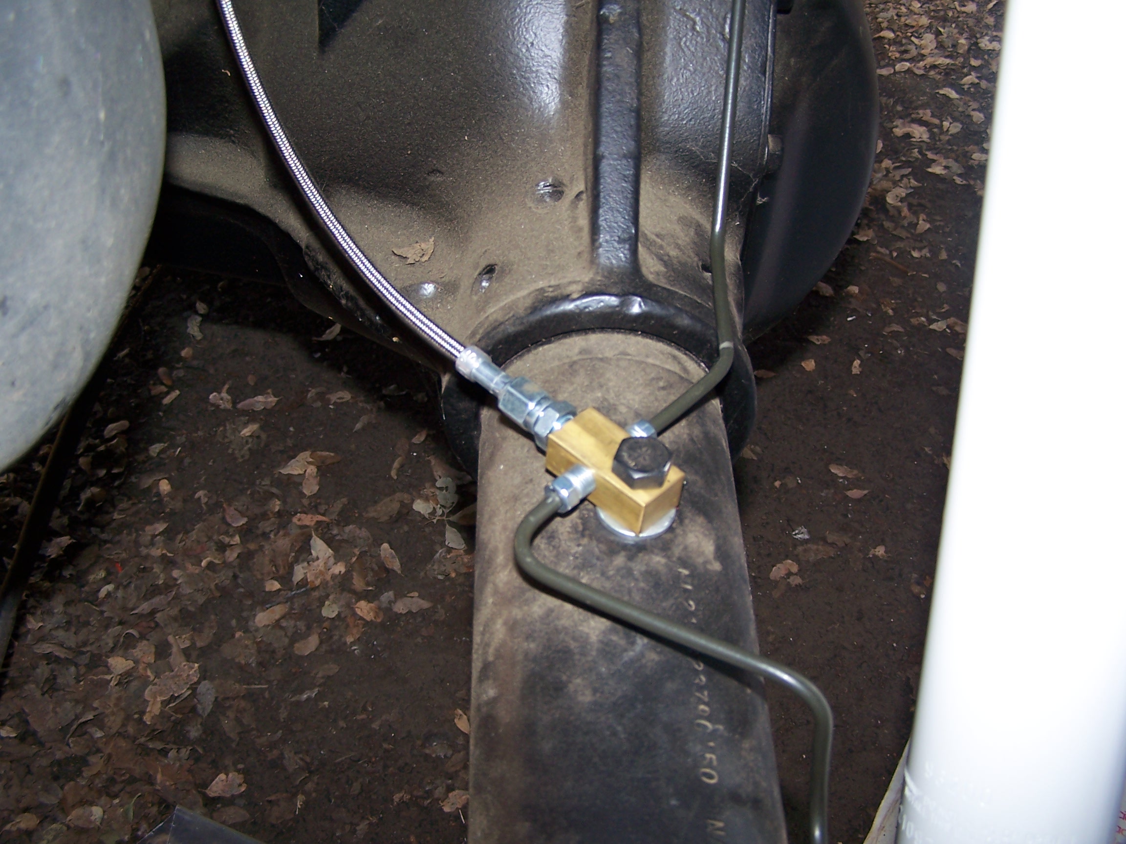

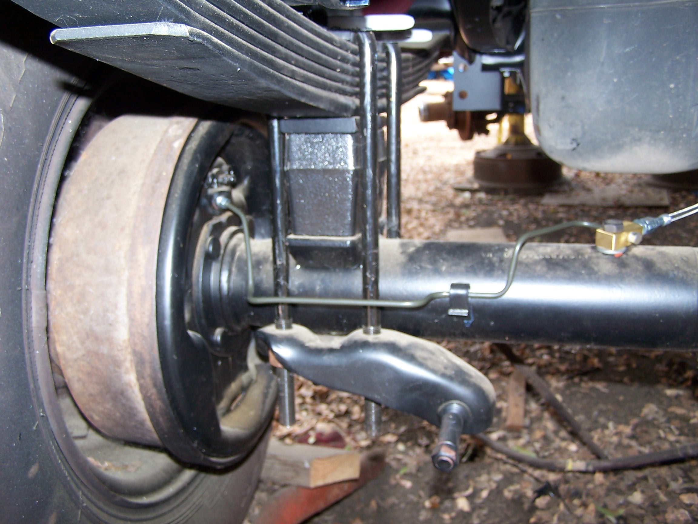

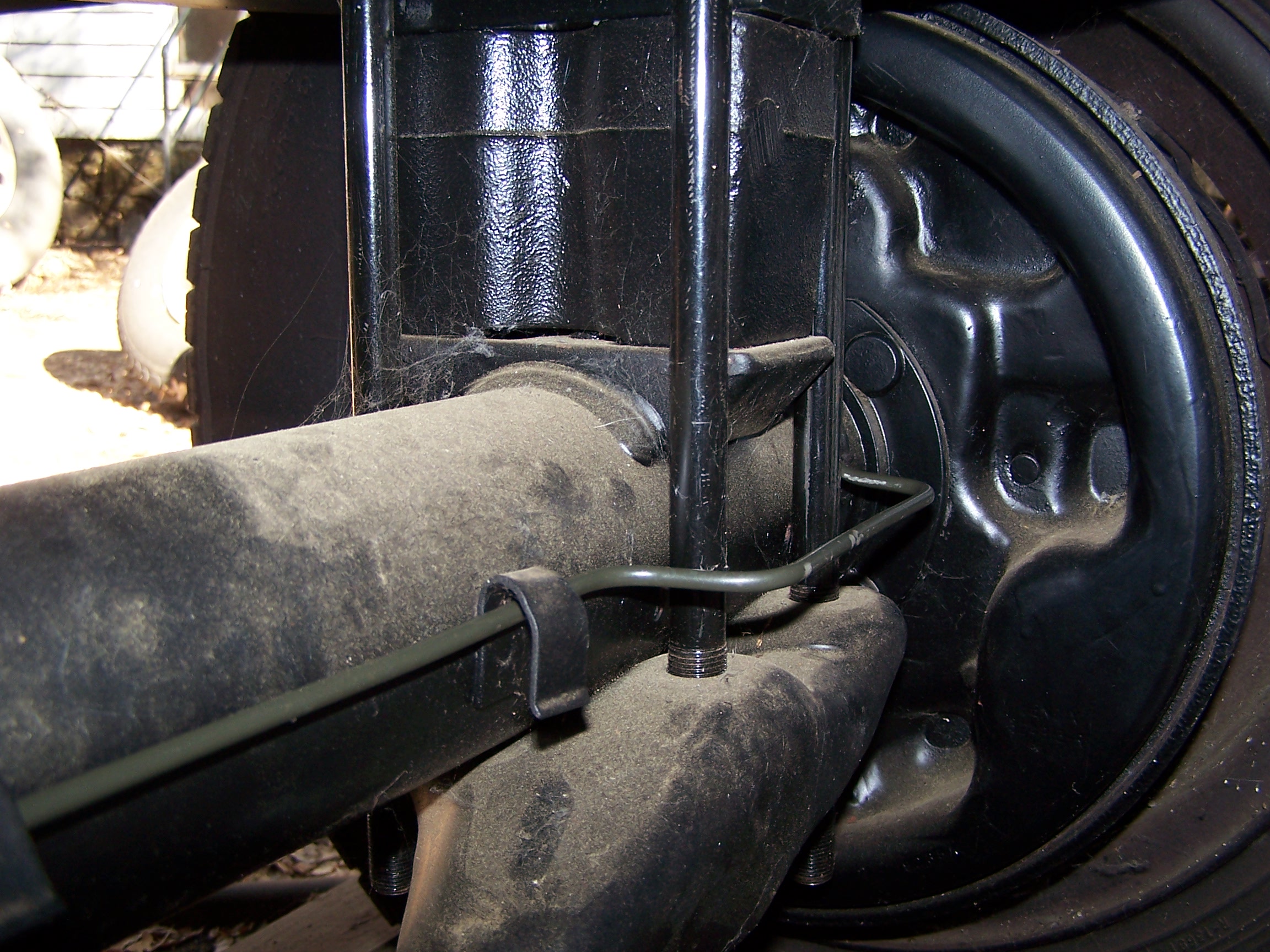

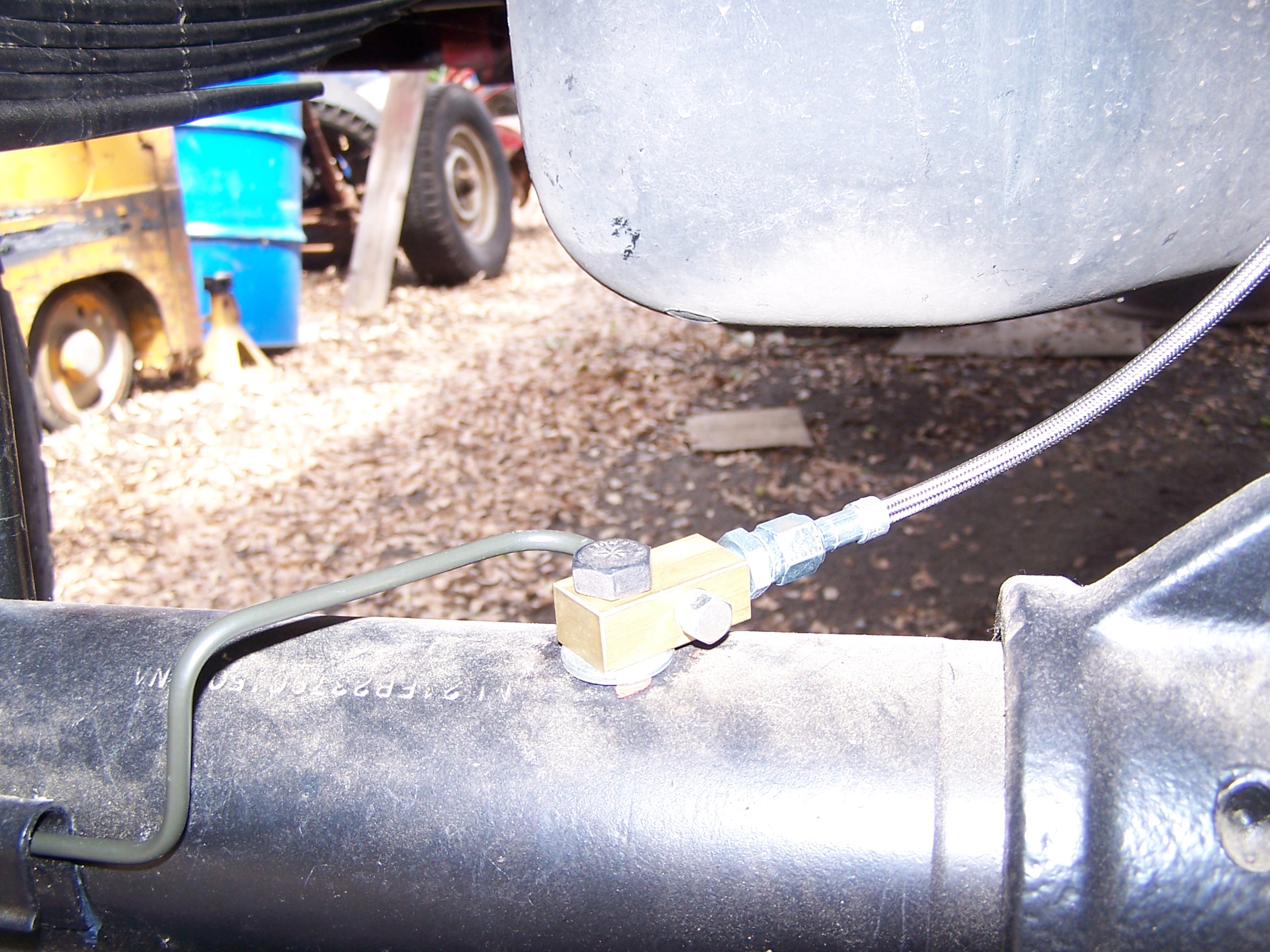

Right rear brake line done. It came out pretty good. I still have a brace to make from a cover bolt or two, I think two. I went over the top of the differential so when I take the cover off I don't have to fight the brake line. You may have noticed my shocks are close to the bottom of their usable range. that is because there is a lift in the future.

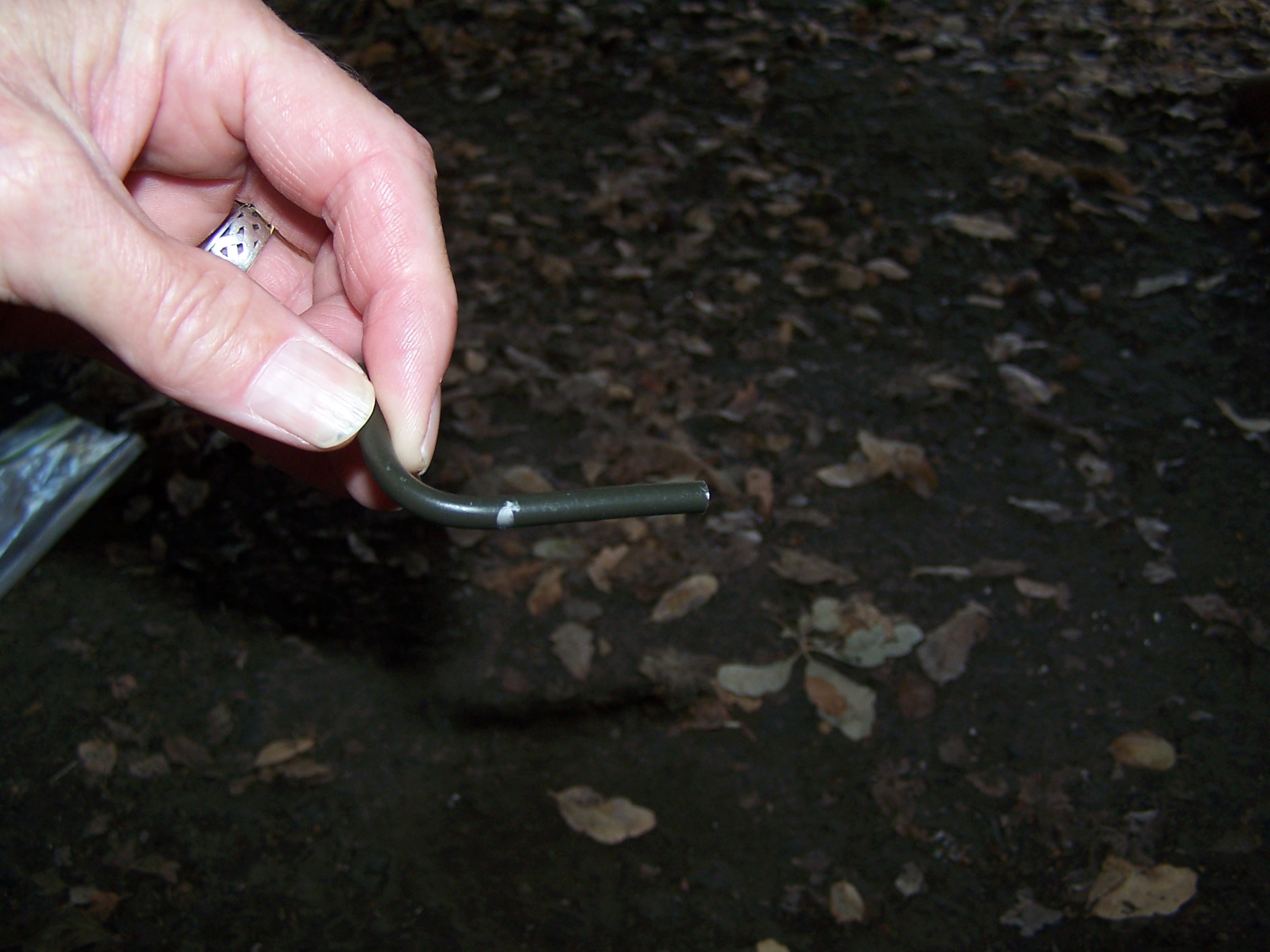

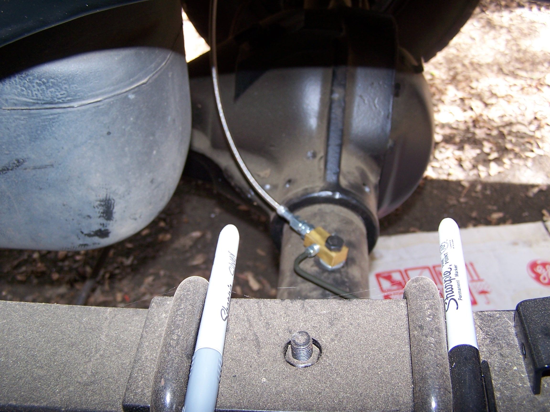

Before I got too far I made this reference "tool". I marked my bender and a piece of tubing then lined up the marks and made a bend. I used the "tool" to get my bends very close to where I wanted them. I was able to hold the "tool" up against the tube where it needs to be bent and mark it. i also made a reference line on the inside of the bend so I knew which way to go. you can see all the silver Sharpie lines on the tube

Old Aug 22, 2015 | 10:51 PM
  #867
I like that routing much better. Hate having to pry the OEM line out of the way to get that diff cover off. Couple brackets...one on the up and down slope of the line over the top would look good IMO.
I like that idea. I hadn't thought too much about it but it it sort of looks like that is what it is there for.
