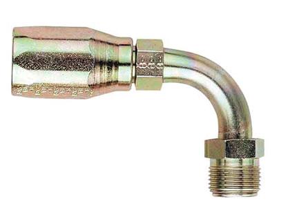

I spent quite a bit of time looking a fittings yesterday. The hardest part of the swap is the plumbing.
If i could find a fitting Like this with a 11/16-18?(if it's 5/8-18 we are in business) thread for a -6 hose for the steering box pressure fitting the rest would be easy. Adapting the inverted flare and the metric o-ring fittings to #6 AN is easy to find adapters for.
The pressure port on the steering box is the tough one.

Old Apr 24, 2015 | 07:43 AM
  #719
bobva's Avatar
Posts: 840
From: granite falls washington
Give Lee powersteering a call.Rebuild and Misc :: Lee Manufacturing Company Sun valley, CA 91352 Steering gears Pumps Reservoirs I called them about the LEE POWER STEERING ADAPTER KIT those little looked like a ticket. The guy I talked to knew more about AN-6 and old steering gears than any body that I talked to before.
