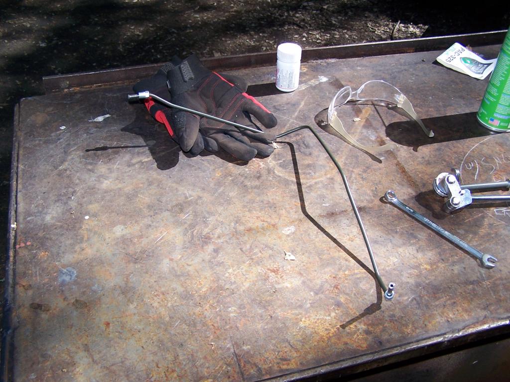

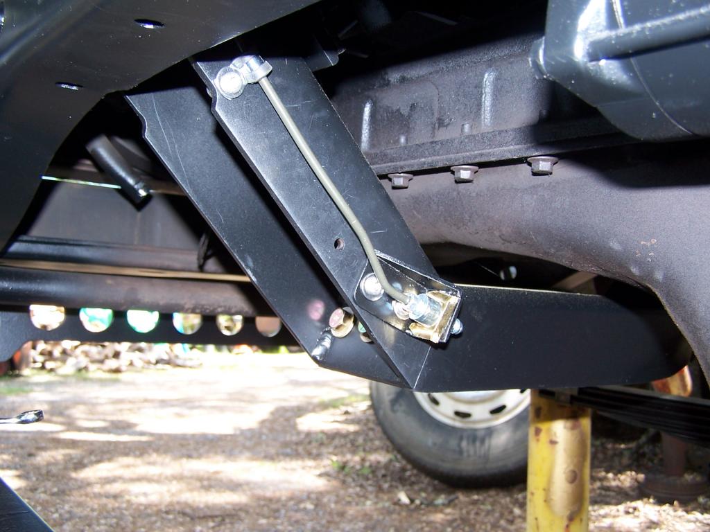

Made this up today. It goes from the balance valve to where the braided stainless line takes off to the front axle.
Attached Thumbnails 1990 D250 to W250-100_5550.jpg   1990 D250 to W250-100_5551.jpg

How / where are you hanging the flex line from your fabricated crossmember?

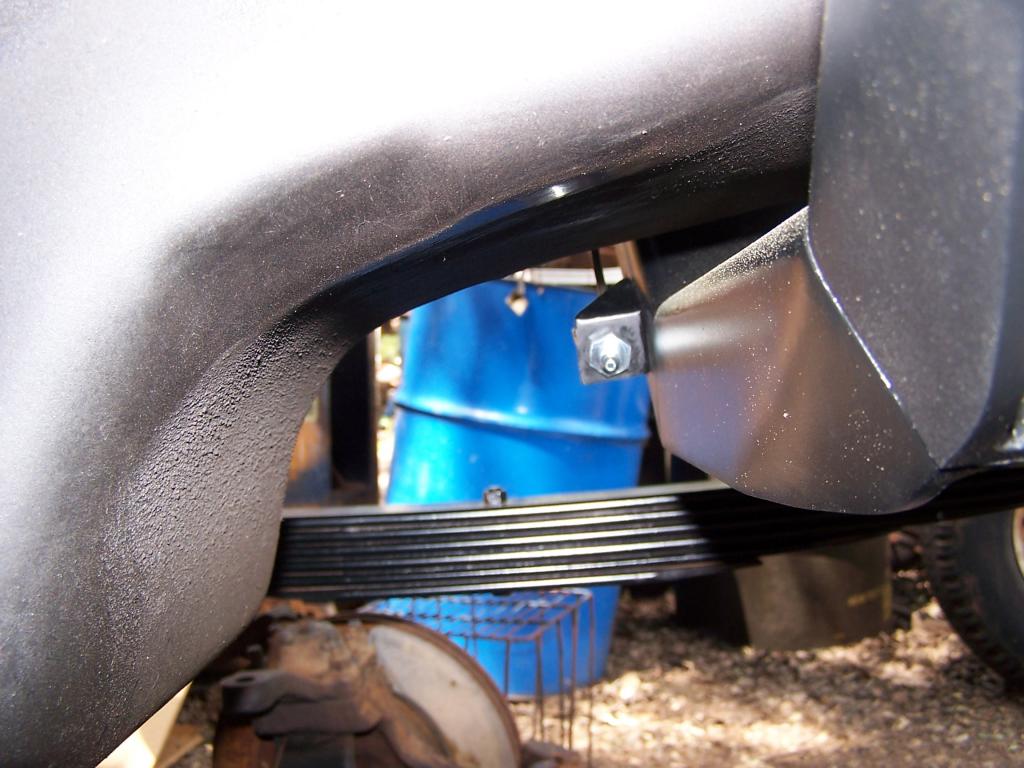

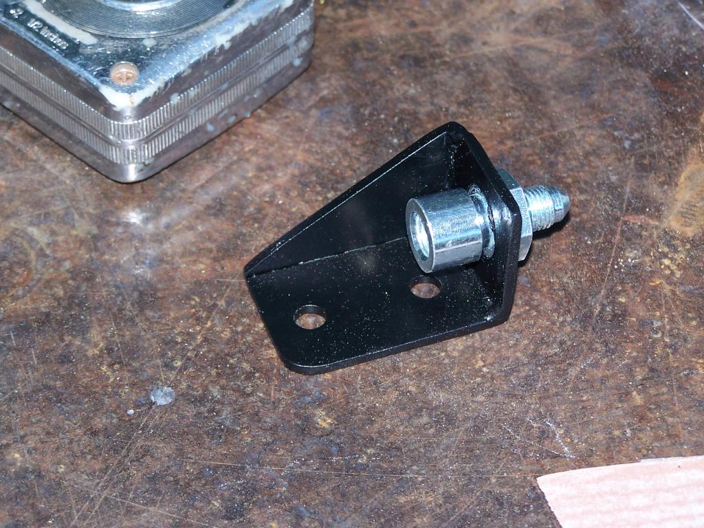

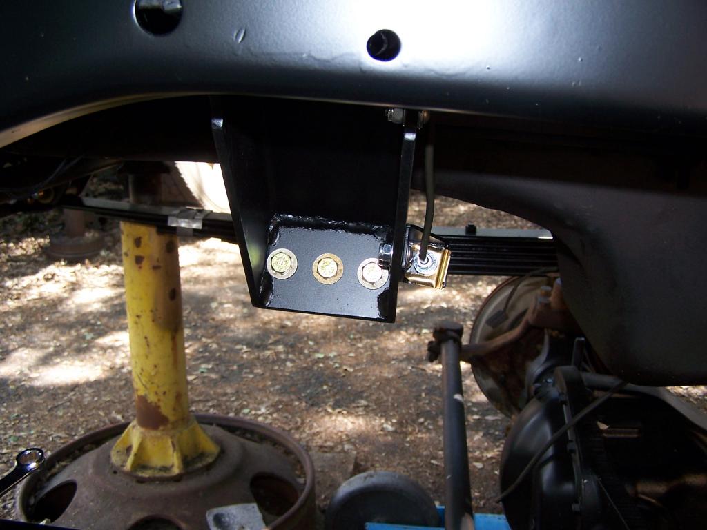

Here is a bracket I made for the flex line fitting.

My wife is having knee surgery . . . line I had.
I hope the surgery is successful with a speedy recovery!
And there is always something to be said for using up existing inventory.
I was curious as to where on your cross-member you were mounting the bracket and how the line routing interacted with your member center section . . .

Mark...Hope things go well for your wife and your self.
That's a snazzy looking bracket..guess it got a free dose of pollen as well... ...like your idea on that one too!
Thanks Alec, The surgery is pretty minor. She just has to stay off it for a while.
I Figured that is what you wanted to see I will get a picture today. I ha to pick up some decent 1/4-20 nuts and clamps this morning.

Thanks Brian,
I started to make it with gussets on both sides then thought at the angle it sits it would just collect crud.
Yeah even after a pretty good night of steady rain the pollen prevails.

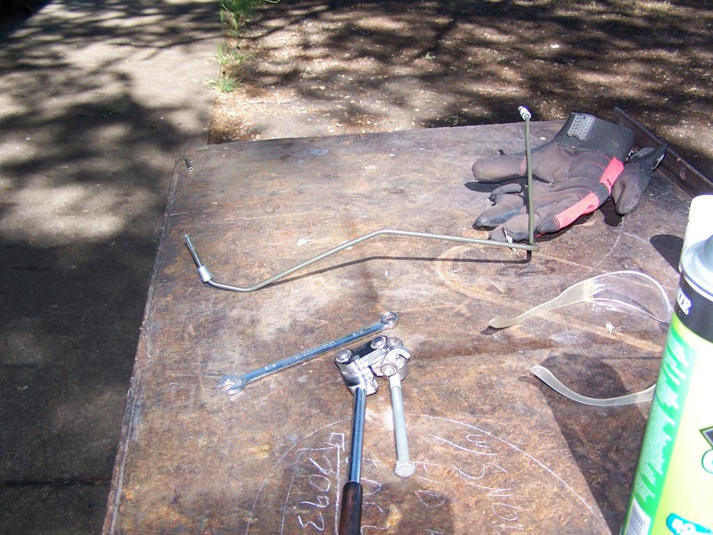

here is the brake hard line for the front. I also picked up some 5/8" U- bolts for the front axle. and naturally I had to drill out my spring plates.
Attached Thumbnails 1990 D250 to W250-100_5555.jpg   1990 D250 to W250-100_5556.jpg   1990 D250 to W250-100_5557.jpg   1990 D250 to W250-100_5560.jpg

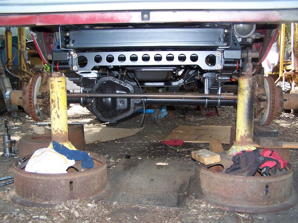

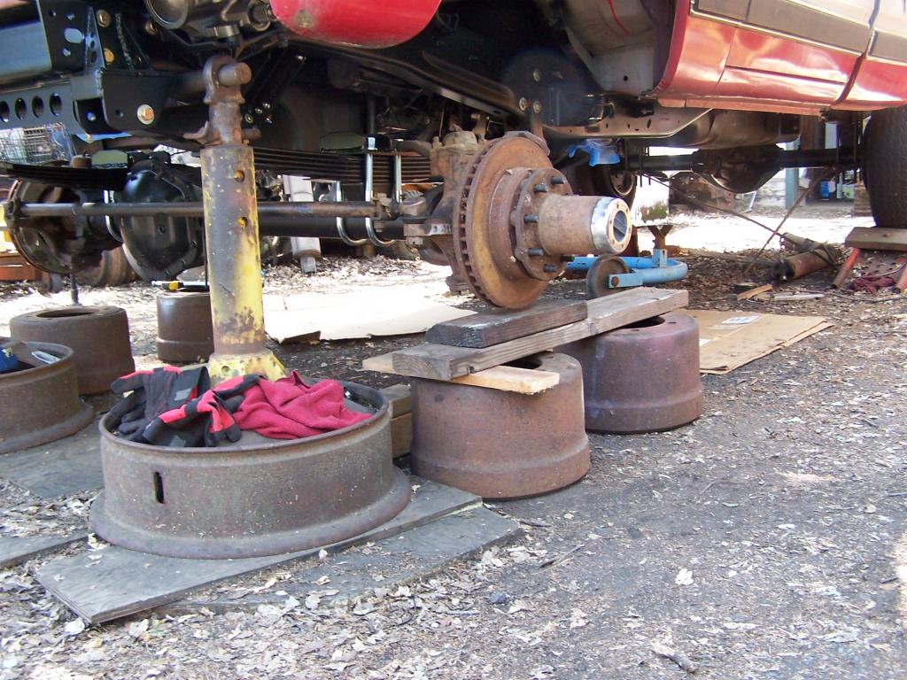

From: Tulsa, OK

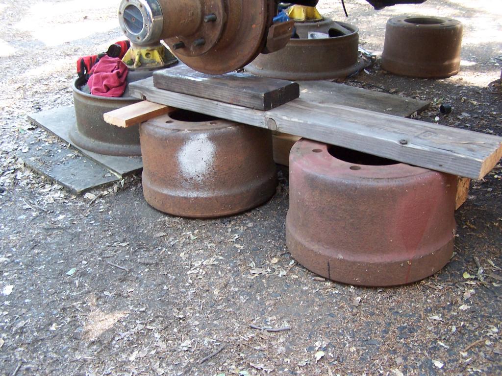

I bolted up the front differential today. I couldn't get close enough to the front with my cart so a built a bridge. It worked pretty good too.I jacked one side at a time (4") then slid my brake drum 2X6" bridge under the rotors. After that I clamped a piece of 1X2" pine to the pinion yoke like a kick stand.
All I had to do now is roll ti to where I want it. I then used a couple pairs of vise grips to keep the rotors from turning and jacked and block .
Attached Thumbnails 1990 D250 to W250-100_5561.jpg   1990 D250 to W250-100_5563.jpg   1990 D250 to W250-100_5564.jpg
