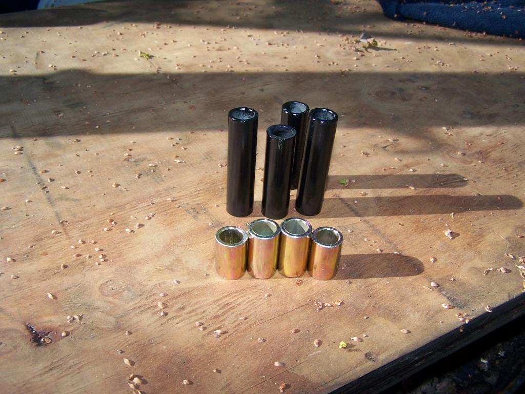

I was sorting through the hardware that came with the urethane cab bushings I can't figure out what I am supposed to do with these.
Half are too short and the other half are even shorter. It looks like they are even too short to keep the bolt from moving around like a baseball bat in a rain barrel.

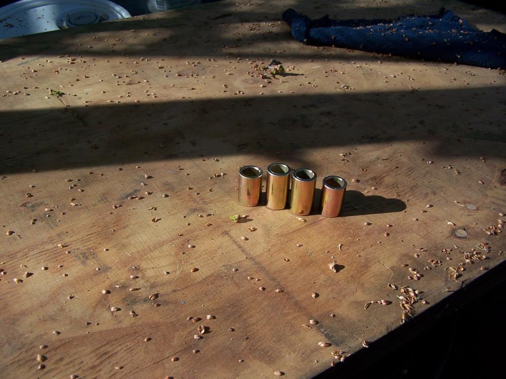

So I resurrected the old ones. Maybe they will work better.

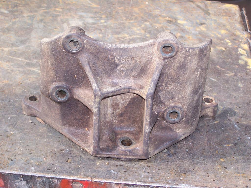

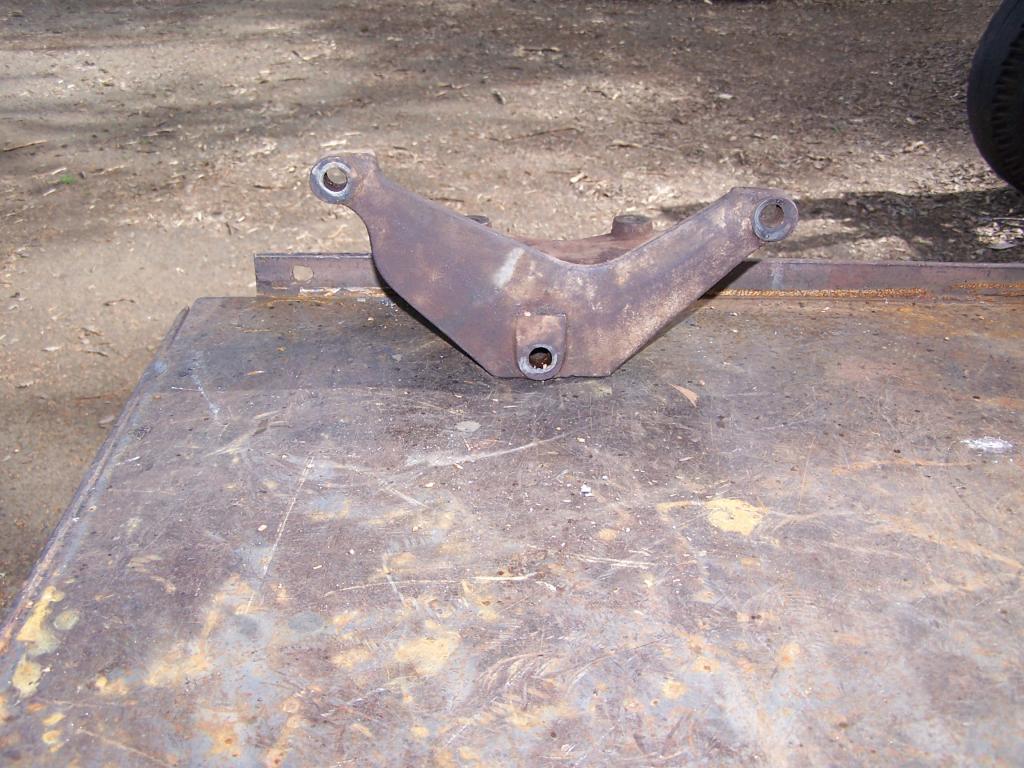

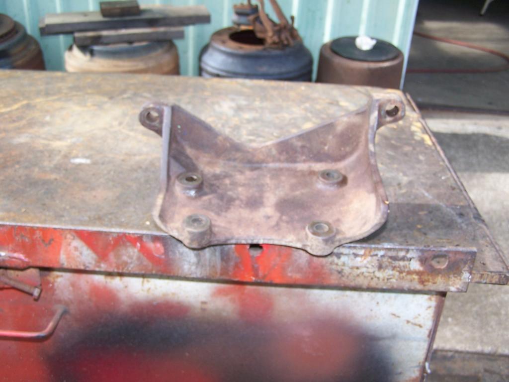

I went to pick n pull today and drug this morning and drug this and the steering box that goes with it home. I couldn't pass it up as the front sheet metal was gone off the truck
Oooohhh!
Real Dodge goodness there!
It needs to go on your truck, like that wasn't in the cards......

Nice find Mark! Kinda gives you a warm fuzzy don't it?!

I have Nick (PapeCAT) to thank for the find. I was kind of surprised when I saw it just sticking out in the breeze the way it was. My first thought was something has got to be wrong, this is too easy.
