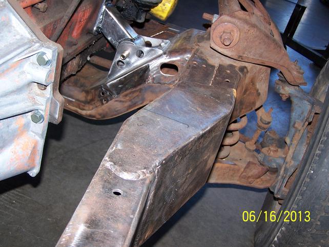

I just found this picture hiding in my first gen collection.
This the the right front side of my 52 GMC frame In the foreground is where the GMC frame meets the 75 Camaro in the back is the motor mount I made for the 250 six that will go into the truck. these are the first parts that I took the time to drill holes just for looks.
I used poly spring bushings for the mounts..
