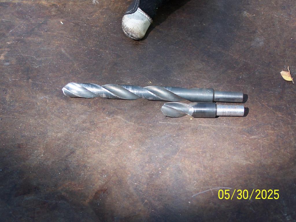

So far today I treated some parts with metal etch for paint.
And shortened a 1/2" drill bit to fit inside the channel in my frame. For a angle drill.

This afternoon I went to the hardware store and bought three 1/4" X 1/2" set collars. The idea is ,when I drill the holes for the transmission crossmember I can't get a transfer punch behind the braces that go up to the top frame flange. There is enough room for an angle drill though.
So here is the plan, tack weld a set collar into the 1/2" hole in each hole in the brace. bolt the brace in place at the bottom and run a 1/4" stub drill through the hole in the collar into the flange making a pilot hole. I can then take the brace off and drill the holes to size. move the brace to the other side and repeat.
