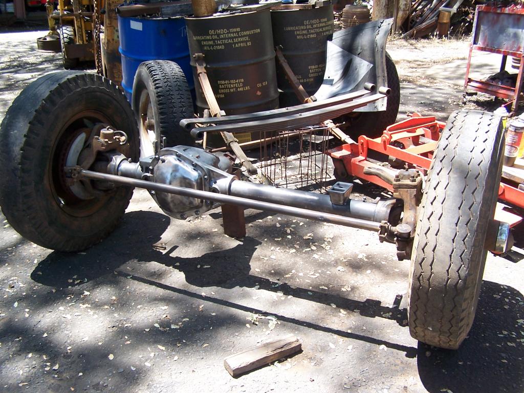

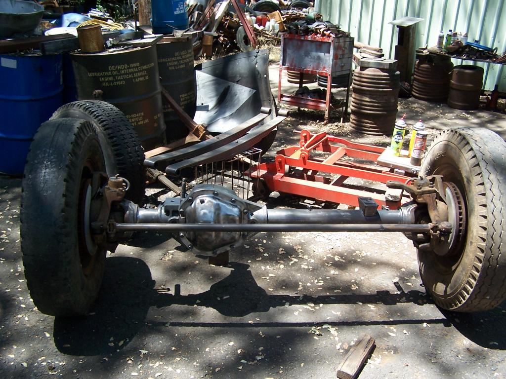

cleaned up the front parts a little more today. I didn't mess with the knuckles yet . I figure why sling grease all over if I can wait until it is apart and then clean the rest up. I don't know if that is the wisdom that comes with age or just laziness.

Wow...Those look almost like you blasted them. Good job on the cleaning!!
It will be easier to do the knuckles...and related parts...once it's secure on the truck. It's not laziness...just prudence...
I was really surprised at how easy they cleaned up. I hope the rear goes as well.
"It will be easier to do the knuckles...and related parts...once it's secure on the truck"
Yeah kinda like a big vice.

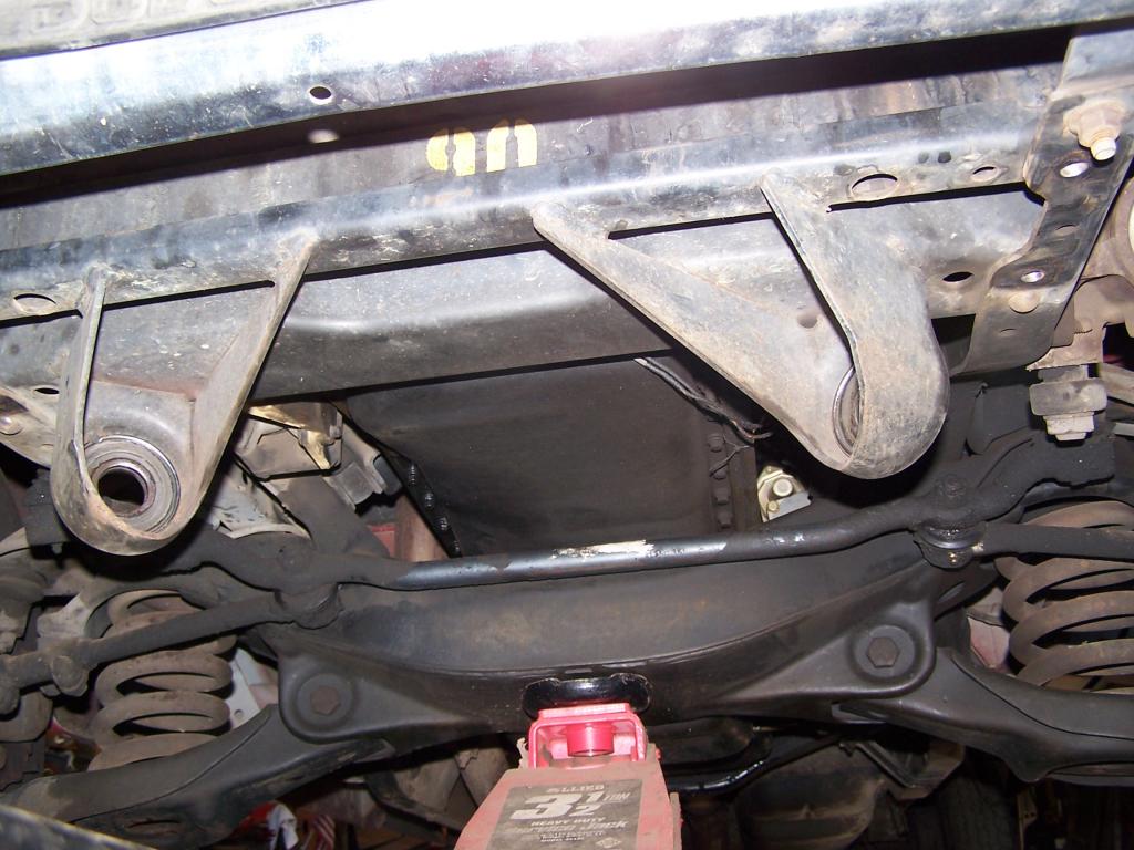

The dissection has begun. I had a bit of time on the concrete floor so I did A little.
I got the shocks off and the front wheel wells(Splash guard's) off. also the front control arm braces. Tomorrow I should be able to cut the brackets off the front crossmember. Then I can piece my front spring hangers together.

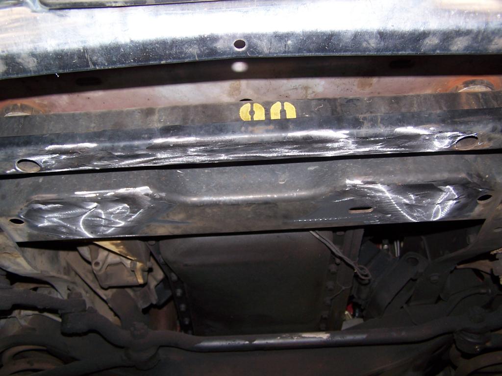

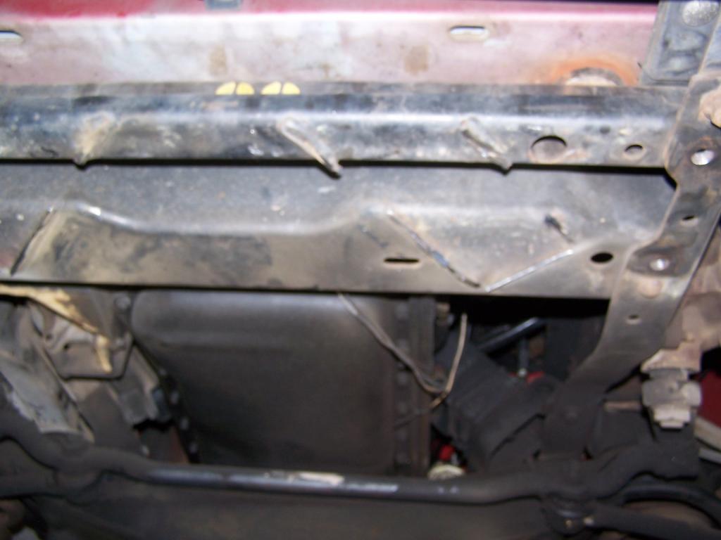

yesterday I cut the front strut rod brackets off and ground the welds on the front crossmember almost smooth. I can't grind over head for very long anymore. A little more clean up and it will be good. The next step will be to get my front spring hangers mounted and the cross brace welded up.
I didn't get any pictures after the grinding. I was in a hurry to get out of the shop.

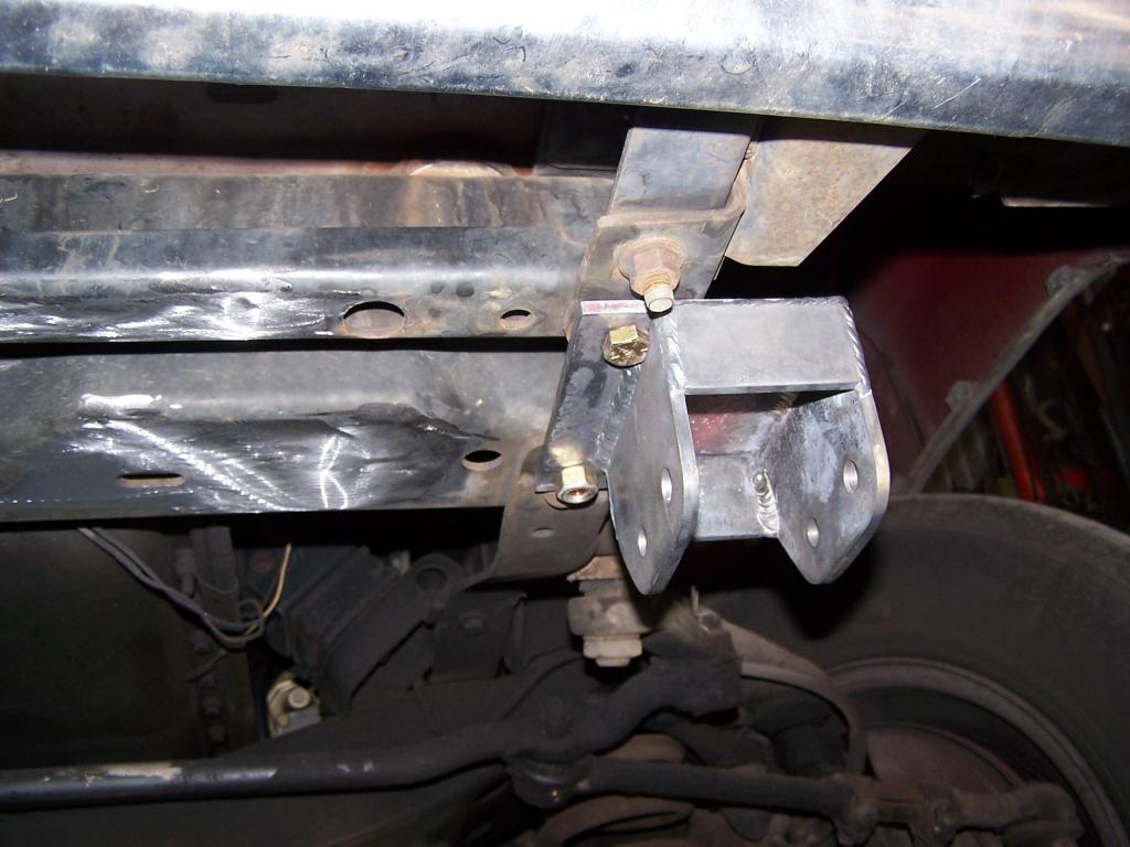

A little more progress today. I finally got the grinding/sanding on my front crossmember pretty much done. So I mounted my spring hangers and drilled the sides of the frame for the spring hanger braces.

Are those bias ply tires?!
Good eye they sure are. 700-17 on split rims from a 52-53 Chevy one ton.
