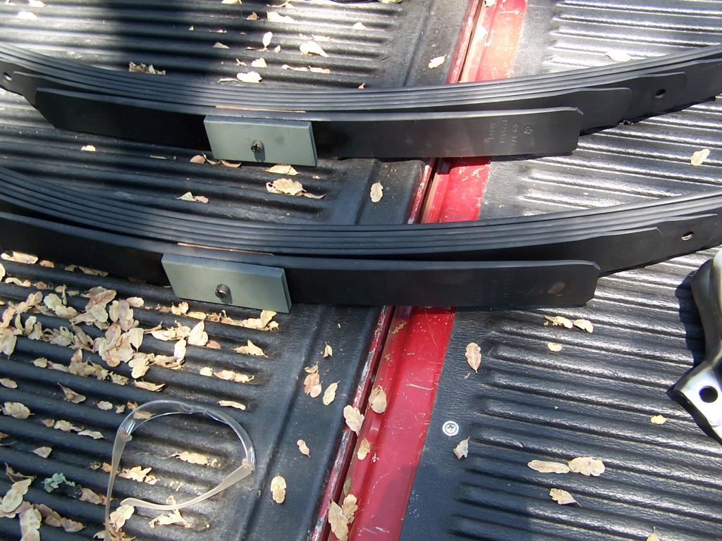

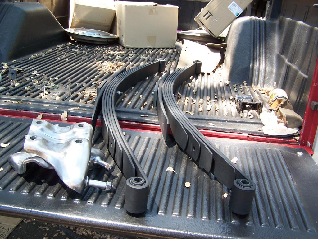

I actually put something together today. strange but true
This should become more common as time wears on
It is nice for a change to be putting something together for a change.
Ignore the boxes I have been collecting them to put down when I take the trans cooler lines off. Hopefully then I will have a disposable mess.

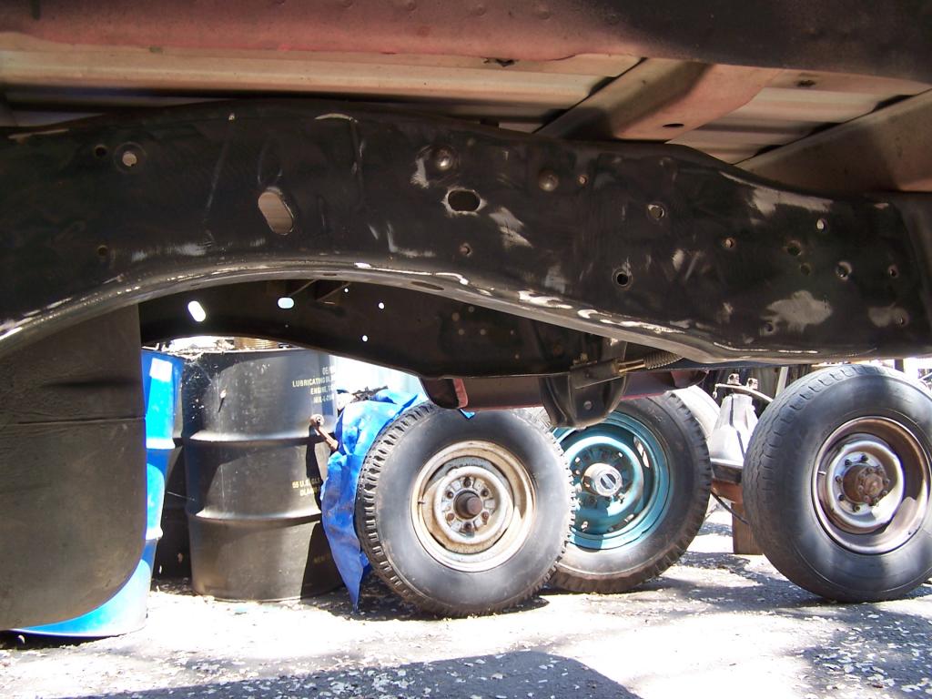

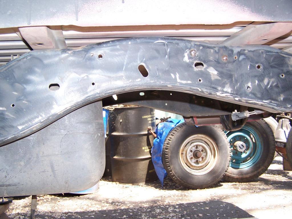

I got a little time in cleaning up the frame before it got hot out 115 in the sun. It was 106 in the shade when I called it quits. It is supposed ot be cooler later in the week maybe I can get some paint on it.

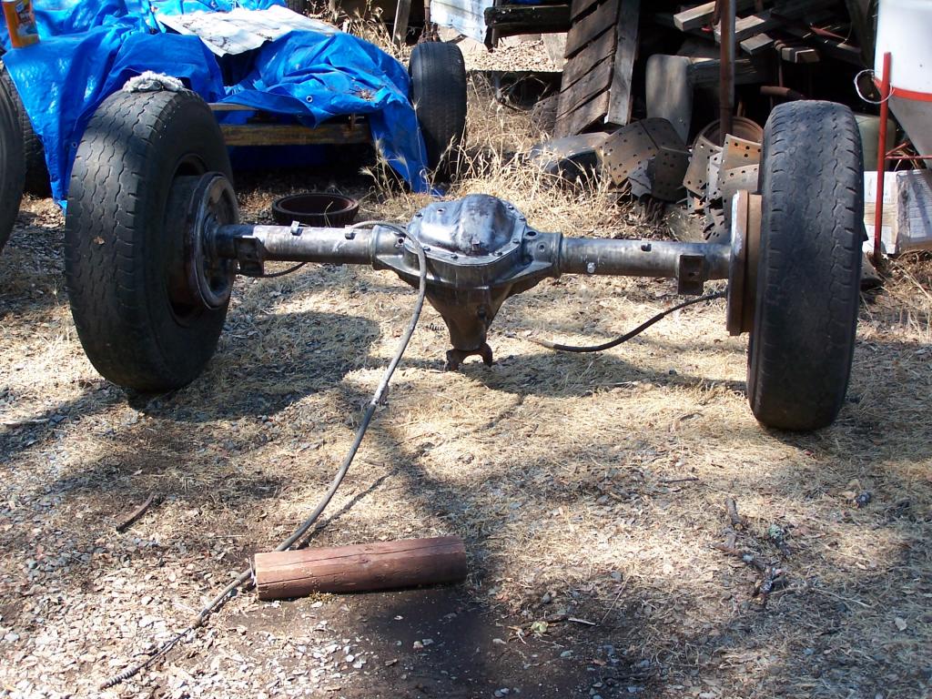

I got a little more done on the rearend today. I got the nooks and crannies cleaned out and treated it with phosphoric acid to kill the rust in the places I can't reach. I am going to hit it again in the morning when it is nice and cool. then I will turn my attention to the inside of the frame in the rear. Then, then, then,
