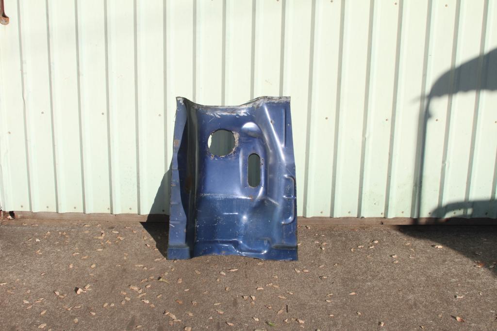

This morning I spent a couple hours taking the carpet and insulation out to get a better look at the Floor. that transmission tunnel is tiny. the floor looks pretty good with just a little bit of surface rust.
It looks like I am going to do a transmission tunnel swap from a 4wd. I thought about modifying the stock one but decided to scrap that idea. It will be much easier to cut and weld a stock part from another truck. That way A stock floor mat or carpet will fit.

It may be easier in the long run by saving me from removing and replacing the transmission/transfercase god knows how many times. Or blocking the cab up and trying to measuring where it is difficult too see.
Besides it is a good time to take the Heater/AC out and clean it out. The AC doesn't work so I am not losing anything there.
I think it's 6 of one half a dozen another time wise( for me anyway)But sheet metal is easier to lift. Plus the holes for the shifters are already there

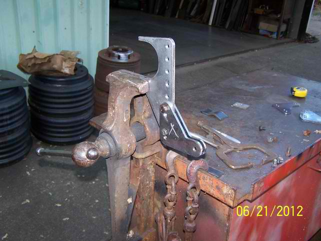

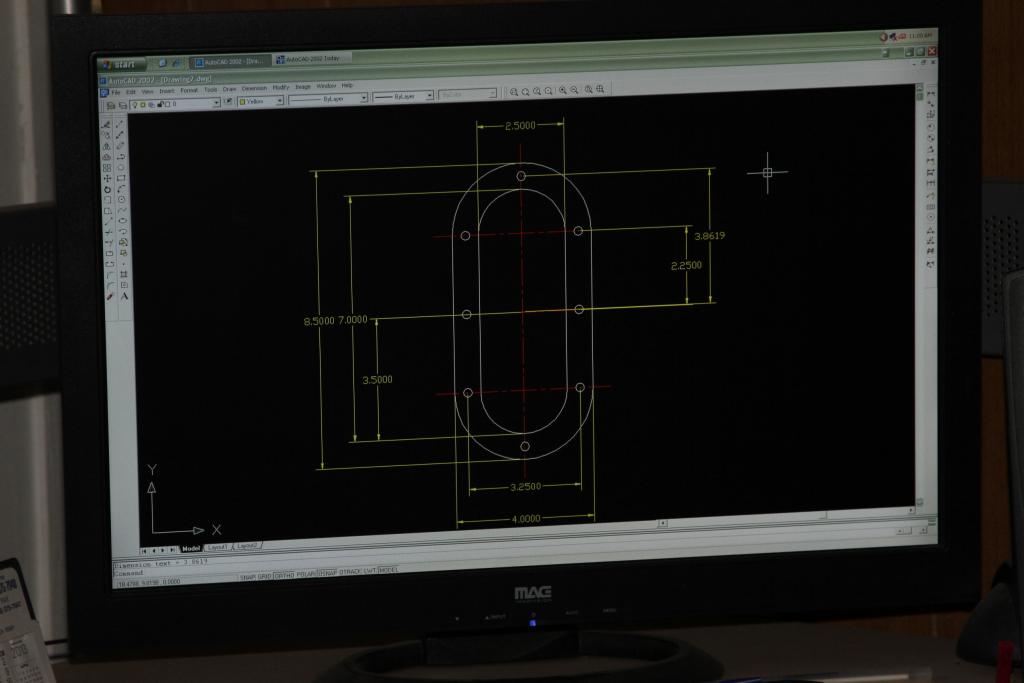

I didn't get much done today. First thing was to sand the burs off my doner transmission tunnel. then just for fun I made a drawing for a alumunim transfercase boot retainer to replace the crappy bent up steel one.

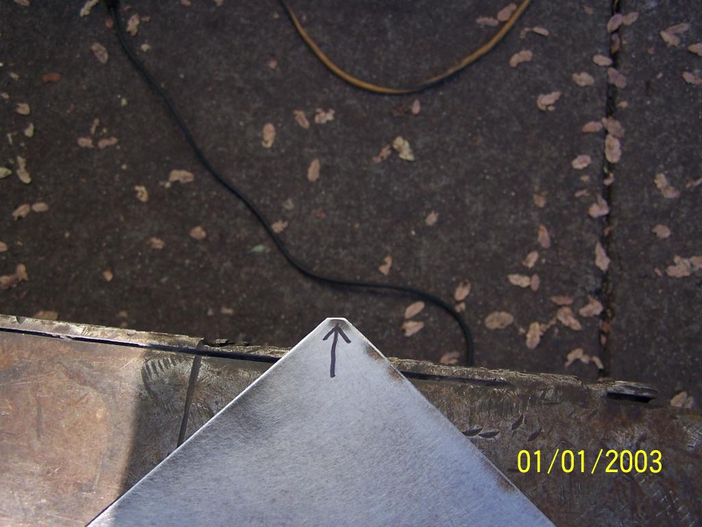

Then I made a temporary cover for my left kick panel vent. I will replace it when I get around to the interior.

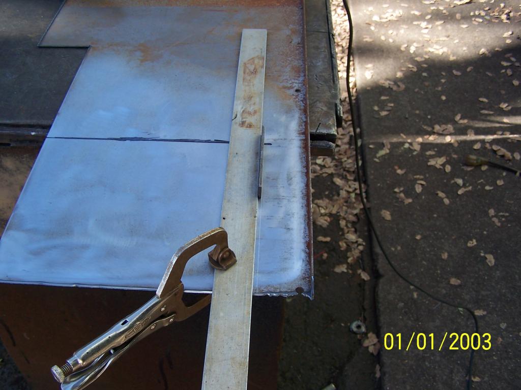

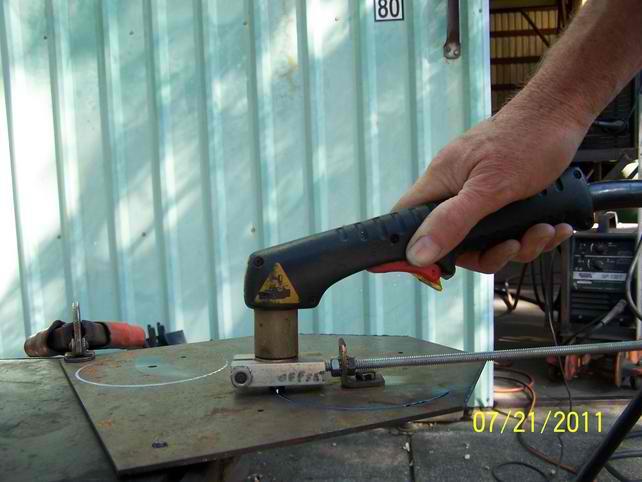

First picture is how I set up the guide my the plasma cutter. It is 1/8" from the line I want to cut to the inside of the flame.I also have a cool way to cut circles from 4" up. I will post a picture when I find it.
The second picture is a way to cheat to get a more even corner radius. works pretty good too.

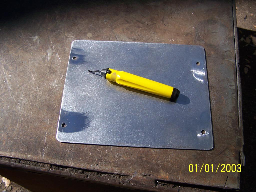

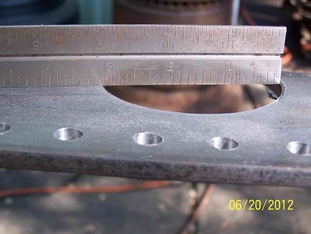

Third is my cheapie hole deburing tool. I got it at Home Depot in the pluming department.
I also usually use a step drill(on sheet metal) on holes up to 3/4" hole saws from there to 4" and my handy dandyhome made circle fixture for the plasma cutter.

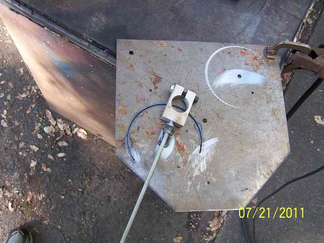

Here is the circle cutter. I used a peice of longer all thread to cut a 15" dia circle for a fan shroud.

Thanks man. It is one of my favorite home made tools. It only took a few minutes on a Bridgeport to make. But I think one could be made without a mill pretty easy.
