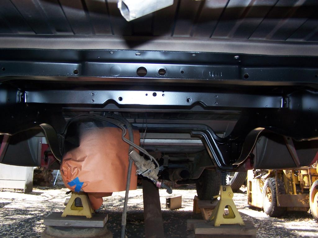

more today

Now that look purdy!!! Almost too nice to want to start bolting things back up and driving it in bad weather.

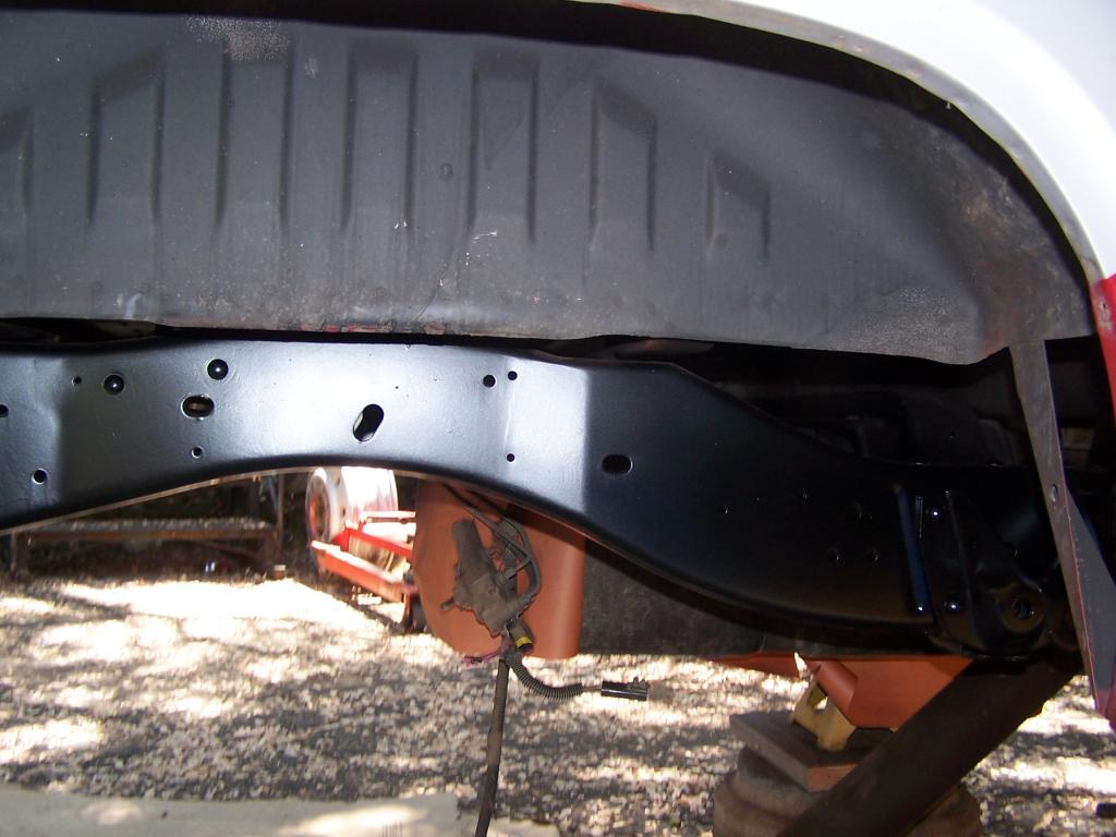

Thank you Brian, I had some troubles but worked through them. Geez it has been close to fifteen years since I used a paint gun. but toward the end I was using my left hand too.

Old Jul 24, 2014 | 04:26 PM
  #199
Posts: 7,293
Likes: 2,884
Looks like it came right back to you, even after 15 years!
That looks great.
That looks great.
Thanks Oliver,
It's good to have this part done. The rest should be easier. we shall see.
I was smart this time I painted the nooks and crannies first then the inside of the frame, the rest was easy.

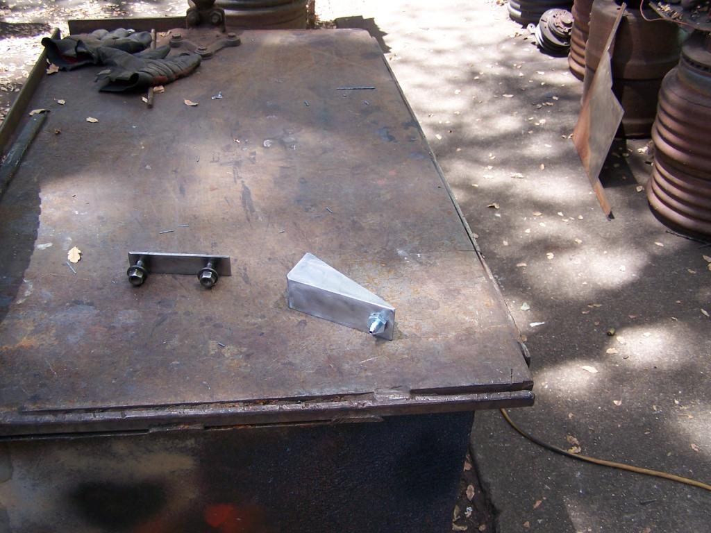

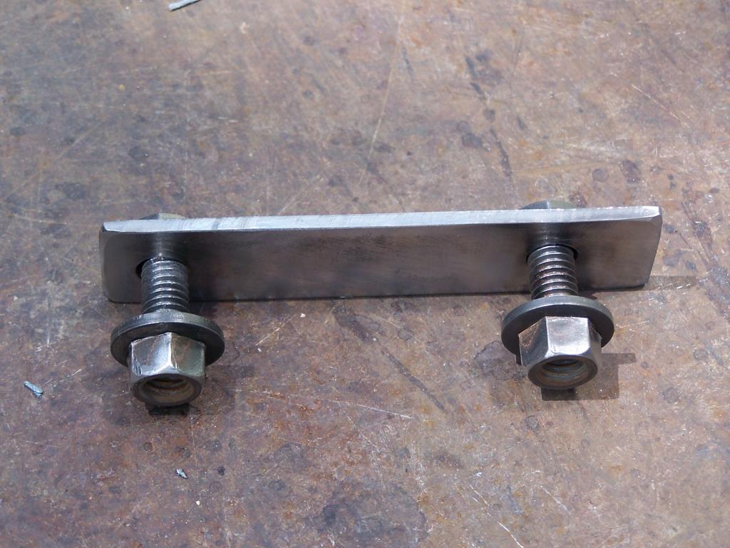

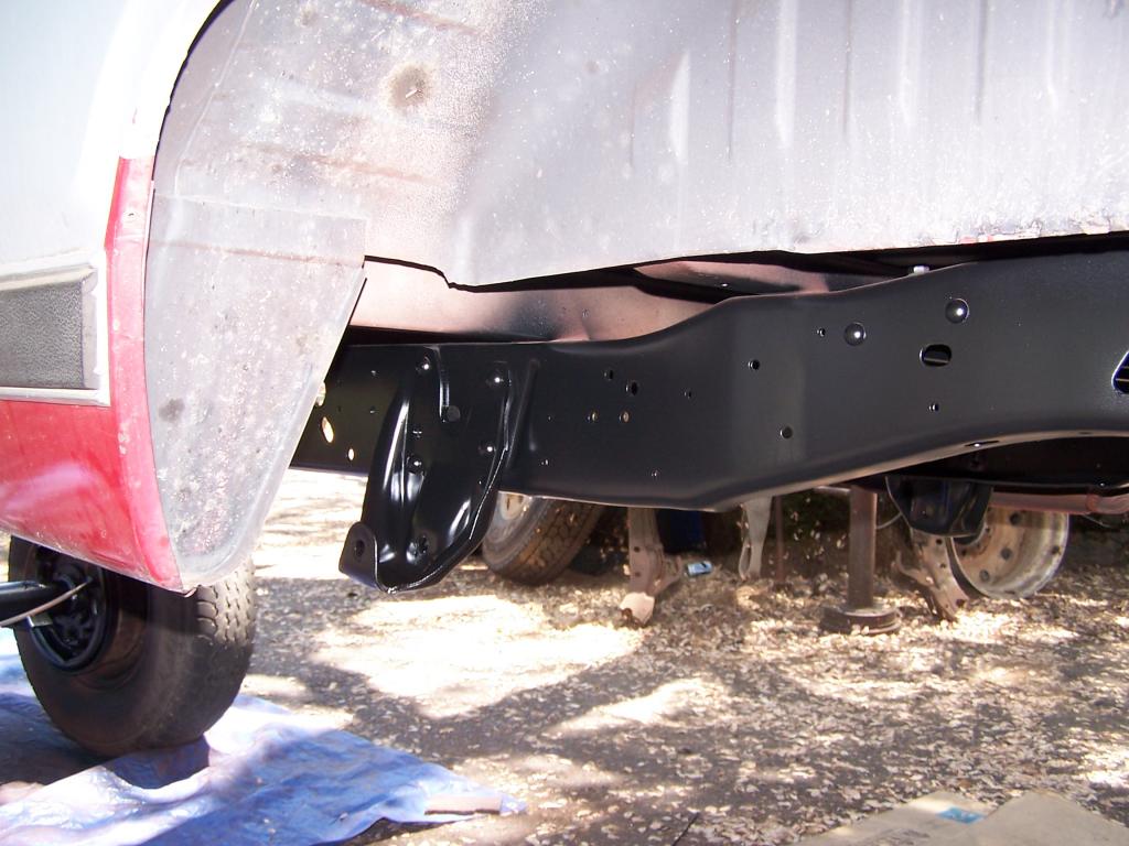

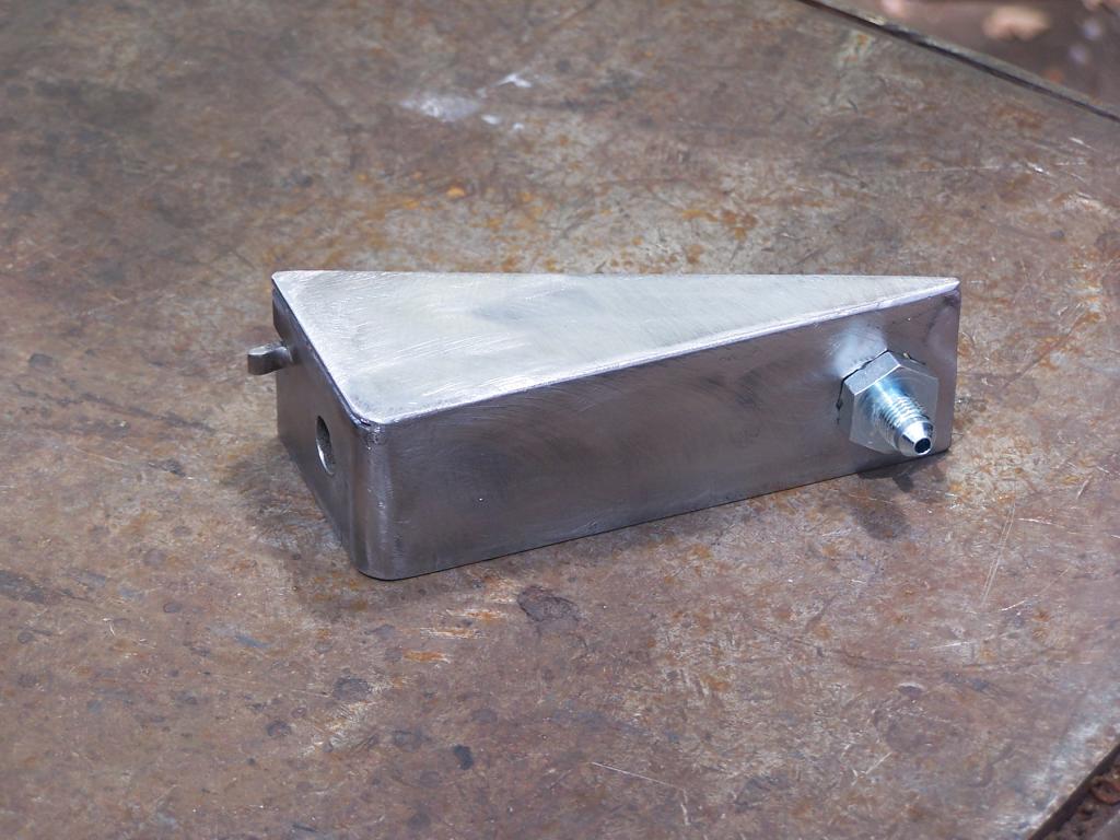

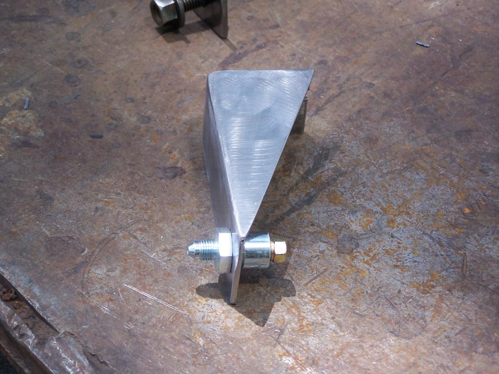

I did some little stuff this morning. First I reworked my rear brake line hanger. then I made the part on the upper left. any guesses where it goes?

Hmmm....flat plate with bolts welded(?) on.....I want to say it's a delete plate for the rear RWAL valve. But why you would choose to put a blank plate there, when you could leave the holes open, I don't know? Unless you plan on mounting something else on that plate?
It goes in a spot that is hard to get a wrench. The plate doubles as a washer and wrench.

For the fuel tank straps? I was going to say that, but the spacing looks too far apart?
Close and good eye. It's for the e-brake bracket just ahead of the left spring hanger, Behind the fuel tank. I have a tough time getting my fingers and a wrench in there at the same time.
