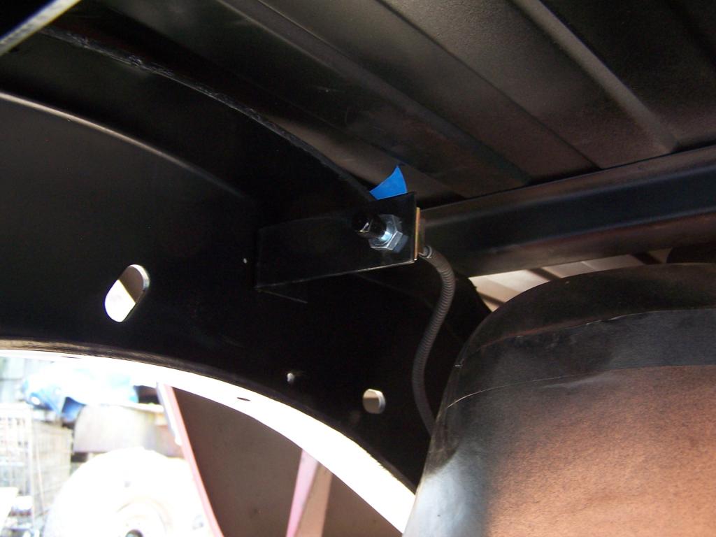

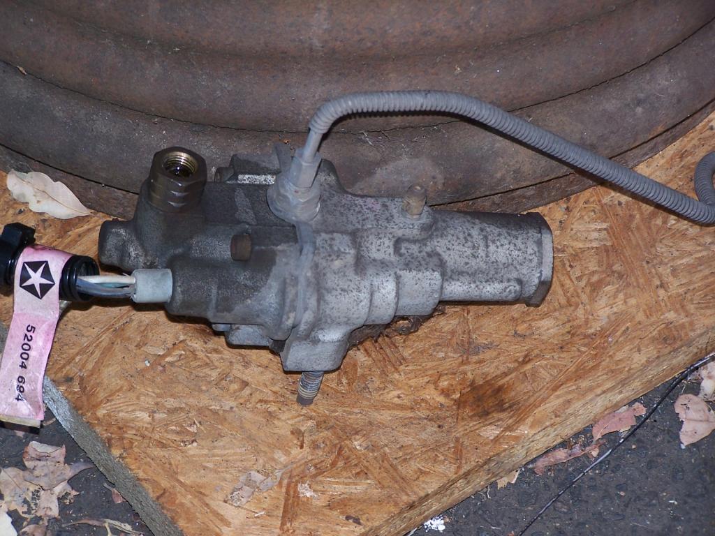

Here lies the problem, ...........................and the fix,female Inverted flare to male AN. for a braided stainless brake hose. Kinda hard to see this end has an aluminum cap to keep the crap out

I was going to eliminate the RWAL from mine too but I think someone beat me to it! I traced the brake line from the MC to the rear axle and can't find anything that isn't just brake line.
that makes it easy I am glad to see the thing go.
