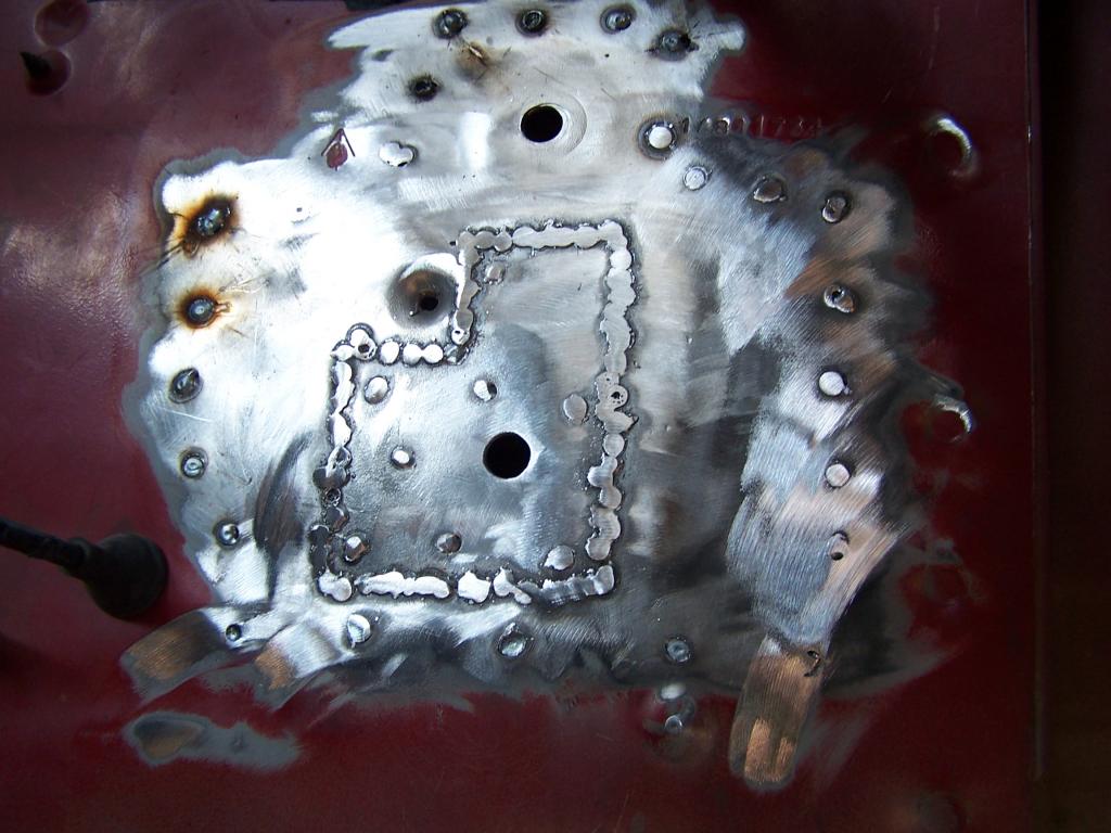

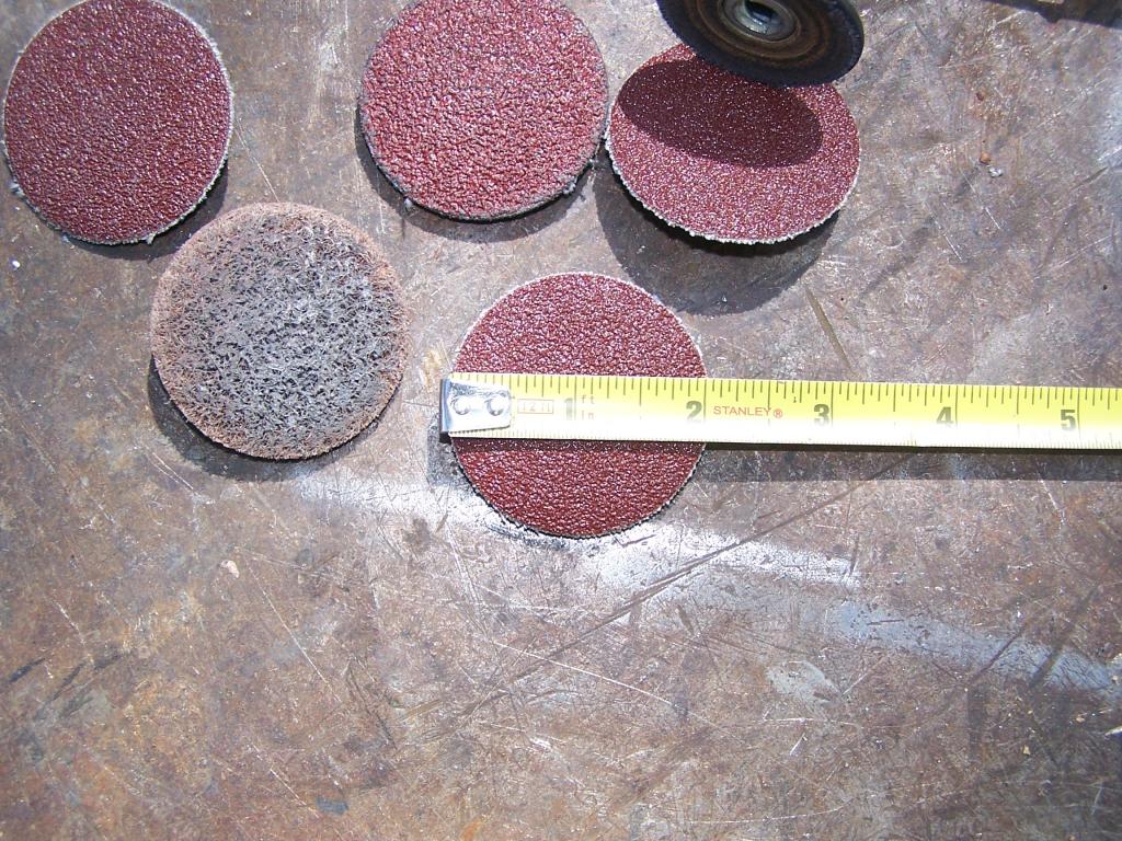

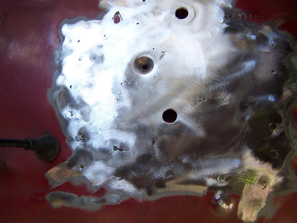

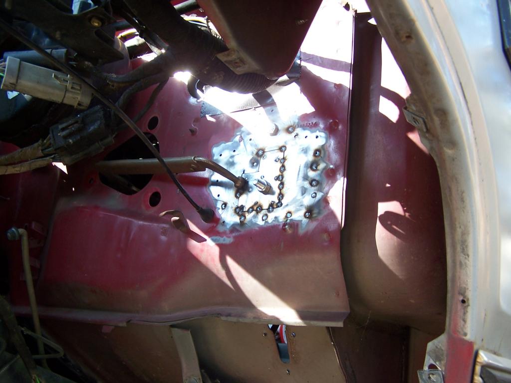

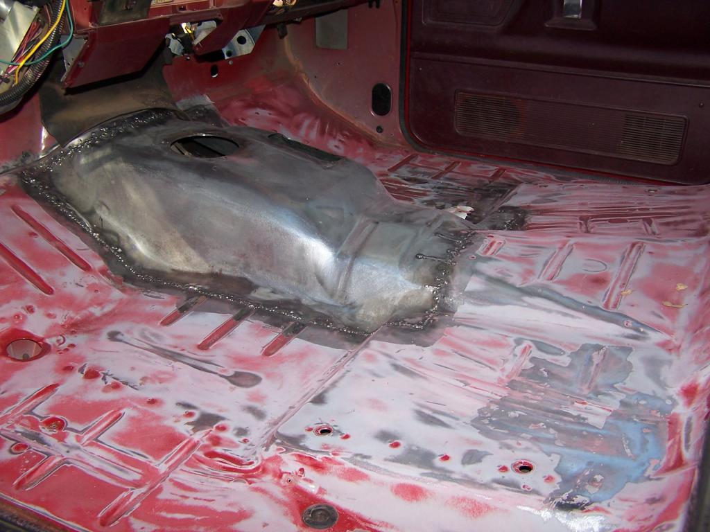

I welded up the firewall patch. It came out pretty good. I was happy to see my local tool store had the 2" screw on sanding discs. That made my day and the job 100X easier.

Nice looking welds, like you said, spaced out little welds that end up look like organized sea gull poo when your done.
Thanks Oliver,
It does look sorta crappy when you are in the middle of the job.
I had a little trouble with a breeze blowing my gas away in most cases that would be what you want ,but with a mig welder not so
I love those little 2" disc, on my wee little 90* air grinder. One of my favorite little grinders to use.
Thanks Oliver,
I had to wait weeks to weld up the cowl cracks on the crewcab...waiting for an almost calm day. Of course the days that there was little wind usually brought rain...
That's par for the course. It worked ok using my hand as a wind guard. but that was only short bursts of a couple seconds longer beads would be a different story.
I will be glad to move on to another thing for a nice change.

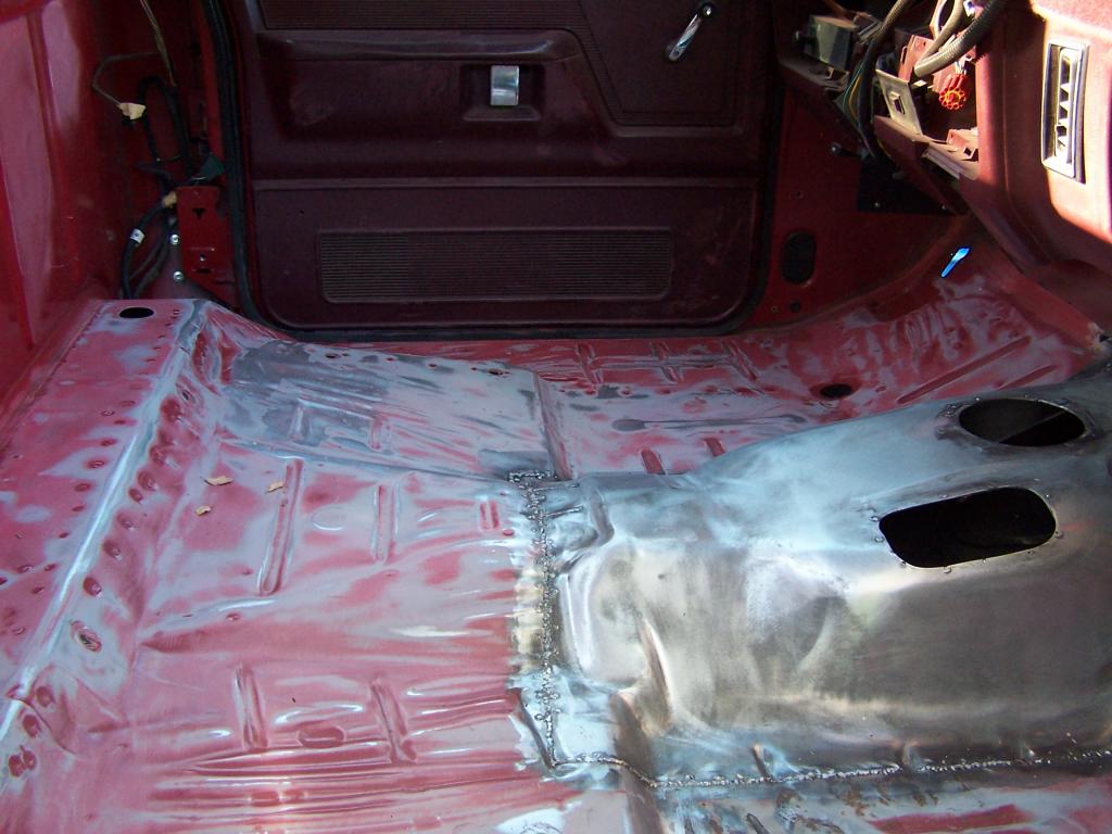

I did a little sanding on the floor today.

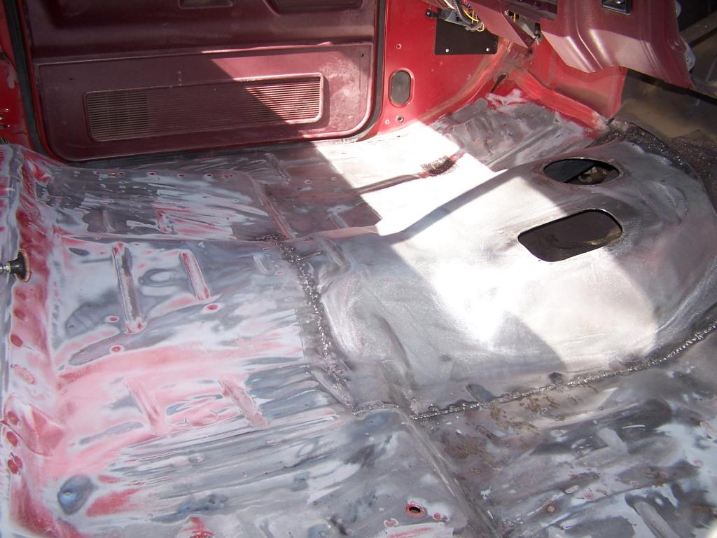

and a wee bit more.
