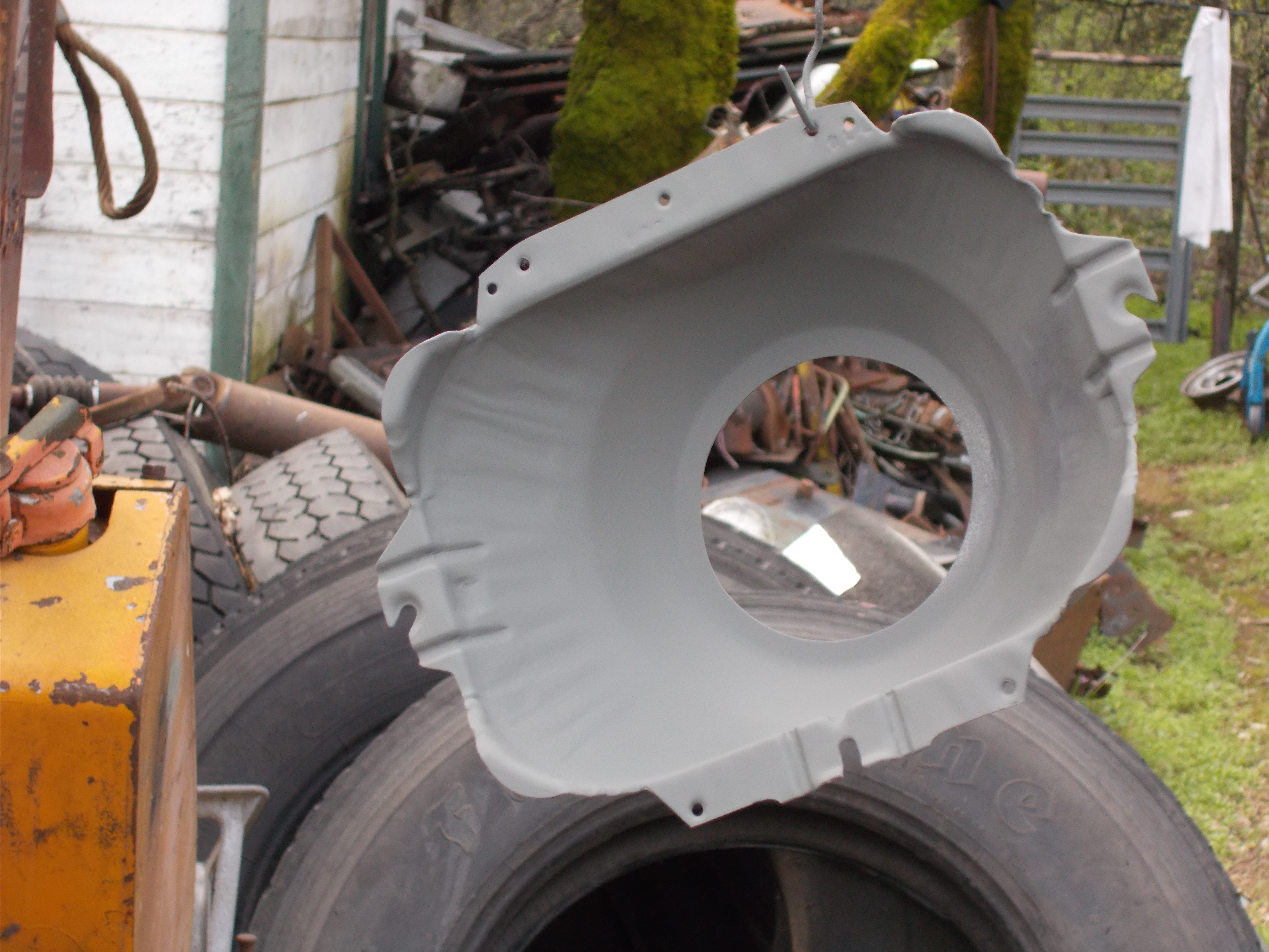

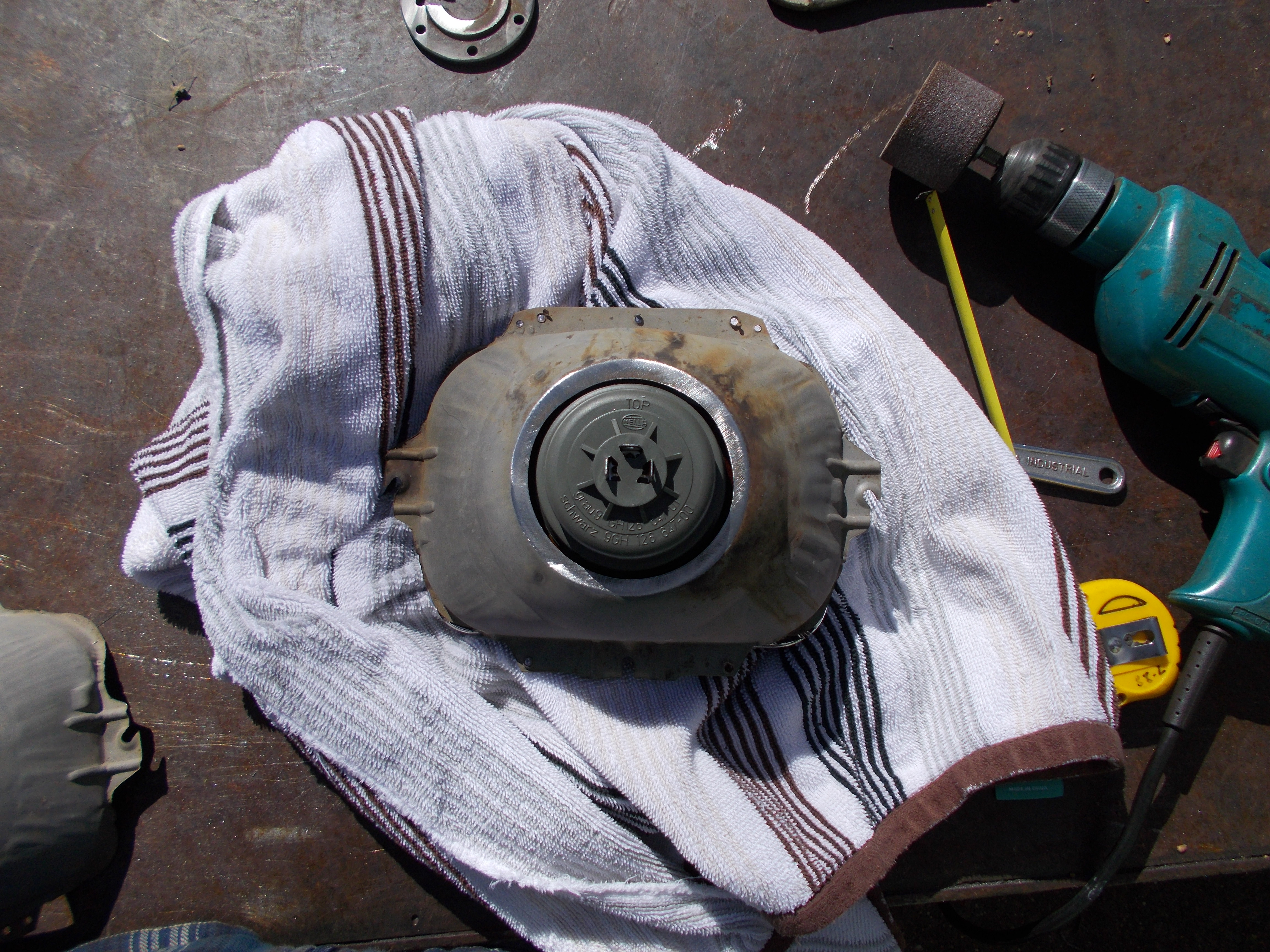

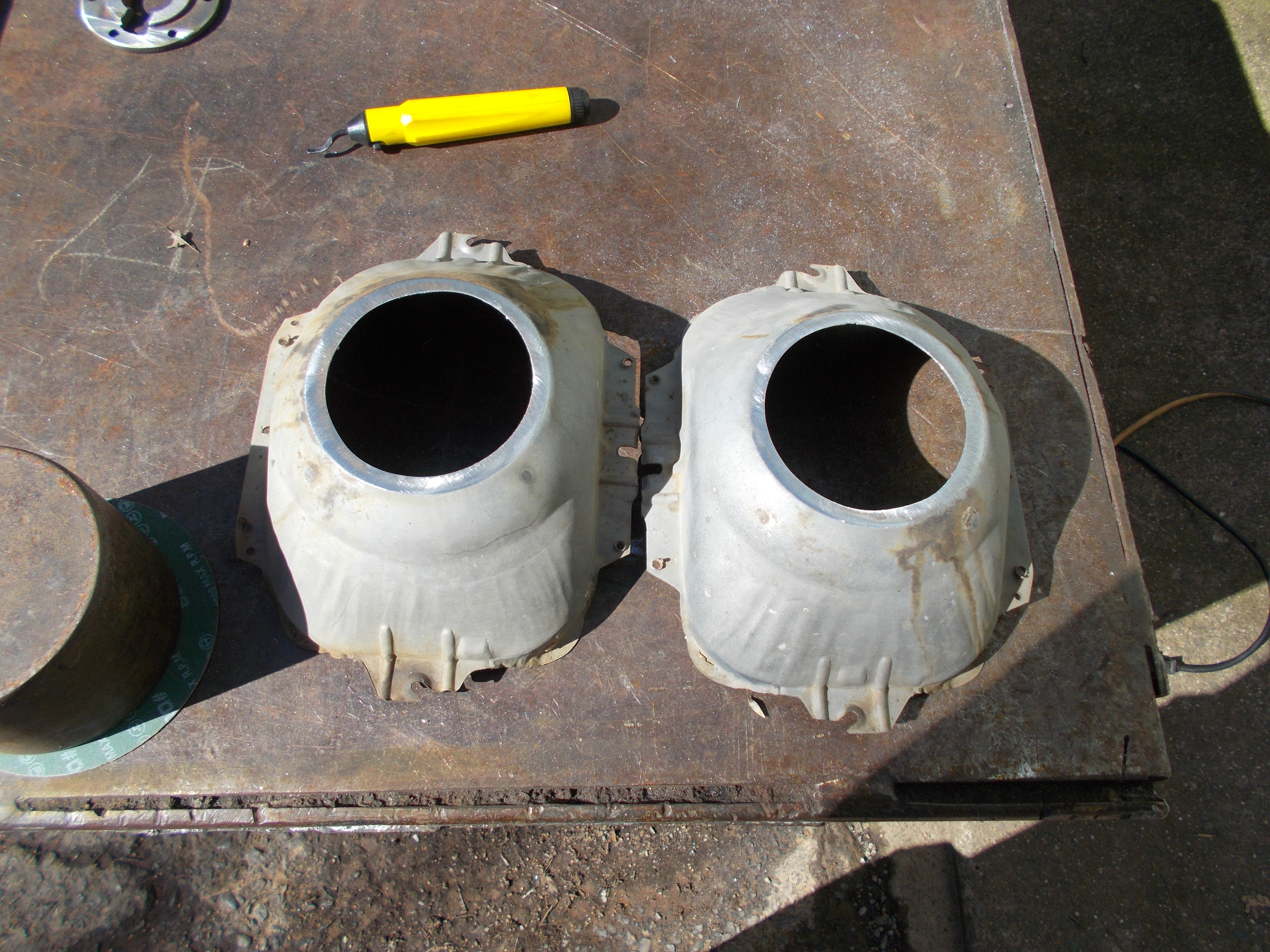

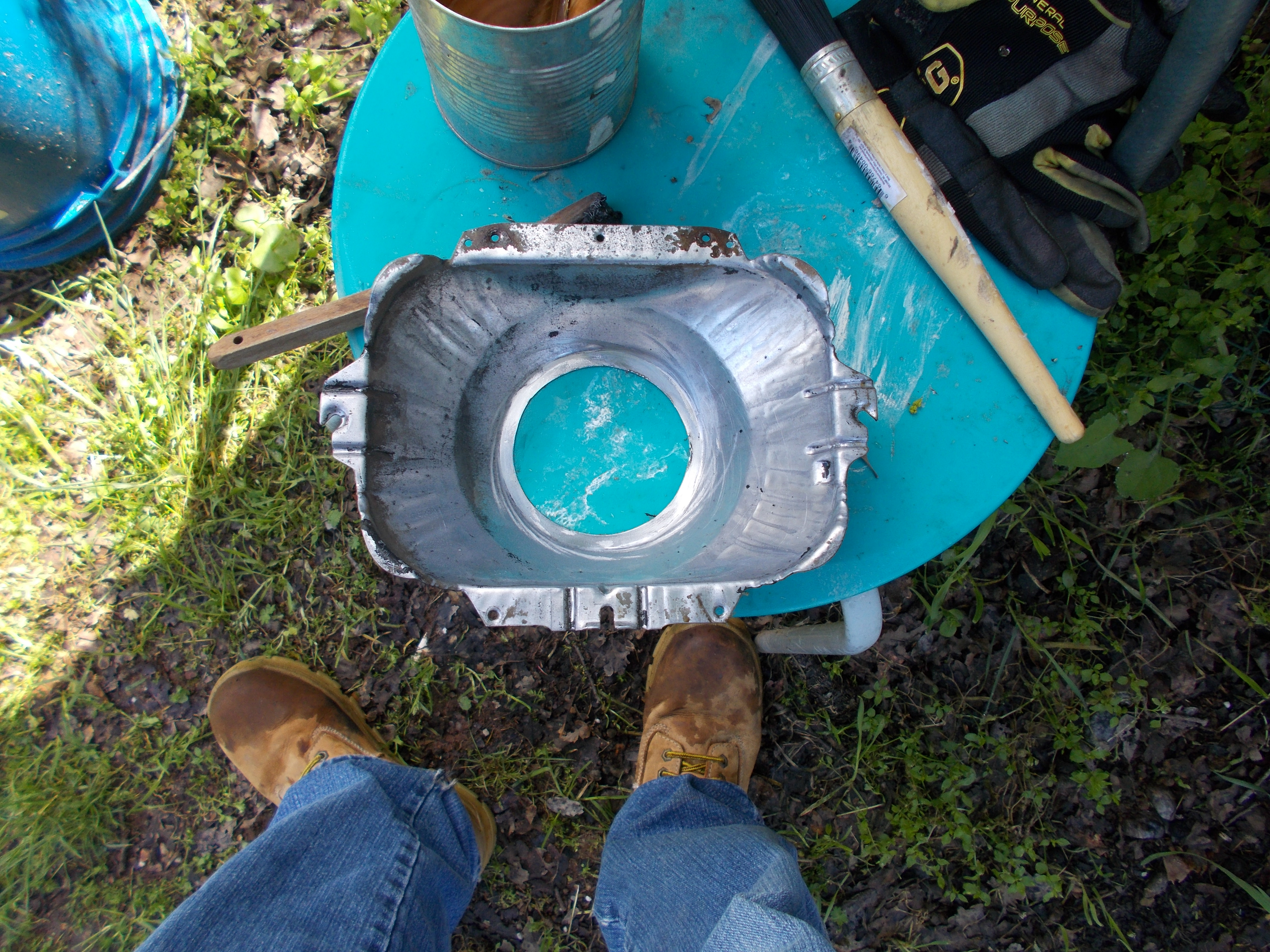

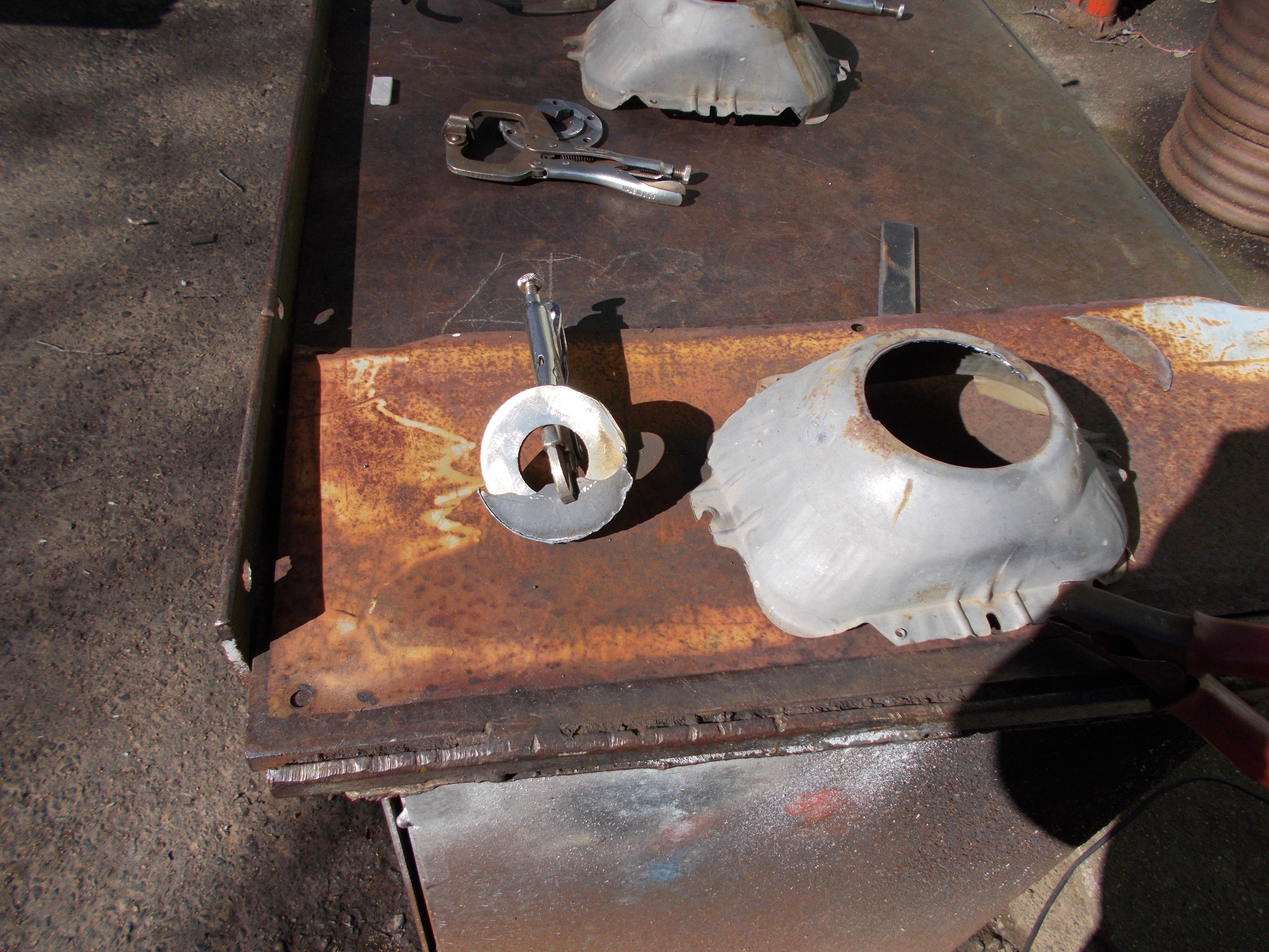

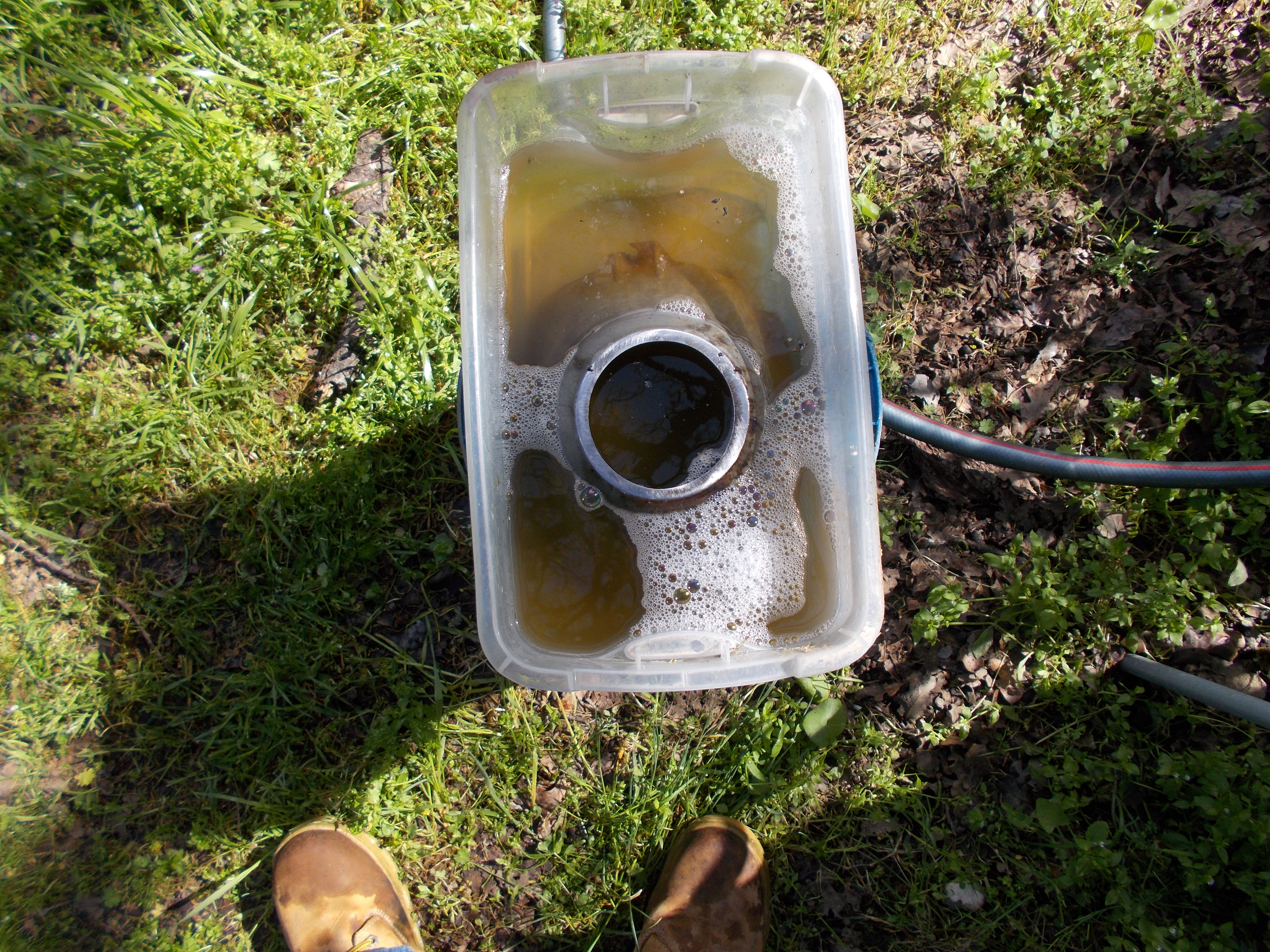

Nice spring morning so I figured I would see how much carnage I could do to my spare headlight buckets.
First I found a washer the size I wanted 2.75. I figured that would be the perfect size for a guide for the plasma cutter to open up the holes in the buckets. I ended up clamping the washer to the half hole then cut it out.
It worked better than I thought it would I didn't have too much clean up with a 2" drum sander on an electric drill motor. After that a little paint stripper and now soaking in Phosphoric acid to etch and get rid of the rust.
Attached Thumbnails 1990 D250 to W250-dscn0316.jpg   1990 D250 to W250-dscn0318.jpg   1990 D250 to W250-dscn0319.jpg   1990 D250 to W250-dscn0321.jpg   1990 D250 to W250-dscn0322.jpg

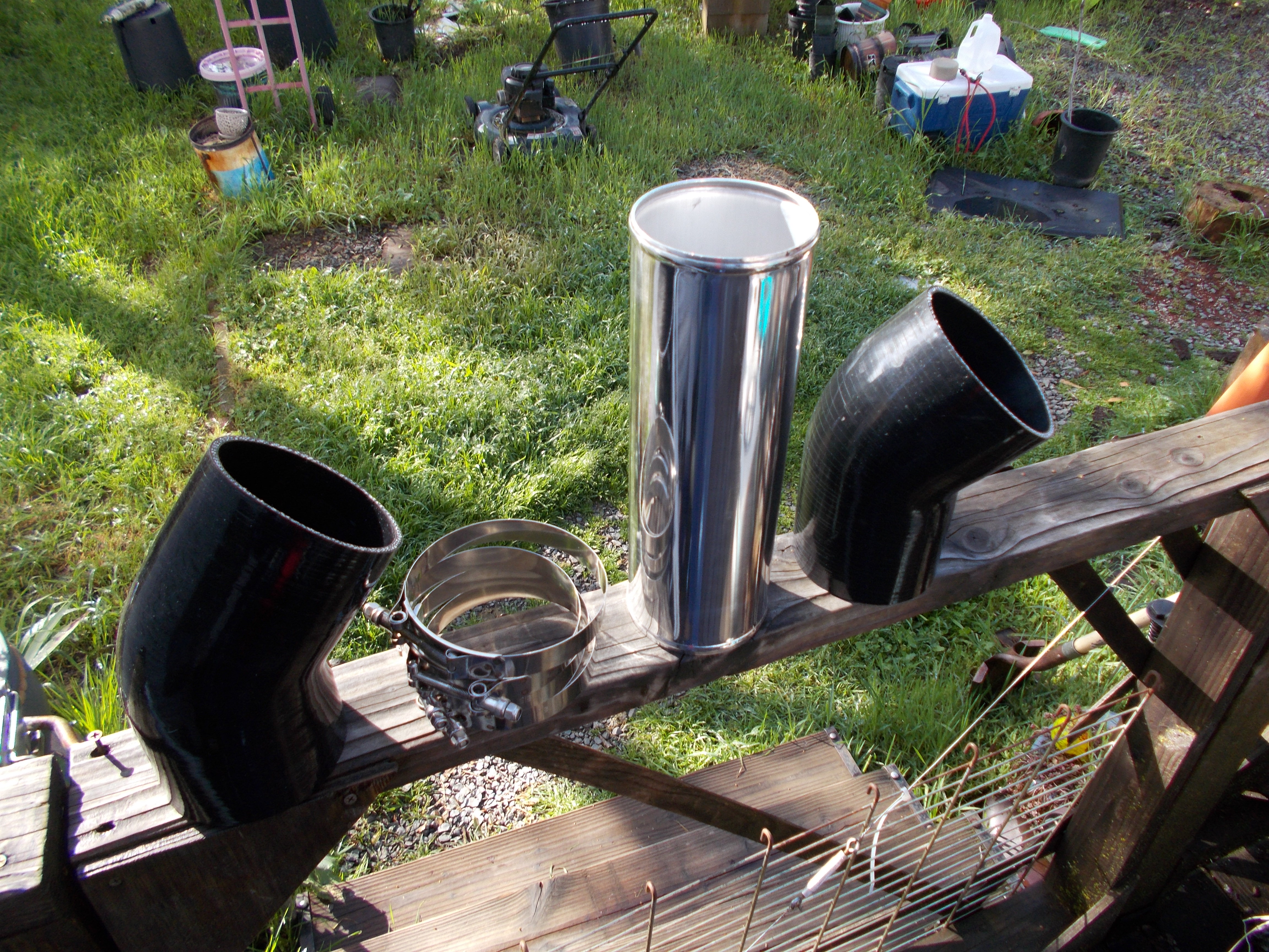

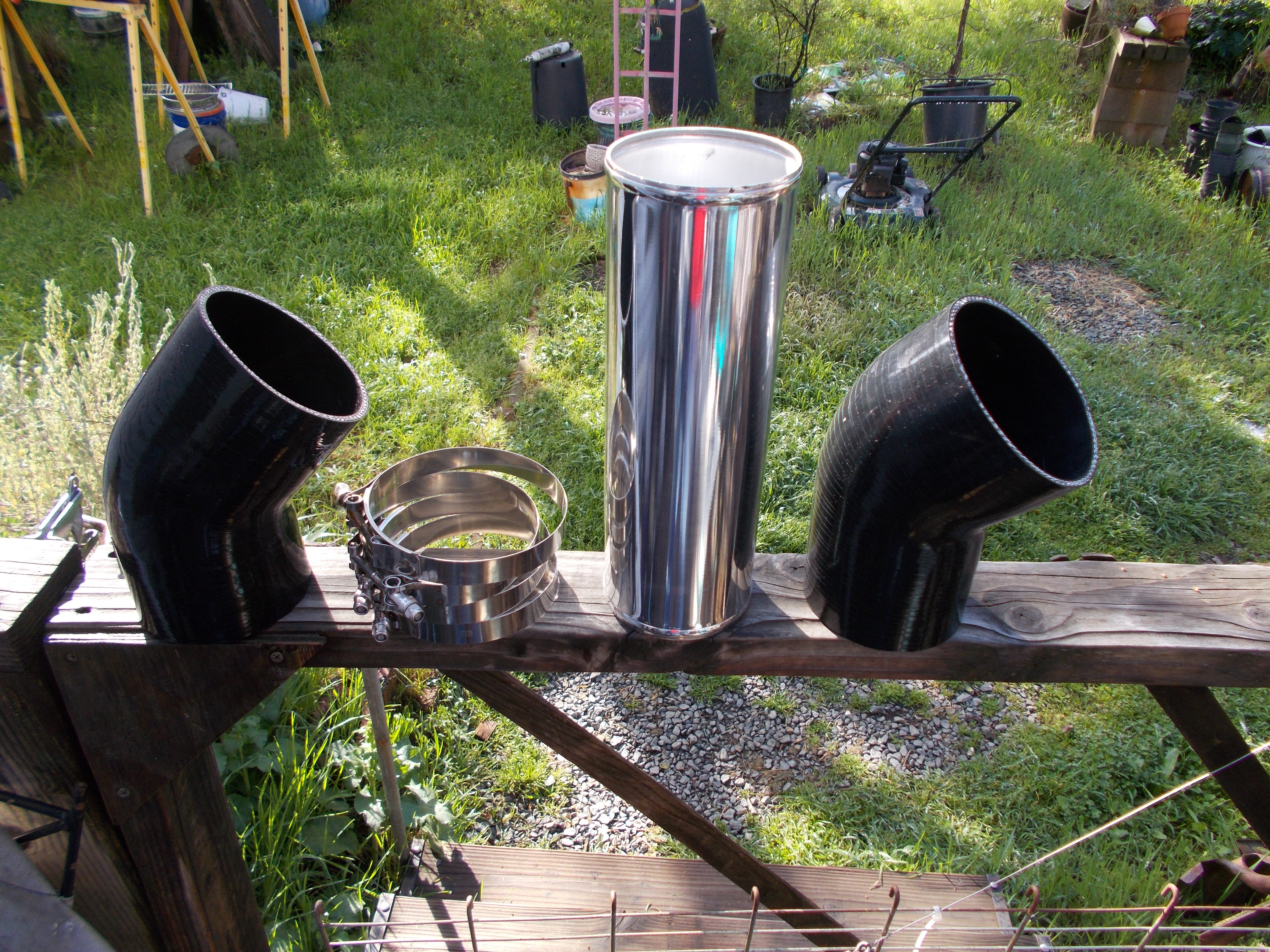

Fed ex has been busy one package from rock auto yesterday (Timing cover gaskets) and another from Silicone Intakes.
Attached Thumbnails 1990 D250 to W250-dscn0326.jpg   1990 D250 to W250-dscn0325.jpg   1990 D250 to W250-dscn0324.jpg   1990 D250 to W250-dscn0323.jpg

Why did u cut the light buckets
Old Mar 25, 2017 | 12:59 PM
  #1120
mknittle's Avatar
Joined: Aug 2013
Posts: 4,918
Likes: 603
From: Tulsa, OK
For clearance for the Bosch e-code headlight conversion. The light is brighter and better controlled than standard sealed beams. The bulbs are changed through the back.
