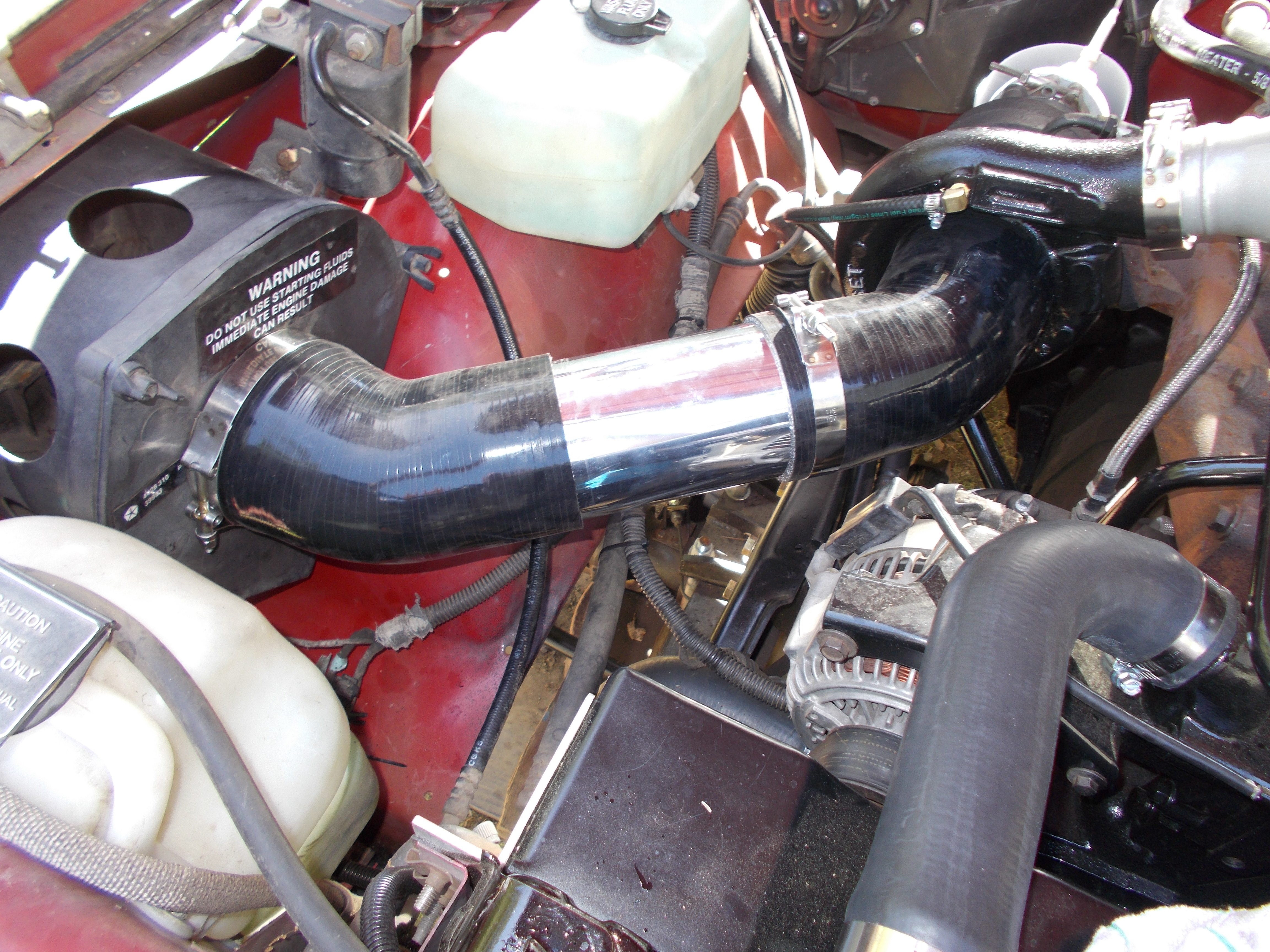

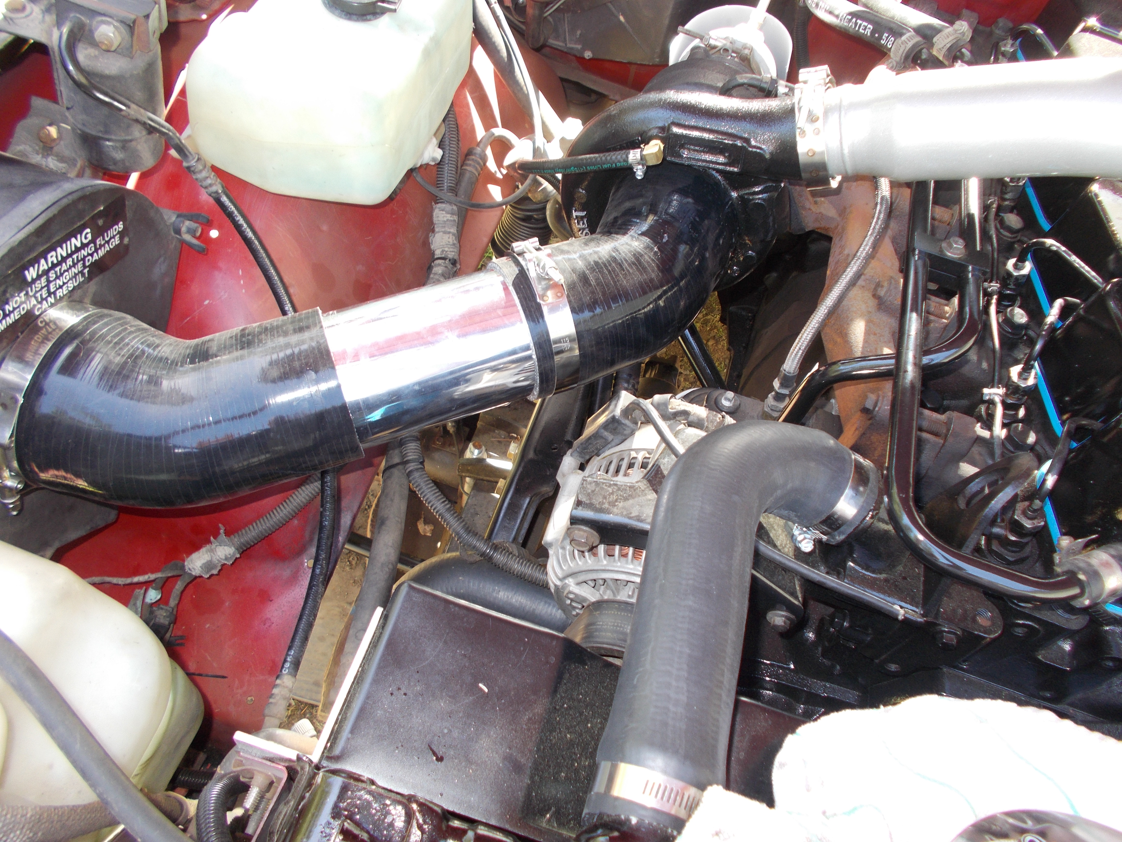

Well moving forward. Looks like I got my fuel leaks stopped. So I started working on my air filter ducting. this is temporary until I get the time and money to get a BHAF.
first off I got the silicone boots stuck in the tube. no matter how I pulled the would only move a tiny bit at a time.
Some how I thought of mixing a little dish soap and water in a rattle can lid. I pulled the silicone boot away from the tube as best I could and poured some of my mixture in between the tube and boot. I worked my way around the tube pulling the boot. when I pulled on the tube it came out so fast and easy I almost punched myself in the face.
so that is how I made the mock up really easy. I put the boots on the turbo and airbox measured cut sanded and filed the tube. pushed the tube a boot to where I wanted it lubed the other side and easily got it into position for marking.
Attached Thumbnails 1990 D250 to W250-dscn0432.jpg   1990 D250 to W250-dscn0433.jpg
Old May 9, 2017 | 03:02 PM
  #1274
That looks good Mark. What's the parts list on that tube and boots...I have already had two stock airbox to turbo tubes crack and split on me, down to my last one so will need an alternative probably sooner then later.
Old May 9, 2017 | 04:15 PM
  #1275
mknittle's Avatar
Joined: Aug 2013
Posts: 4,918
Likes: 603
From: Tulsa, OK
Sure I bought the parts here.
Intercooler Pipe Fabrication
BRE000009 1 each 4.5"to 4" bending reducer.
SIL000433 1 each 4" 45* elbow.
SIL000280 1 each 12"X4" aluminum pipe.
CLA000382 1 each 4.5" t bolt clamp.
CLA000310 3 each 4" t bolt clamp.
I cut the aluminum type to 9"
once I got it together I took the airbox loose to get the filter in and the duct on the turbo just 4 nuts in the wheel well. The airbox end is a tight fit and once i got it on I didn't feel like doing it again. it may stretch a bit before thr next filter change.
