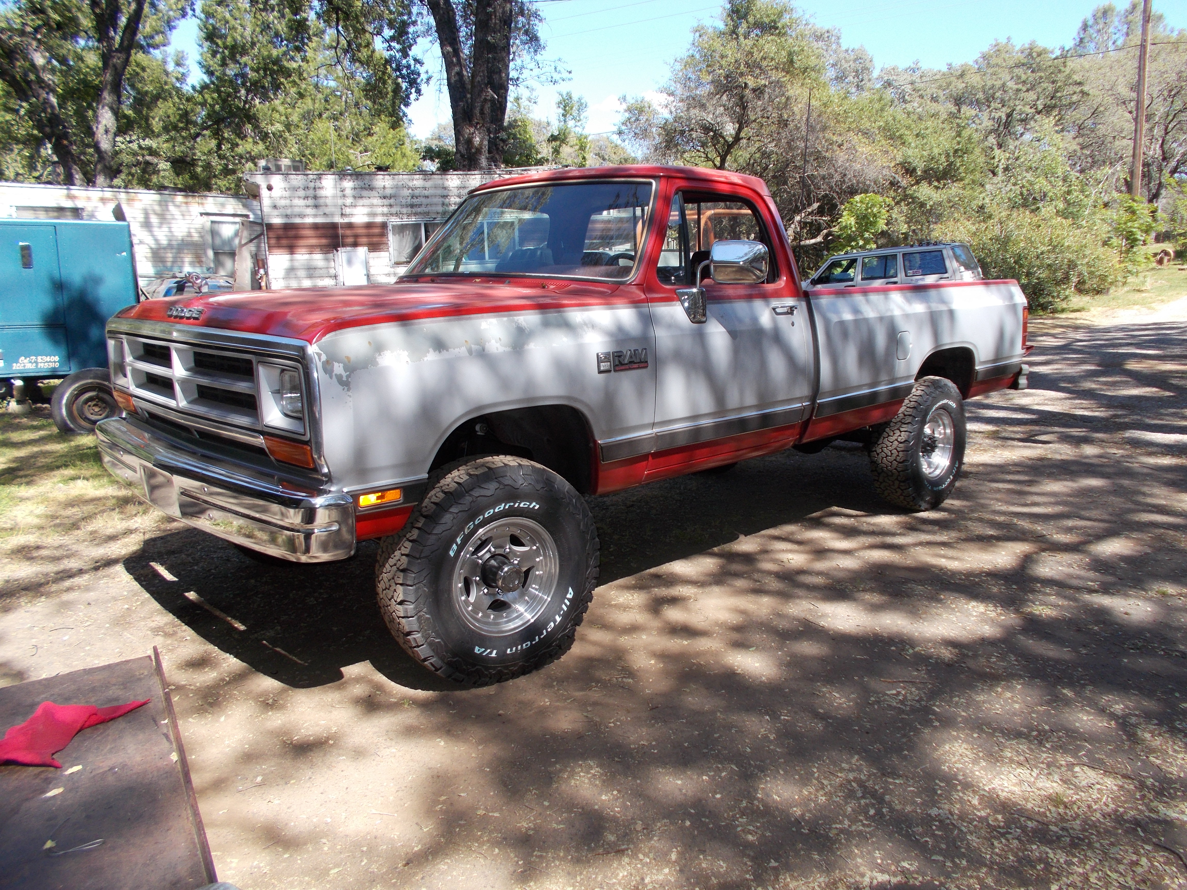

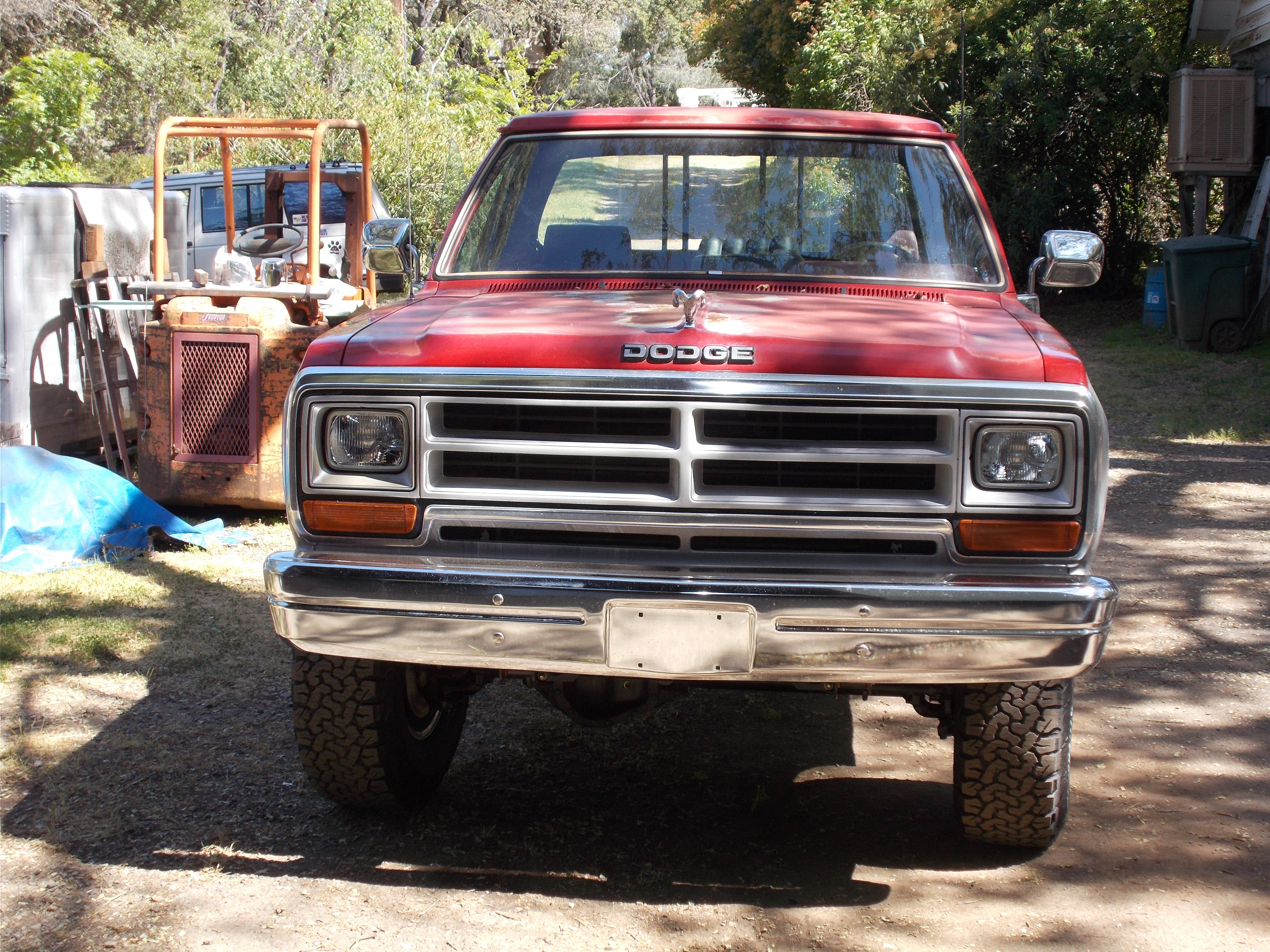

looking a little more like a whole truck. still needs a good couple washings but is getting better
Attached Thumbnails 1990 D250 to W250-dscn0444.jpg   1990 D250 to W250-dscn0443.jpg
