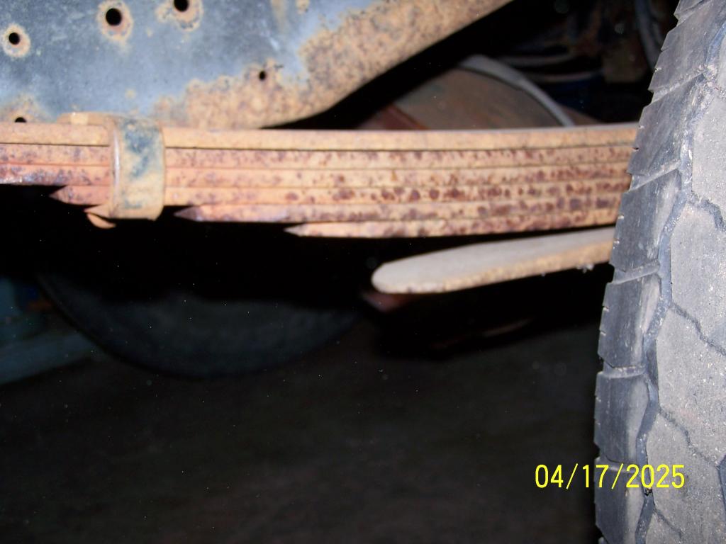

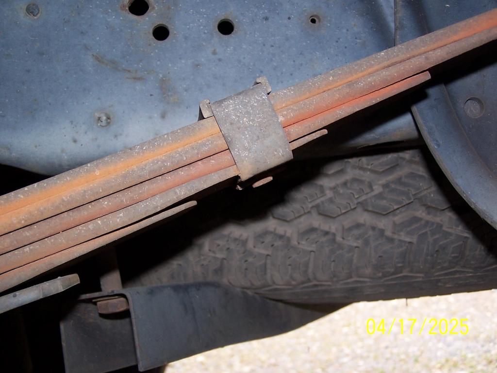

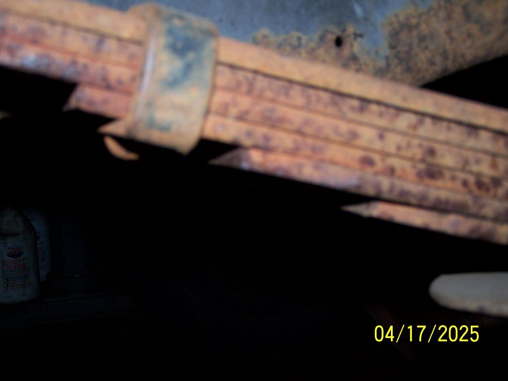

I spent some time last weekend checking the differences of the rear springs on the W250 and the D250. what I found is interesting. Both trucks have the same GVR of 8510lbs
the W250 leaves (below the main leaf) have square cut and have 6 regular leafs and one heavy leaf. rating is 3250lbs
The D250 Leaves have tapered ends (below the main leaf) and have 5 regular leafs and one heavy leaf. rating is 2500lbs.
The bushings are also different. The W250 uses a bushing OD of 1.5" the D250 is 1.250" both use a 5/8" bolt.
I decided to keep the D250 springs (same GVR) and maybe a better ride.
If there are problems with sway and/or wheel hop I can do something about that and keep my better ride too.
D250 right W250 left
Attached Thumbnails 1990 D250 to W250-100_4942.jpg   1990 D250 to W250-100_4943.jpg

OOPS wrong picture the above are both theW250.
here is the D250. I was looking at the pictures this morning and thought " my frame isn't that rusty"

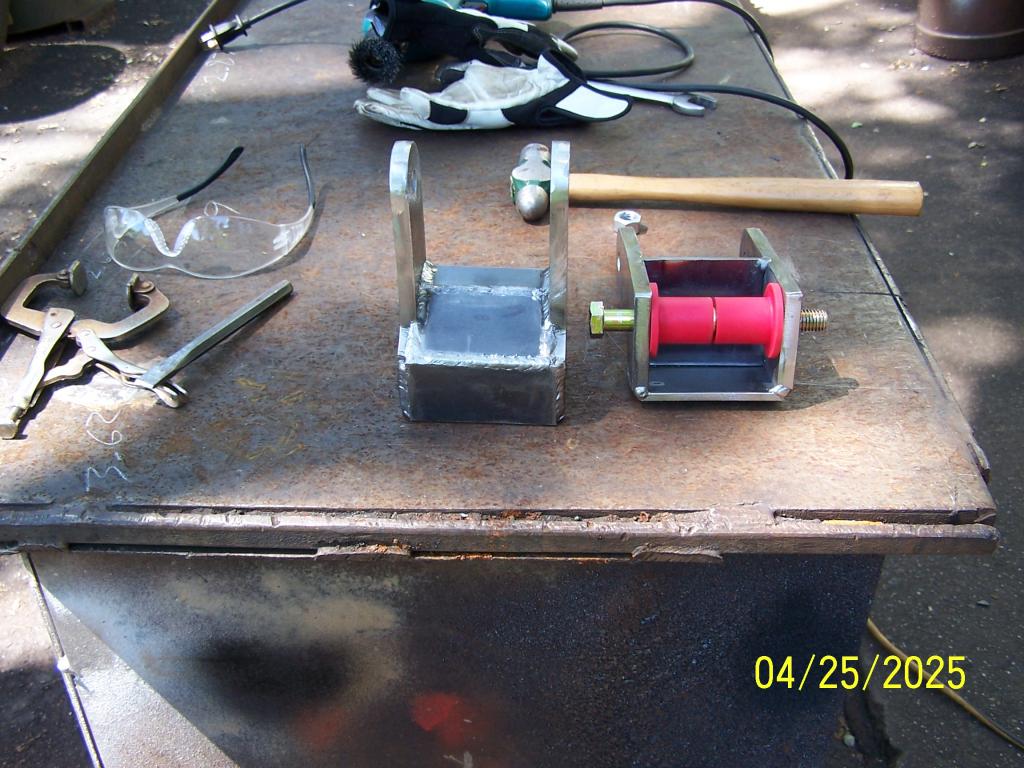

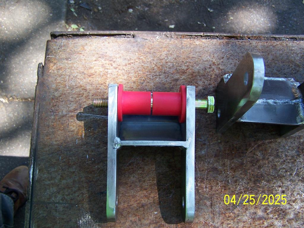

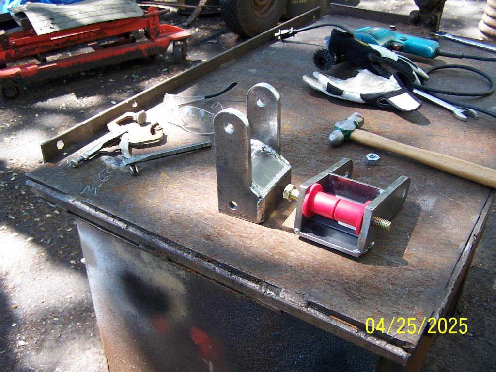

Well here are the shackles The side plates are 3/8" They came out OK. we will see how they work.
They need a little more clean up though. I don't know what it is about this camera but no matter what it makes weld beads look awful.
P.S. these are for the stock length springs.
Attached Thumbnails 1990 D250 to W250-100_4946.jpg   1990 D250 to W250-100_4947.jpg   1990 D250 to W250-100_4949.jpg   1990 D250 to W250-100_4948.jpg

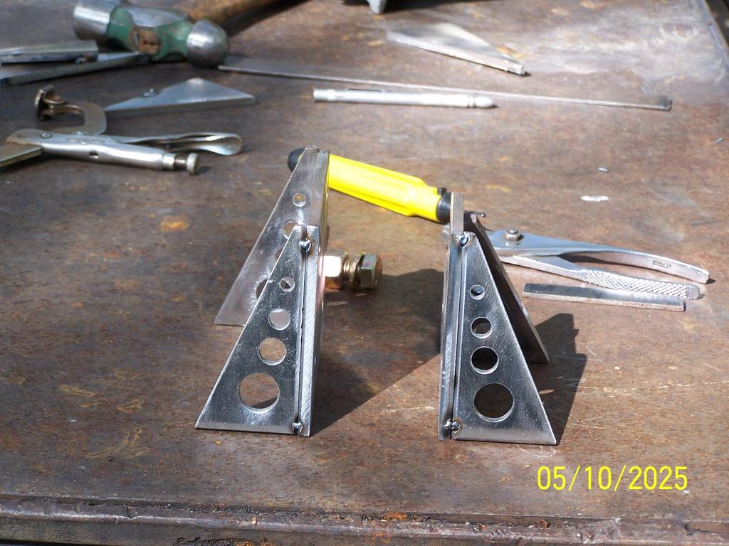

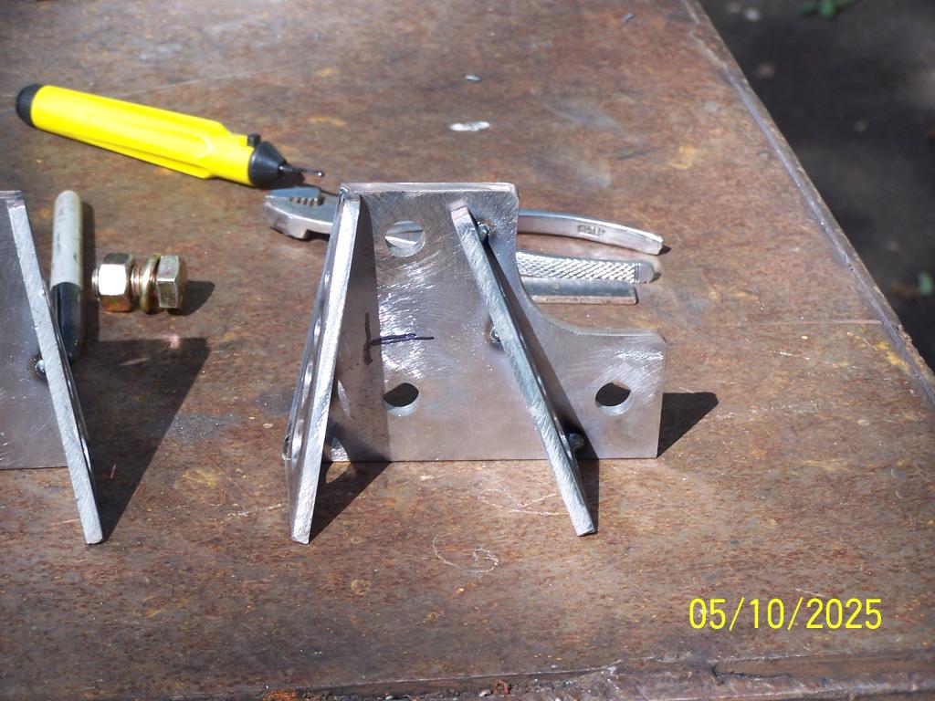

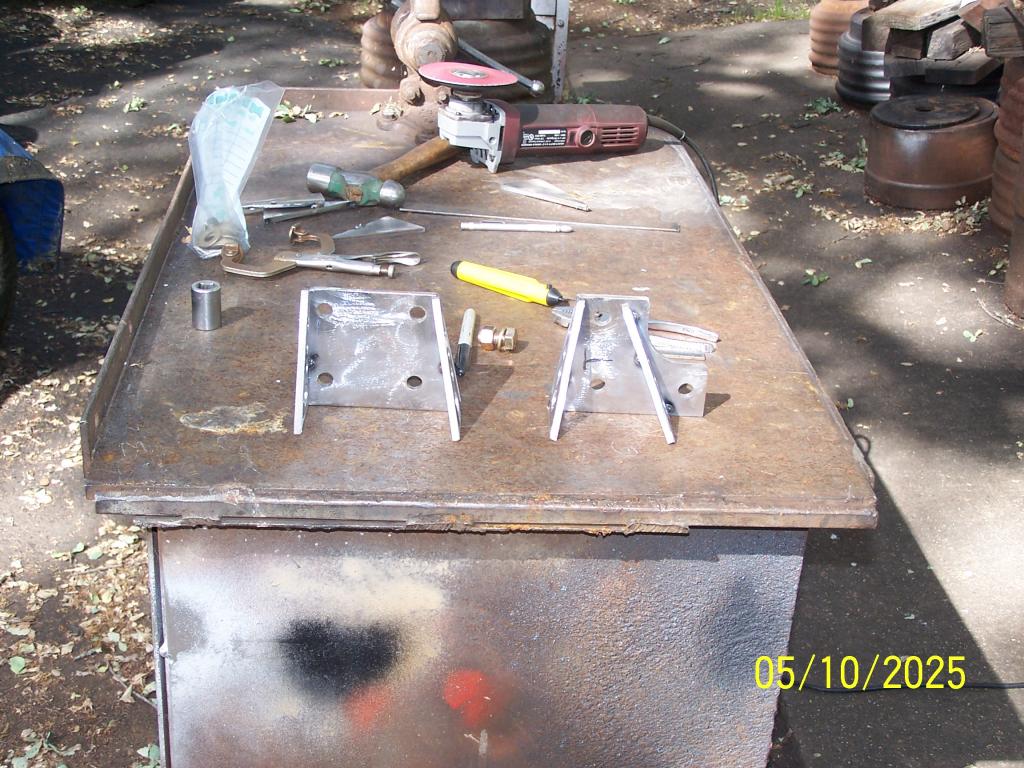

I did some work on the vertical part of my front spring hangers these will replace the factory ones with the unused core support holes. At this point they are just tacked together. I originally mad the gussets for something else that never got very far I know the holes don't do anything but I think it looks better than the plain ones I started with.
Attached Thumbnails 1990 D250 to W250-100_4951.jpg   1990 D250 to W250-100_4953.jpg   1990 D250 to W250-100_4954.jpg
