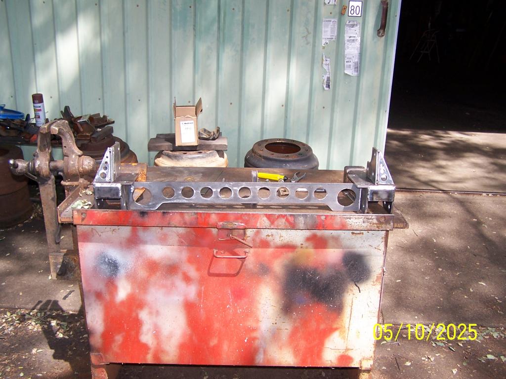

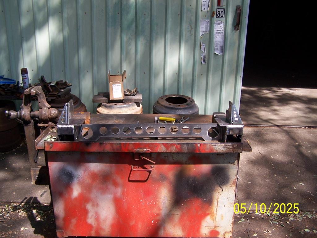

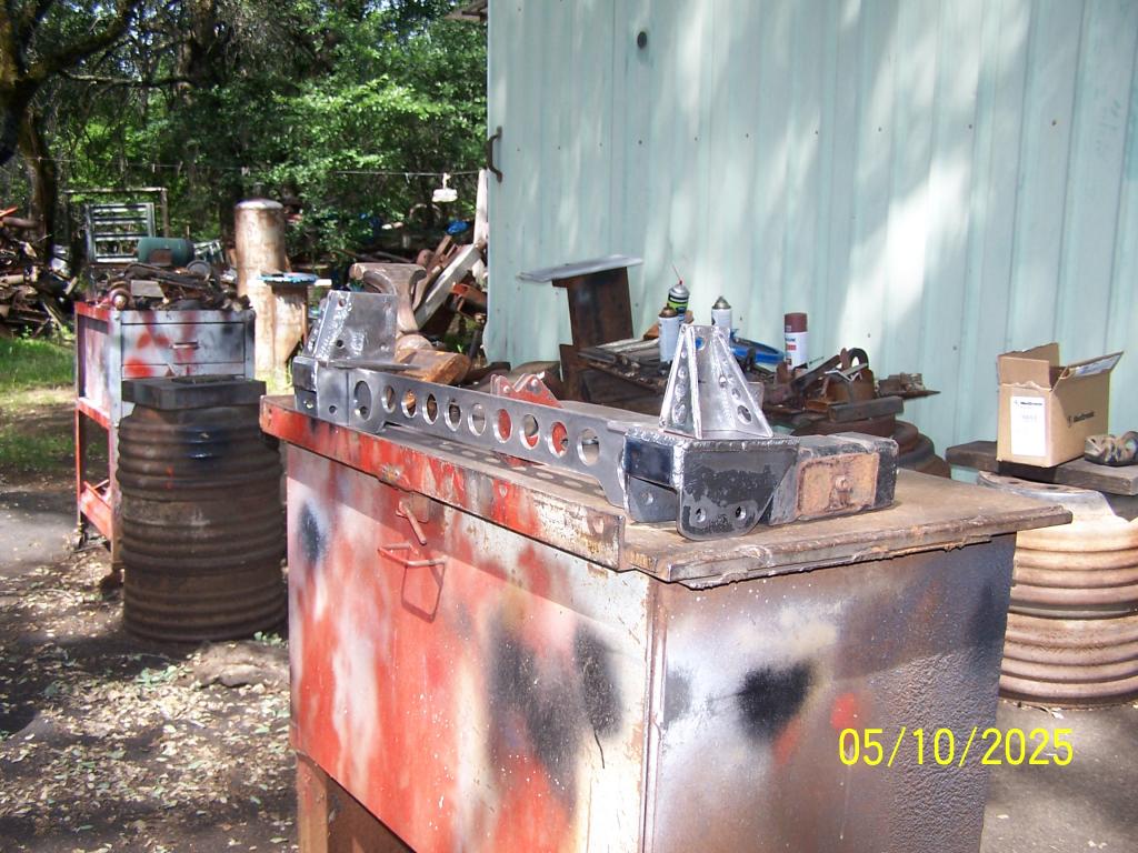

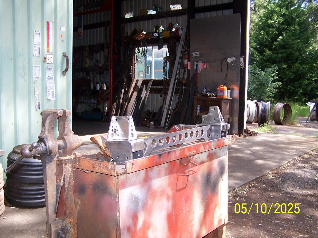

A little more just to see how it all goes together. It is just sitting together so ignore the stuff in the back it is just to keep it all from falling over. most of it isn't welded yet. I will do that on the truck. At least tack it good)

That is going to be STOUT!! And look good while doing it....
Have to ask on that kick a$$ vice....how old and where did it come from?
My dad came home with that vice one day about 30 some years ago. I have no idea where he got it.
My guess on age would be somewhere around the late 1800s to early 1900s
I have seen them in old blacksmiths shops.
My goal on the spring hangers is to allow torsional movement but restrict side to side movement. I think that is what cracks the factory hangers.

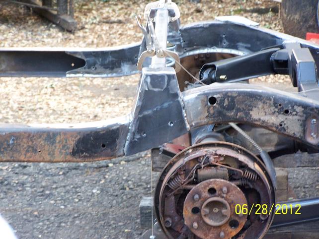

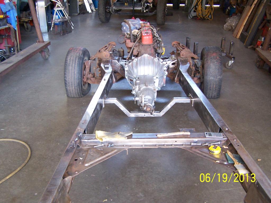

Here is a picture of my long term project. It is a 52 GMC 1/2 ton. I cut the frame off at the firewall and grafted the front of a 75 Camaro sub frame to it. I also boxed the frame and made a cross member ( imagine that)
To fit a 76 Monty Carlo triangulated four link.

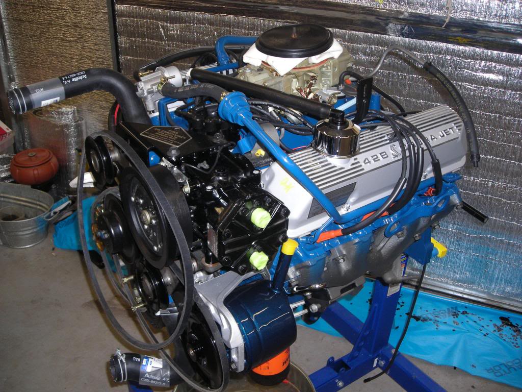

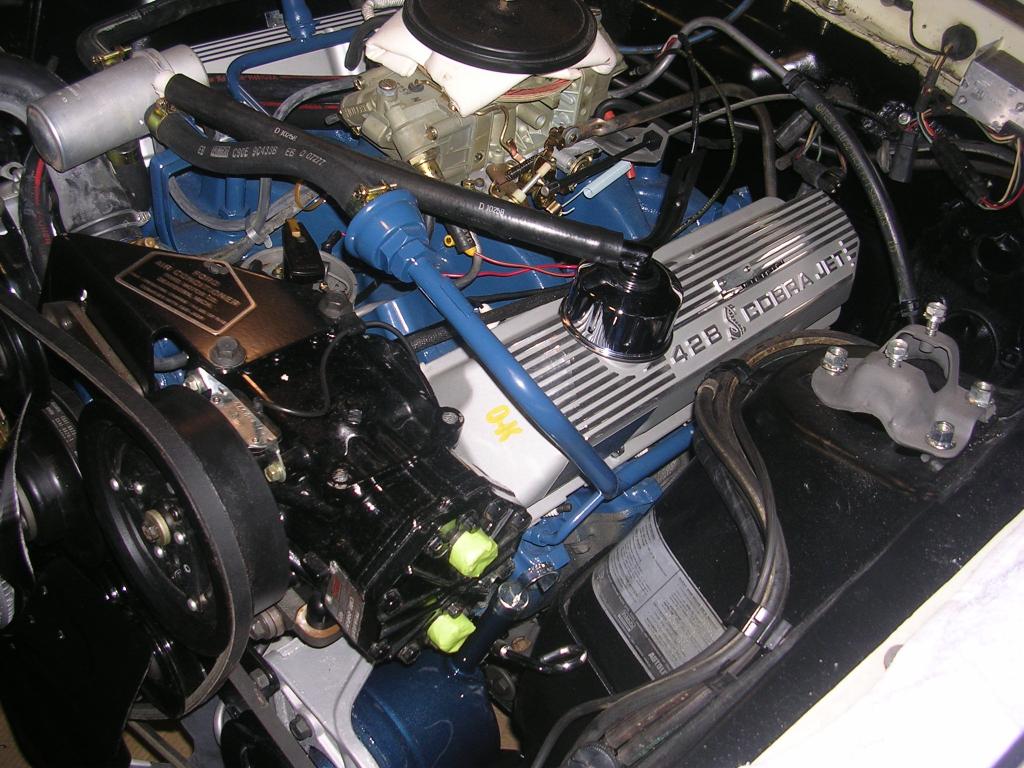

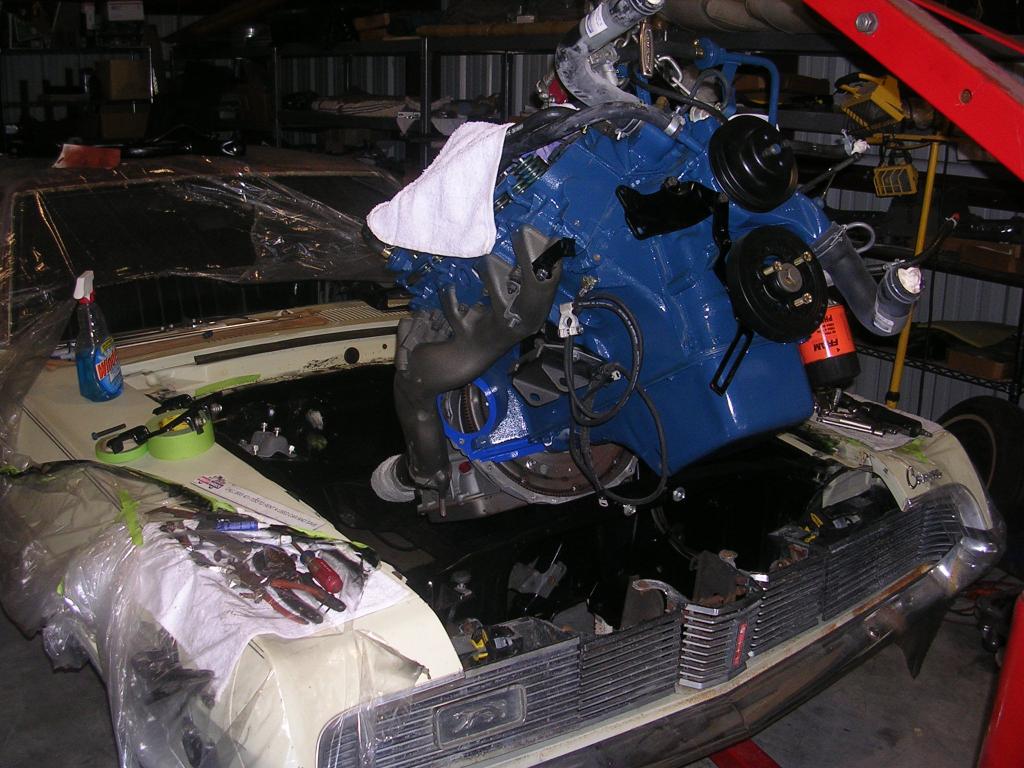

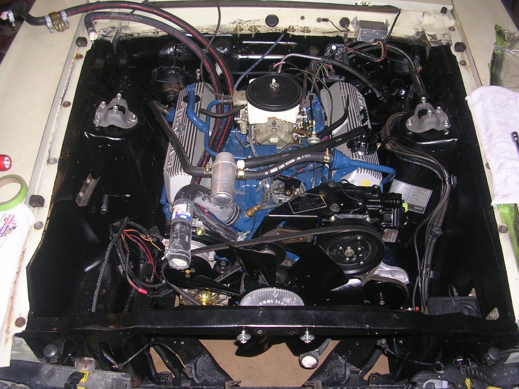

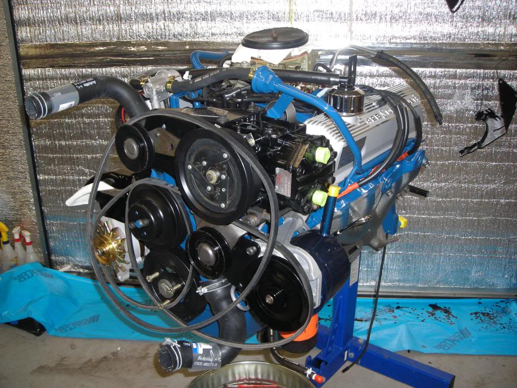

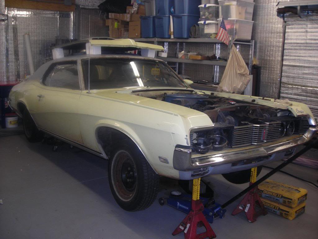

This is the motor for My 1969 Mercury Cougar XR-7 428 Cobra Jet 1 of 6.
This is where I get all my detail orientedness.

Originally Posted by brcron007
It is a SICKNESS. and we all have it.
I thought I saw a Cougar in the background in some pictures in your build thread. I am a big fan of the cougars. Very nice!
Whoa, way cool to know they put a 428CJ in the XR7.
A buddy has a pair of Eliminators ( 69 and 70 ) in 428CJ, but never knew they did any XR7's.

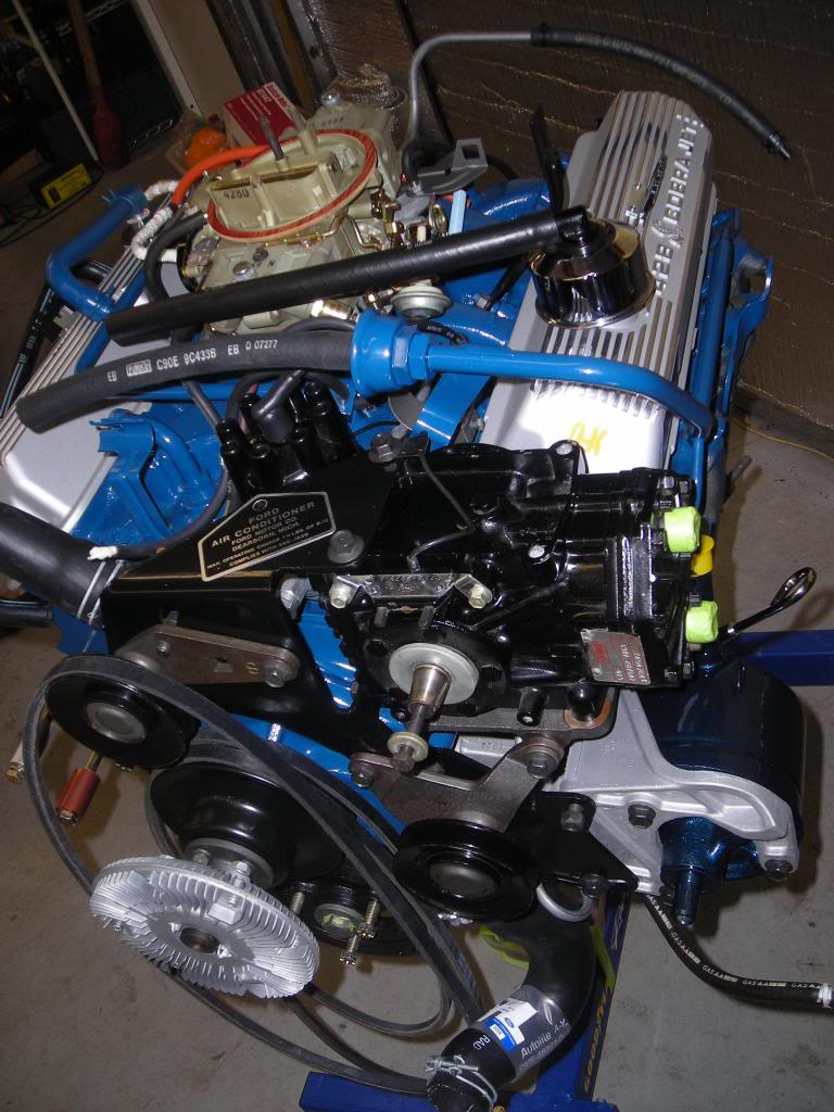

HI MK, Not tryin to take over your post. I've had my XR-7 a long time. It took 13 years to find all the missing date coded motor pieces. So she was just like she rolled off the Dearborne assembly line.
I was the one that hijacked my own thread
like I said I am a big fan of the early cougars and a big block powered one is all the better.

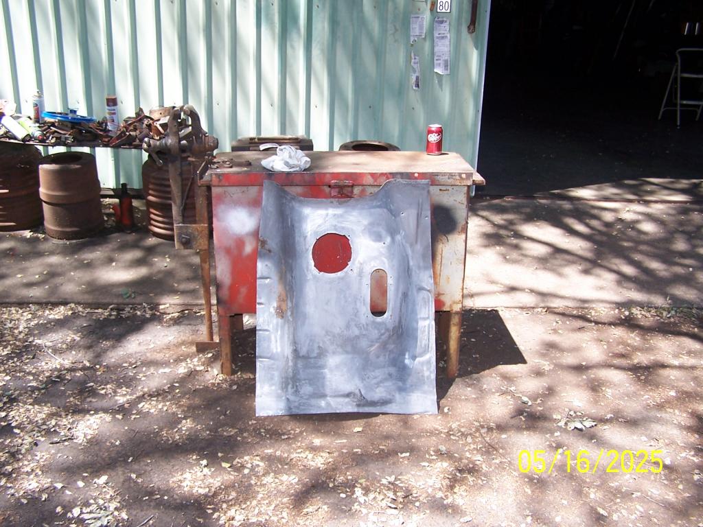

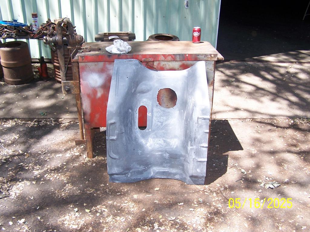

Todays fun at least so far. I am going to cut out the stock D250 transmission tunnel and replace it with this one from a W250
I hadn't planed to go this far on this but there are random little surface rust spots here and there. I figure the only way to get them all is to strip the paint off the part.
I still haven't decided where and how much I will trim off the sides. Here it is so far.
