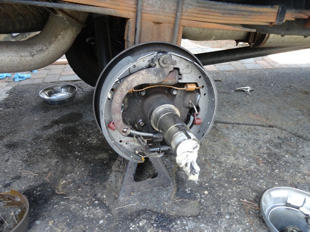

I think we're long overdue for photos on this thread, eh ?

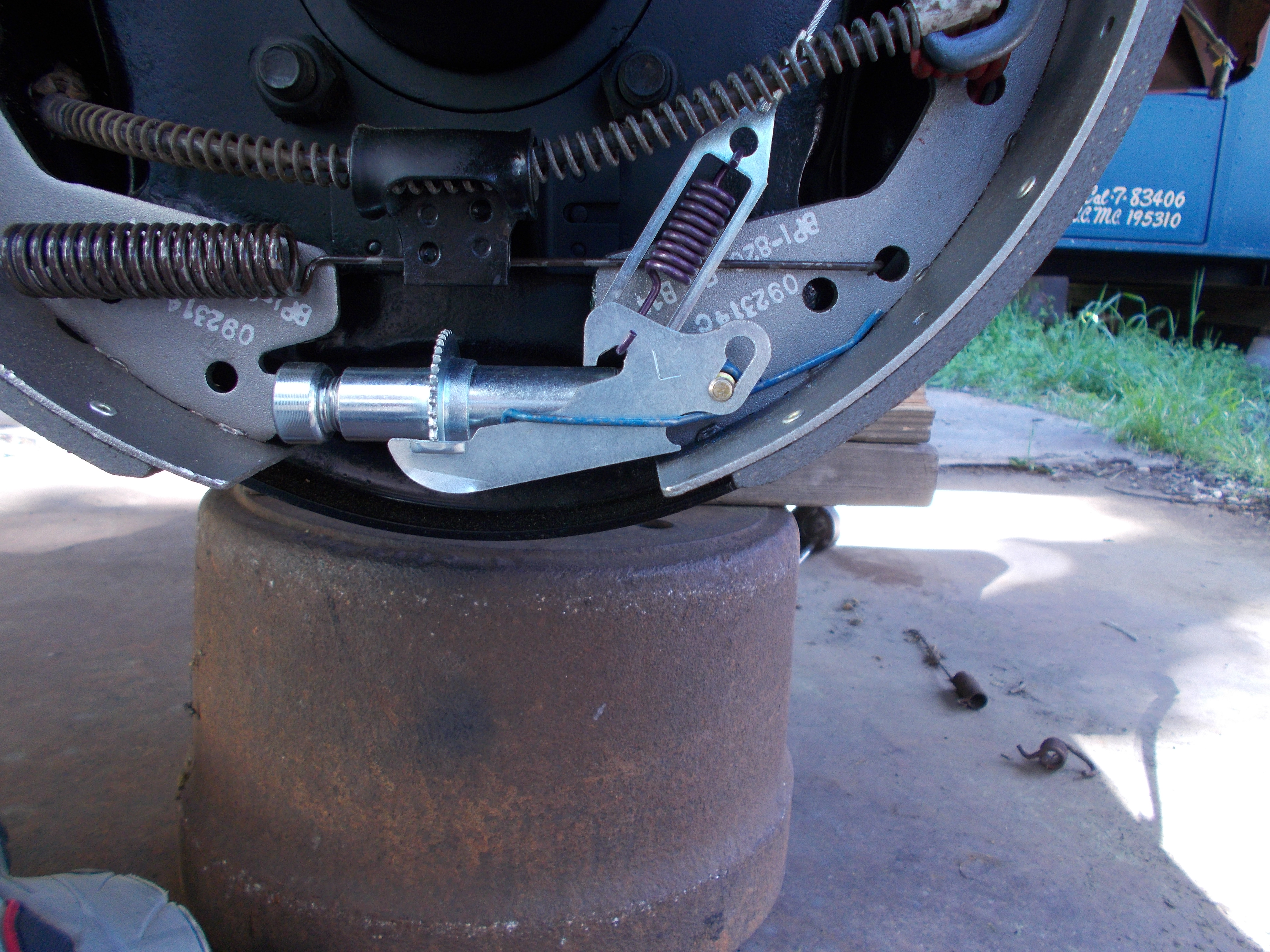

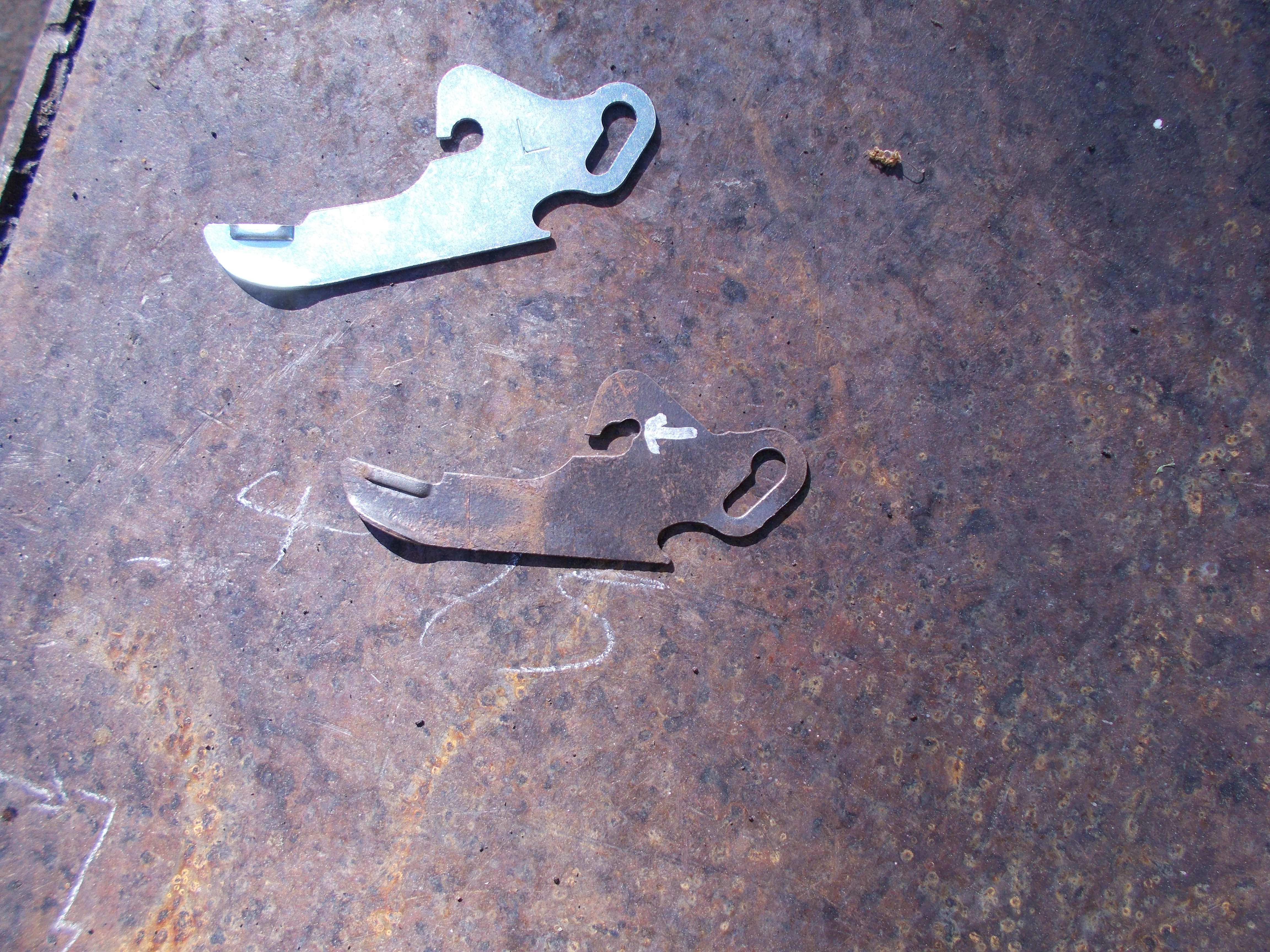

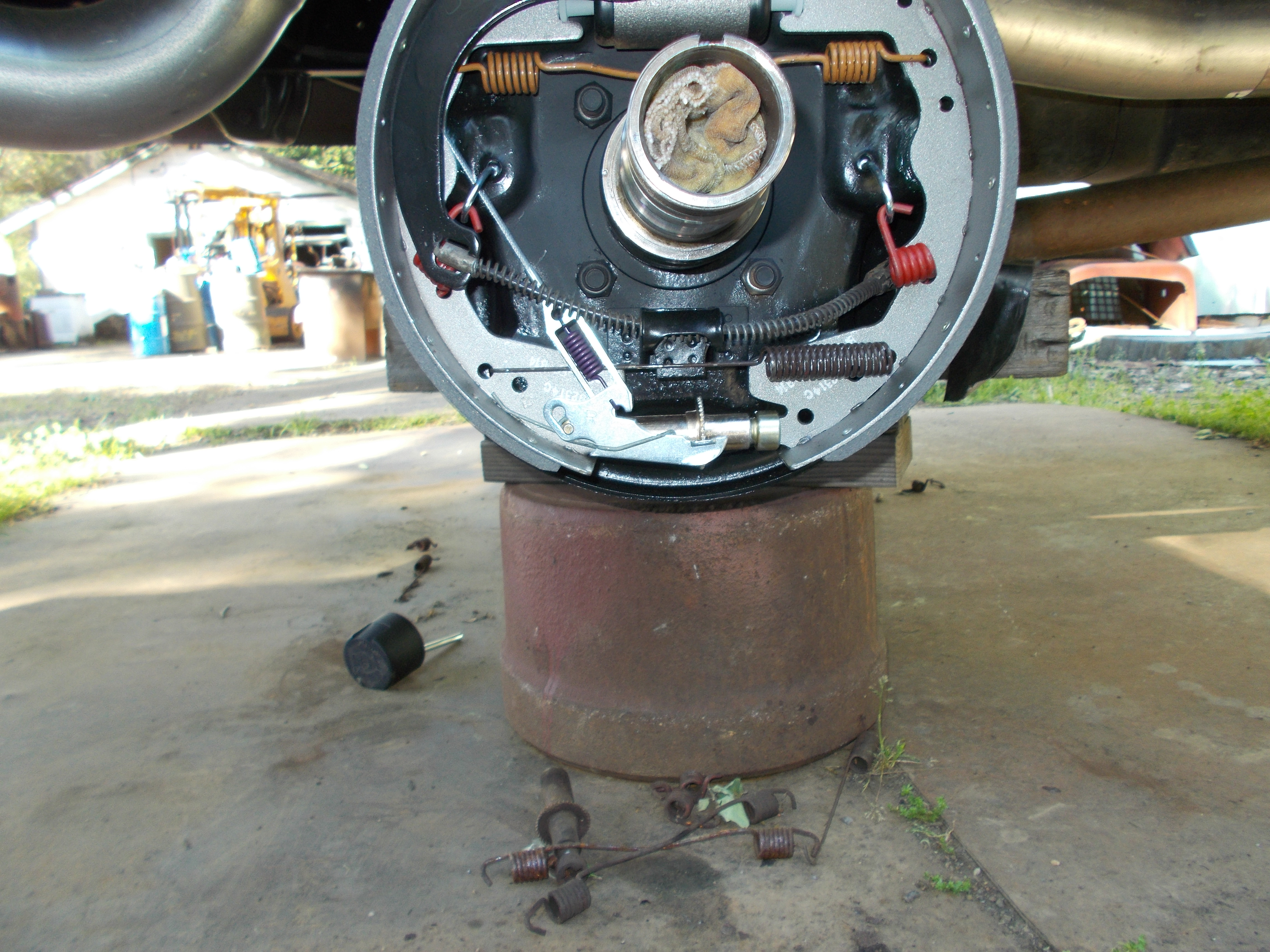

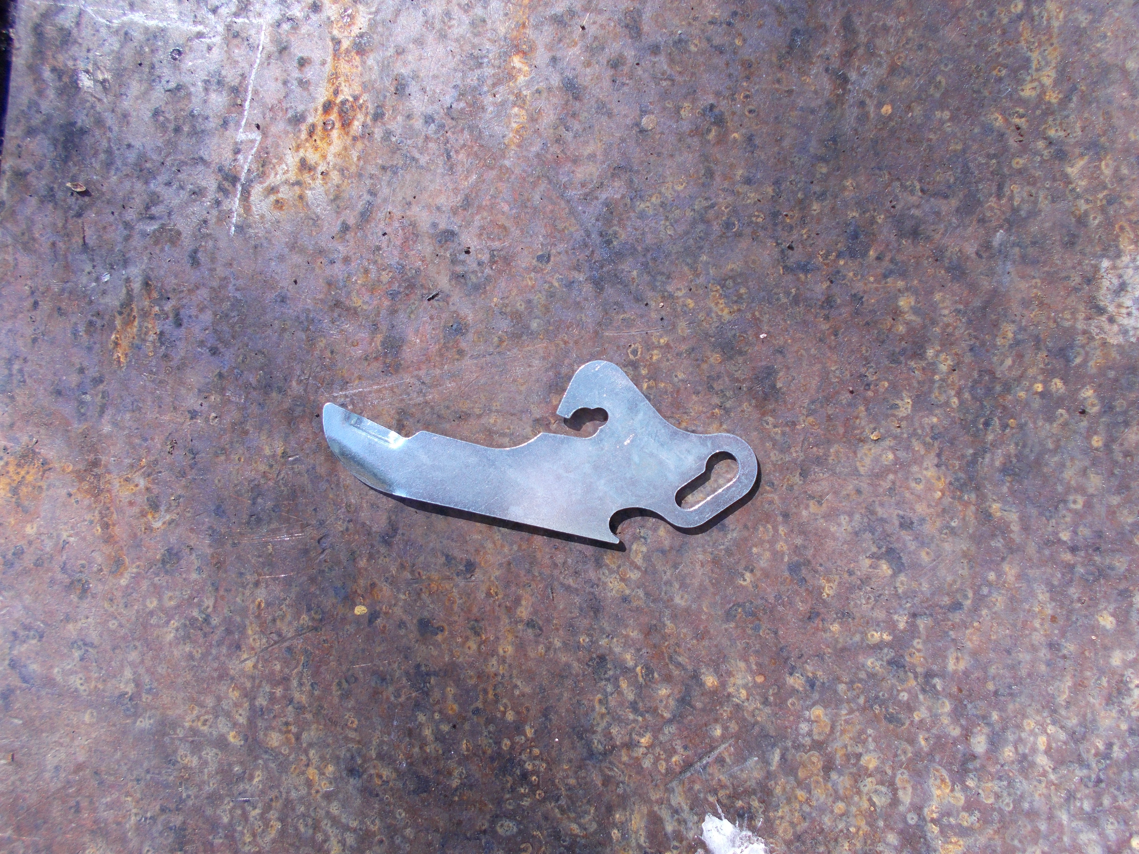

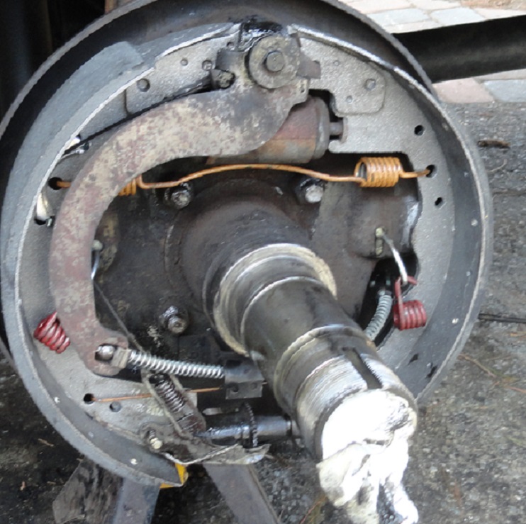

OK and the fix. I used one of the old parts to experiment on. I replaced the new offending part with the old part. I did exactly the same thing so I marked it where the spring sat. A3/13 chainsaw file worked perfectly to make a small elongation that moved the adjuster downward.
Pic 1&2 the problem the adjuster is too high on the star wheel to move it.
Pic 3 the experiment.
Pic4 the fix.
Pic 5 the result. A working adjuster.winner winner chicken dinner.
