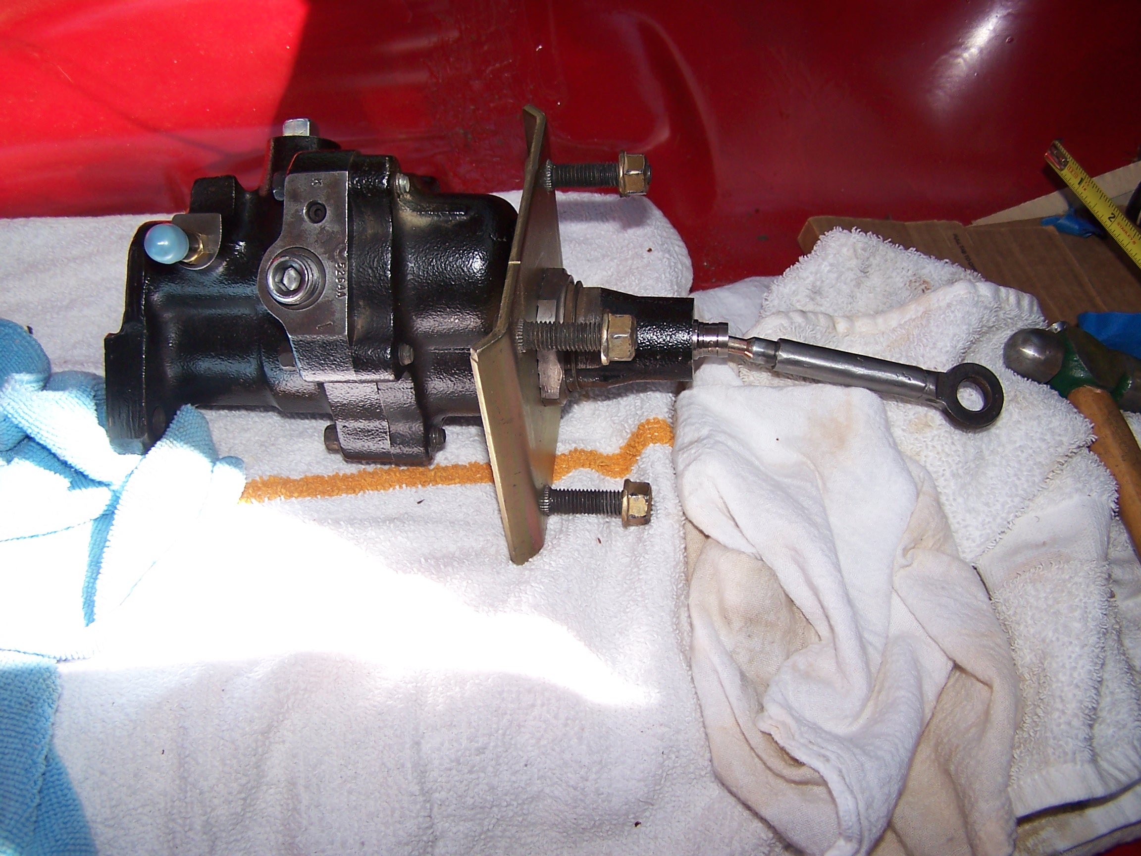

Today I installed the seals in my hydroboost and reassembled it.
Hopefully there will be no leaks

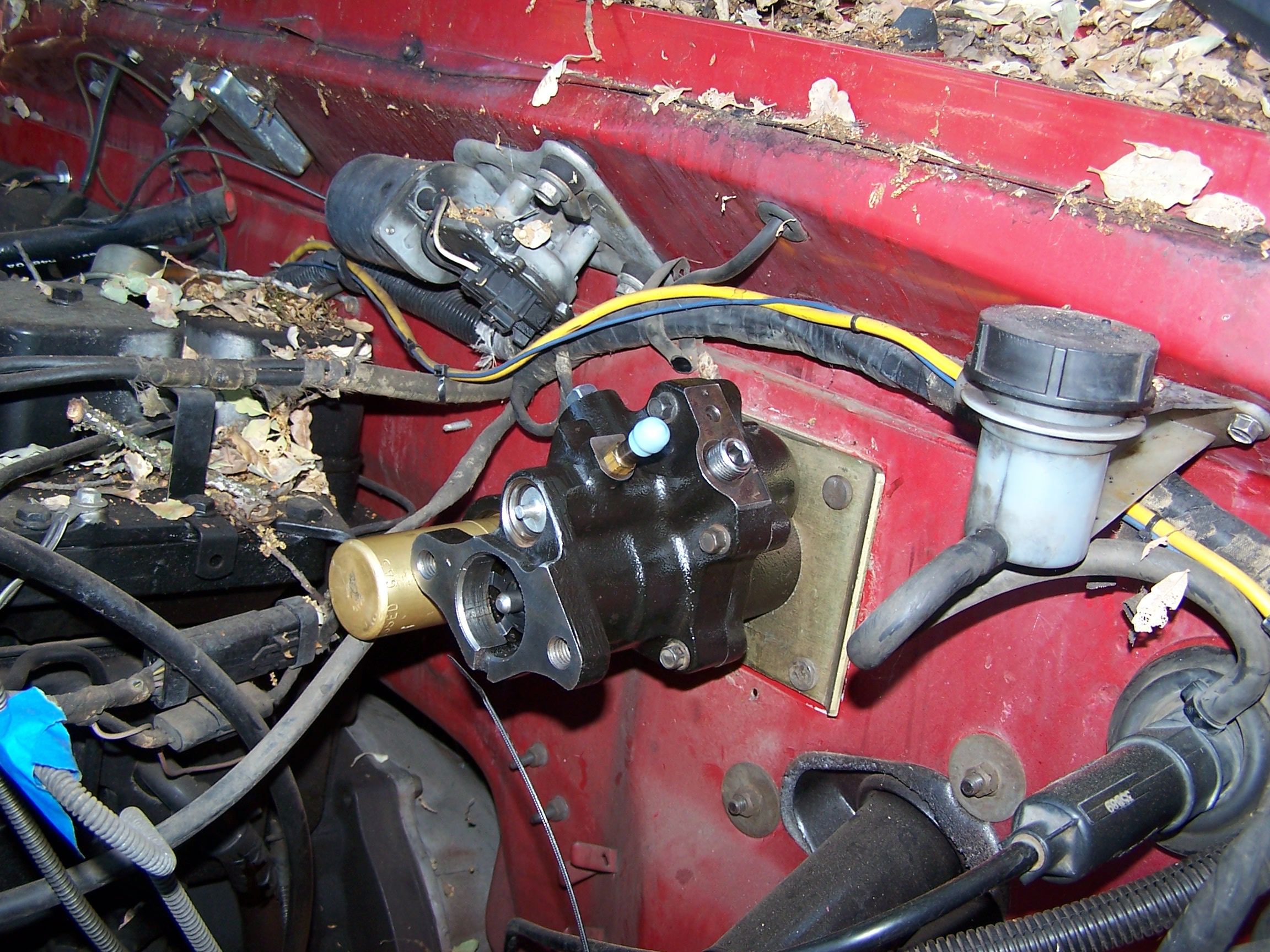

Just for fun I tried the astro van hydroboost mount. I fits like it was made to go on a first gen. This is from a mid 90's astro. I may change the pushrod to a adjustable one to get the pedal a bit lower.

Looks great Mark...I'm a bit jealous that it's just a drop in! But good info for those who are wanting to source these parts from the wrecker.
Didn't you already order the adjustable push rod? And how did you re-stake the pushrod?
Yeah I did get an adjustable pushrod. but I ordered the wrong pedal end so I made one but It isn't hard steel so I have to get a bushing.
I didn't stake it yet,Just in case it leaks. I had to tap it in with a small ballpein hammer and couldn't pull it back out by hand. If it needs to be re staked I think I will drill a 5/8 hole in a piece of scrap 3/8" then cut it in half to make a cradle to support the input rod. For a tool I think a small chisel rounded off and shaped to fit would work.

Originally Posted by NJTman
Chevy astro van ? In a dodge? Frankenstein would be proud
I am not so good with the electronics to tackle something like that
But I like ditching the stock master cylinder.
My father is fixing to learn why I did the swap, He got a rebuilt MC from O'realy's. The complaining shall soon begin.
