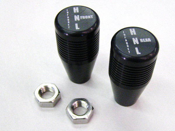

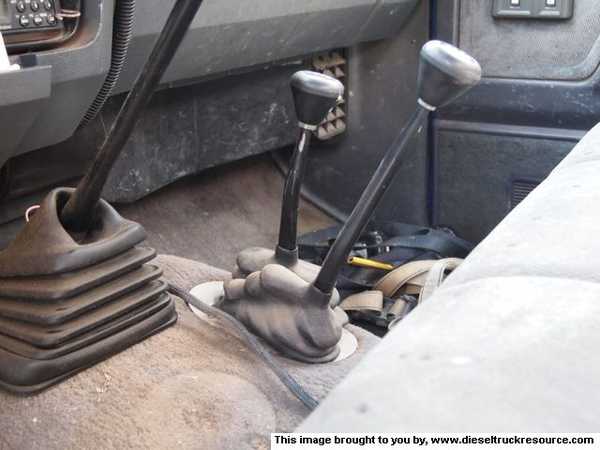

Not to derail this thread, but can someone explain just how a twin stick works ?
Is there a special transfer case that's being used ?
Is this the boot you would use ?
http://www.4wheelparts.com/Drivetrai...9EIaAgOB8P8HAQ
Old Aug 10, 2014 | 12:45 PM
  #276
Posts: 7,293
Likes: 2,884
The 2 sticks make it so you can choose cool gearing options like 2L.
You use the same stock NP-205.
If you look at your NP-205 it has two "rods" that operate the gearing selection.
They are connected to one bar that your stock 4x4 linkage is connected to.
Using the twin sticks each rod is operated by each shifter linkage / lever.

Old Aug 10, 2014 | 01:04 PM
  #277
mknittle's Avatar
Joined: Aug 2013
Posts: 4,918
Likes: 603
From: Tulsa, OK
As Oliver said 2 Low. But the really cool part is if done right. 2 low front or rear. Also high front or rear. Meaning if one end starts to slide under power and the other is on solid ground you can kill the power.(Kinda hard to explain but if you have been there you know)
And a bonus is easier shifting because you are shifting only one side at a time.
A lot of people use that boot but I will be making my own( I have an industrial sewing machine too) because I need the shifter boot as well. I also found some ***** that all match.
This is the basic idea. pretty simple really.
http://jb-custom-fabrication.myshopify.com/
Attached Thumbnails 1990 D250 to W250-p1100423m_1024x1024.jpg   1990 D250 to W250-p9110261_grande.jpg

Originally Posted by Alec
These are nothing fancy, but with a little extra effort, I think they could be made to look quite stock:
I like it Easy to tell the sticks apart by feel.
Old Aug 10, 2014 | 04:16 PM
  #279
Ever since reading about a twin stick NP205 I've kind of really wanted one. But having to modify the floor to make room for the shifters was the killer for me. But the way Alec did his I am now reconsidering it...Seriously!!
Any chance we could get some pics of your shifter mechanism from under the truck?
I think I am now on the hunt for all the parts required to do this modification....Right like I needed ANOTHER project....

Oh, so correct me if I'm wrong.
One lever does from 2 high to 4 high, and the other does 2 low or 4 low ?
IOW, you can disconnnect the front axle or the rear axle depending on how conditions are requiring it.
I HATE my shifter, as it's always bound by torque binding pressure, and a real PITA to shift. When I'm plowing, I'm forever shifting from 4 high to 4 low, and it's constantly bound by the torque pressure, even if I back up first.
is it easily accomplished while everything is in the truck ?
Old Aug 10, 2014 | 06:27 PM
  #282
T-Man...you asking how hard it would be to swap in those adjustable shift detent kit? If so, then yes you could do it while it's in the truck.
Twin stick...not sure...but I would think you should be able to do everything without removing the tranny, or TC. Just remove your front driveshaft, and that should give you lots of room to get the shifters, and linkage all sorted out.
here is the pattern for our trucks. There are several ways to do it. these guys do it a bit different than JB.
http://www.offroaddesign.com/catalog...seshifters.htm
Old Aug 10, 2014 | 07:45 PM
  #285
mknittle's Avatar
Joined: Aug 2013
Posts: 4,918
Likes: 603
From: Tulsa, OK
Worst case scenario A guy could jack and block the transmission and drop the lower part of the transmission crossmember and front drive line.for room to work.
