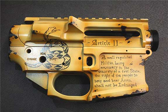

speaking of artificial weathering these AR15 receivers are aluminum the rust and weathering is painted on using Cerakote gun coating.

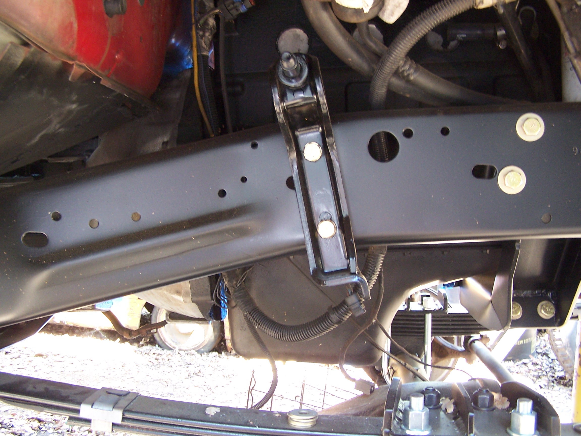

Well I got some done on my truck. First off a bird in the hand can be very messy.

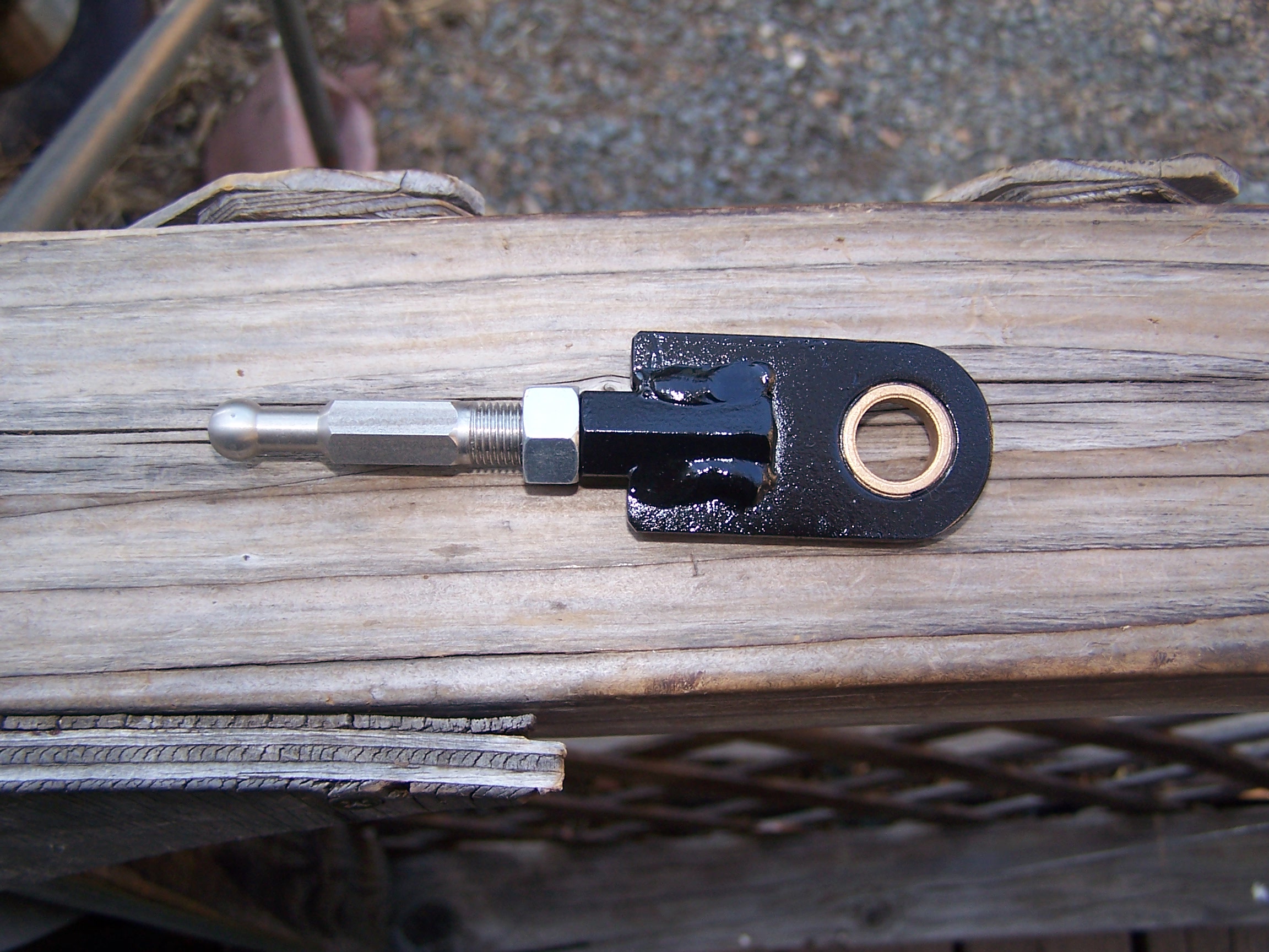

Next is the adjustable brake pushrod finished.

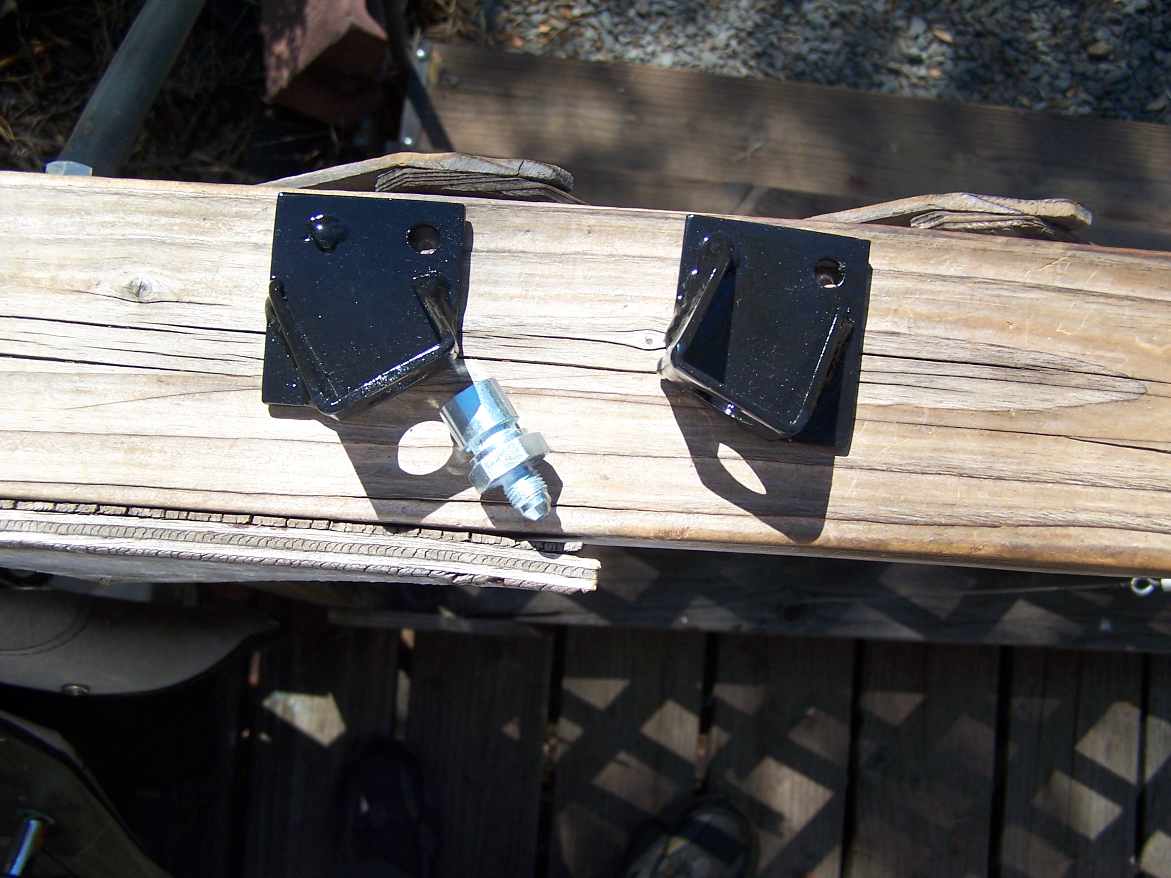

I also got the shock mounts on. I moved the hole on the mount instead of the frame. the mounts sit at a bit more of an angle than stock but It was easyer than welding and smoothing out the frame.
Next is the bracket for the brake tube to the hoses at the steering knuckles.

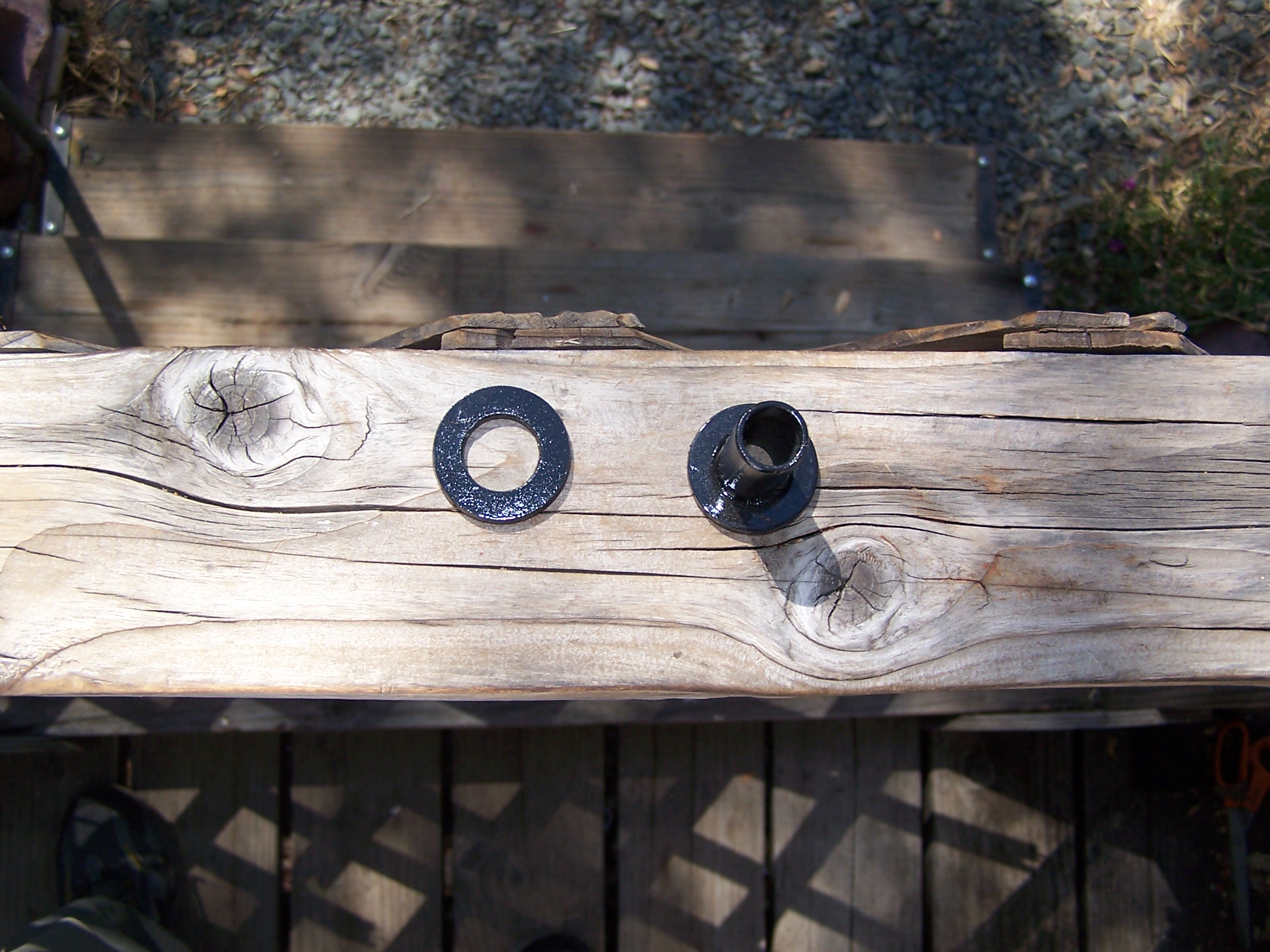

and last is one of the upper rear shock bushings I put together.

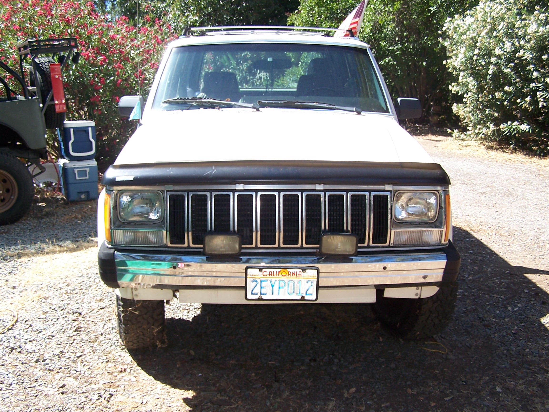

And the smog offender I took off the cheesy plastic lights and the bug deflector and it doesn't look half bad.
