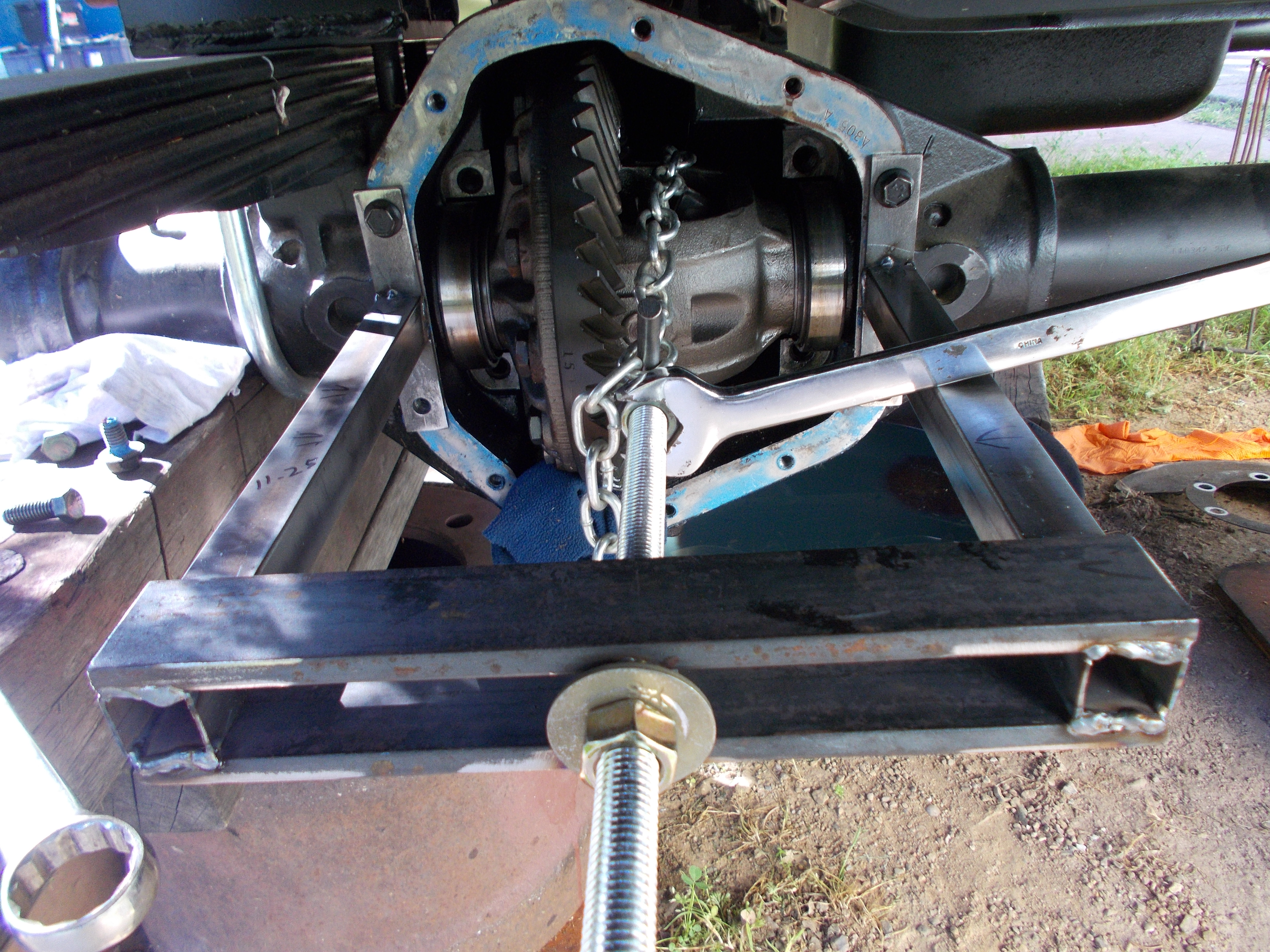

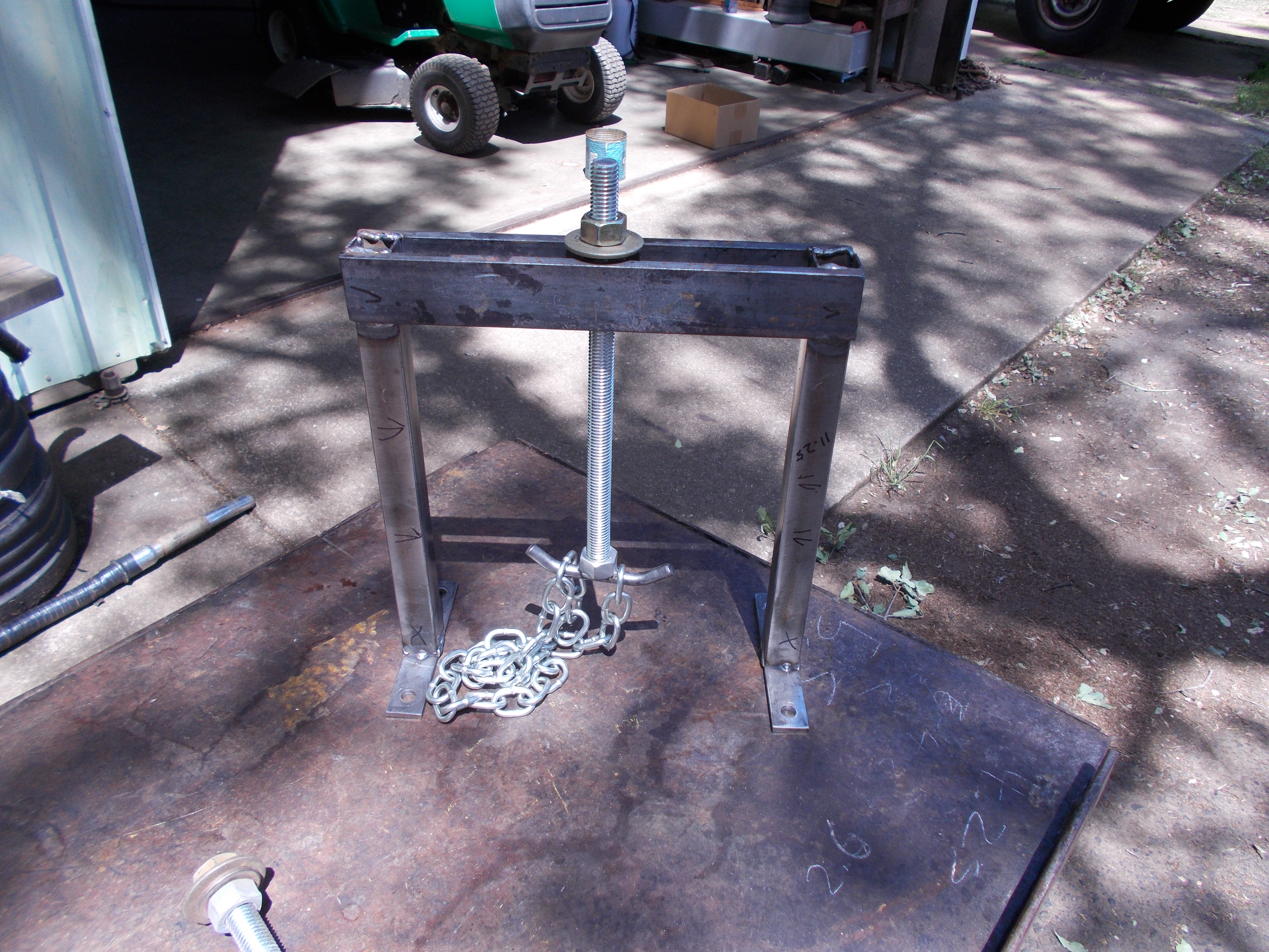

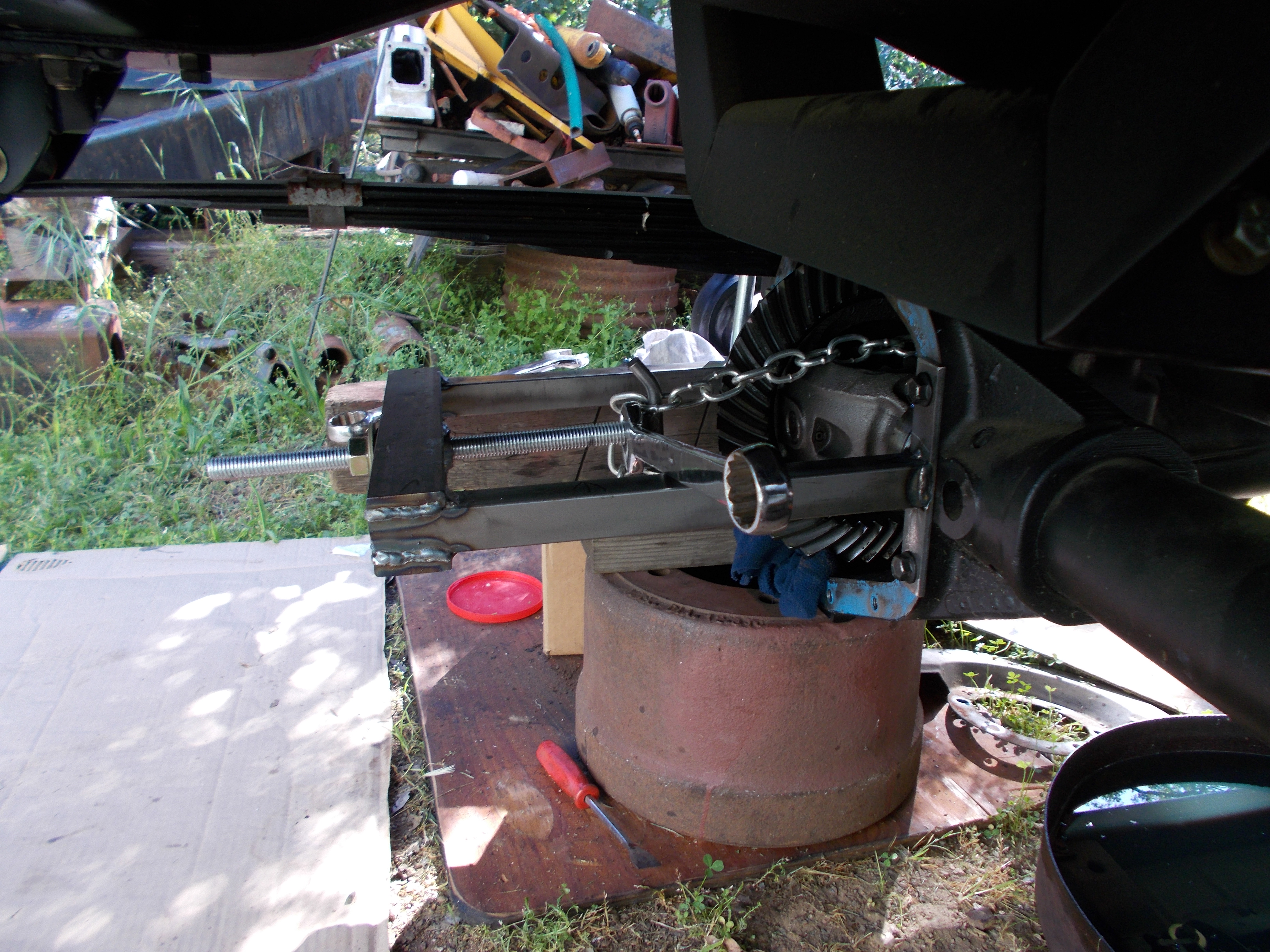

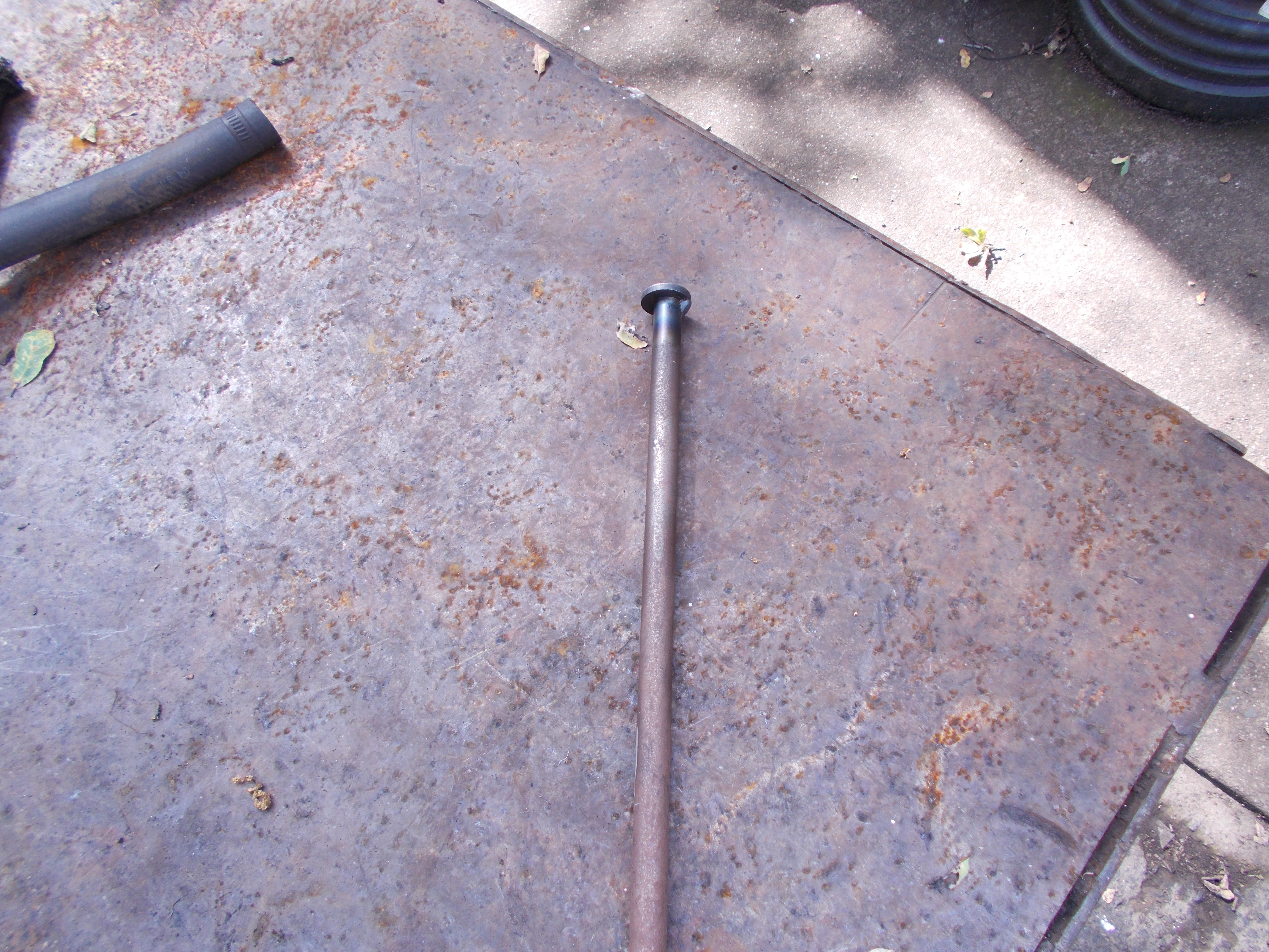

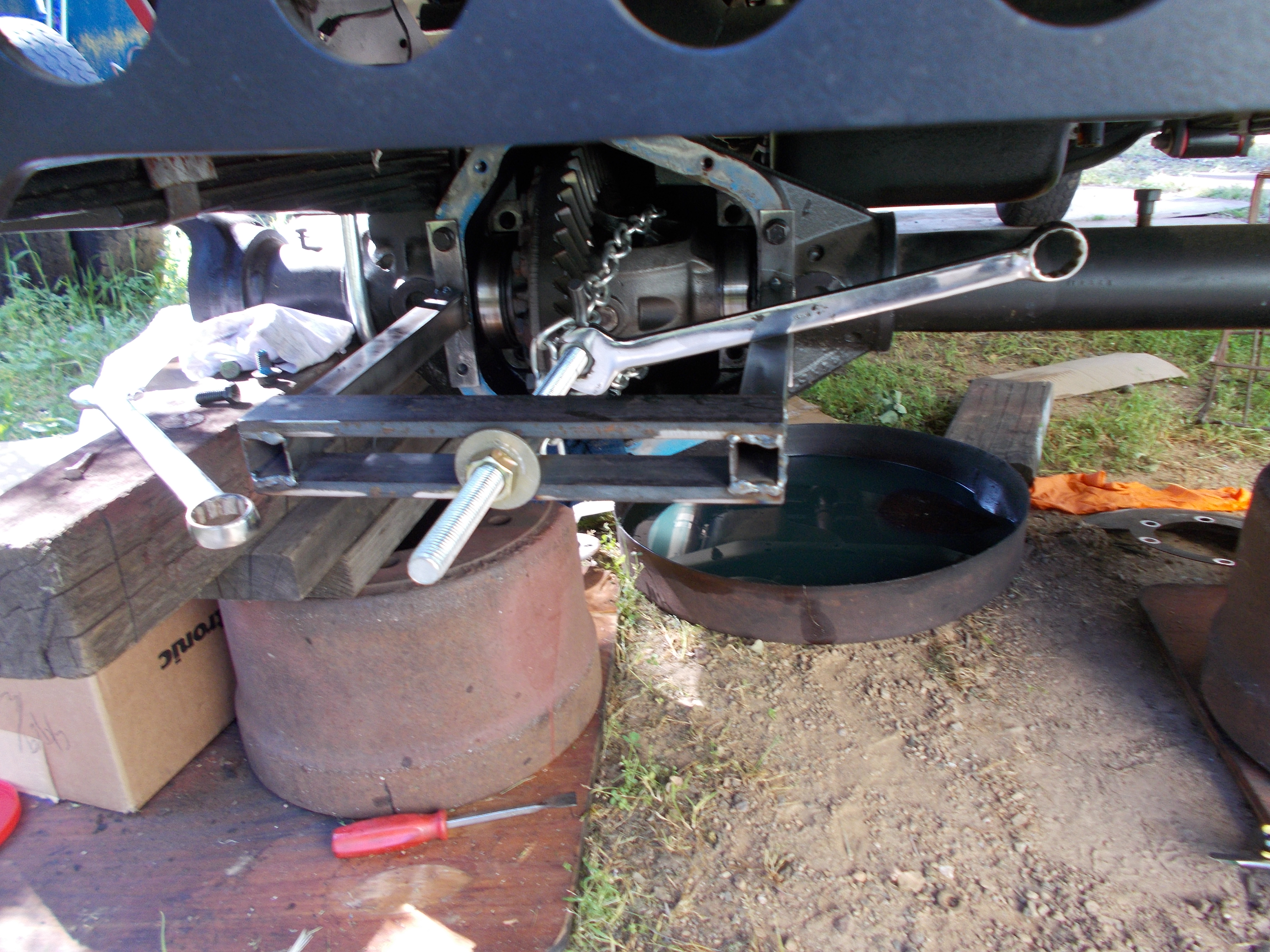

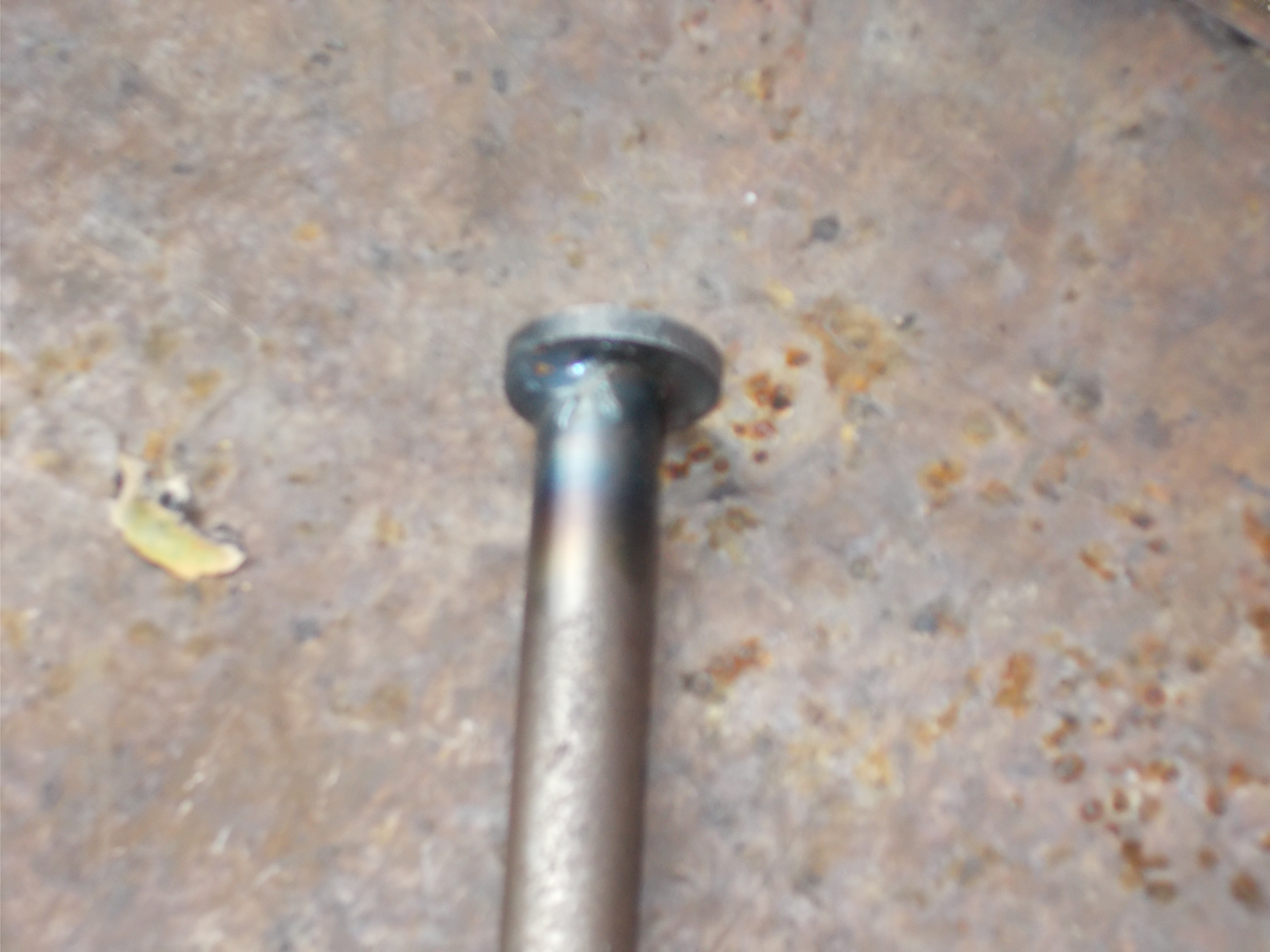

Last Thursday I fought the carrier for a couple hours. no matter how I tried I couldn't get a good bite on it with any pry bar I had. And when I did It wouldn't budge.
So I gave up that idea. Friday morning I went to Tractor supply and picked up a 36"piece of 5/8-13 Allthread and made this. It took roughly five minutes to get the carrier out this time. the nut with the hooks is welded the end of the all thread.

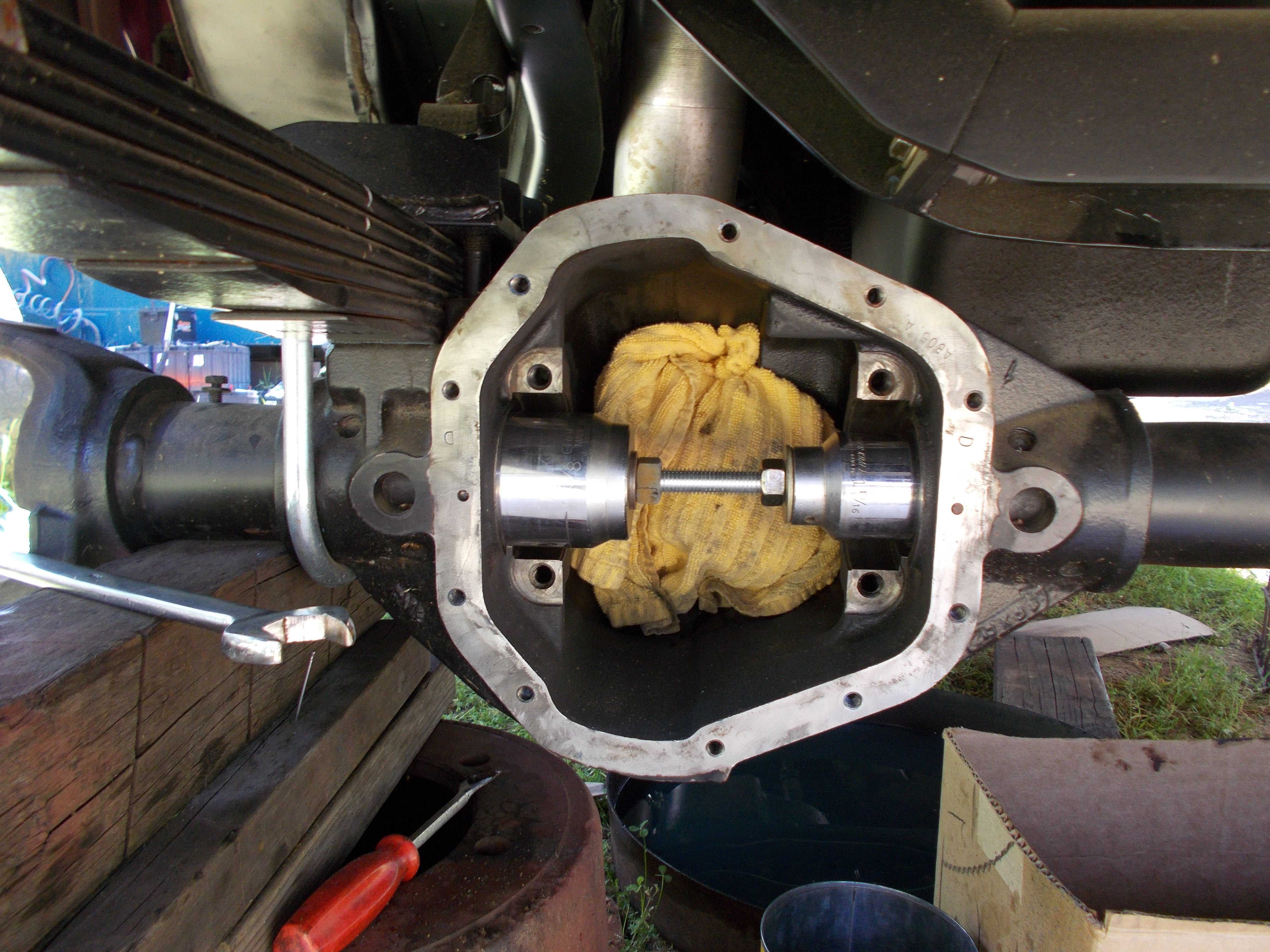

and to install the seals. it looks crooked but it isn't.

Nice carrier puller! And I like your seal installer!
You always seem to come up with some cool gadgets when you run into a road block.

Nice puller,
I am impressed with your MacGyver skills.
Reminds me of someone else I know.

Nice work, but with that much effort, you could have made a nice carrier spreader and made going back together much easier........
Might want to get cracking making one now......
Yeah..... Not difficult, with his skillset...
Yeah That is in the plans for later. The way everything was sitting I didn't have much room so I went with the puller. By time I got done jacking and blocking I would have the puller done.

I've seen guys hook a come a long to the bumper and do a similar pull. Still doesn't help you get it back in, but a lot less time involved.
I like your way better, as you get to play with the welder.....

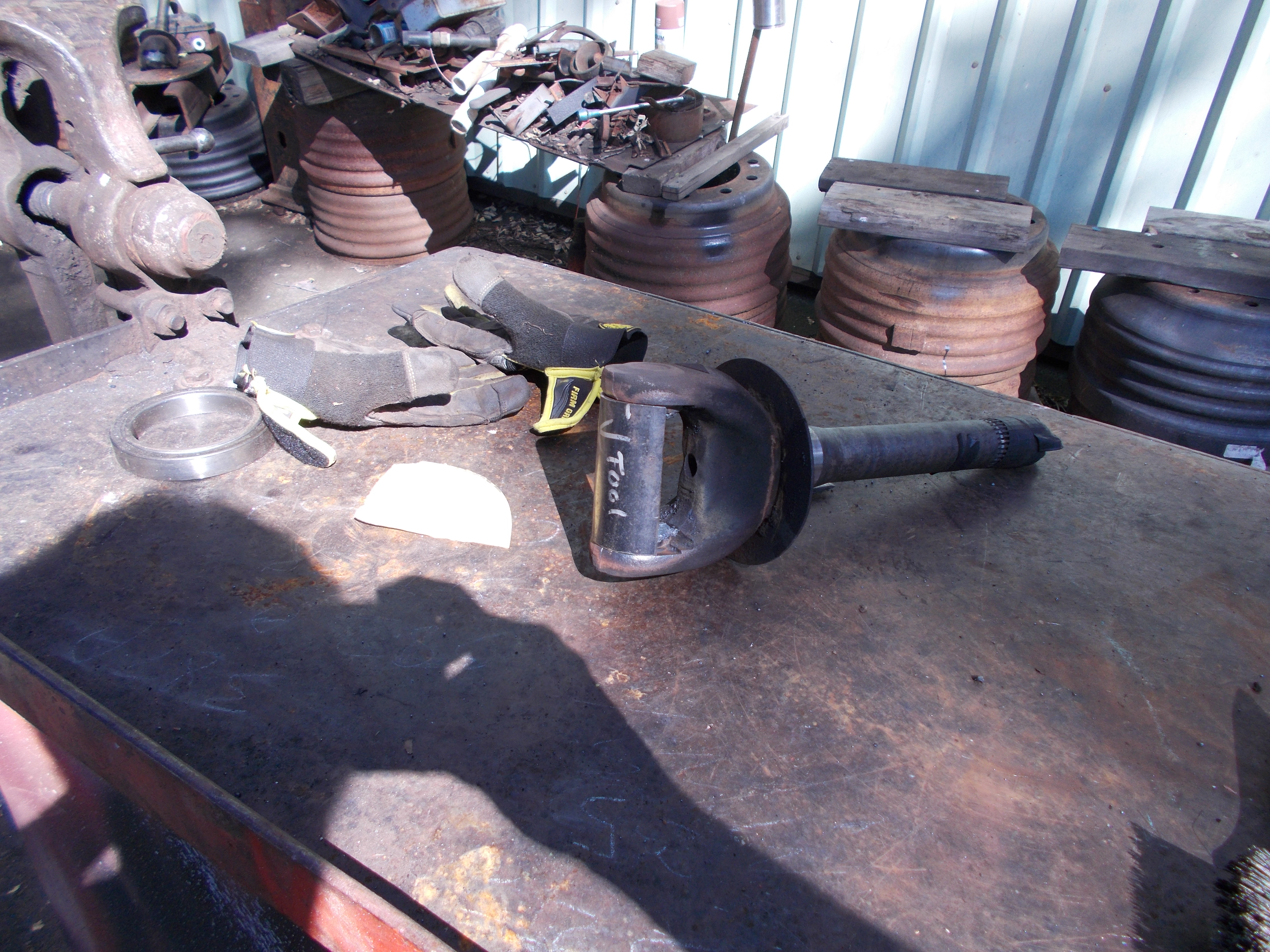

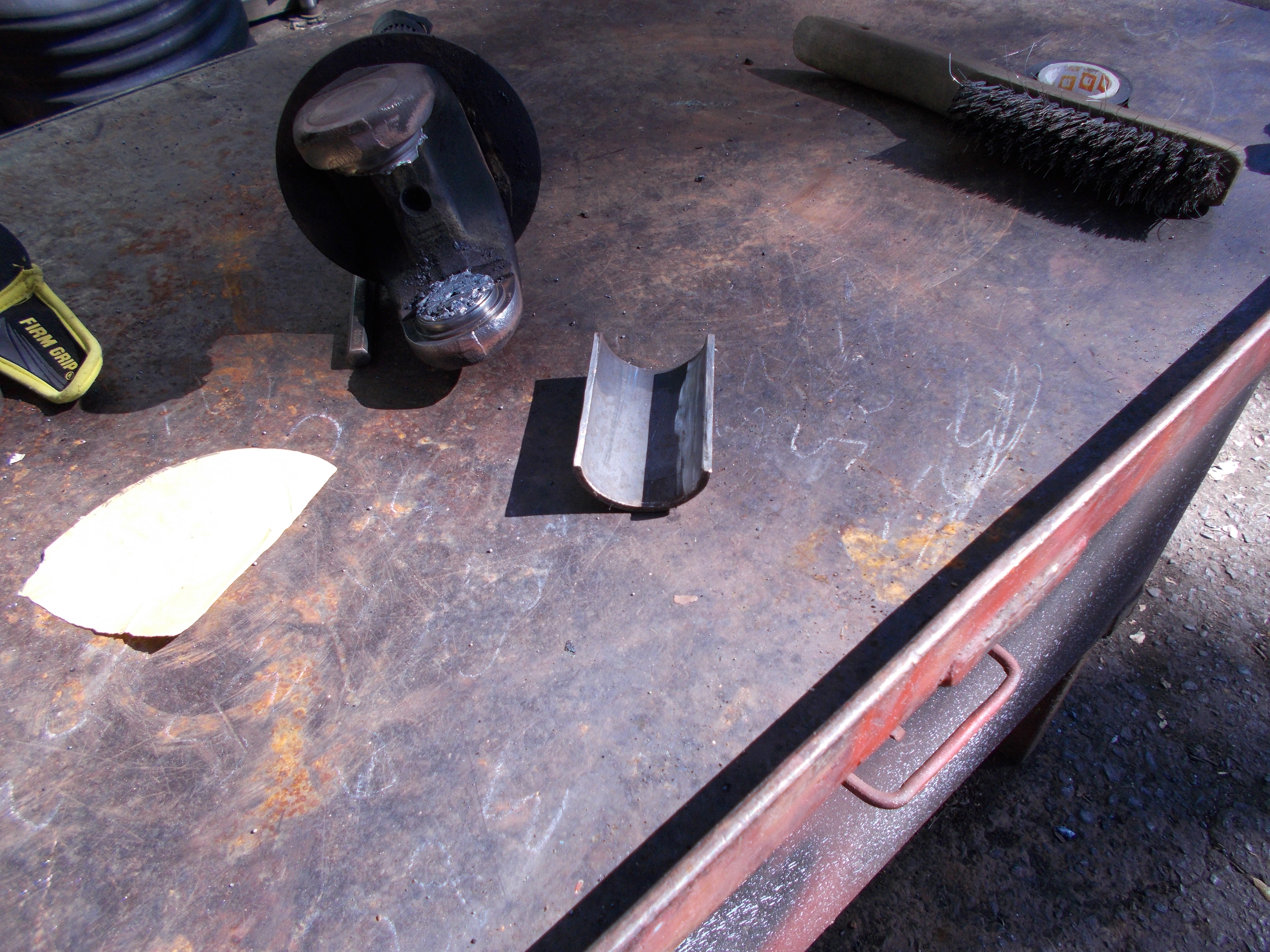

This morning I cut the other u-joint out with the torch. then made a tool to keep the yokes from bending when I pressed out the rusted caps. All went well and I got the axles and stub (one is new) cleaned up and got the new joints pressed in.
The first two pics are an offset punch I made to remove the inside spindle bearings. I snapped my bushing puller so i made the punch. Worked great.
