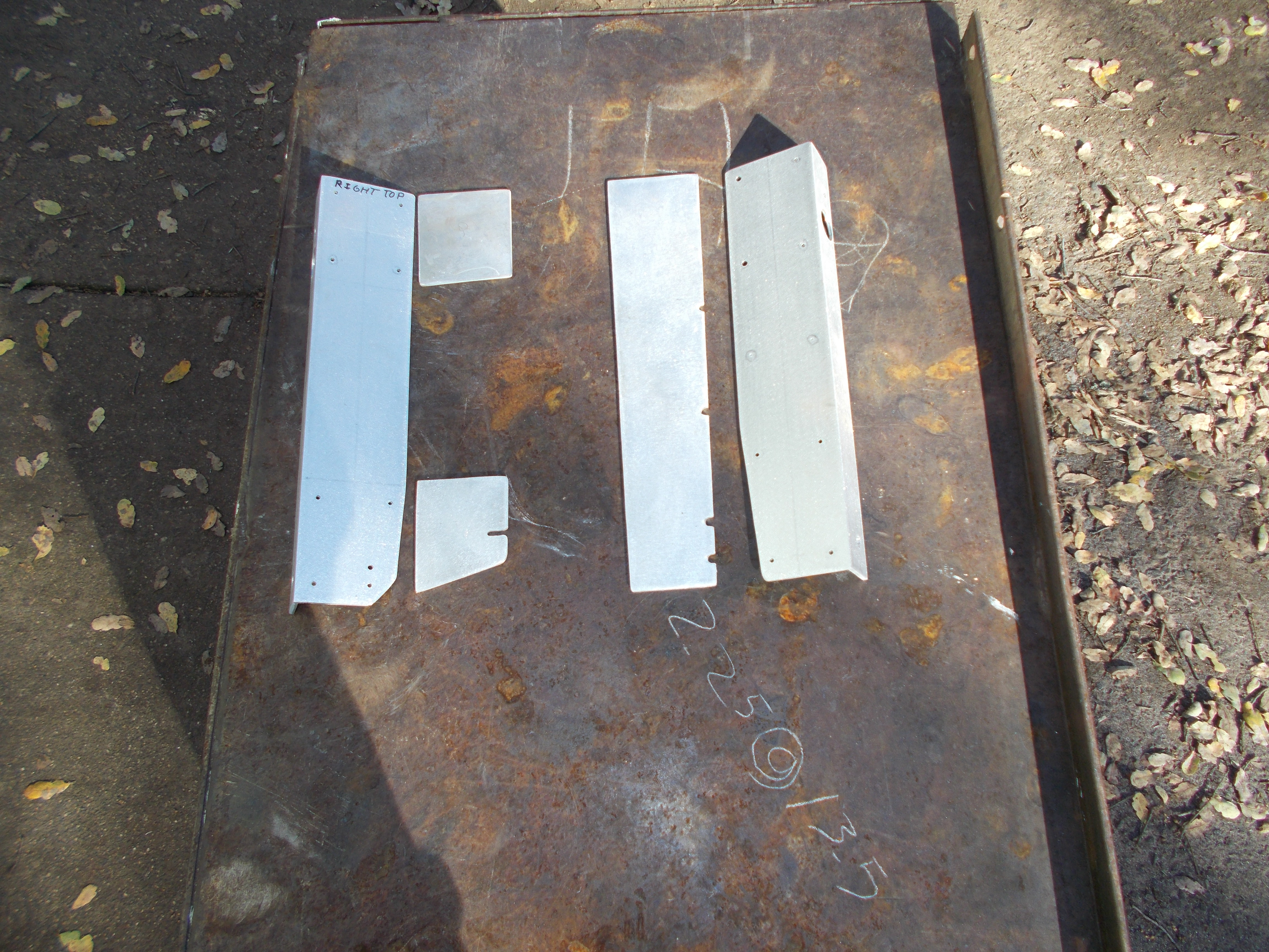

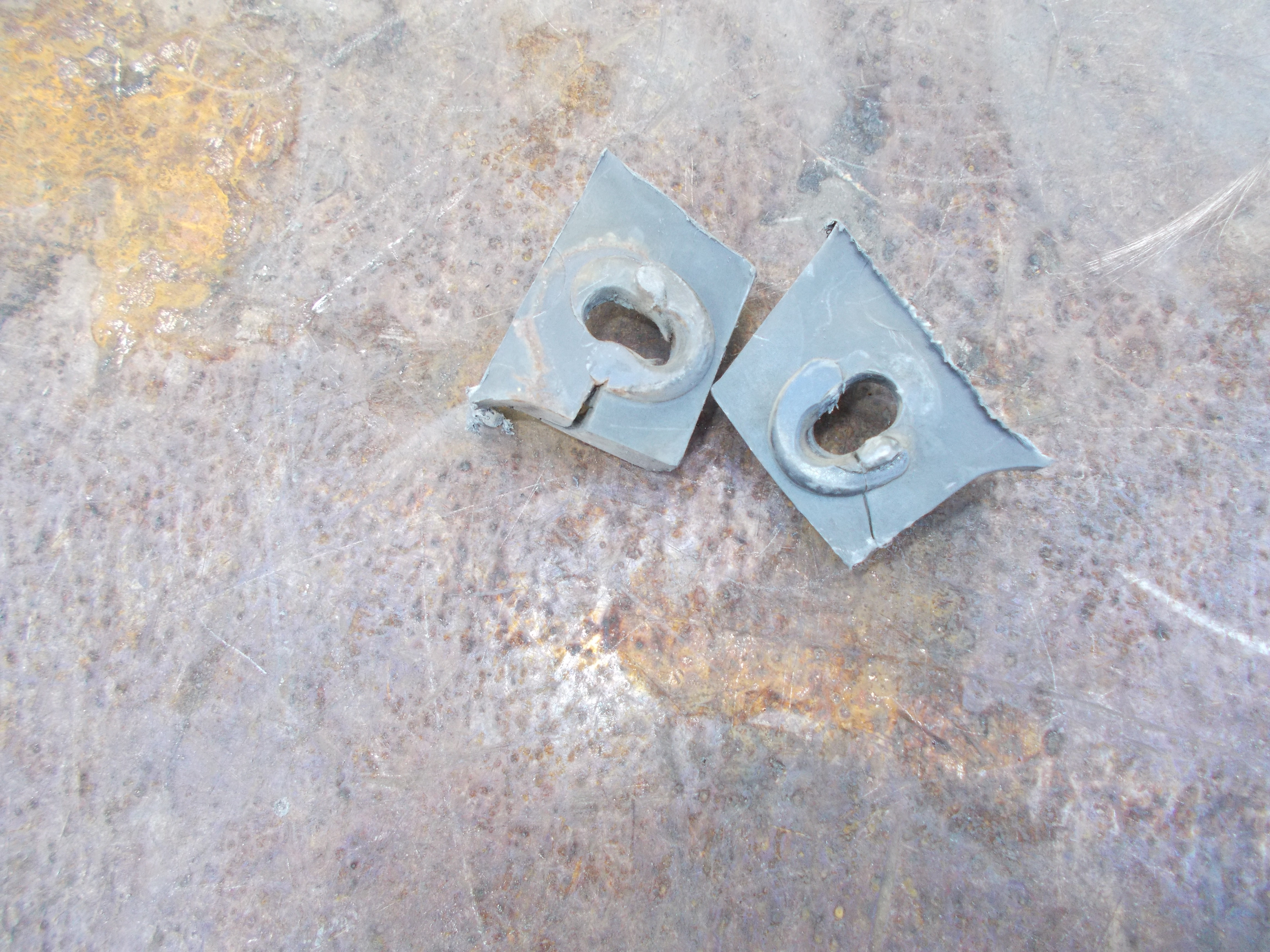

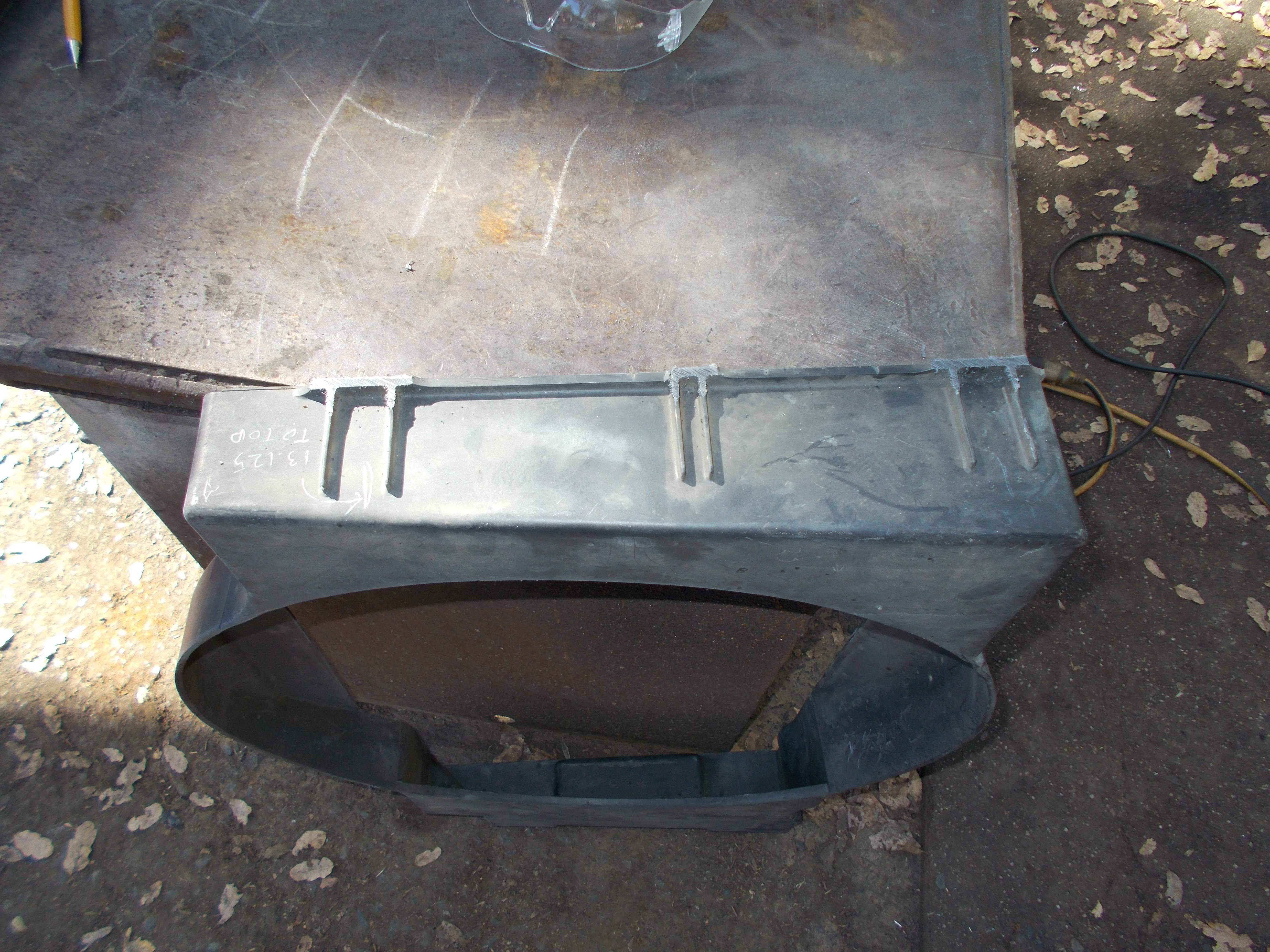

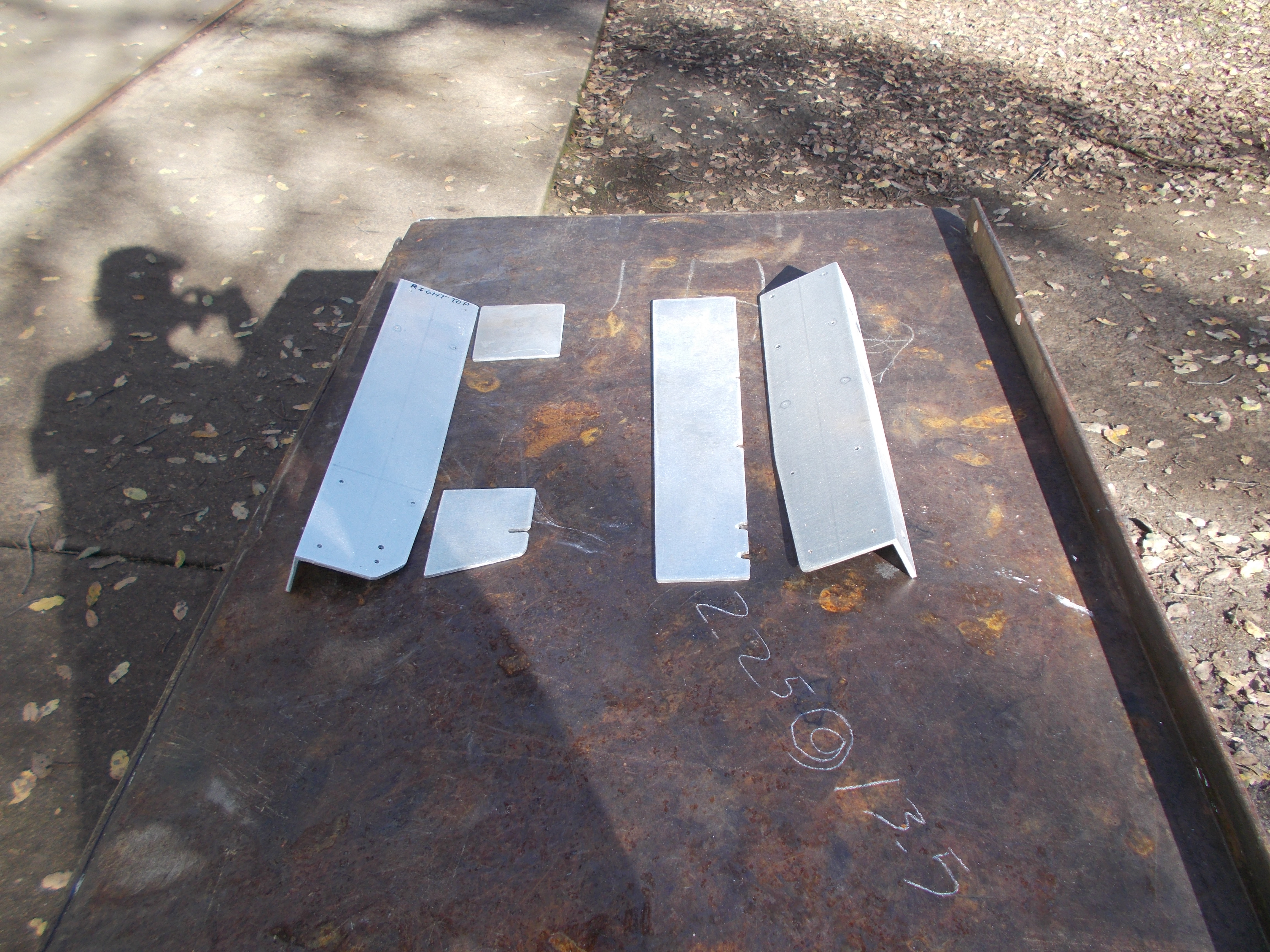

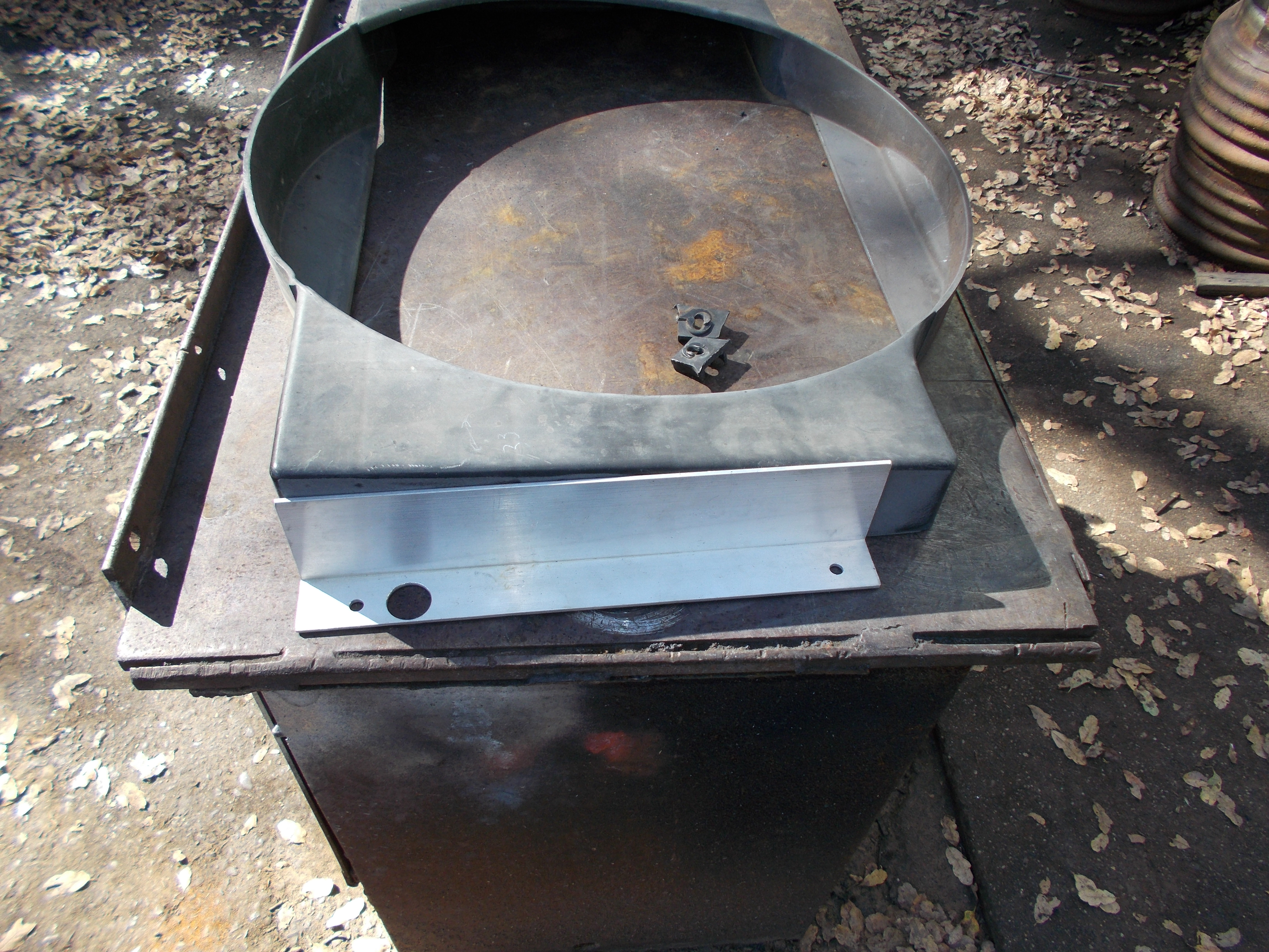

Todays shenanigans While disassembling the front of the engine compartment the do the KDP I found that the fan shroud had a couple cracked mounting tabs. So today I did a little to fix the problem. I trimmed up one cide of a pair of 3" X.125" aluminum angles. drilled a sone mounting holes( May need to be filed into slots) and cut a couple clearance holes for the radiator bolts. Later when I am sure it will work I will drill the long sides of the angle and make backers to go on the inside of the shroud. and JB Weld and pop rivet it together.

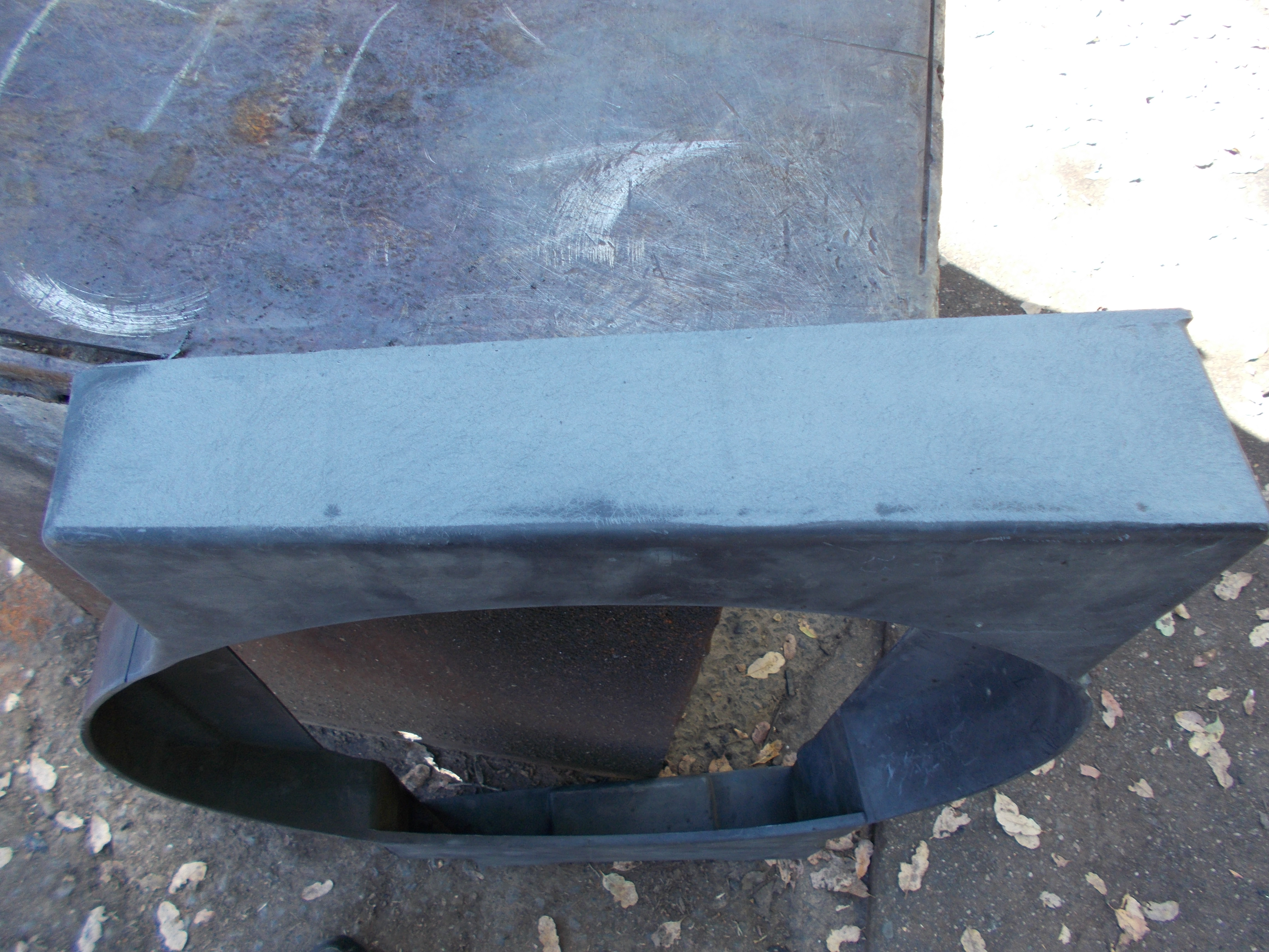

Today I got the flanges for my fan shroud trimmed up and got the back up plates cut and fitted. Now to drill the rest of the holes and pop rivet it all together. Nothing too exciting. Oh the slots fit around the ribs in the back of the shroud.

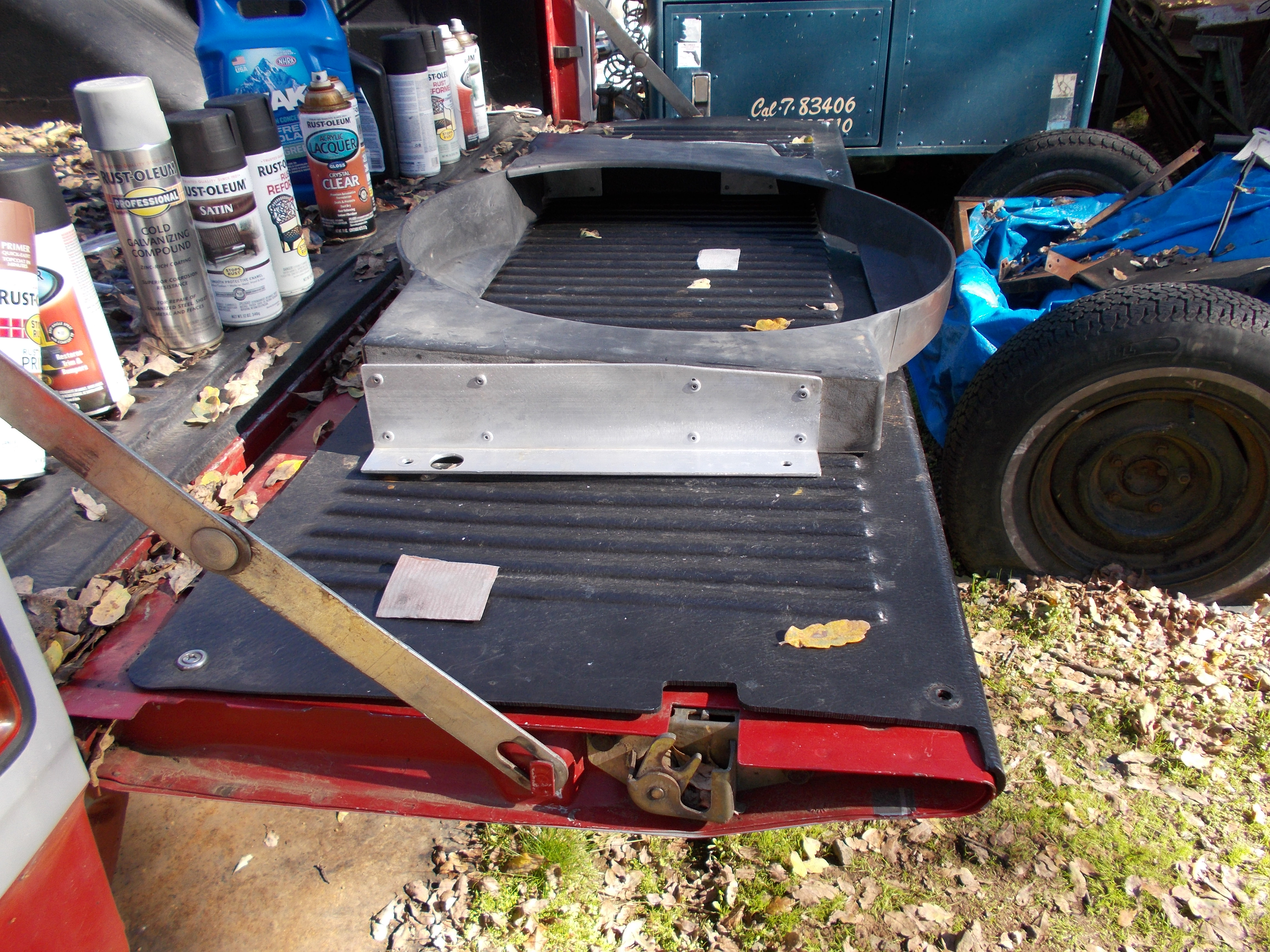

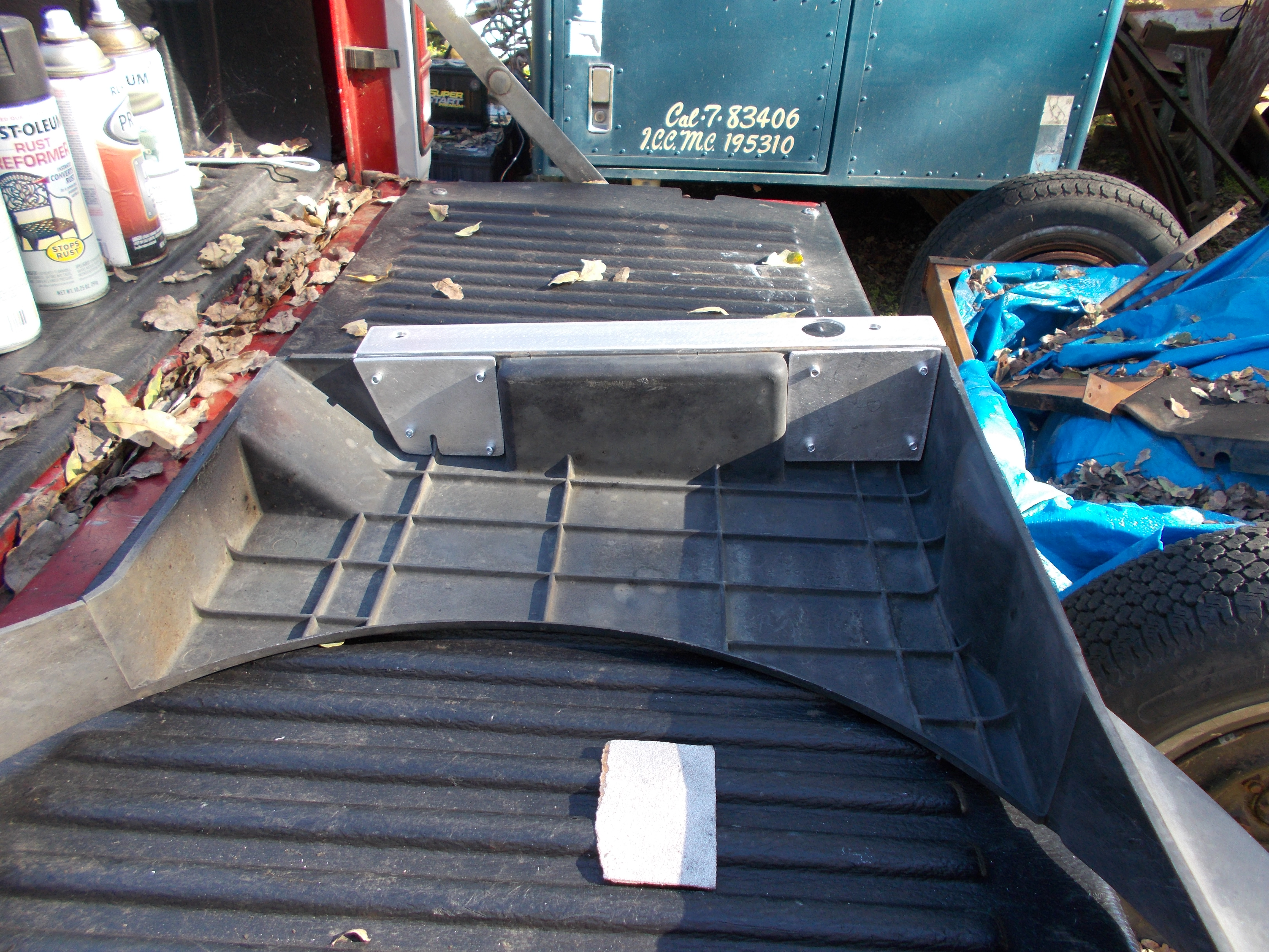

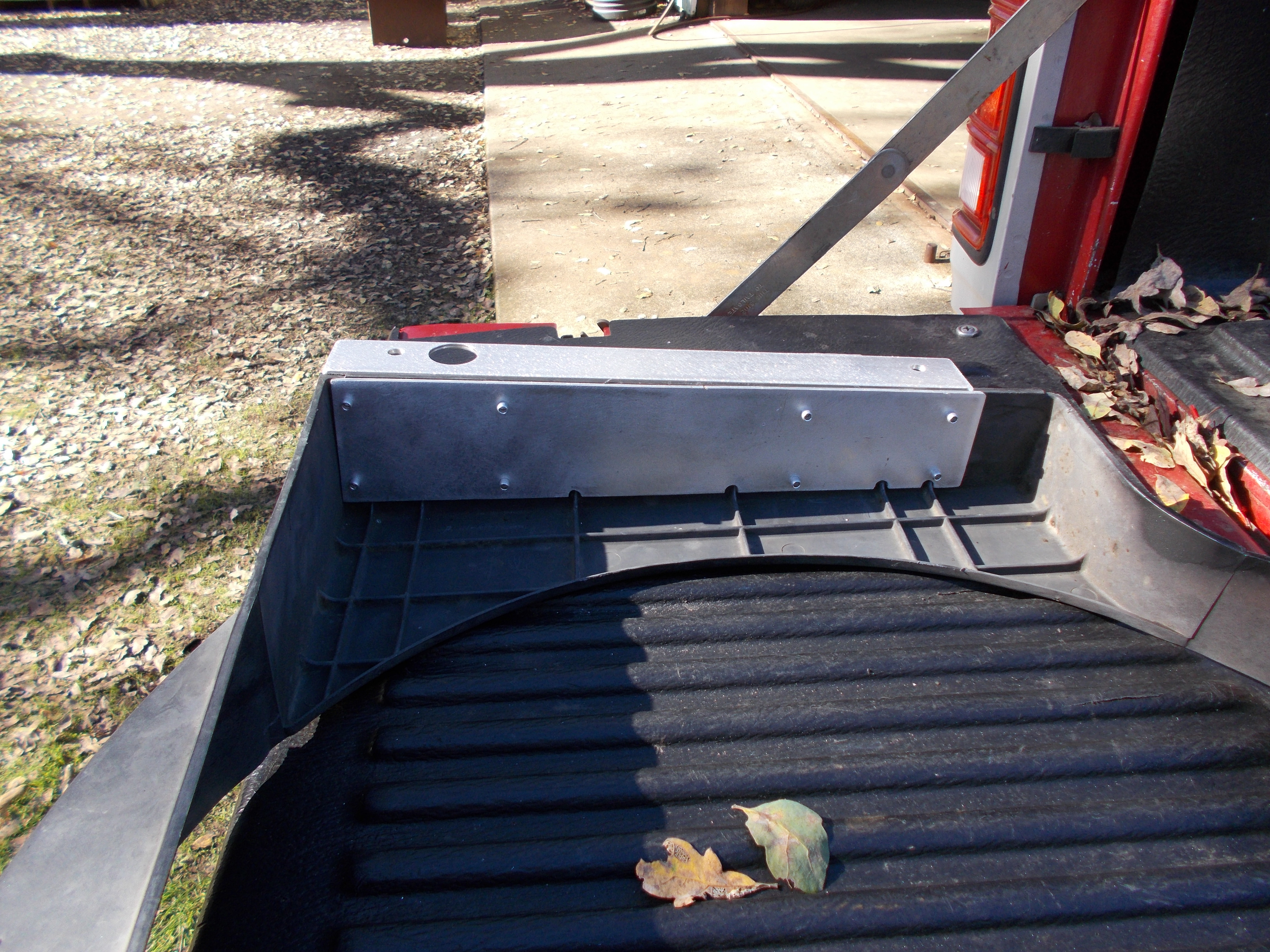

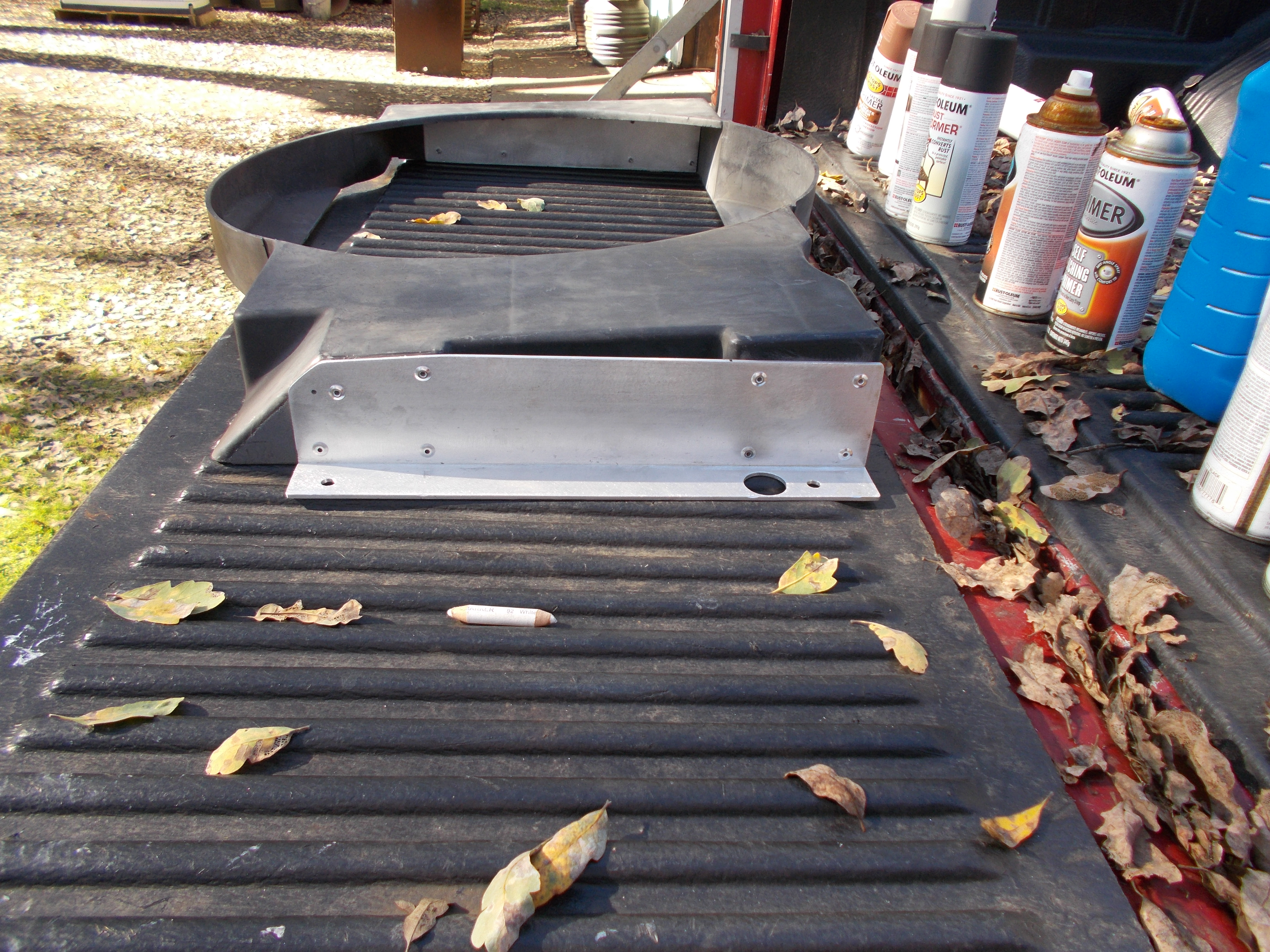

Done with that!

Nice clean looking job Mark.
Thanks Oliver.
Old Nov 9, 2016 | 03:26 PM
  #1064
I agree....very well done. I like the internal bracing as well.
Thanks Brian. I figure there is less chance of problems later on this way as it spreads the load over a wider area.
