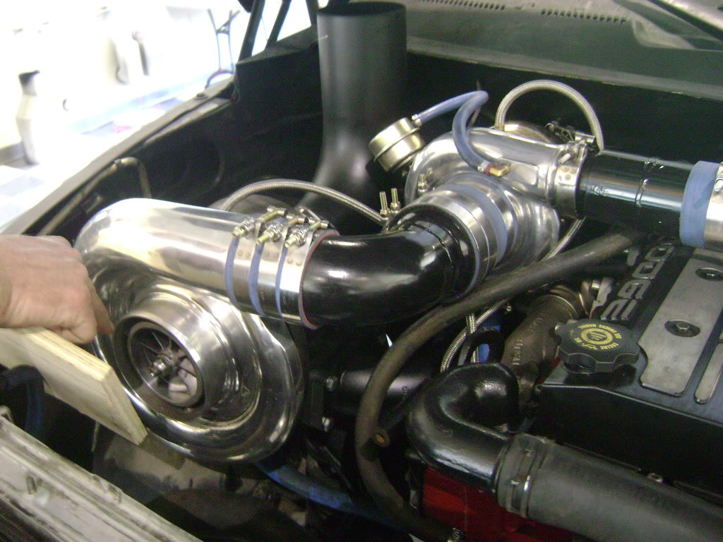

Here are a couple of pics I found of an S595 over an S471, so about the same size frame of turbo's as you are going to run.

This isn't a 3rd gen, but it does have some big turbos.

I wonder how they support that big turbo?

Sch.40 hot pipe, and a brace back to the block.
Now if you jump up to a TN106 we are going to have to put our thinking caps on to get it to fit...
