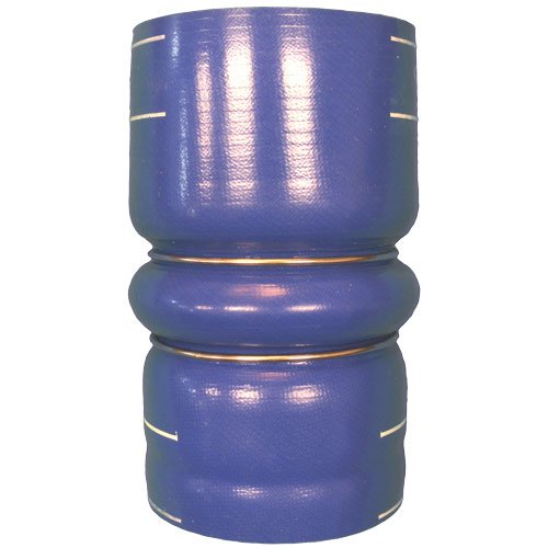

I have bought a couple extra used boots as well, since a couple of mine are looking weak in a few places. I too have looked for the longer "hump" style boots, but have been un-able to find exact replacements.
I have been looking at this style though....
This is the style they run on our commercial trucks at work...but with 2 or 3 bands in the middle.
Just doing some searching on-line and came across this thread...lots of good info on products.
https://www.dieseltruckresource.com/...ilable-182819/

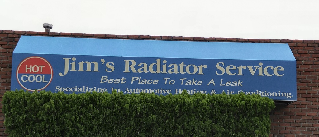

Today, I dropped the rad off at the shop. Funny group of guys there..

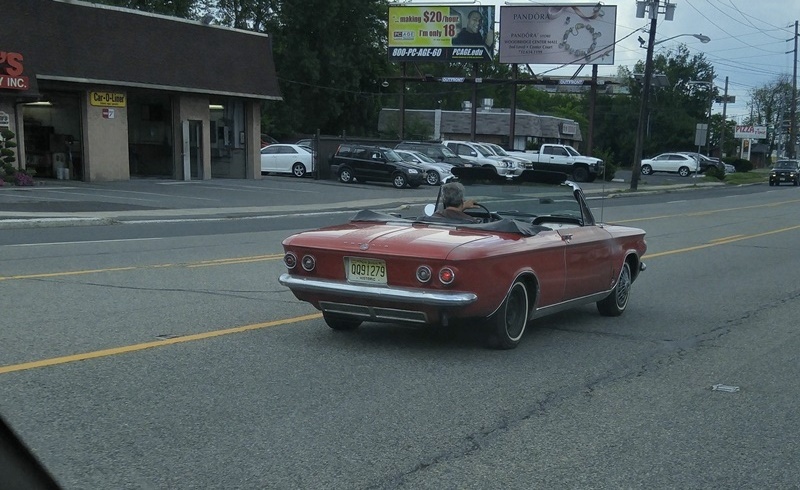

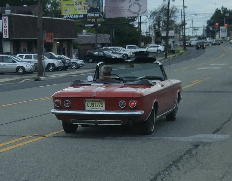

On the way back saw this. Been about 30 years or so since I seen one of these crusing around. I thought they were all melted down turned into washing machine parts.. Cool....
Just because they are unsafe at any speed?
Neither of my trucks had the original radiator in them when they got to me . . . pretty neat that you still have the original Chrysler sticker.

I've always likes those cars, although I've never even sat in one. As a kid, I remember seeing them everywhere. Cute little ride, imo
Yeah... I thought that was cool too. Chrysler really screwed up, as they never intended the radiator, never mind the truck, to last 23 plus years. Minimal junk in the tube ends, but I figured it was time..

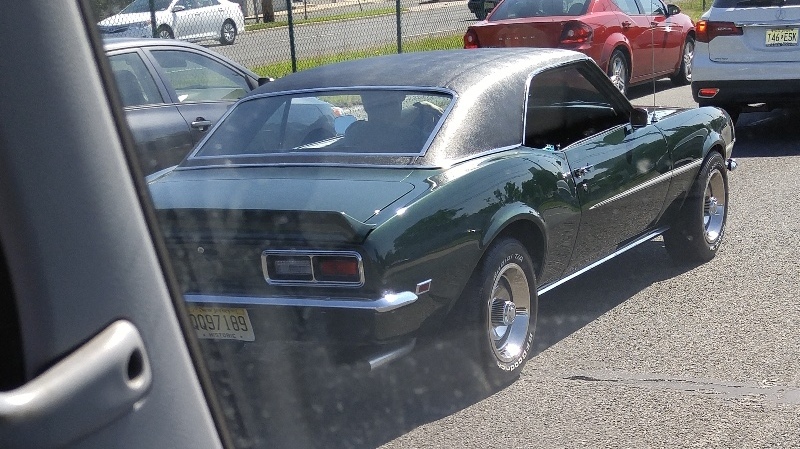

Saw this the other day.
Can't help but drool over the 67 and 68 body styles. Incredibly sexy car, IMO....even in green..

Too bad they missed one. My friend, and his girl died in one of those, parked by the lake on a cold winter's night makin' out. CO poisioning.

My neighbor had a Corvair. He was all nutso about it. Never really cared for them myself. I'd occasionally do a burnout in front of his house with my '71 Demon...made him grumpy 'cause his Corvair could barely even chirp 'em. Hehehe...

With all due respect, and not to get into a pizzing match with someone whom I have an admiration of talent....
Are you holding the car / car manufacturer responsible for someone who sat with their car idling and subsequently was overcome by exhaust fumes ?
Really ? I understand the emotion tied to it, but doesn't personal responsibility come into play here ? I have personal knowledge of this scenario, as my brother took his own life utilizing his car for a supply of co. The car was his tool for taking his own life, but I can't hold the car or manufacturer responsible for it.
I don't know about you, but I wouldn't sit in my dodge (which has a relatively new exh system) for very long without the windows open for fresh air. It's common sense, IMO.

They were in a parked car, engine running, wide open space down by the lake. CO came from the cabin heater, which drew outside air across the cast iron cylinder jugs with aluminum crankcase and heads. Cast iron to aluminum (great expansion difference) joints carrying exhaust components at the head/cylinder and manifold/head ventilated by air then used to heat the cabin. CO poisoning impairs judgement first, then motor functions, like breathing.
Back in Nader's day, testing with windows cracked didn't relieve the problem at all because it was so severe. High accident rate with Corvairs were attributed to driver impairment from CO poisoning.
Yea, I have an attitude about it. Bad engineering leading to death bothers me.
