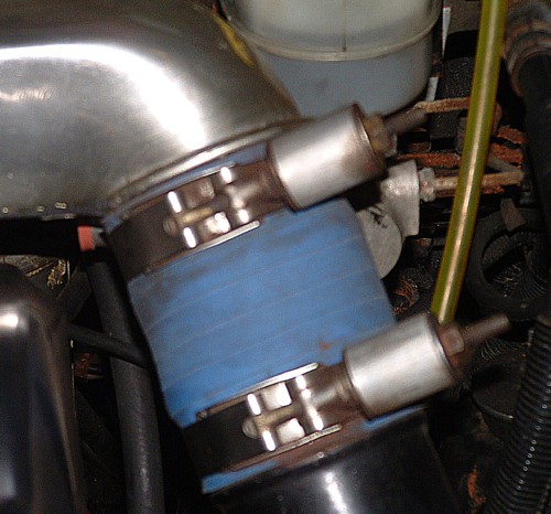

If you try to run more than about 50 psi the spring clamps are a waste of time and money. The clamps need to be tightened to the point where the spring is fully stacked and then some. Also the springs require you to use a wrench to unwind the nut for a thousand turns before it is loose enough to use your fingers to open the clamp enough to get the boot over the tube hump.
I use the BD boots and threw away the springs. I replaced them with an aluminum spacer and now can remove and install a boot in seconds instead of minutes. I just hate lying in the snow by the side of the road reattaching the boot at the intercooler with those dang spring clamps.
I found that 100-inch pounds using the BD boots would keep them from blowing off. Here is a shot of my spring delete mod. Oh, And did I mention I hate those spring clamps?

Sweet mod! I'll remember that!
