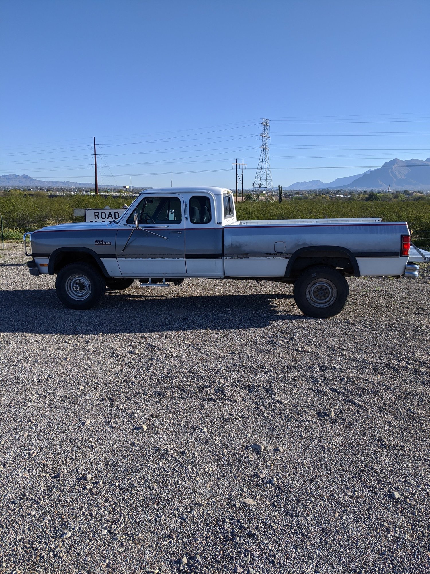

I bought my truck in 2017. I've been using the forum since before I bought the truck to learn. Now that I've started to upgrade the truck some I figured I should post to share with the community.
The truck is a 1992 W250 automatic. It has 141,000 miles. It was completely stock when I bought it. The previous owner installed a new headliner and steering box. I don't know anything else about the history other than it lived its entire life here in the desert and it needs a paint job.
The first thing I did was tint the windows and change all the fluids.
Here is the truck when I first bought it, getting it registered:
First at home:
