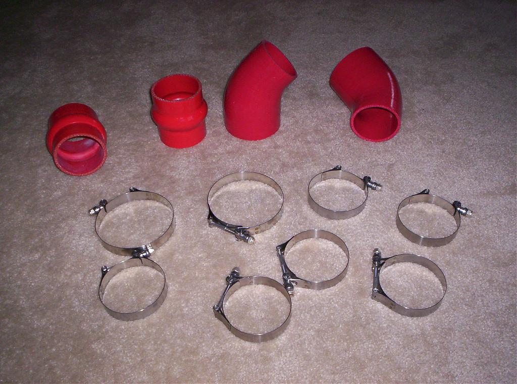

Stylin motors do not make the boots anymore. A few months ago I tried, called them up, and it is a no-go.
You sure?
There websit says they have them in stock.
http://www.stylinmotors.com/dodge.html

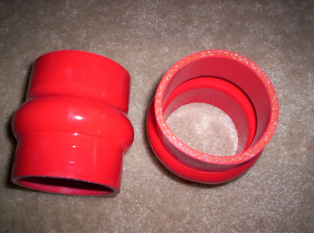

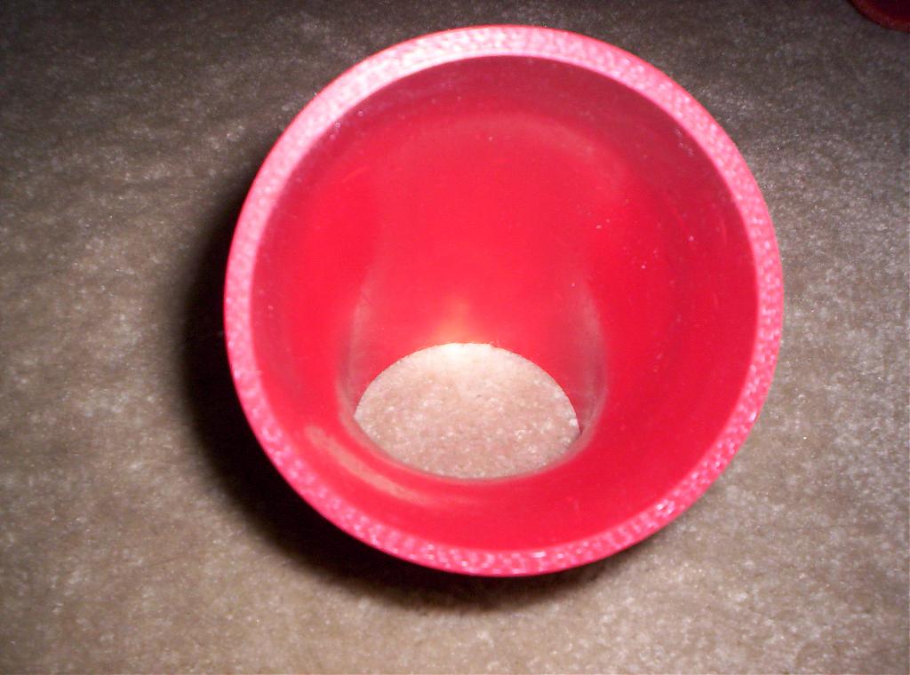

These boots are very high quality! When I bought my truck gthe PO had a PDR boot on the passenger side intercooler supply. The Stylinmotors one are much thicker.
Attached Thumbnails So, who has the thickest, gnarliest intercooler boots available?-boots-001.jpg   So, who has the thickest, gnarliest intercooler boots available?-boots-003.jpg   So, who has the thickest, gnarliest intercooler boots available?-boots-004.jpg
