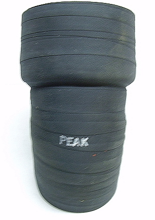

Got Juice?'s Avatar
Joined: Apr 2003
Posts: 398
From: Kanada
Peak Diesel Performance
Looks like Piers is getting the good stuff made for all of us junkies again!
http://www.peakdieselperformance.com...ge/4863099.htm
Attached Thumbnails So, who has the thickest, gnarliest intercooler boots available?-peak-diesel-booties.jpg
