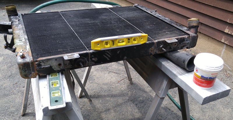

Today, I played with my radiator.
Nothing worse than having to do what you paid someone else to do, eh ?
Monday, I dropped off my radiator to the shop, originally to fix the petcock, and of which they did a very nice clean job. I also asked that the radiator be boiled out, pressure tested, and made sure it was 100%. Well, I think they did 3 of the 4 tasks. I can't help but wonder what they "boiled it out with". When I picked it up, the white deposits (solder bloom) was quite visible.
Although it looked minimally different than what I remember dropping it off as, I asked him (the radiator dude) why there was still deposits inside there, after their "boiling" procedure. He said "they can't remove everything unless they remove the tanks, wire brush the crud off, and resolder the tanks back on. He didn't want to do this, as the radiator is 23 years old, and he said the flow was excellent for it's vintage".
Well, knowing me, I thought okay, I'll take it back and put it in, now that it can be drained without removing the lower hose once or twice a year. well, that didn't last very long. I decided to research what they use to "boil" radiator minerals out of them, and found this:
Oxalic acid to remove the gunk
Sodium Carbonate to nullify or stop the acidic process after cleaning.
So I went on my quest. True value hardware for the Oxalic acid (it's called "wood bleach" in the paint aisle) which cost a big $6.00 and the Sodium carbonate was found at HD in their pool supply dept. It's a stronger version of the sodium bicarbonate we're all fond of as Baking Soda.
I put the radiator on a surface, leveled it out, and put the cap on. I took a hose connected it to my Hot water heater, and filled a bucket of hot water to 2 gallons. Mixed in 1 3/4 containers of oxalic acid, and stirred gently in the bucket. I then funneled the acid into the radiator.
10 minutes later, drained and rinsed out the rad, and there was almost zero mineral deposits left. I can't see any left in the cooling tubes, so I assume I got 99% of it out..
I then mixed up a couple gallons of the PH Up and neutralized the acid in the rad through a couple washings.
Tomorrow, I paint the radiator, and put it back in. I'm going to run distilled water in the engine for a day or so, then dump it all back out again. I'm thinking of putting some neutralizer in the distilled water to neutralize the engine block, but not sure its good to do that with 180,000 miles on it....
It's then I'll put my new Green antifreeze (conventional) back in and be done for the year with maintenance on the cooling system. New lower hose going on as well..

Good stuff, similar to what I did to mine over this past winter.
Did you manage to get an OEM petcock or use that chinese Dorman part?
Old Jul 30, 2015 | 02:58 PM
  #1199
I have no idea. it works, so I guess we'll see.....

I replaced the petcock with a plug. I can get just as much or more coolant out with a siphon hose through the radiator cap hole, and not have to lay on my back to do it, or deal with it splashing all over frame and steering.
