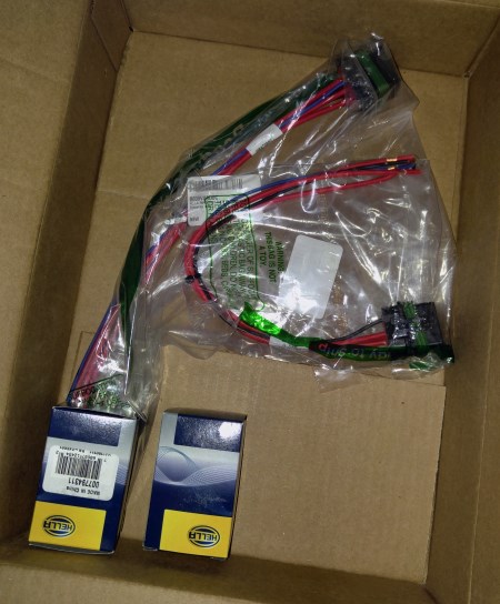

This is the connector and relay system I'm using for the Headlamp relays I put in by Jim Lane. Nice tight seal, and (hopefully) will last longer. Very similar to a GM connector..
Amazon.com: HELLA H84709001 Iso Weatherproof Relay Connector with 12" Leads: Automotive
The relays
Amazon.com: HELLA 007794311 12V 20/40 Amp SPDT RES Relay with Weatherproof Bracket: Automotive
