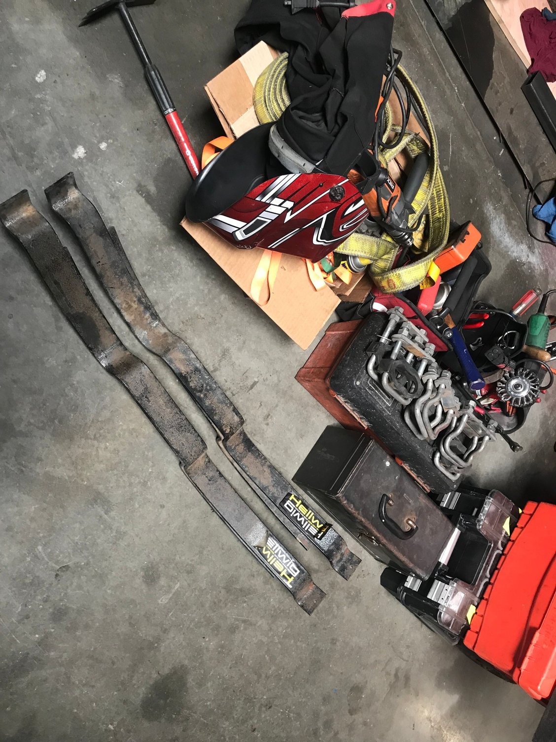

Scored a set of Hellwig helper springs on the cheap. The guy used them on a 72 with a large camper and only had them on for 1,000 miles. Soooo....these will be going on tonight after work.
