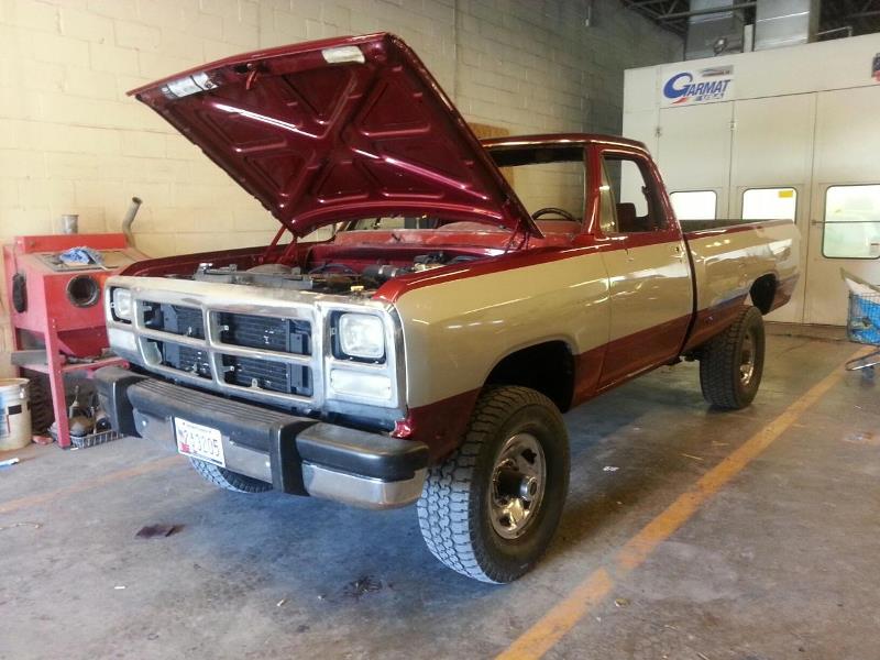

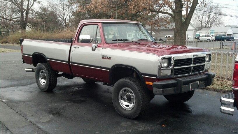

Was going through some old photographs, and I found the first 1st gen I owned.
Then I found the photos the dude who restored it once he bought it off of me.
Ah.... It looks pretty decent, eh ?
