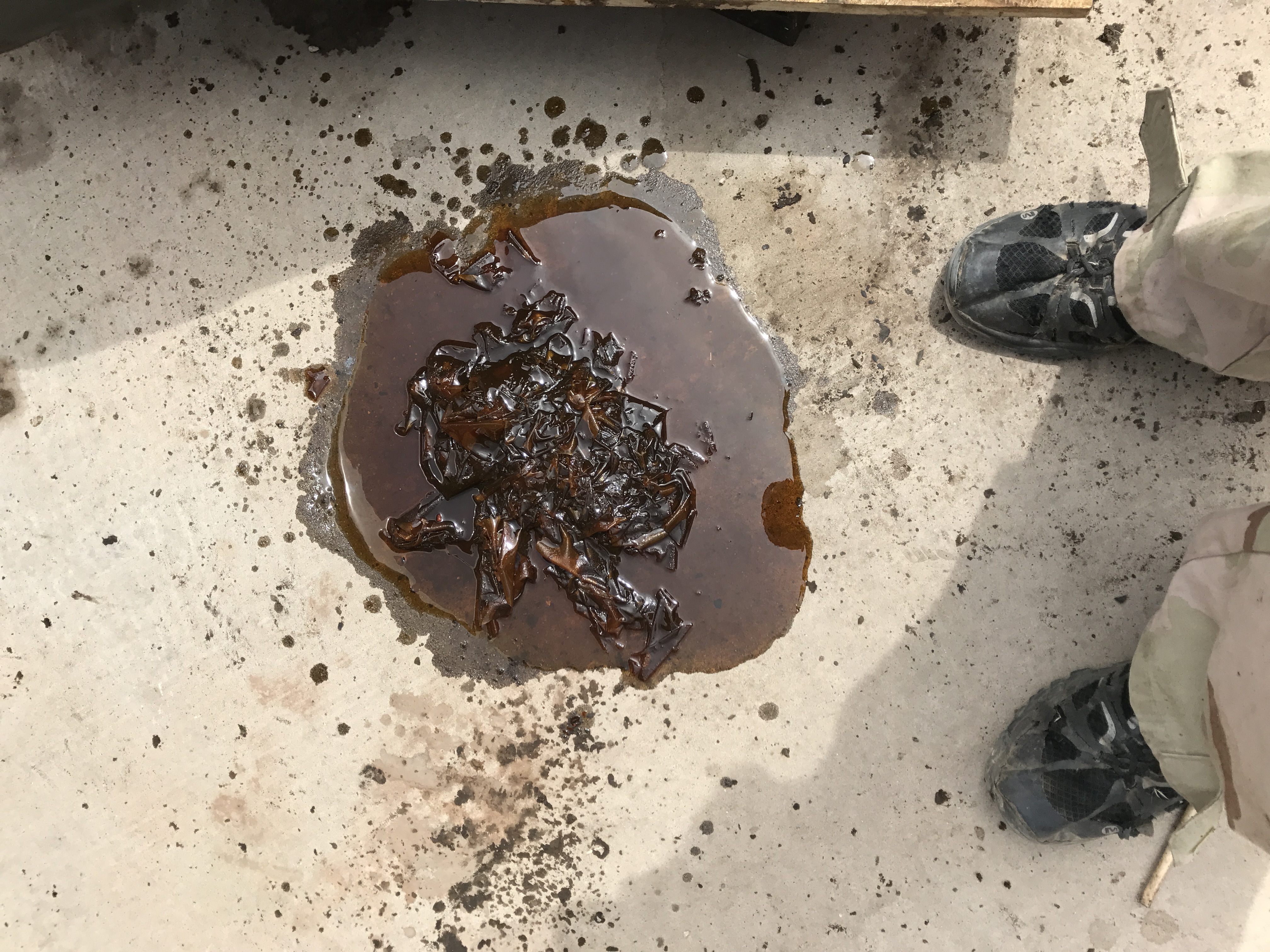

Looking at pictures of it and trying not to swear. Battling a gummed up injection pump from the vegetable oil the PO ran in it. Truck runs fine until it gets up to operating temperature. After that it starts dying when I stop, especially in reverse. When it doesn’t die when I stop in drive it just hogs way down. Then I put it in neutral or park and it isles just fine. Put it back in gear and it bogs way down. It’s my daily driver so I’ve been having to improvise lately. Going to go drive it on back roads today and see if I can’t get that gunk to clean out. Had tank cleaned and got desperate and had a shop do a tune up on it as I ran out of time. Still dies once up to operating temperature. Crossing my fingers that it cleans out as I don’t have the $1000 for a rebuilt one. They sure know what they want for the rebuilt ones.

What is your idle speed set at? But to me it sounds more like a problem with the transmission then the motor.

I agree. I started having similar issues with mine. When I swapped in the 5 speed, the issues went away. One thing I would check, would be the line with the check valve up at the front tranny cooler. Make sure the check valve isn’t stuck open or closed. Also, check band adjustments, line pressure, and give the fluid a look and smell test.

The truck is a 47rh swap and has new fluid and seals in it. It was originally a Getrag 5 speed, but the PO swapped the 47rh into it. Transmission has about 35k miles on it. Truck doesn’t have a tps, but still shifts somehow. I think it’s just off of pressure and there is an overdrive switch and a torque converter switch as well. Both O.D. and T.C. are turned off and then engage noticeably when I flip the switches while accelerating. Not sure what the idle is at as there is no tachometer in these trucks for some dumb reason unknown to me, but the shop I just had it at tuned the pump as well to economy settings. The mechanic I took it to has been working on these first gens since they came out and said he thought the idle seemed about right. He said the gunk might work it’s way out and it would get better. Driving it today that seems to be true, but it still bogs down while in gear once up to operating temperature. As soon as I put it in neutral or park the idle goes back to normal. When the truck is first headed out and not quite warmed up yet it isn’t as noticeable when it bogs down, but still does a little which seems normal for an automatic. When I cleaned my tank and flushed fuel lines the stuff shown in the attached picture was in the tank and thus circulating through the injection pump. So that shows what I’ve been battling getting cleaned out. Mechanic gave me the option to either drive it and hope it cleans out or pay $1000 for a rebuilt pump. I’ve opted to drive it and it’s gotten better. Still bogs down, but hasn’t died on me in several hours driving today back and forth on dirt roads. Cooler is a under bed cooler with a fan and there is none up front. Thanks again for any input I’ve gotten and probably will continue to.

I live in NJ. Everything here is too expensive, other than heroine or crack cocaine. Pretty sure it was,in the $900 to $1000 range. I will have to look and see what i paid to have it done.
That's amazing what was in your tank. I bet the passages in your injection pump have some funky stuff in them as well.
Old Dec 12, 2017 | 01:05 AM
  #4977
Wow....now that is some crud! If you have any of that in your injection pump then I can understand it acting funny.
NJTman=That's amazing what was in your tank. I bet the passages in your injection pump have some funky stuff in them as well.
Yeah. I coundnt believe it when I pulled that out of my tank while emptying it out. The shop that cleaned the tank out had to keep it for a week to soak it before steam cleaning it. Today I woke up and decided my truck needs a name. Not sure what made that come to mind, but I guess just cuz I’ve had it since April.

In your last picture...I have to ask is that some sort of "skin" that was on the fuel from the veggie oil, or is that paper towel in the grease puddle from cleaning it out? If that is the "chicken skin" that say sometime develops in Veggie tanks that is gross.

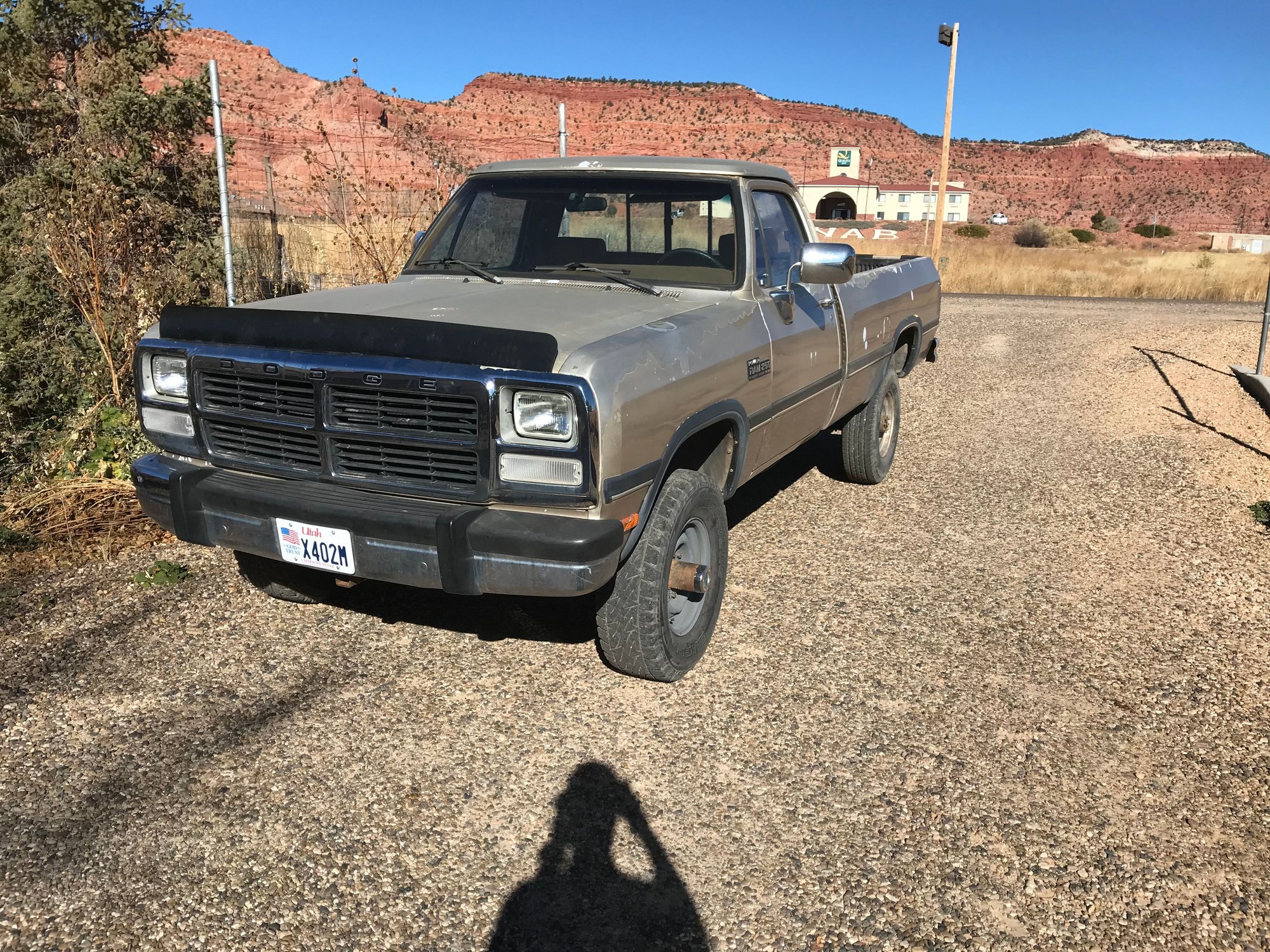

Smile
Nice looking truck.
That is a nice looking truck. It is completely identical to the way my truck looked when I inherited it from my dad -- right down to the bug shield bolted to the hood!
Mopar calls that color "light champagne." I eventually two-toned mine with another 1993 Mopar color called "emerald green."

I have the same question. I've run a lot of biodiesel and some veggie oil; I hope my tank is not such a mess .
