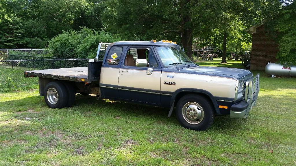

The body was in great shape. No rust and no damage other than the hole in the hood that was cut for a stack... then patched with a piece of a street sign. The mudflaps are ridiculous; 2nd gen mounted crooked on the front and NAPA in the rear. The flatbed isn't stock, but it's in good shape so I'll keep it. The truck drives great and the getrag 360 shifts nice and smooth. The cab doesn't rattle at all and the interior is excellent.
Old Jul 7, 2014 | 12:31 PM
Posts: 7,288
Likes: 2,884
AHH, the old fixing sheet metal with road signs.
That rarely come out great.
Nice looking truck, and welcome aboard.

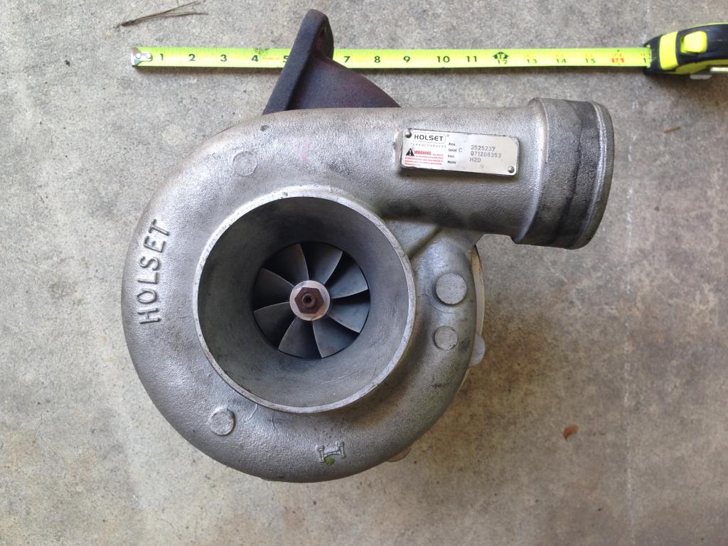

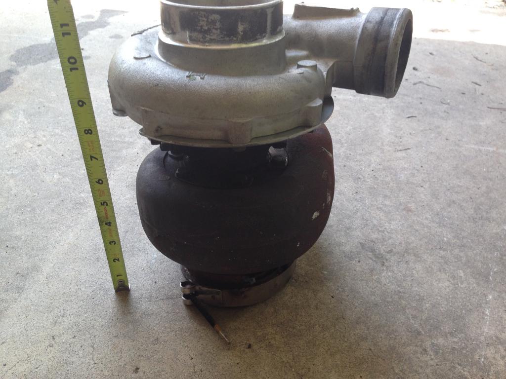

This is the "HX40" that came the truck. One look at it and we can clearly see it is in fact an H2D. This turbo charger spools slower and flows less than the stock one. My EGT's were running very high even during regular driving. the slightest grade uphill and I was touching 1050. At first I thought was my injectors so I pulled them and swapped them with stock injectors from a buddies truck, his truck was running rough so we swapped them back. The next day I put a stock turbo charger on and my EGT's are much lower and the engine is producing much more power.
Attached Thumbnails '92 D350 Rescue-img_1507.jpg   '92 D350 Rescue-img_1508.jpg   '92 D350 Rescue-147.jpg

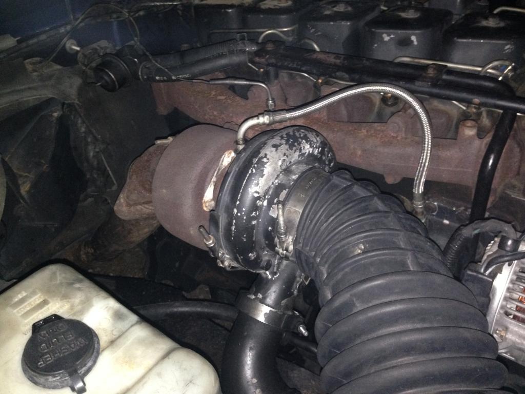

The exhaust manifold was also due for a replacement. When drilling and tapping for the EGT probe, the previous owner "welded" a bung to the manifold and ruined the holes for the studs when he attached a t3-t4 adapter. Luckily I happen to have a couple Cummins blocks mostly in tact in my back yard so scavenging the part was easy.

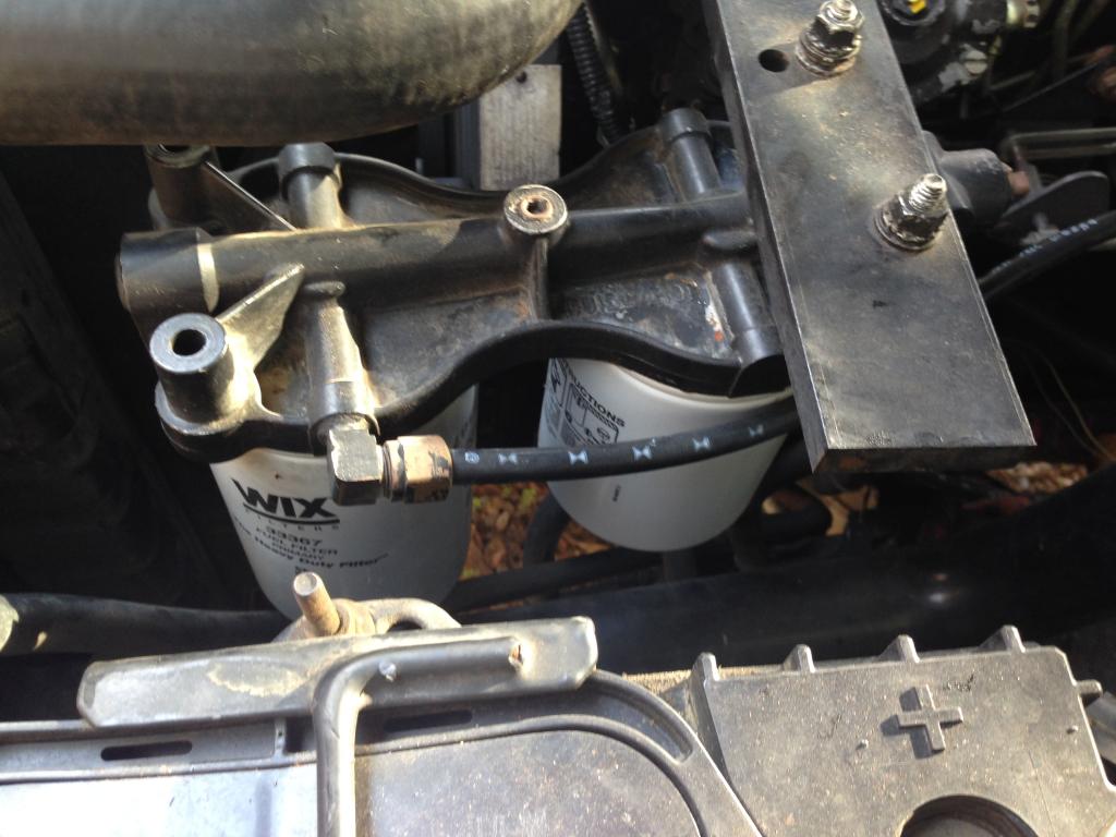

My next task was to delete the ridiculous fuel filter system. Hot air is blown across it and it restricts my fuel flow. Luckily, the original fittings were attached to the lines so it was easy to remove. My engine bay looks cleaner and 15 pounds I don't need are gone.
Attached Thumbnails '92 D350 Rescue-165.jpg   '92 D350 Rescue-177.jpg   '92 D350 Rescue-173.jpg

The guys that say "check out my CUSTOM fuel filter set up"
But all you can see when you peer into the engine bay is some cobbled up junk.
That exhaust probe welded on bung is pretty "custom" too!
Basically ruined a manifold, as it was drilled right in the center too, by the look of it.

I bet that bar stock holding the filters weighs all of 15 pounds by its self.
