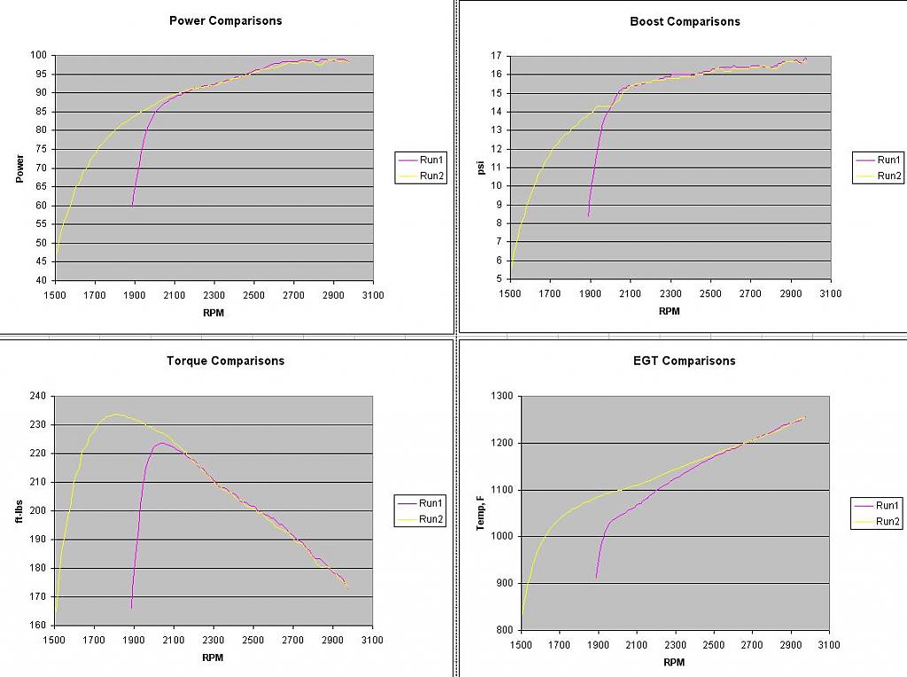

Got the raw data files from the dyno shop. Made some plots with Excel for RWHP, RWTQ, Boost and EGT's and show the two runs at the same "tune" with the different rpm start points. I think if I would've asked him to start even lower the peak torque would've been higher. Also, the peak rear wheel hp was 99.0 on run 1 and 98.8 on run 2.

I see you are hitting almost 17lbs of boost. Do you still have your wastegate connected?

Yes, the waste gate is still connected.
My boost gauge has never shown numbers as high as what their setup was recording (we pulled the tube to my gauge off the port and put their tube on there). My gauge shows ~13.5-14 psi max with the present tune. My EGT gauge also reads a little lower than what their gauge was reading (they used the 2nd threaded hole in the exhaust manifold to put their gauge in so that might be part of that issue). I'm not sure which gauges are more accurate but since I had their data aligned with the engine rpm and hp/torque data I thought it was an interesting baseline of information.
