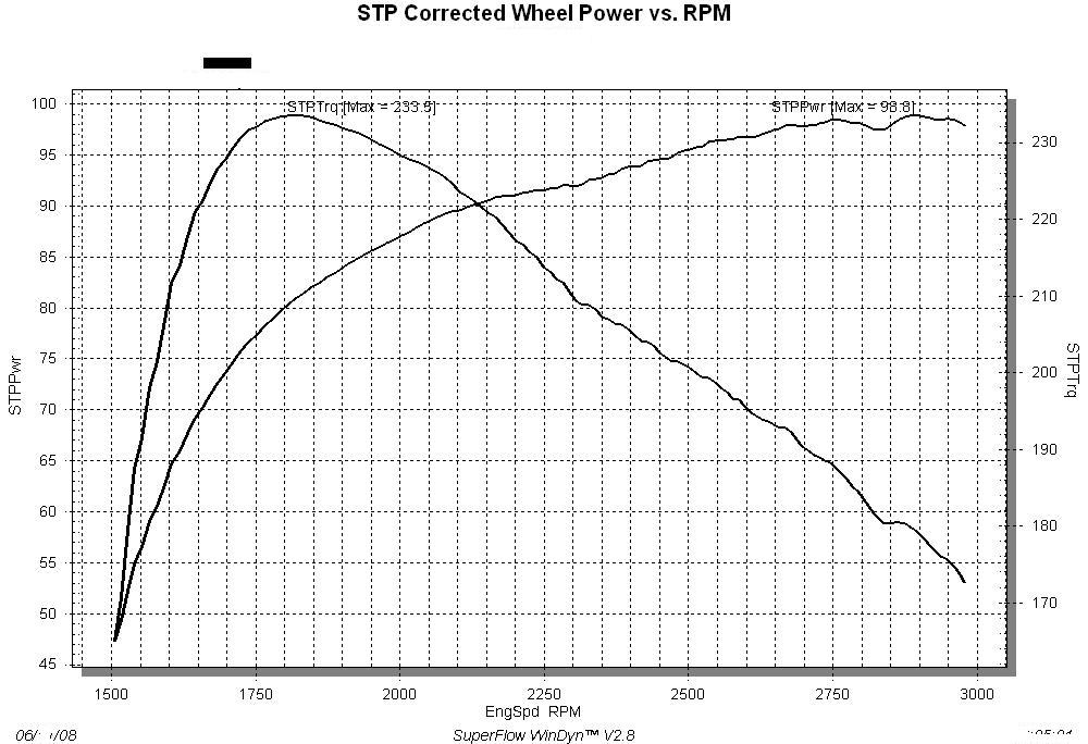

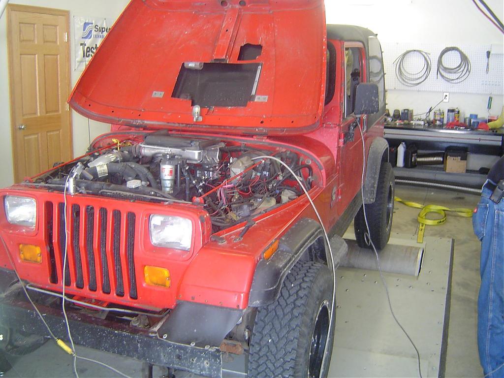

To celebrate the 2 year anniversary of my conversion I decided to splurge and buy 1 hr on a dyno for my jeep. A place close to where I live recently installed a SuperFlow chassis dyno and I took the jeep there in between rain storms (the Midwest is a wet, hurting place right now). They specialize in high performance diesel trucks. Big HP monsters. They enjoyed teasing me about my baby Cummins.
From what I’ve found on the net it appears there’s some debate over the accuracy of different dynos. Seems like dynojet’s tend to read high, with Mustang dyno’s a little lower, and SuperFlow’s a little lower yet. I do know the multiple runs for my jeep were very repeatable, but that doesn’t mean it’s accurate.
Anyway, some background:
Several months ago I decided to turn the fuel screw down a bit from where it was on my last accelerometer test as I wasn’t comfortable with how long the engine took to slow down in between shifts at high rpm’s (hard accelerations and shifting above 2k the rpm’s would kind of float down slowly) and it didn’t seem like that was a good thing for the fuel pump. I think I was asking the pump to put out more fuel than what my injectors can flow? I backed off the fueling so that on a hot engine even at high rpm shifts the engine slows down rapidly so that it’s below the next gear shifts rpm on fast shifts. Anyone with experienced on VE pumps I’d appreciate hearing if this is an accurate conclusion or not. I was also concerned about the drive train reliability with estimated 300+ ft-lbs of torque going through it.
The dyno runs were with >90% home brewed biodiesel in the tank. Tires are 30 in ProComp AT. Air temp was 80 F and kind of humid. They used an optical pickup to measure engine rpm’s (was able to verify my Dakota Digital box which takes the alternator pickup and drives my jeep tach was accurate), and we also hooked up the EGT and boost to the machine. Runs were in 4th gear (1:1). I asked him to keep the max rpm’s below ~3k. The top mount intercooler really didn’t have any air flow going through it so I don’t know what impact that would have on the numbers.
The first couple runs the operator started the tests above 1800 rpm so we missed peak torque numbers. The best run put down 99.7 hp at the wheels at 3000 rpm. The worst run was 98.8 hp which occurred on the last run where he started at lower rpm’s. Peak torque on the last run was 233.5 at ~1880 rpm.
On my accelerometer runs I started at ~1000 rpm and peak torque occurred lower than this rpm and was down about 10 ft-lbs at 1880. I think if the operator would’ve started even lower the peak torque might have been a little higher.
Right now I have a pic of the jeep on the rollers and a pic of the last run. I’ll try to post those. I emailed them to see if they could send me the data file as well. I think the peak boost was ~16.5 lbs and EGT’s were ~1250 F.
Found some dyno plots of stock jeep 4.0’s at this site (don’t know what type of dyno they used)
http://www.kennebell.net/supercharge...wrangler40.htm
Looks like I’m ~ 48 hp less and ~32 ft-lbs more than the 190hp/235ft-lb 4.0 engine. So I’m maybe ~140 hp and 270 ft-lbs at the crank on almost straight biodiesel? Somewhat close to my swag accelerometer tests predictions.

Old Jun 12, 2008 | 10:22 AM
  #462
TDIwyse's Avatar
Joined: Mar 2004
Posts: 380
From: Iowa
I think you should make a spectacle. And those guys are going to find out sooner or later so you might as well get it over with
