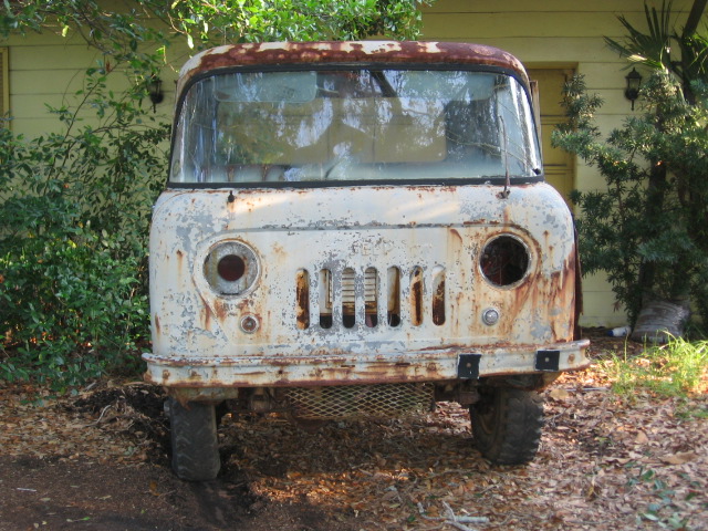

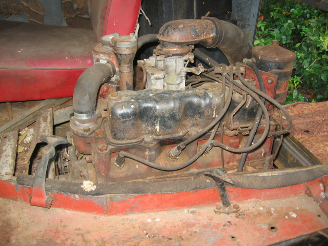

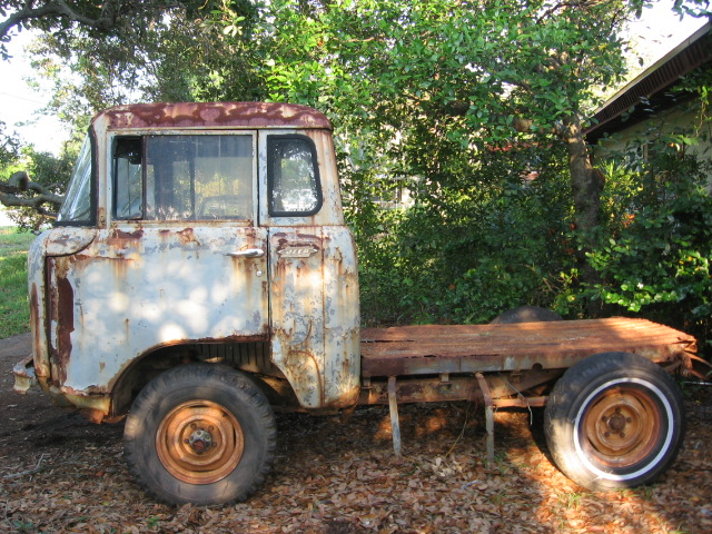

I have something to make those COD blues go away. Any time you feel that head wind slowing you down think of me. I am building a 1960 FC-150 Jeep Forward Control. It has to be the biggest block of steel Jeep ever made.
I also have a question. Does anybody know of any web sites that have demensions of parts like :axles, trannies etc? There are very few of these ever made and nobody repops the parts. It does share alot of drive train with the CJ-5 but, I'm replaceing all that with a B3.3T.
Thanks
Kirk

Your FC-150 though not popular was bulit from 1957-1966, there was a drive line change in mid 1958. They wentfrom 48" wide front tread to 57" wide, which stayed until the end of production in 1966. the FC 150 had an 81" wheel base. and was basically 1/2 ton.
The FC-170 was 3/4 ton but was advertised as a one ton. there are a number of web sites around that can help you out, and parts are not to bad.
try this for some infor: http://jeepfc.www5.50megs.com/tread/tread.htm
Bob S

I'm learning alot with this vehicle. I have found alot of good sites so far. Since most of my build will be non-standard I was looking for sites that gave measurements or other brand parts I could swap in.
I want to build it to pull a trailer with small "vintage tin"(model As, etc). They all seem to be up north. So if I want to build a Hot Rod I have to build a truck to go get them first. I know its short but i can always stretch it out I don't have a bed on it yet.
