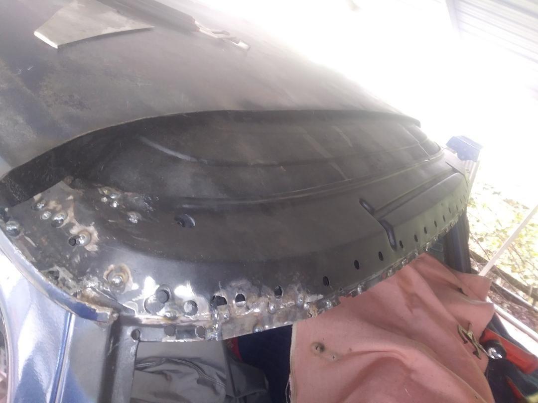

Speaking of rust...
I finally finished with my rusty roof repair. In the process I found more rust when we removed the rear window, which I broke, so now it has just a plain glass instead of a slider. I never opened it anyway, oh well.
I decided instead of doing a bunch of body work that I would roll the roof with bedliner so, it may not be perfect but it aint rusted.
This is one job I never want to do again so if I buy another 1st gen it will have to be rust free!
Where'd you get that idea ?
Lol.
Nice job. One Florida / rust free roof.
The new roof looked like brand new. Where'd ya get the parts for it ?

I saw your truck. lol
My son found a guy on facebook parting out a 93 W250 club cab that was only a few miles from me. The bottom of the cab was rusted away but the roof was near perfect. He cut it off at the pillars and sold it to me for $150. I wanted to buy the axles too but they were going to his dad.
