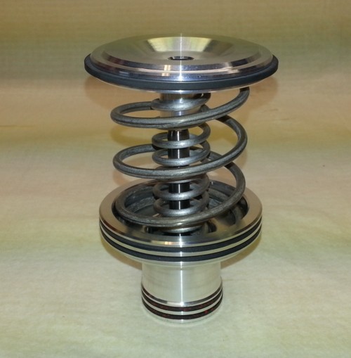

What you are looking at is a cover that guides the rod that the piston moves.
Here is a pic of a billet dual seal ring servo but you get the idea.

AJ, how hard is it to pop the servo out while still in the truck? I would assume his spring has broken?
Old Nov 12, 2014 | 08:35 AM
Angry Johnny's Avatar
Posts: 939
Likes: 264
The spring returns the servo to the non applied position. You have to compress the cover slightly, which will have spring pressure on it so it doesn't easily compress, and remove the snap ring holding the cover. Then if you're lucky the cover will pop out but most times the seal ring is holding it so you'll need to compress it and let it pop quickly, maybe several times before it will pop out.

When I overhaul these transmissions, I always replace the intermediate and reverse servos with the Super Hold servos. They can be purchased through trans re builders or even Fleabay.

That servo pictured sells on moparts in the trans for sale section. I bought both the kickdown and reverse servo. They are beautiful pieces at $208 for both with shipping. Delivered fast too.
