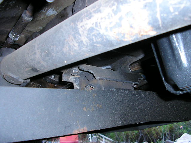

For mine I made a new cross member that wraps around the outside of the frame and leaves the inside open so there's a bit more room.

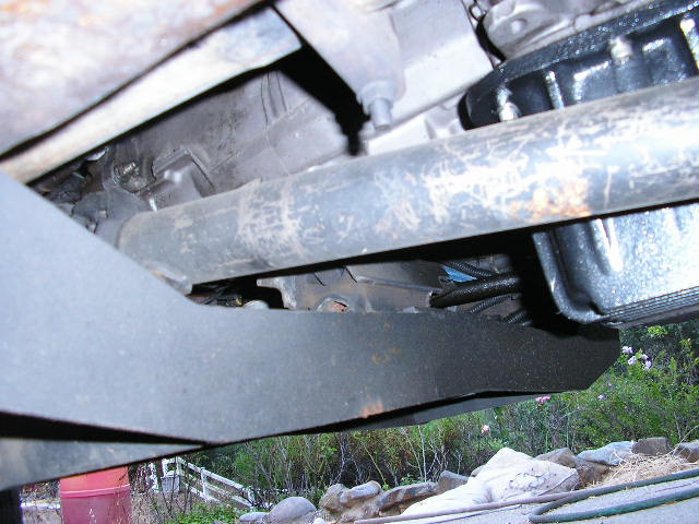

It opens it up a bit and has held up well.
