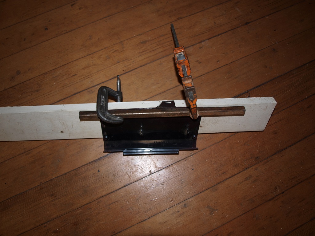

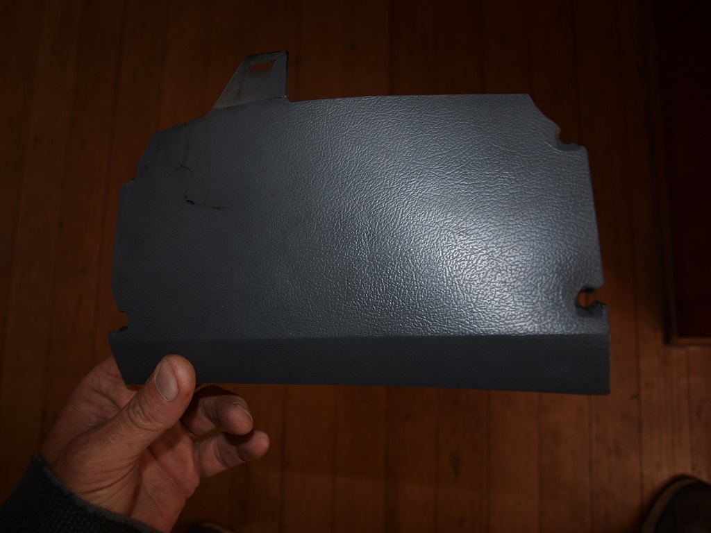

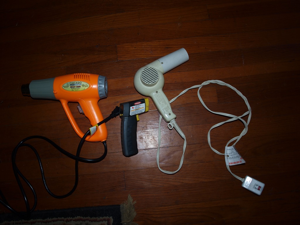

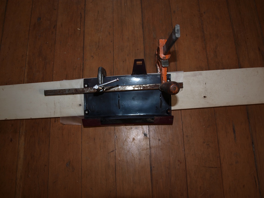

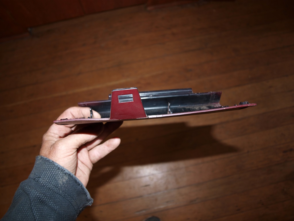

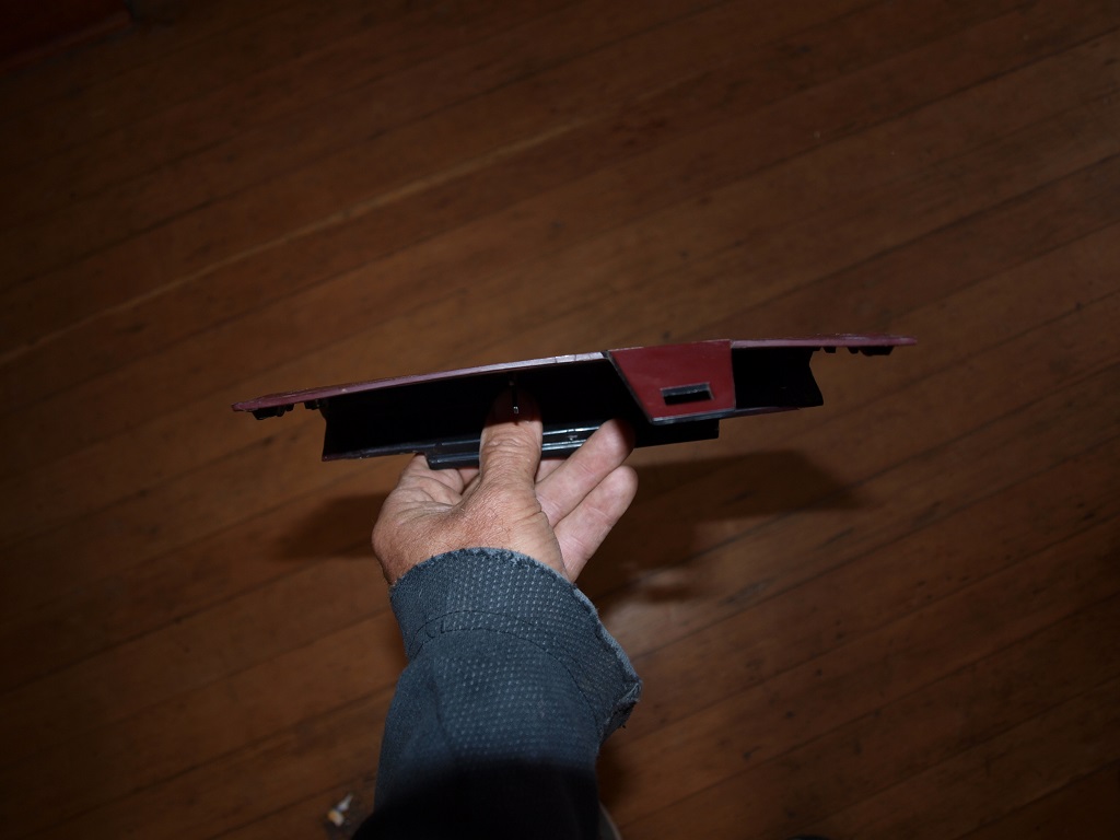

I, for one, am tired of my fuse fox falling out of the distorted and damaged plastic panel that is supposed to support it and hold it in. I found a used one on ebay from a d150 gasser, about 25 bucks. It got here and I noticed that it was in good shape as far as the screw holes go, but it had the same curve in it that my old one has. This is why the tab on the fuse box keeps coming out. I wondered if I could clamp it to a flat surface and heat it up, to get it to flatten out. I know that plastic will do 1 of 2 things when it is heated, either melt and get soft, what I want, or turn to charcoal and burn away. I tested on the old piece and it got soft. I clamped it to a good straight piece of wood and tried to use a blow drier. It would only get to about 200 degrees F. and that just was not enough. I then used my paint removal heat gun and it got plenty hot enough. I tested on the old piece and around 250-260 degrees F. made the plastic very soft. I also put a piece of wax paper between the wood and the piece as a release agent, don't ask how I figured out why I needed that. I used a piece of 1/2" square tubing to clamp on the underside, which has tabs and other protrusions. I forgot to take a pic of the final result before I installed it, so when I pull it to paint it, I'll snap one. I found that if you direct the heat through the steel, it worked real well. The final result is that the tab on the fuse box now stays in and the fuse box is in the correct place. Hope this helps you people with the same problem...Mark

A couple more pics, I'll post the pic of how good it straightened out when I pull it for paint...Mark
