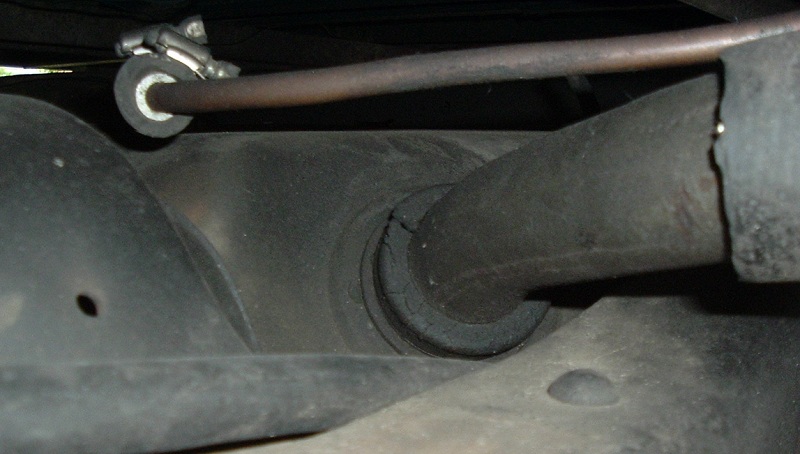

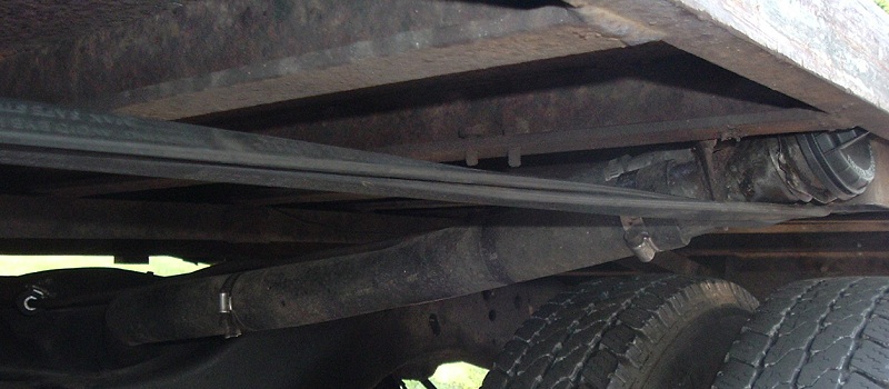

My truck is a cab & chassis so I'm not sure how much of a difference that makes, but...
The truck came with a huge utility box on it and the part the fuel cap screws into was pretty much just set into the hole in the box meant for it - it has a triangular flange with 3 tiny screw holes. That part has a tube coming off the side to connect to the vent on the tank.

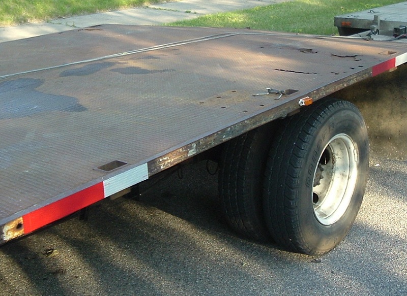

Now I have a very wide, low flatbed on it and it has to sit practically horizontal, which just is not working for me, but I don't know what else to do. The only thing that seems like it'll work is putting the filler through the bed 2 feet in from the side, but that would really restrict how I can use the bed. Basically I'm looking for ideas on how the heck I can fill my tank better... right now I can't use big truck stop type pumps at all, and even the diesel nozzles at gas stations I have to fill it real slow to keep it from shooting out the filler. In the overall pic of the bed you can barely see the fuel cap, it's tucked behind the outer rail. I had the filler welded in place but it was at even more of a horizontal angle, this way it was easier to fill (slightly).
I'm also wondering if there's a PN for the thick rubber thing that keeps the base of the filler neck in the tank. I don't think mine leaks but it's obviously been flexed so much (and is old) that it's cracking. Ignore the crappy vent tube, it was an emergency repair.

Here is a shot of the filler pipe on my parts truck, it had a flatbed on it.
Old Jul 4, 2010 | 03:25 PM
Machinos's Avatar
Posts: 365
From: Minnesota
That's pretty similar to mine... I wonder if running the filler forward diagonally so it's longer would help any.
